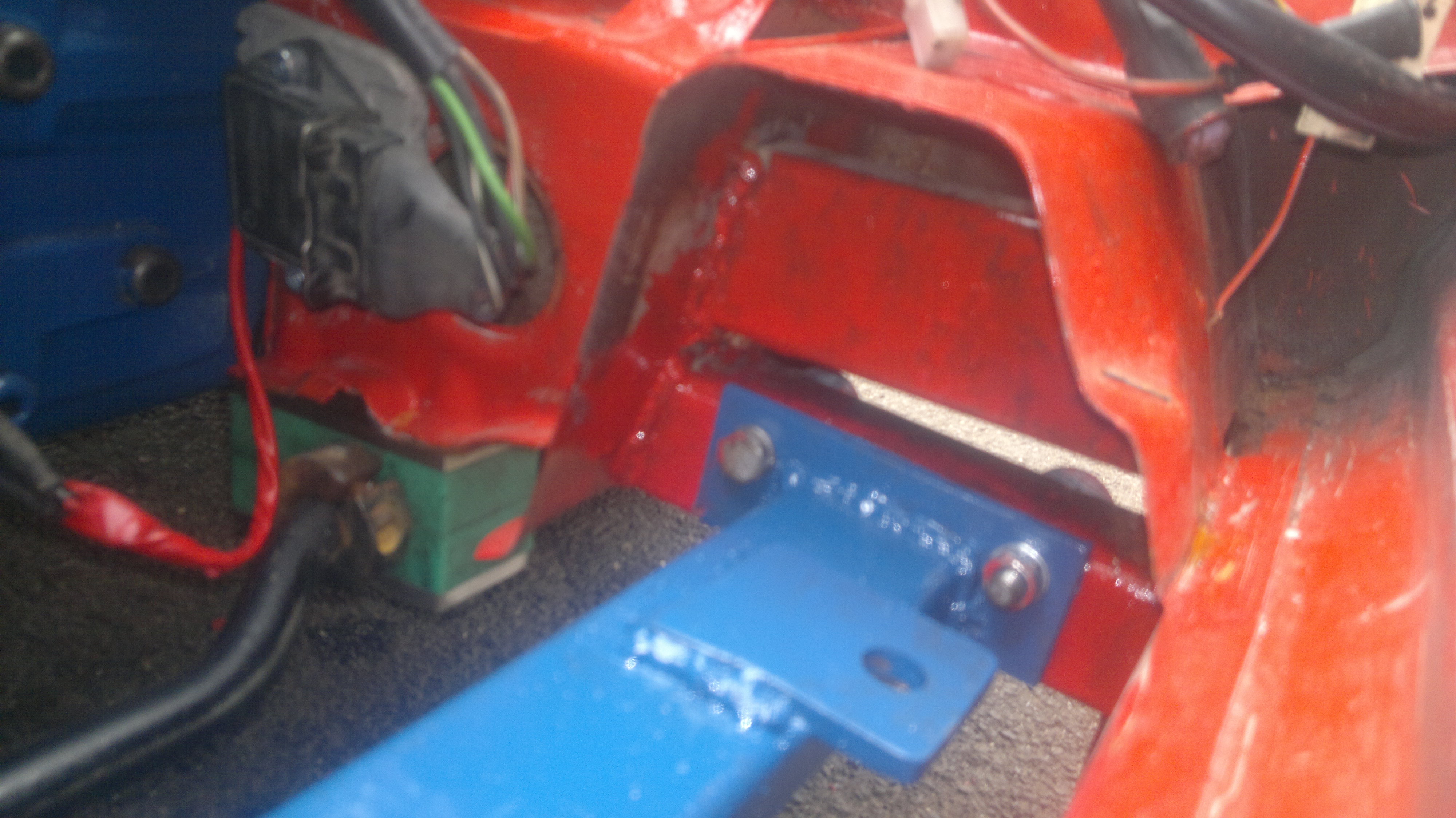

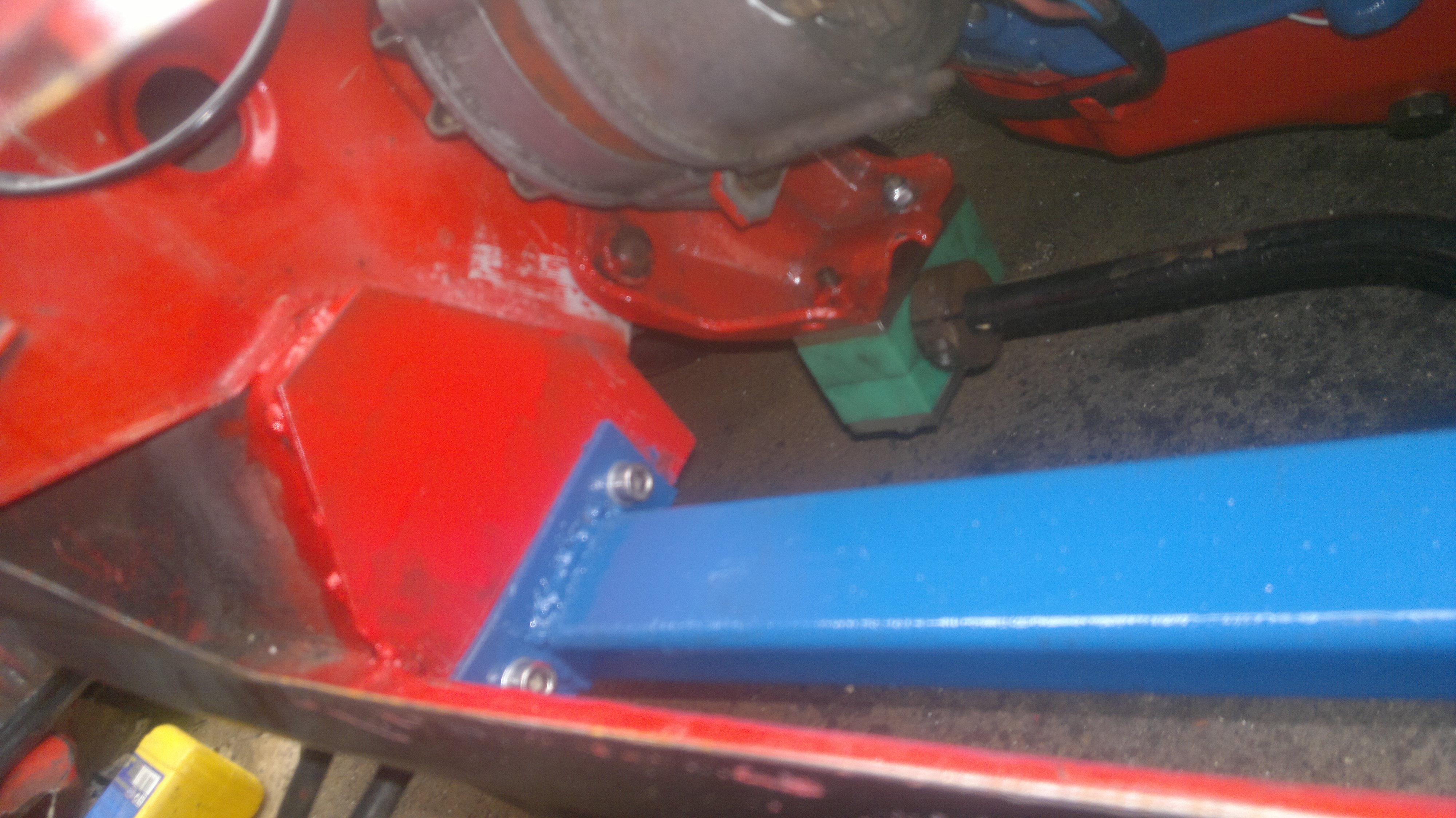

rear lower strut and chassis rail brace bar (my own design and made it myself)
223381_2009911728109_1253192899_32317186
215427_2009626440977_1253192899_32316560
217121_2009627040992_1253192899_32316562
Gearbox mount bracing and also front brace mount.
224073_2009912728134_1253192899_32317188
chassis tow brace plate and front brace mount.
225091_2009912328124_1253192899_32317187

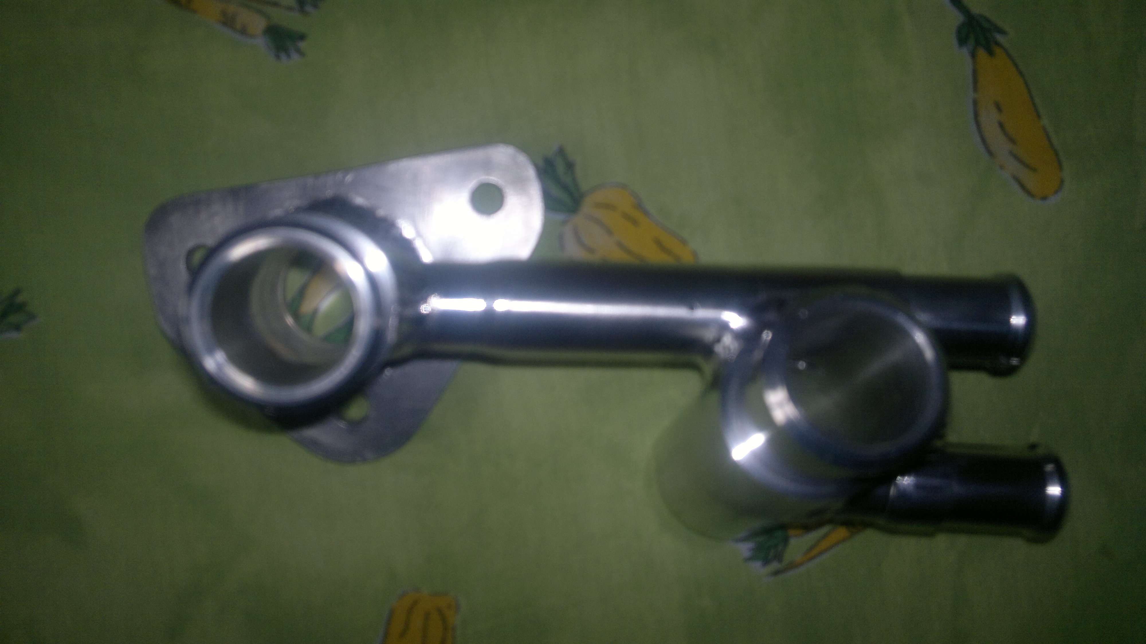

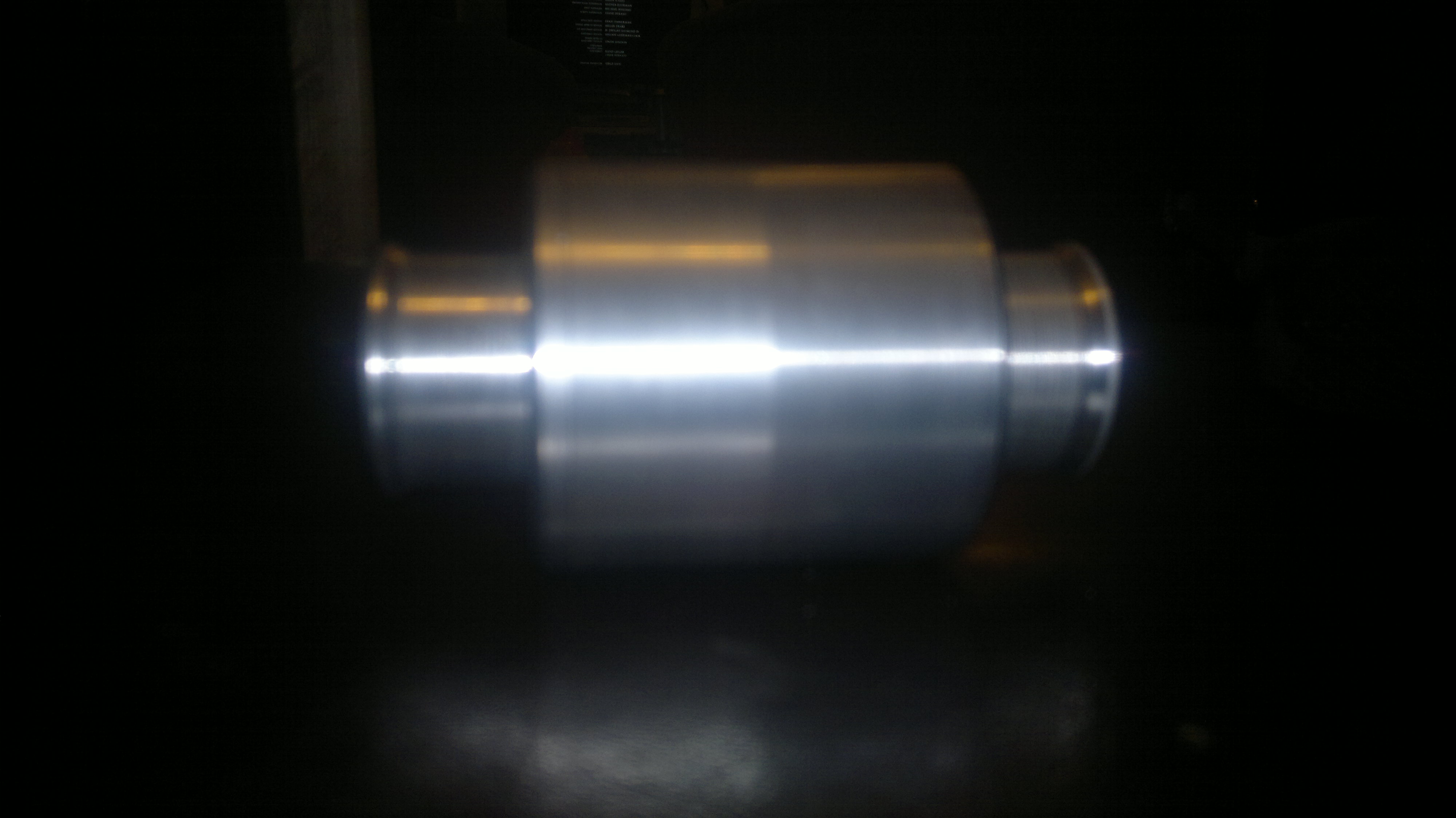

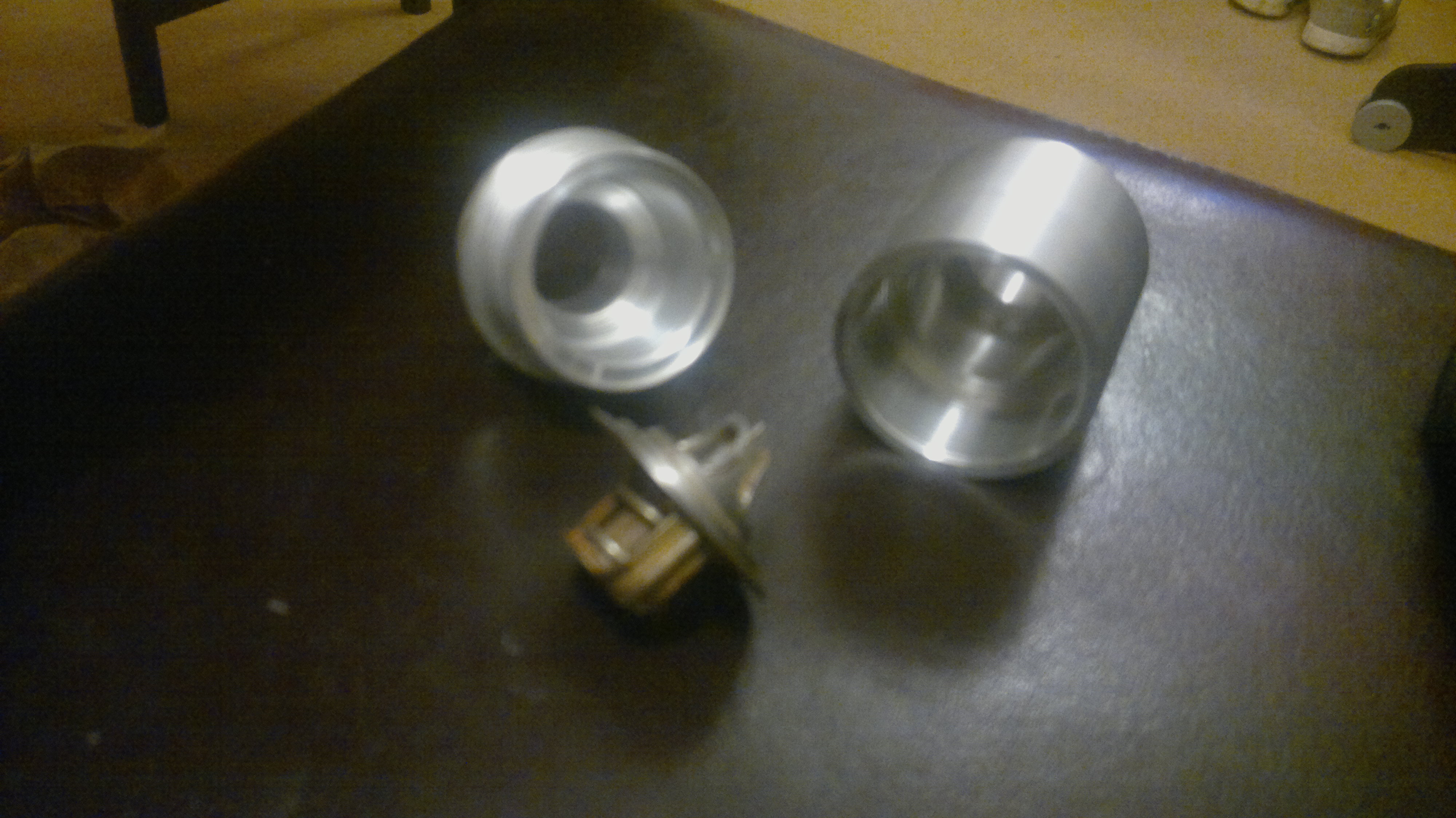

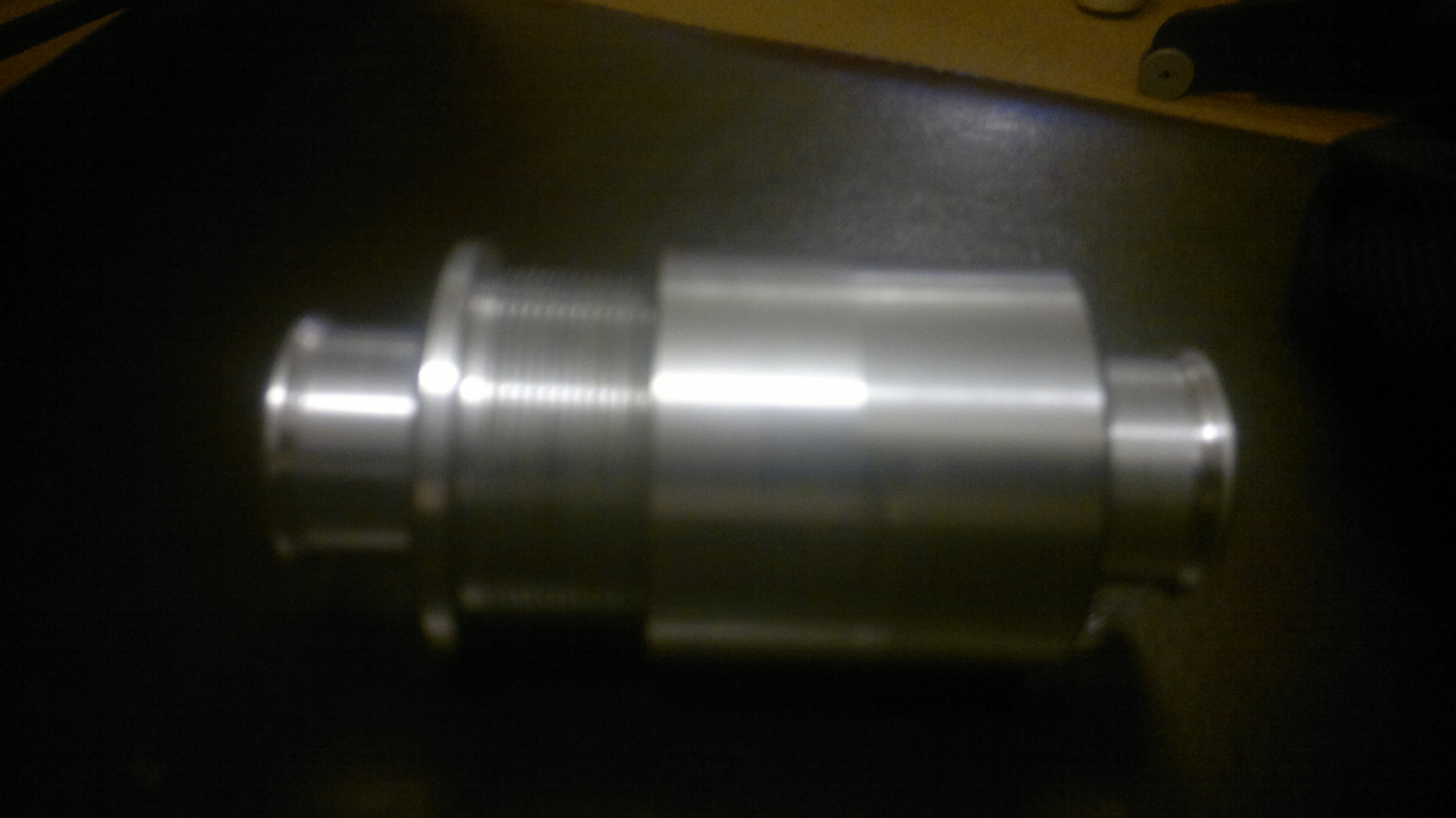

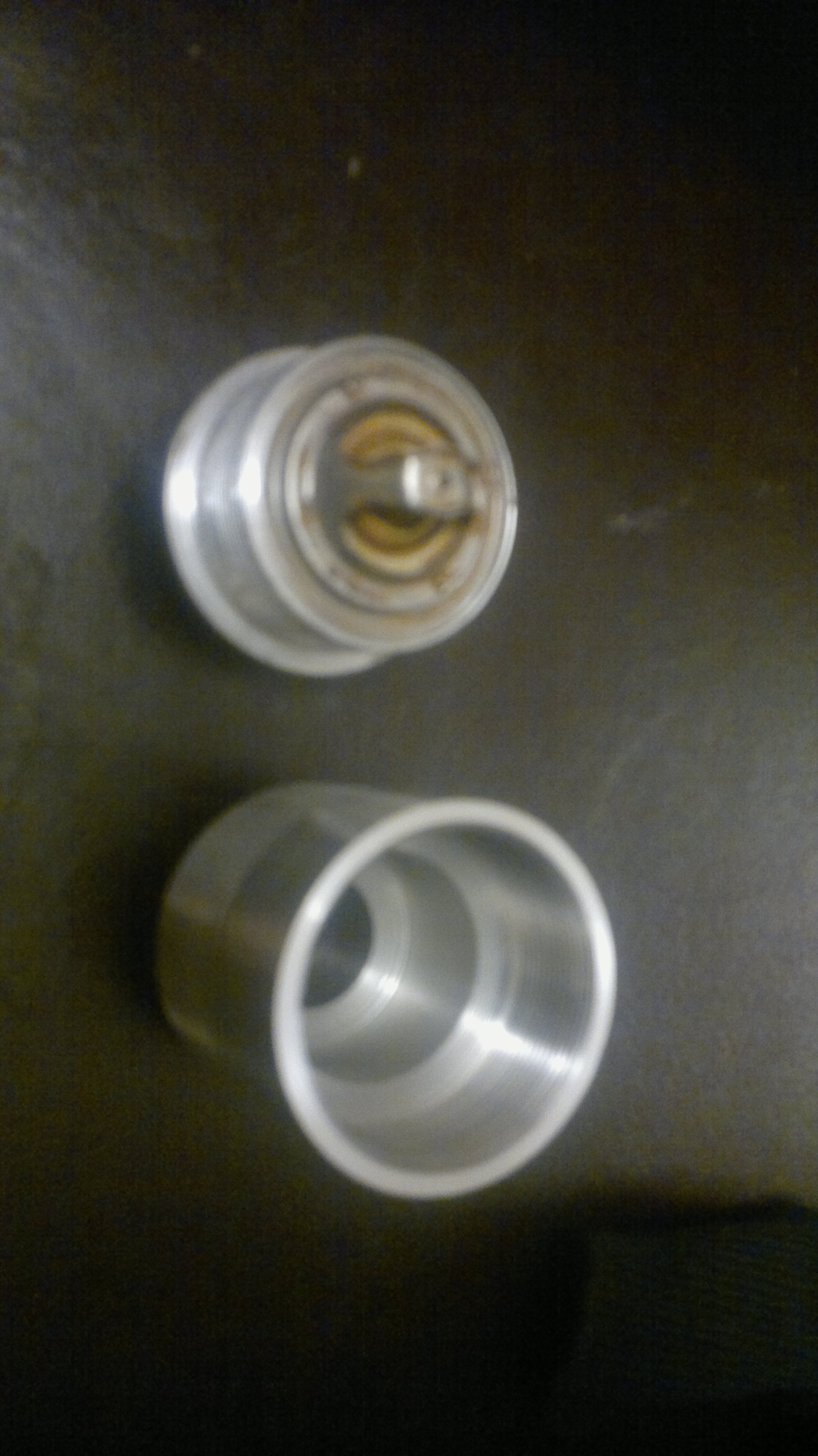

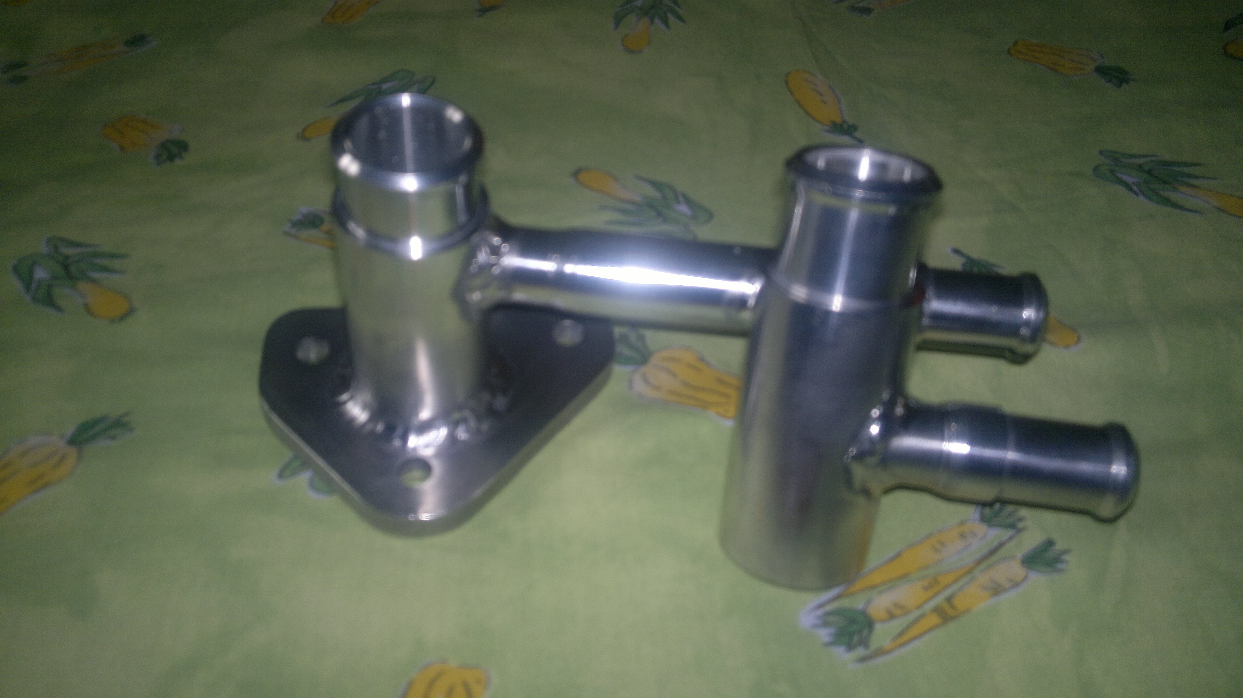

Got all my parts back from anodising on friday this included my water distributor that replaces the thermostat housing, my inline thermostat housing as i deleted it from the distribution bit i made and a radiator hose connector.

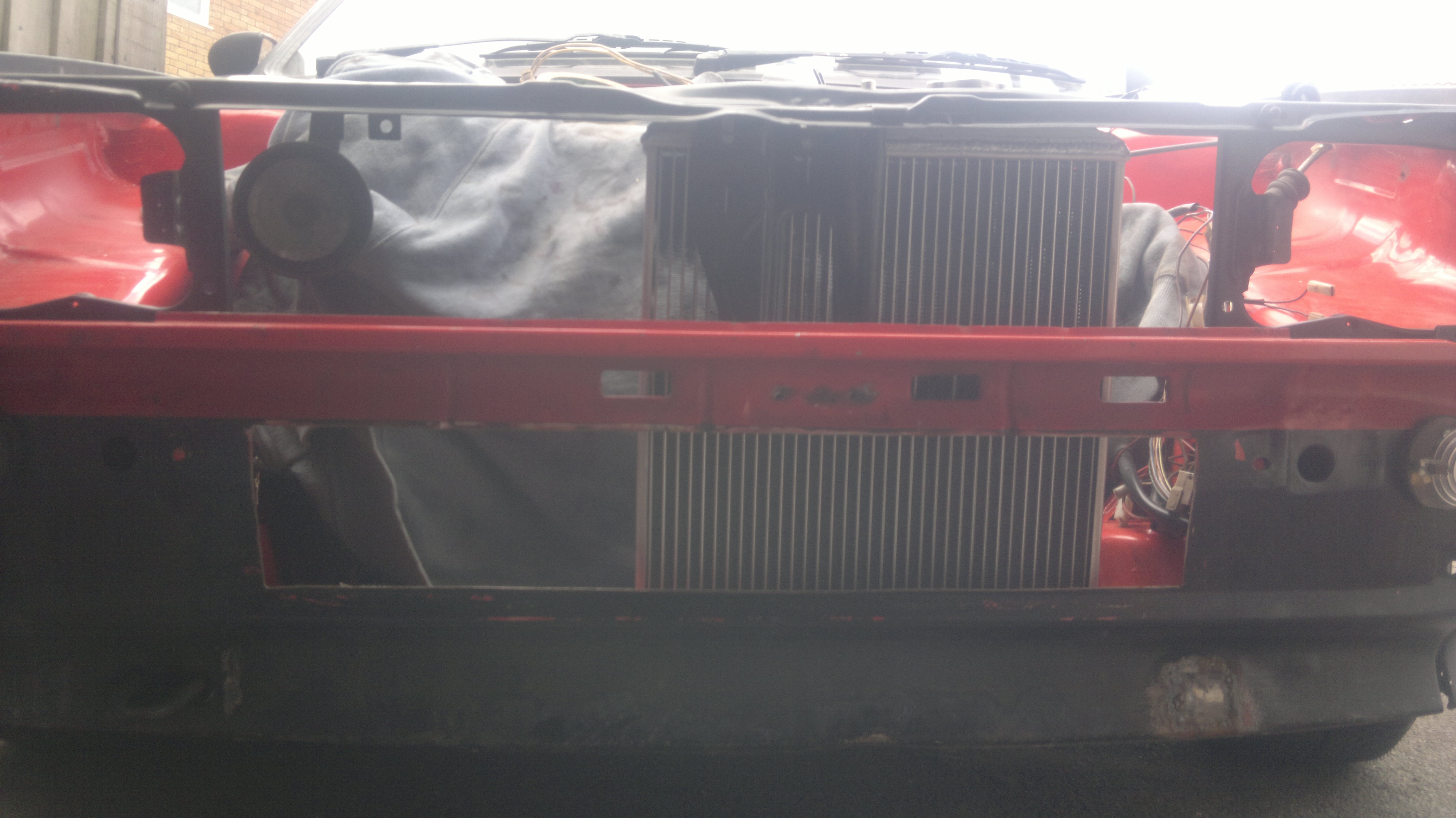

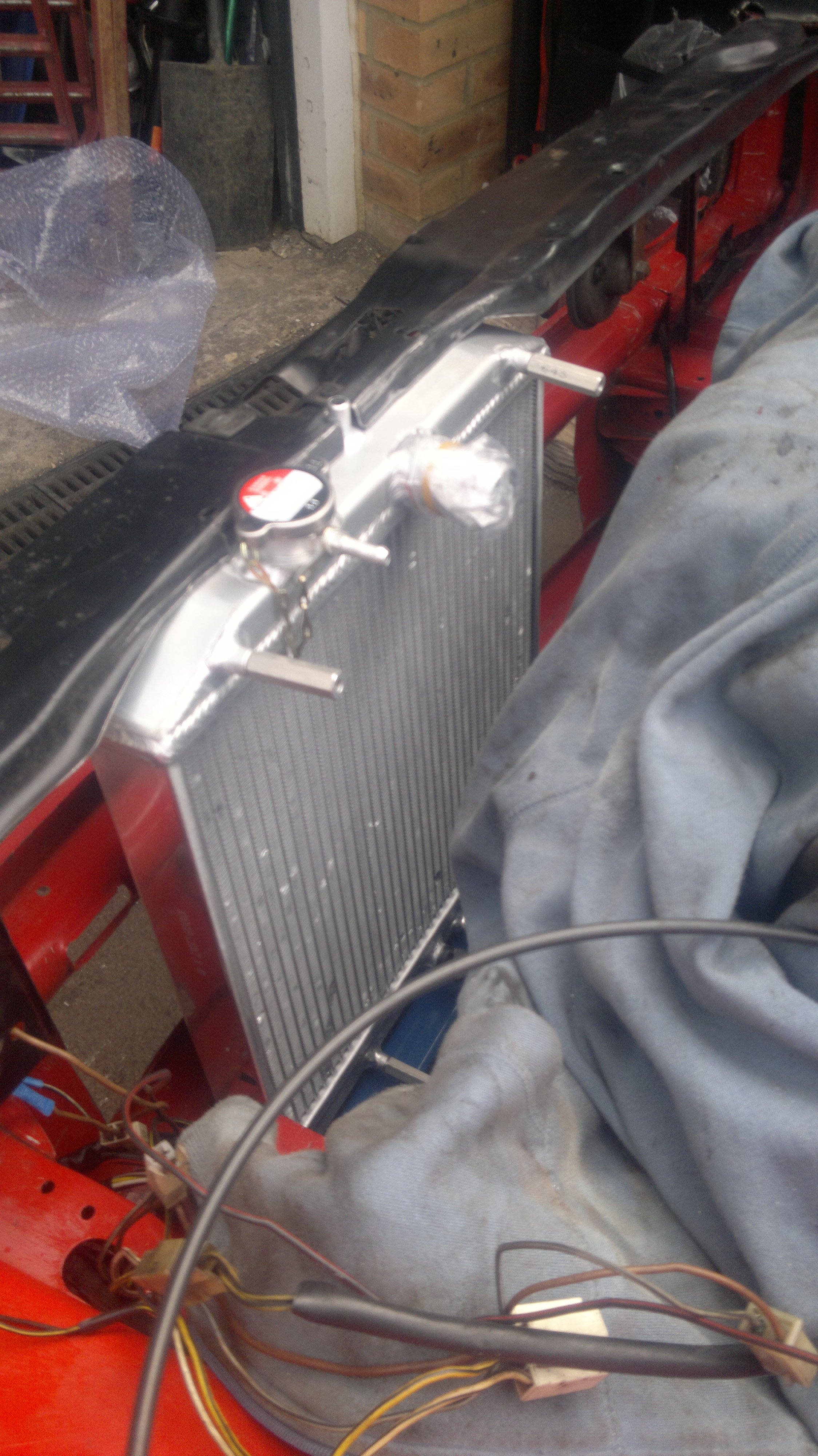

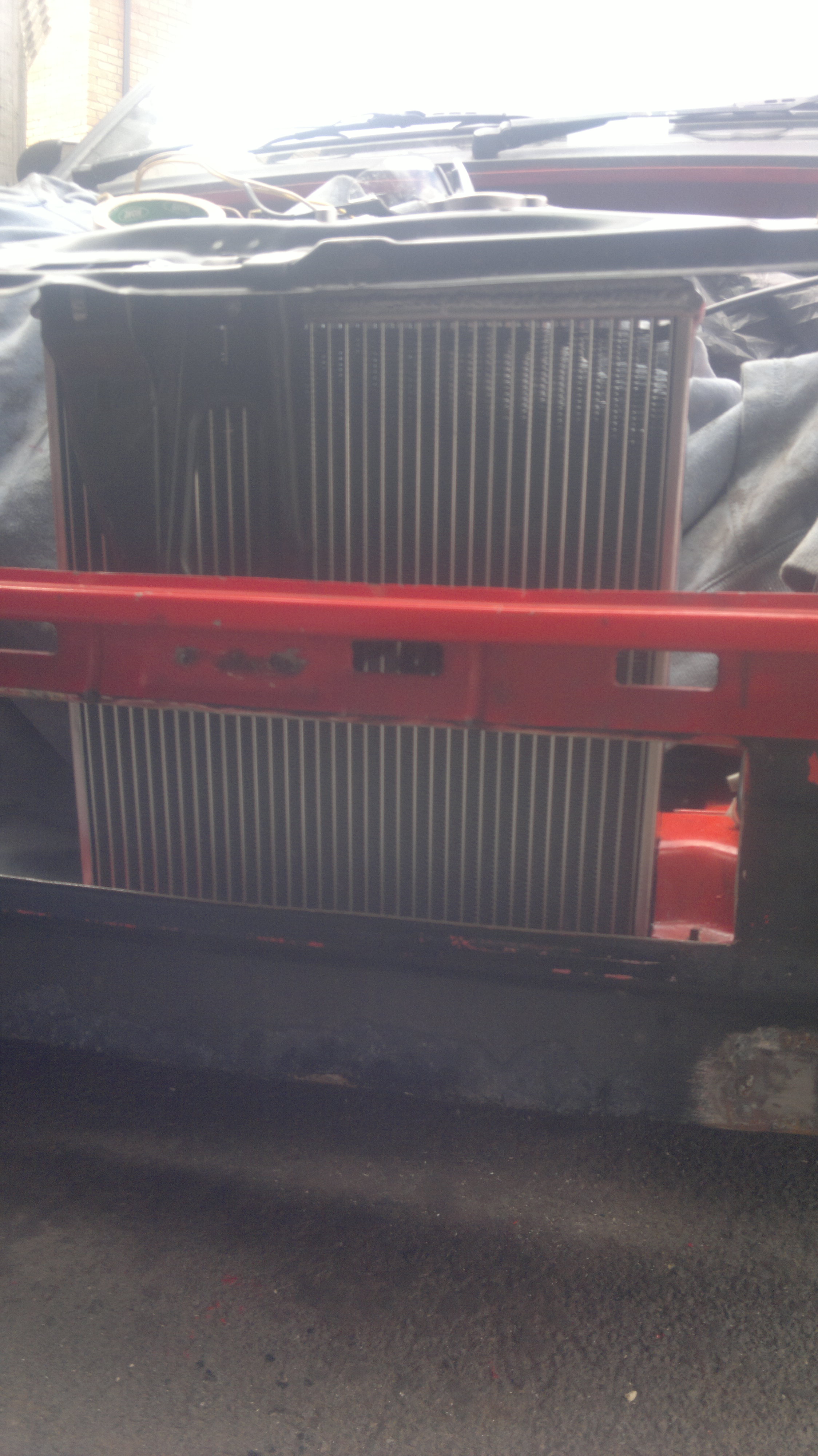

friday night i fitted my water distributor and made the brackets to hold my slimline fan to my full alloy honda civic radiator that i have fitted.
i then fitted everything in and started fitting my hoses but have found out i need to buy another 90 degree silicone bend oh well payday this week and also need to get a new lower temp thermostat and a rad fan switch for this radiator.

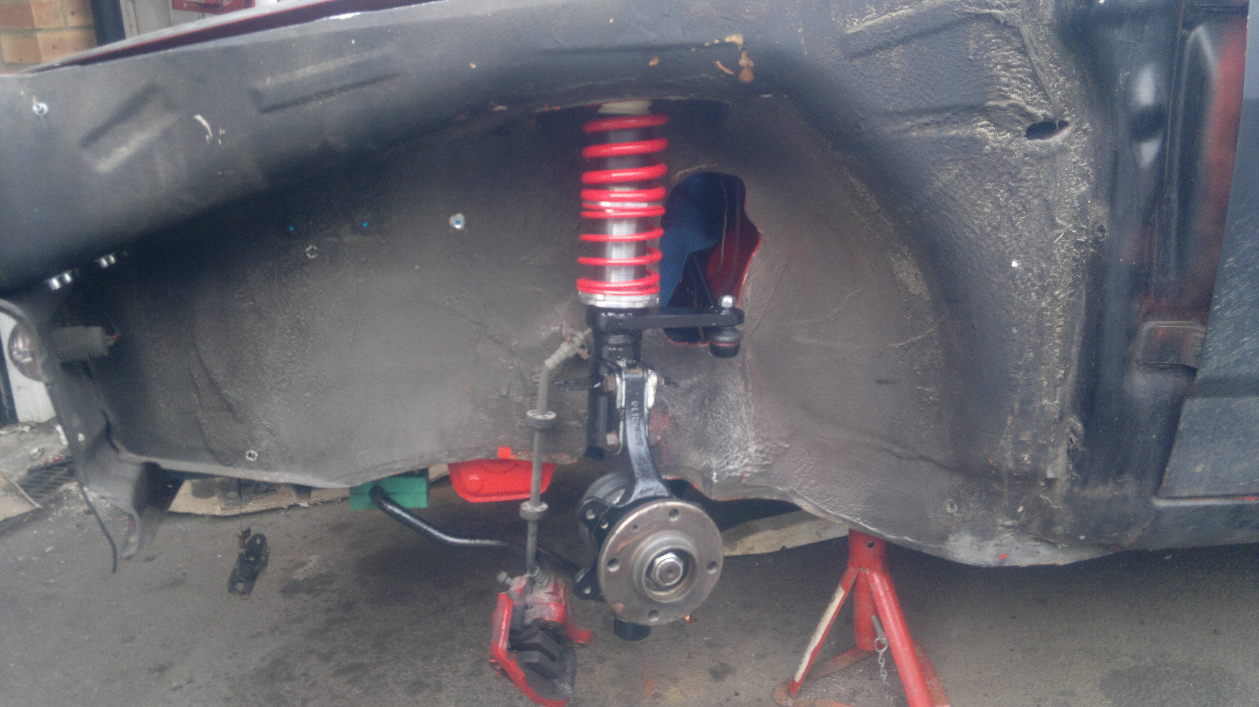

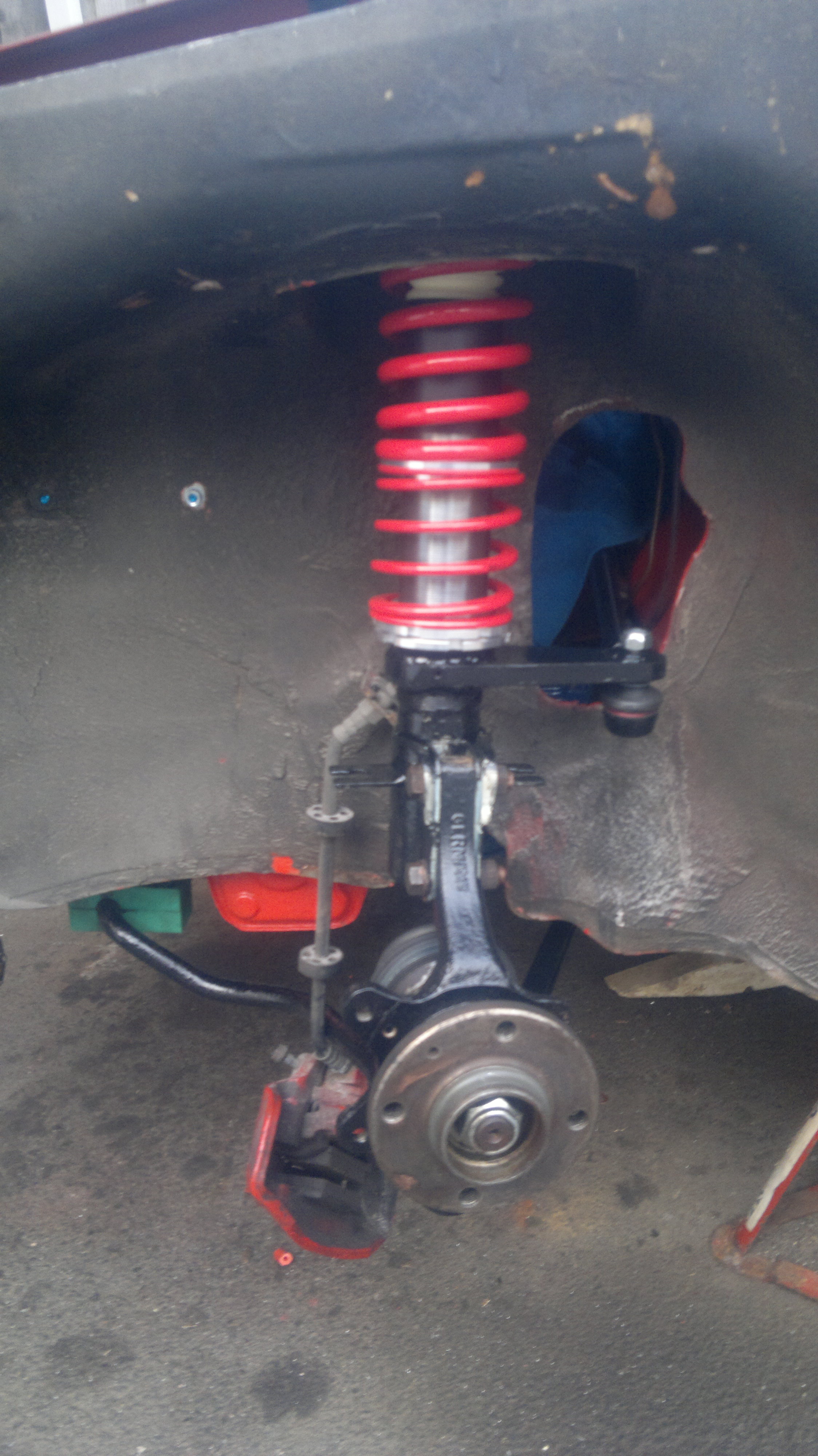

so coilovers fitted on the front finally with upgrade to vented mk1 golf gti vw11's

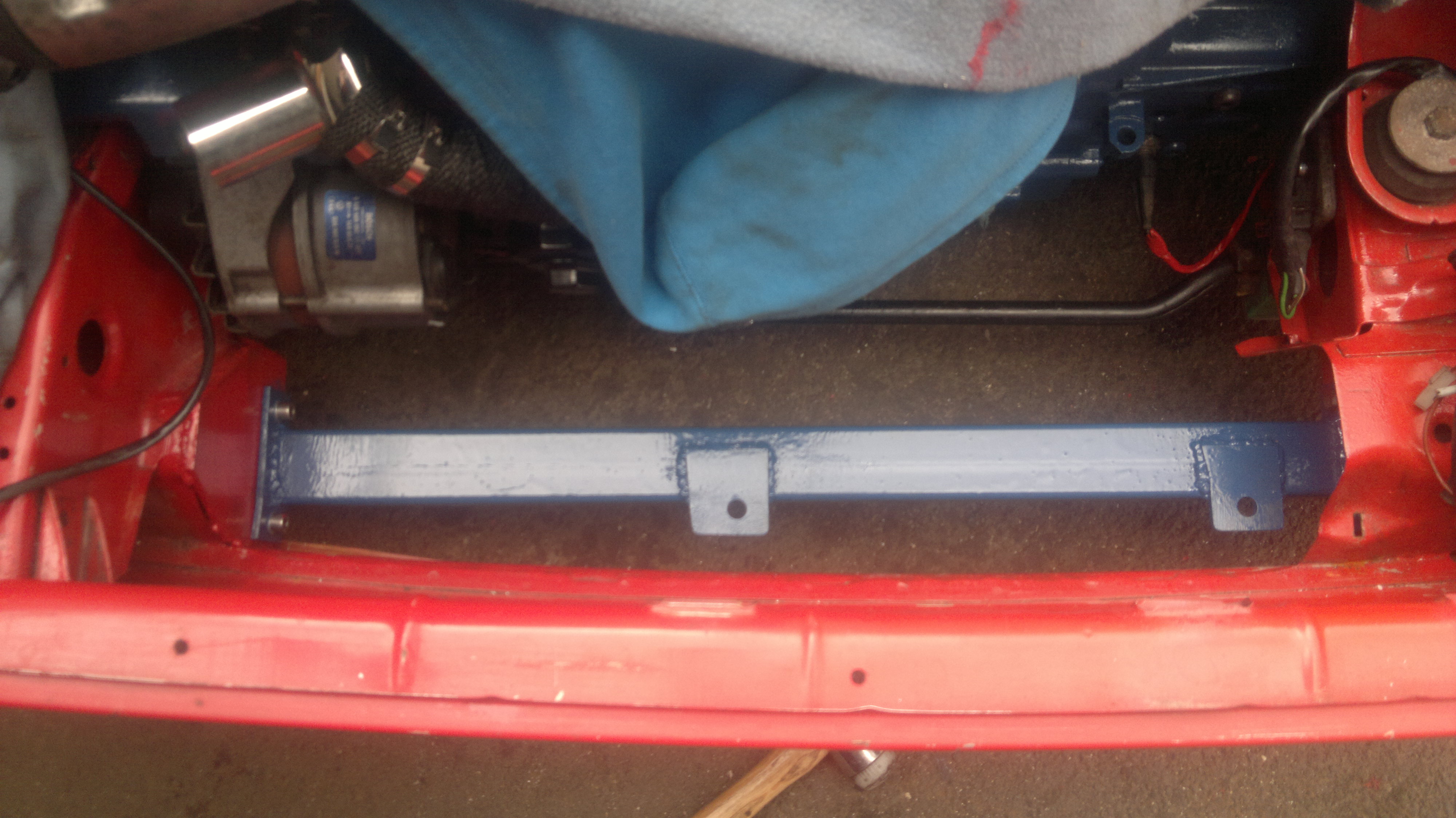

painted and fitted front brace/ radiator support bar

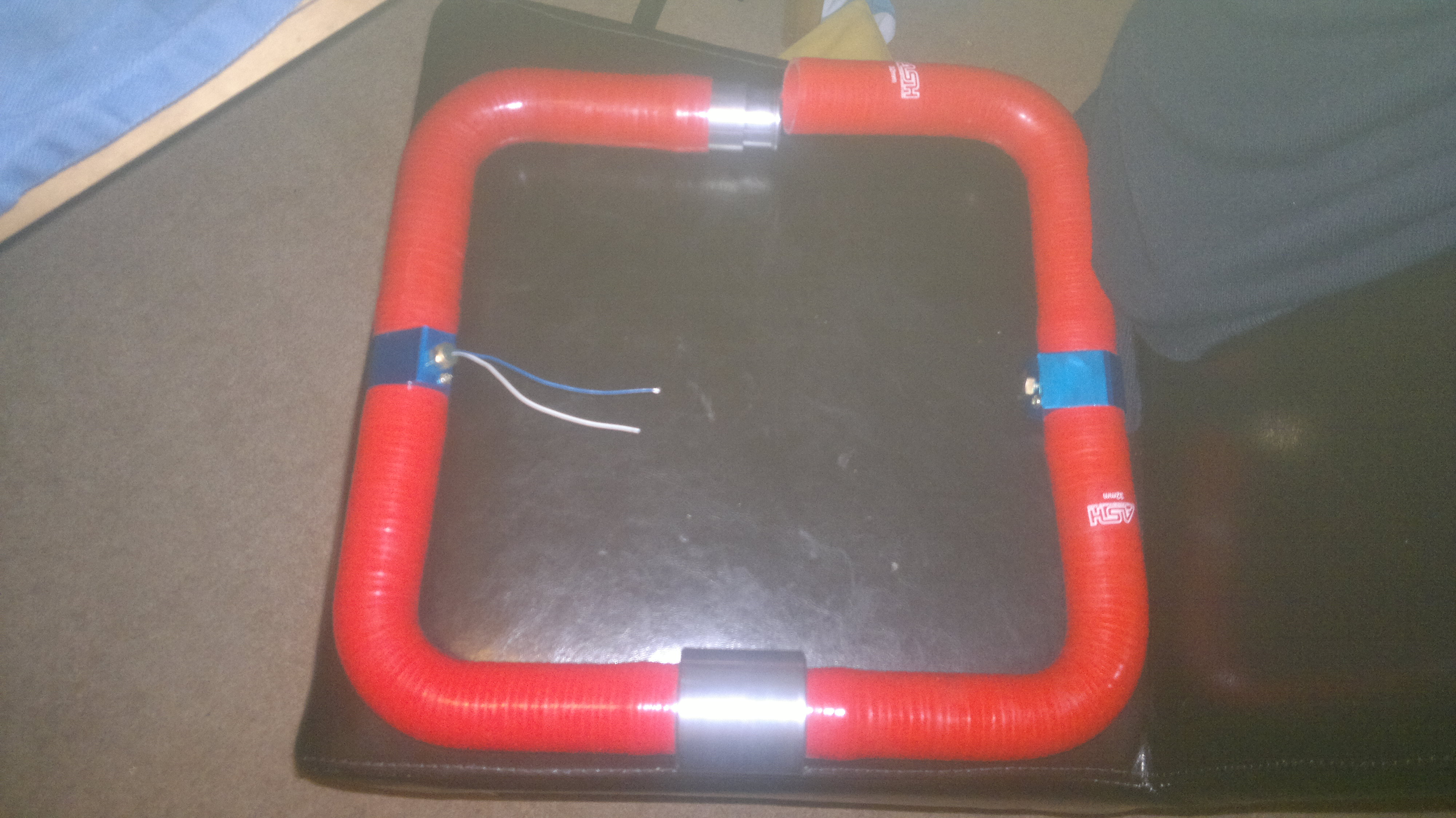

New silicone rad hoses

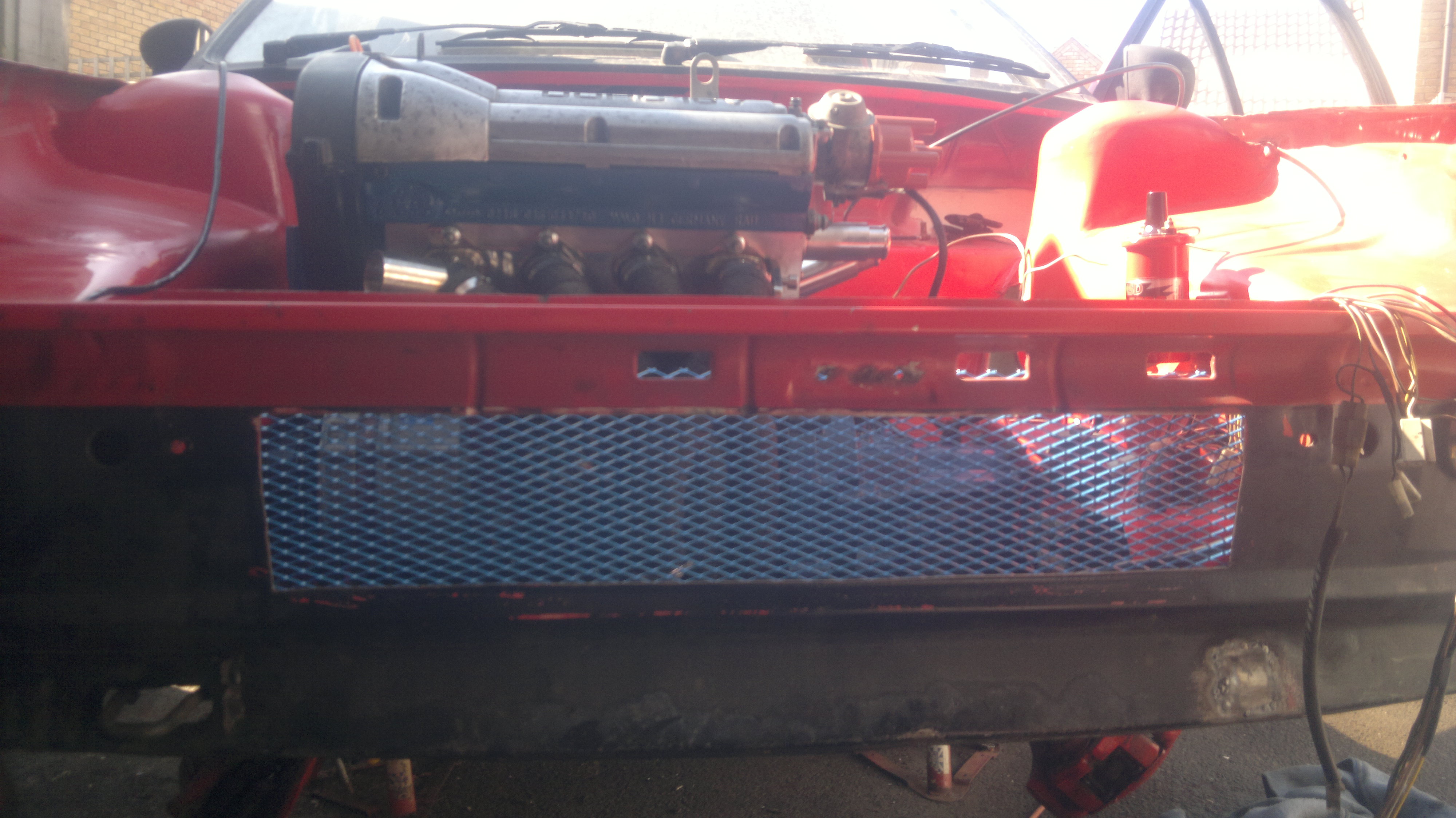

new honda civic full alloy radiator fitted
water distributor fitted after it was anodised
inline thermostate fitted also anodised

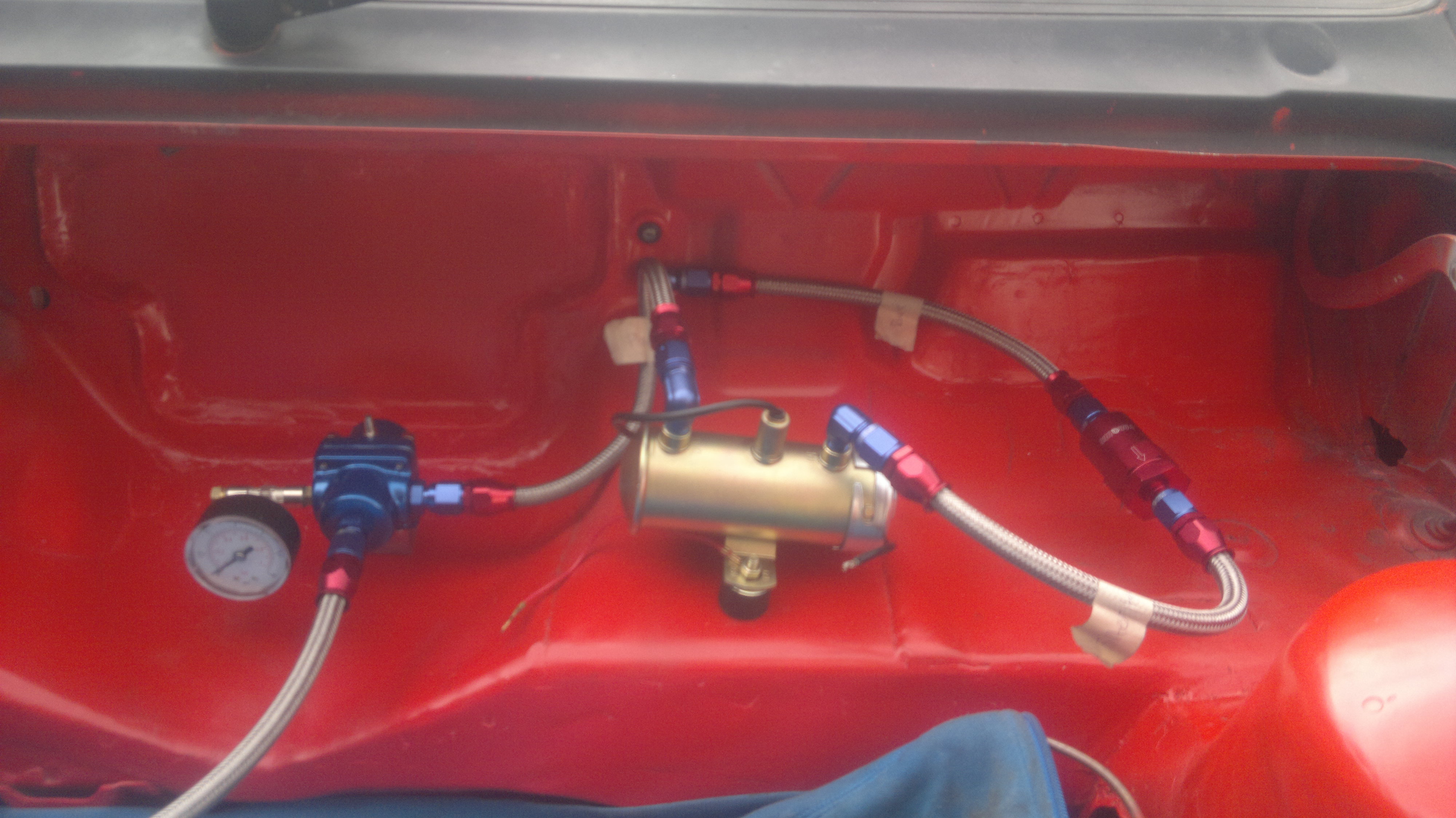

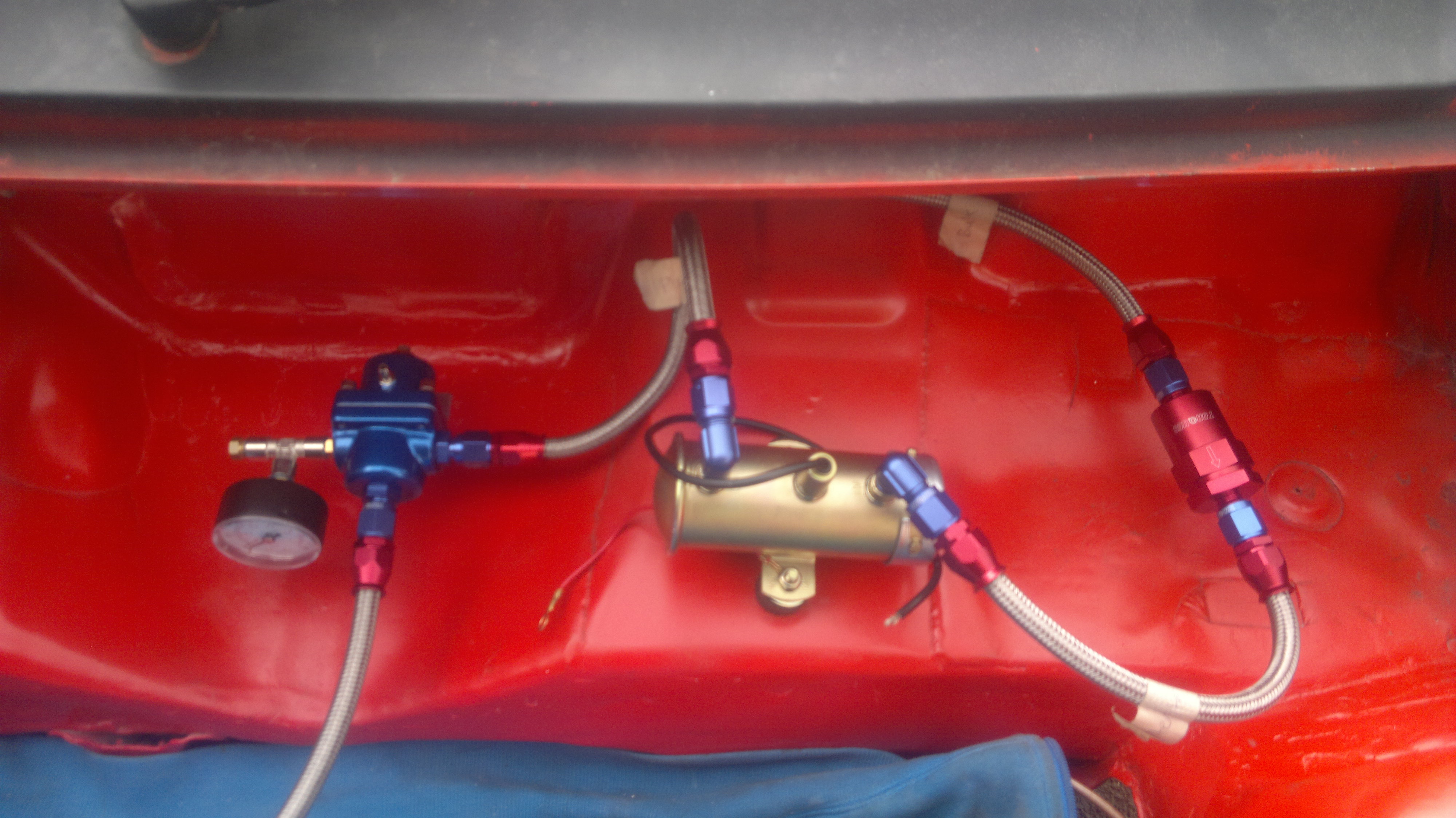

fuel pump, fuel reg and fuel filter fitted with teflon lined s/s braided hose

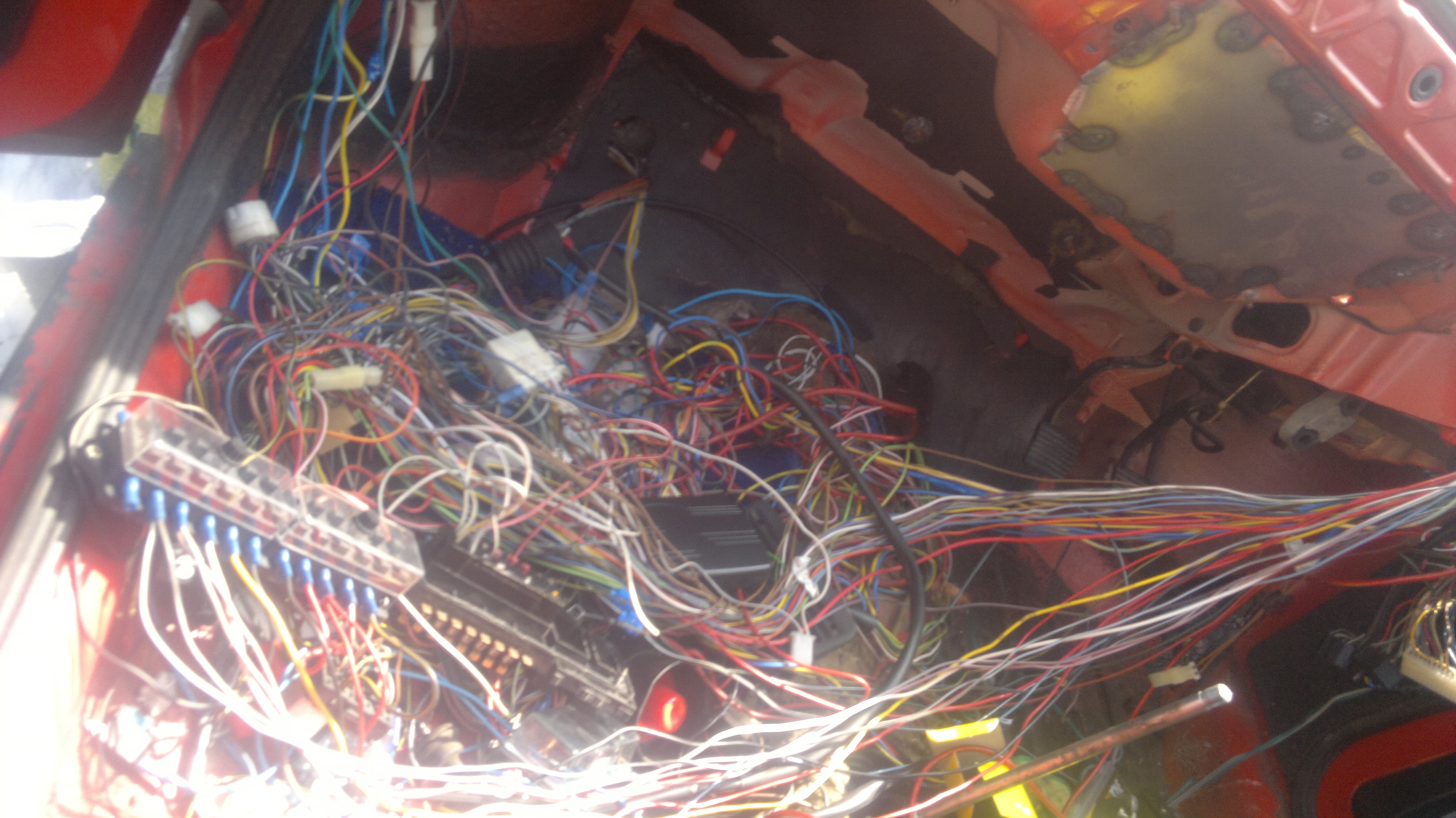

Also rewired alot of the car too

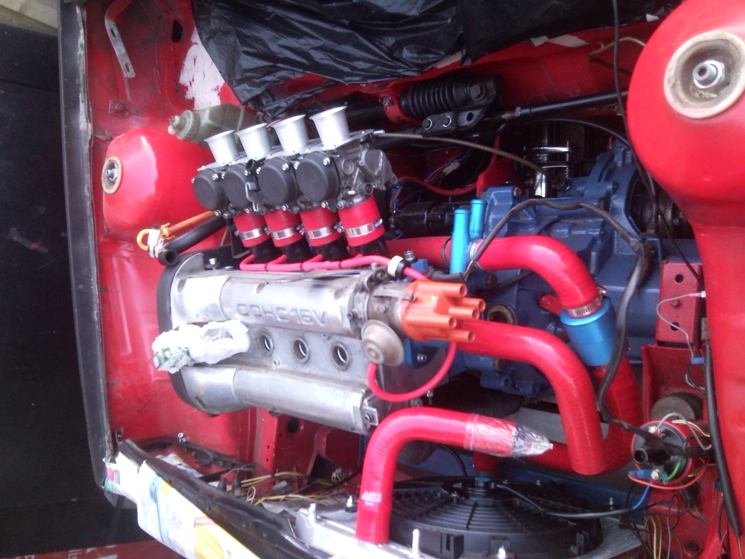

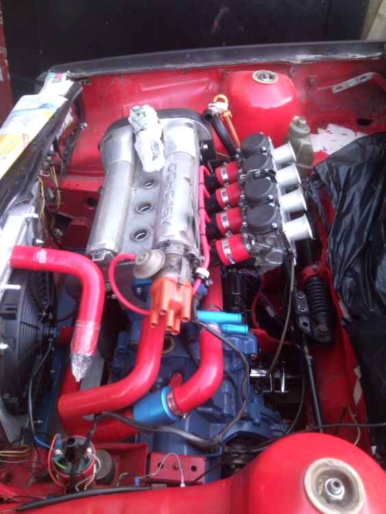

engine bay as it stands now
pretty happy but will be looking alot better soon once finished
what you guys think

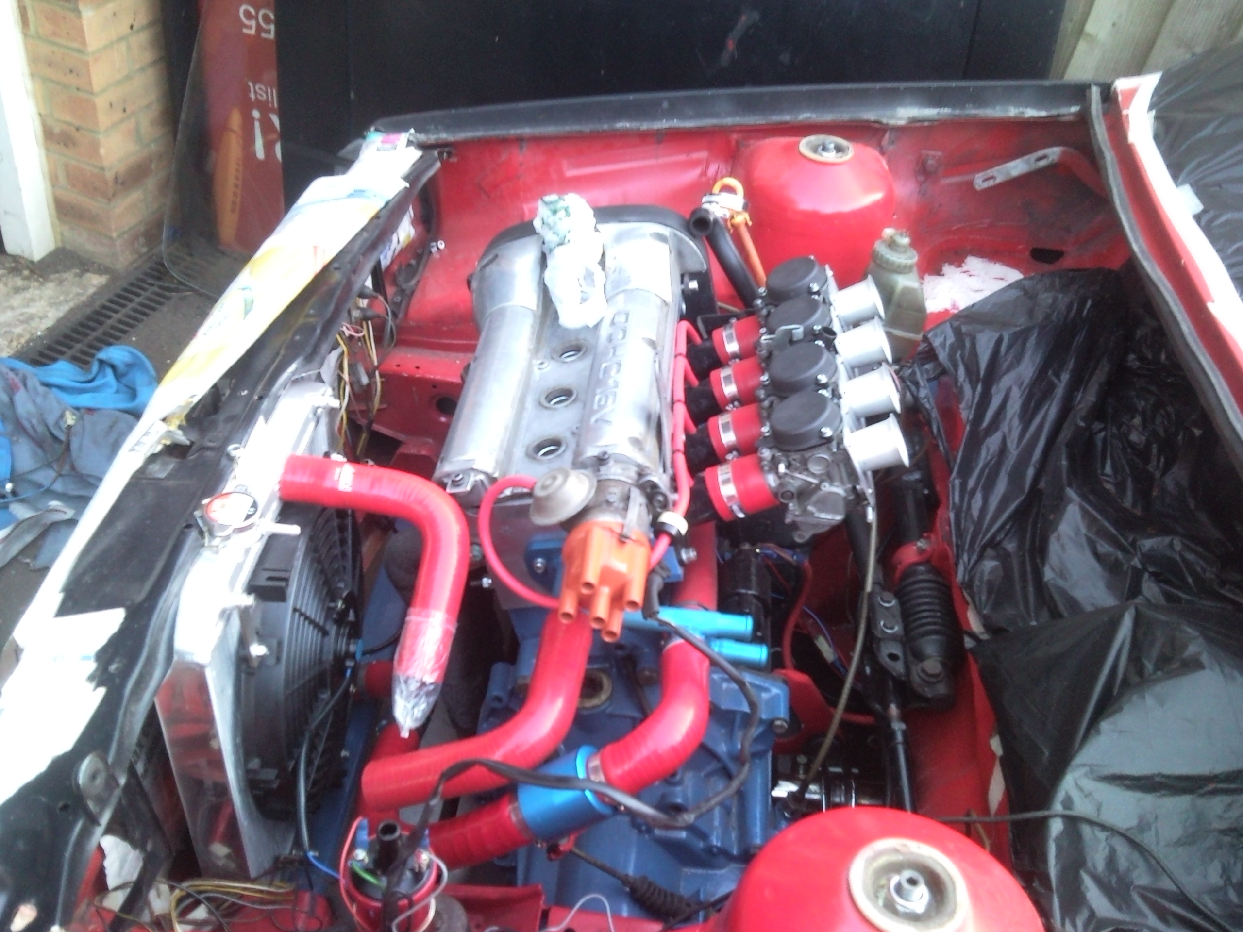

engine as it stands now
250499_2106275297138_1253192899_32448709248127_2106275097133_1253192899_32448708248140_2106274697123_1253192899_32448707249541_2106274257112_1253192899_32448706
so pleased with how its looking now just a few more bits to sort out then it should be on the road running but got to sort it for mot straight away :( most of its new i only think the chassis is left original and even thats heavily modified lol so should hopefully pass
enjoy
yo pete, nice engine bay man, hardly looks like a polo one now! I like what you've done with the radiator, it's a really good idea and gives a bit more space in the bay. does mean custom hoses are required tho..
I think paint the DOHC 16V letters red ;)
yeah thats what I'm going to do with the letters think it will make it look so much better just sorting more important things atm trying to get it all sorted and running then il do the little tarting up bits

so heres some more engine bay pics engine is now running after alot of wiring issues and a few other problems carbs need some balancing and tuning and all my brakes need rebleeding after fitting a bias valve for the rear and vw2 vented front calipers and discs. got a few more things to put back in the bay like oil breather catch tank, custom rad expansion tank, custom washer bottle, and the wiper motor but like i said engine is now working but definately needs setting up properly.
also fitted my new custom clocks i love them I'm sure some people wont inside needs sorting and tidying and i also now have a working handbrake thats basically all custom made by myself too well apart from the actual handle and ratchet mech but all the fitting and cable routing etc.
anyways heres the pics and at some point the inside will be done properly i just need the car back on the road asap now so i can get to NASS.
enjoy
