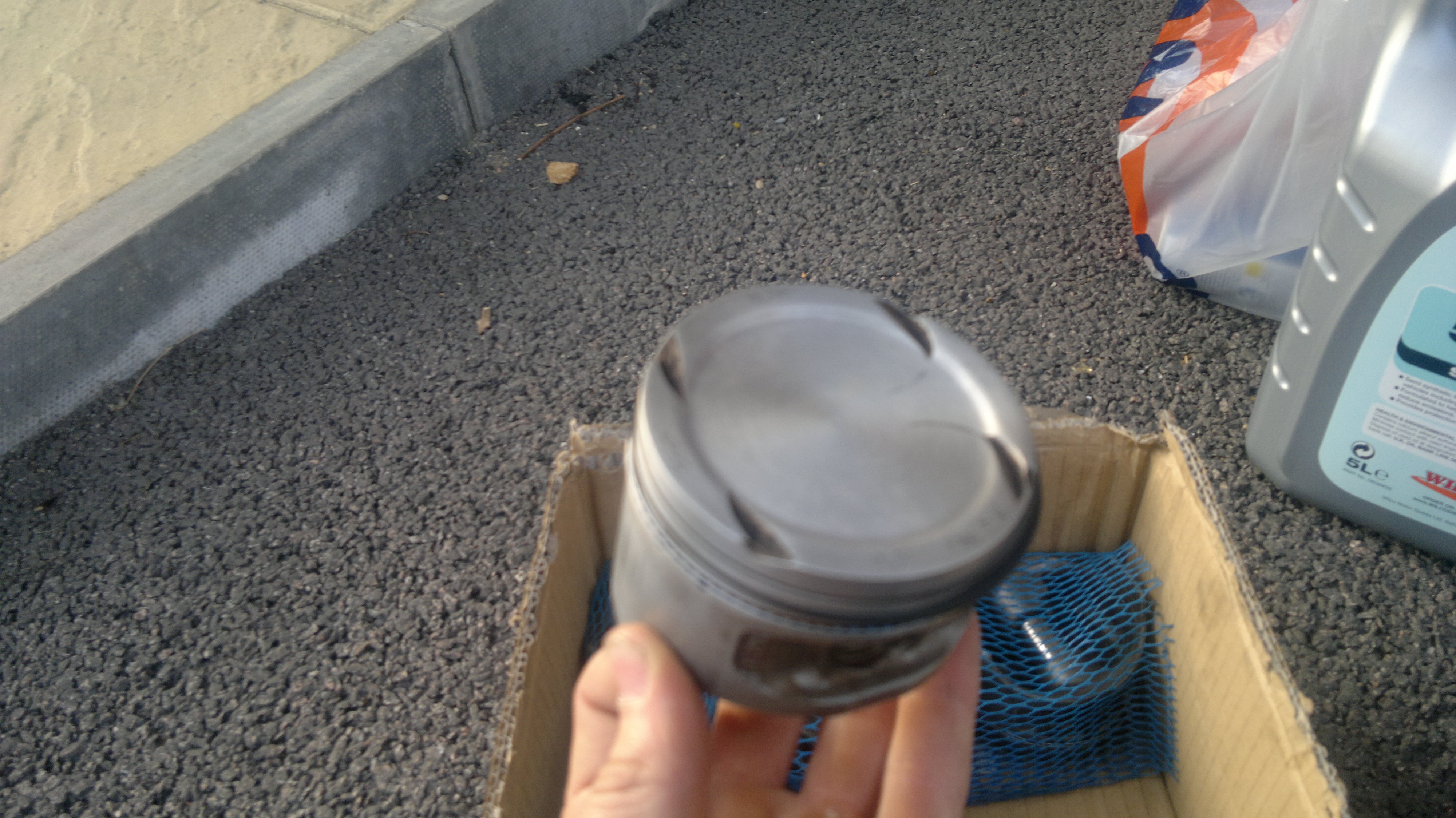

nah no new pics atm but it now has tax and mot :) just a pity the piston rings have gone on cylinders 1,2 and 4 and the compression is very varied i think 1 is getting 11.5, 2 is getting 12.5, 3 is getting 14 and 4 is getting 9 bar so after rebuilding the full top end of the engine i now have to strip the engine out and rebuild the bottom end too.

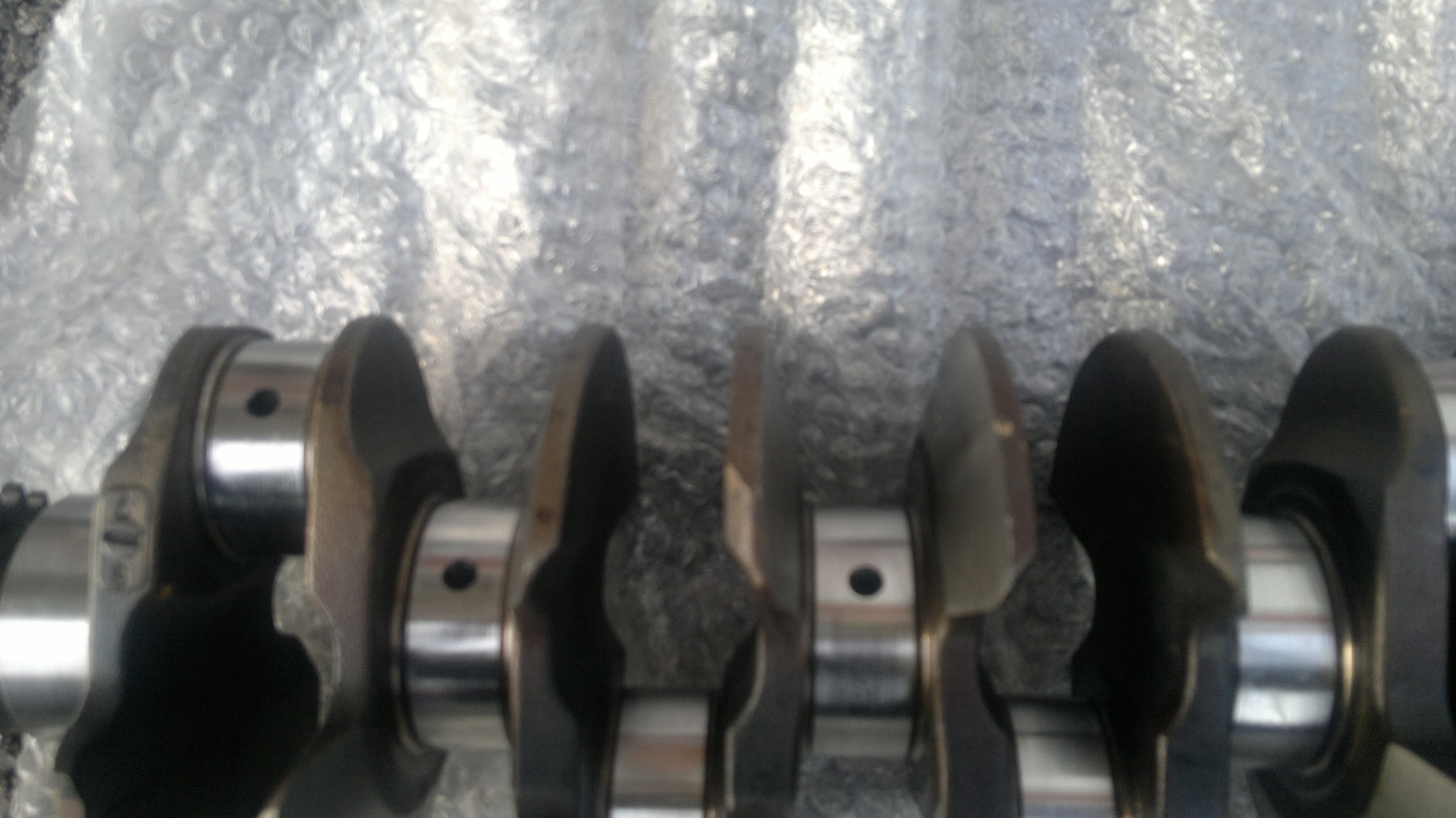

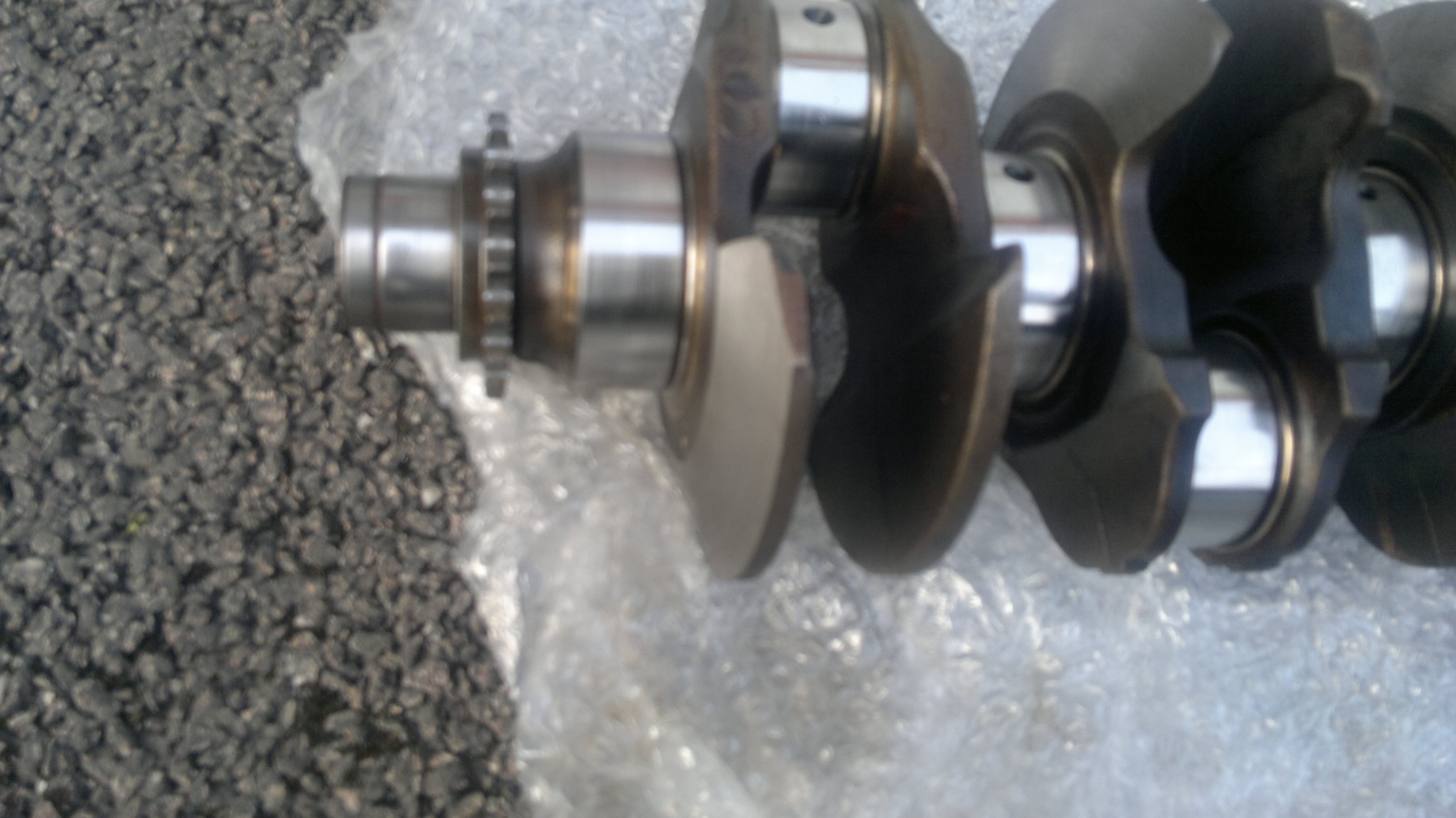

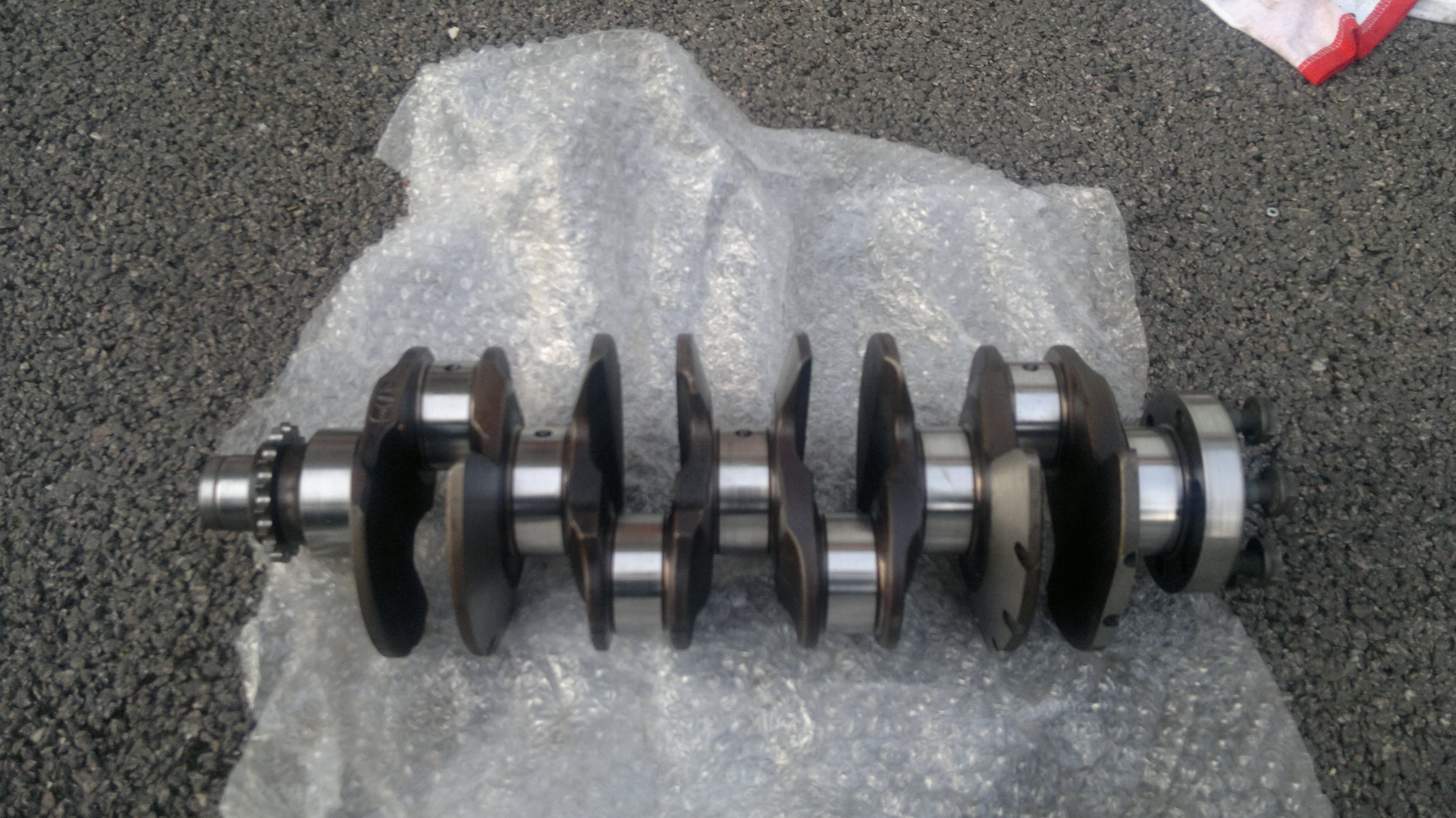

Thanks to mclovin i now have a spare afh block that is getting rebuilt, atm the crank is getting lightened, balanced and knife edged by a guy called HotGolf on the golfgti forum he is pretty amazing at this stuff and well known in the golf community for this and he also lightened and balanced my flywheel so i know what he can do and his prices are reasonable too.

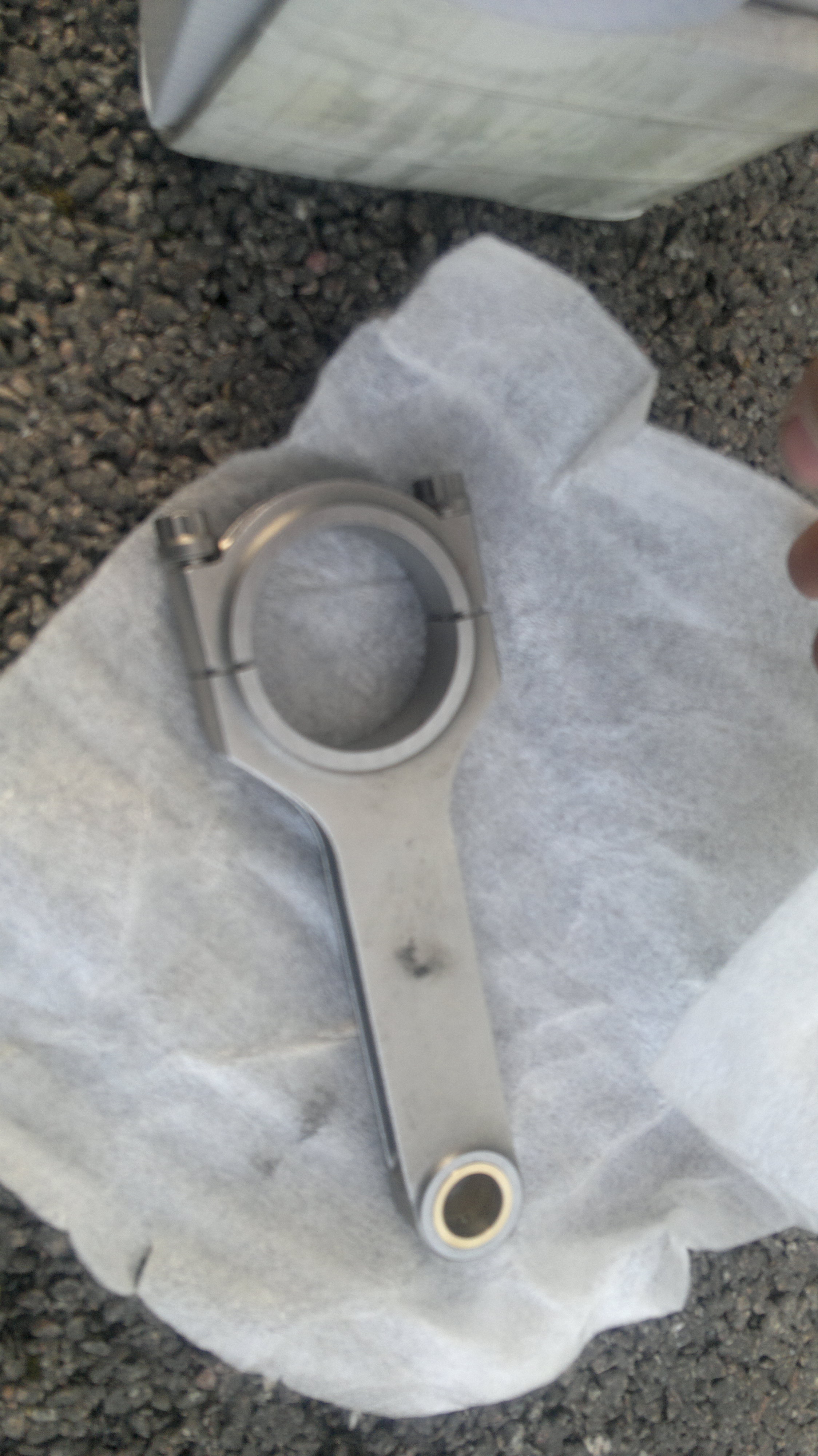

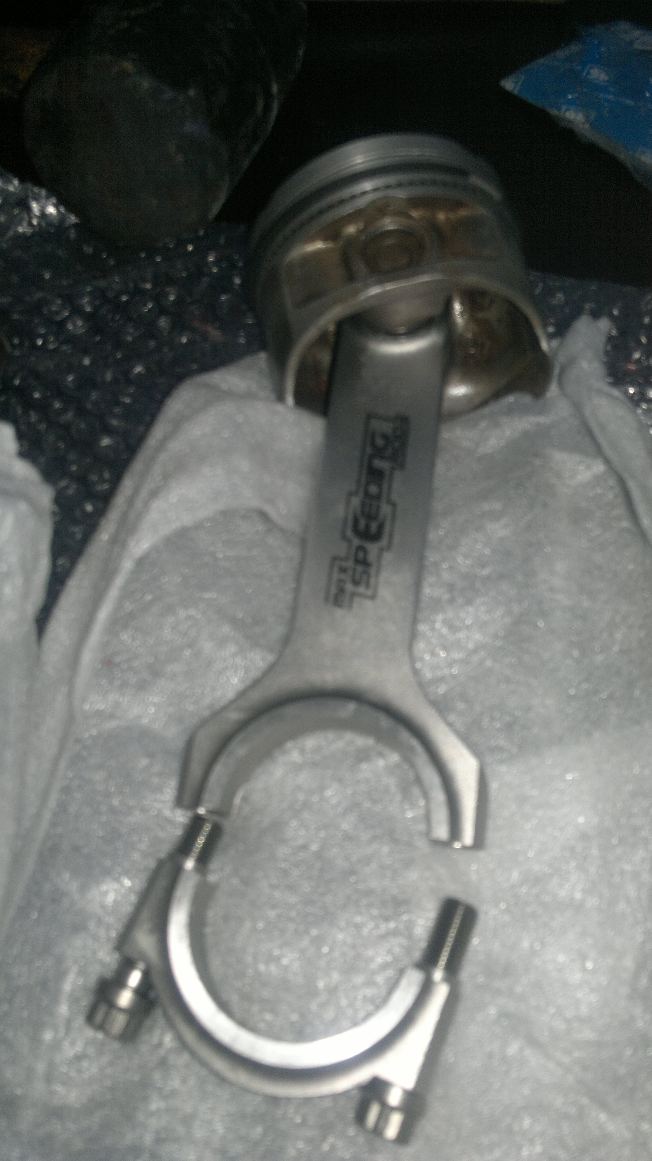

next I'm ordering 1.8 20v turbo forged H beam conrods as i might as well forge the bottom end while its being rebuilt save me hassle for next year when phase 3 engine plans start.
i did want forged pistons but the only company I've found so far that can do them will only make a minimum of 3 sets at a atime and i cant afford 3 sets only 1 so as the forged pistons are standard sizings just forged (due to the height being low at 28mm on them anyways)
you cant alter the compression ratio by dishing the pistons or lowering the height. You have to run a decomp plate to lower compression on the afh engines so means i wont have to change anything else in the bottom end next year to charge it.
so i am just going use standard pistons with new rings and the forged conrods as they are the weak part in these engines.
i will be rebushing the forged conrods to the smaller 17mm for the standard piston gudgeon pin at work.

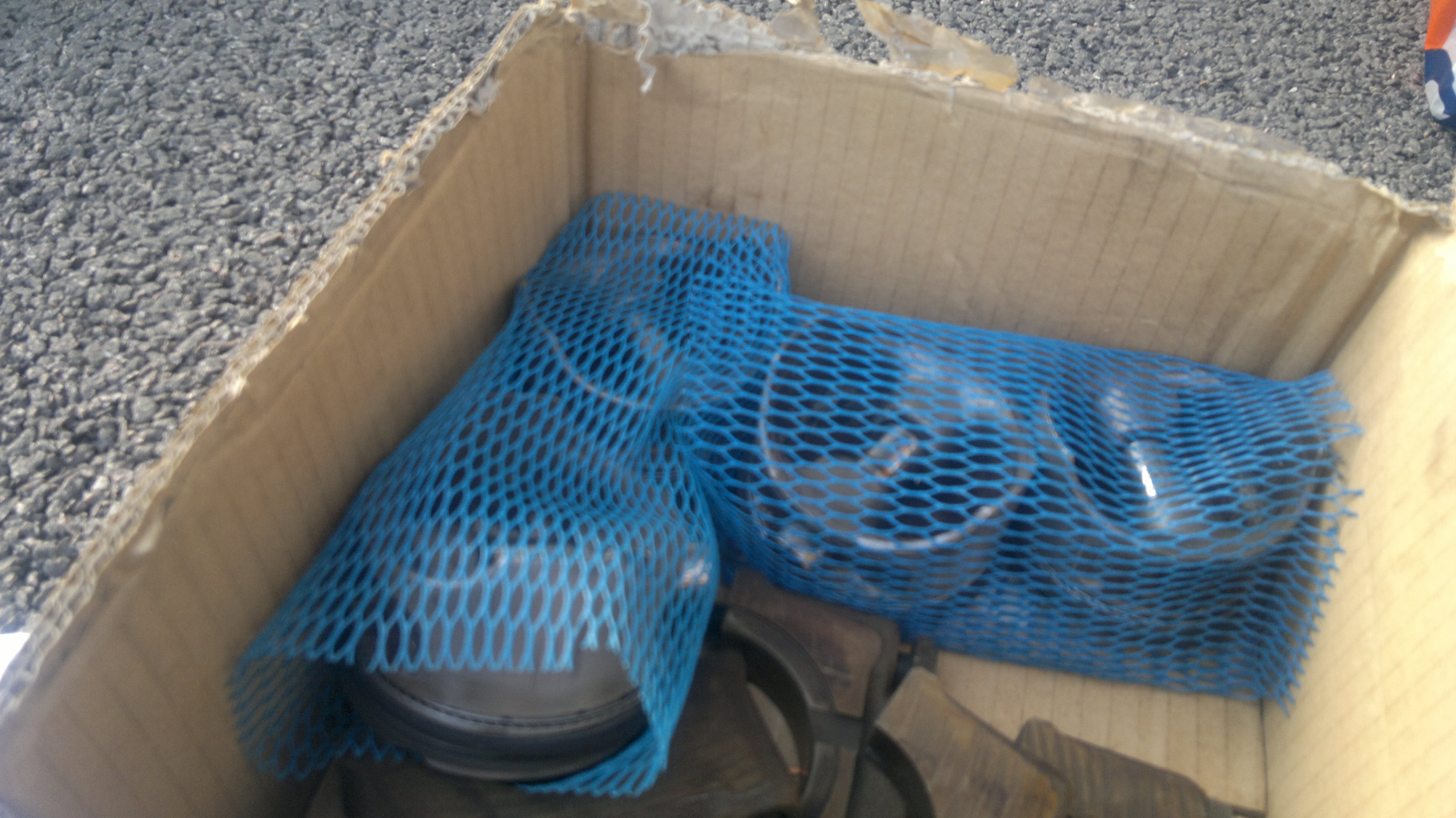

once the new rings have been bought for the pistons and fitted they will be taken with the spare block to get the bores honed for a nice tight new fit

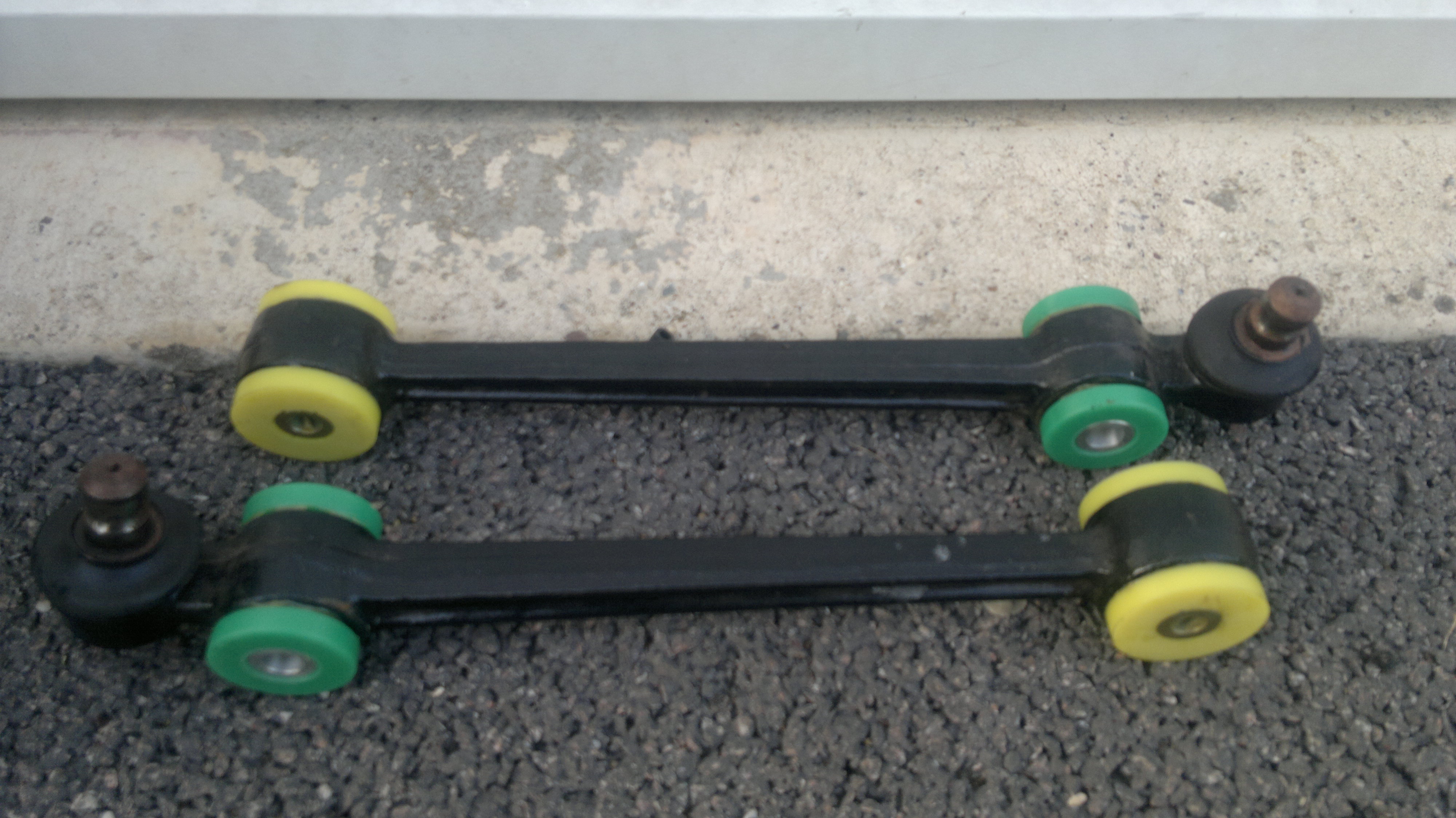

also going to be buying a stage 2 frame with outer g lader bushes and will fit the strongflex innner bushes at the same time.

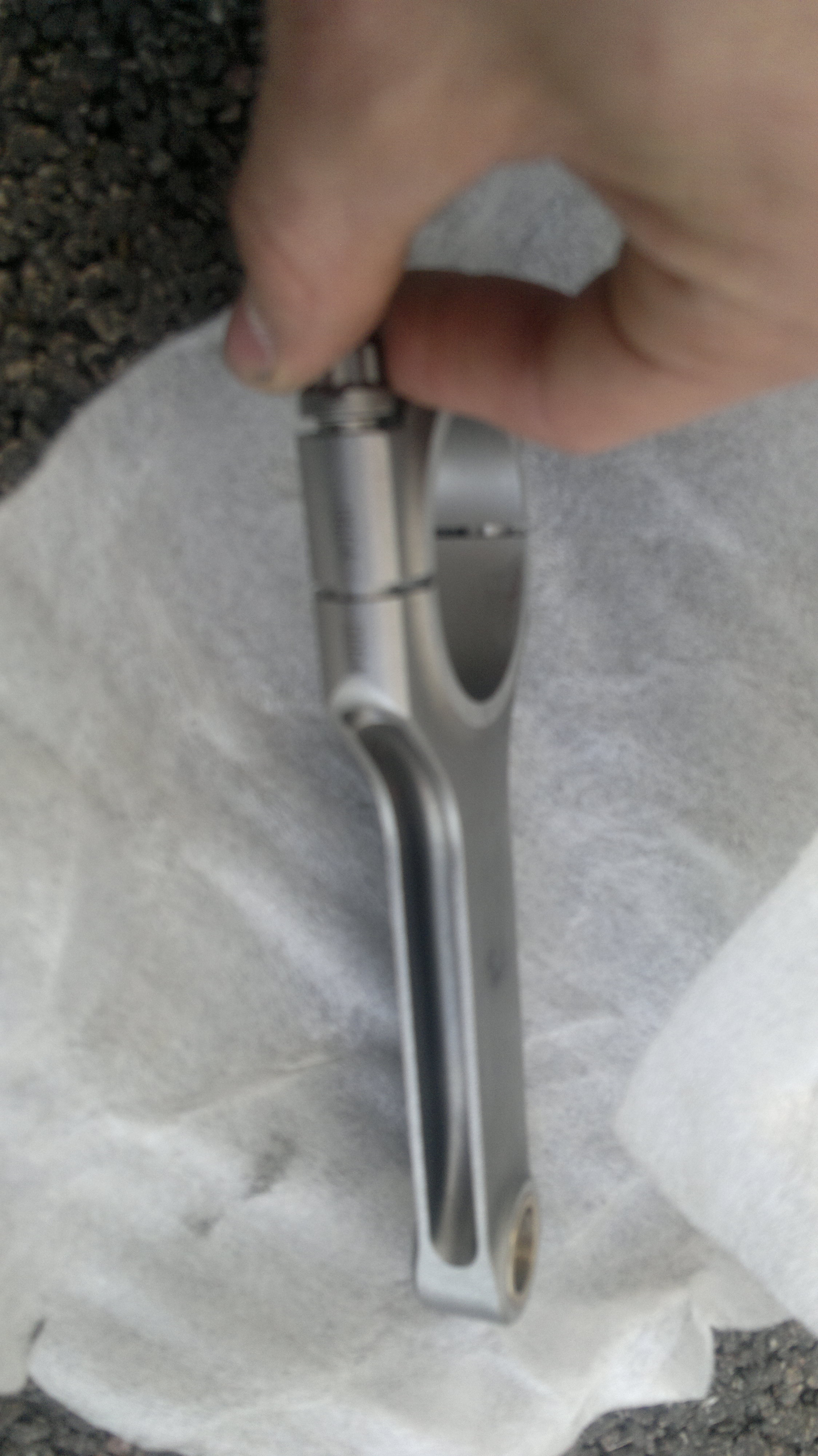

right this week at work got quite a few things done so far i have surface grinded all of my 1.8 20vt conrods on both sides to reduce the thickness from 25mm to 20mm so they will fit in my afh just need to make new small end bushings for these now and press them in then they are complete and can be fitted.
also got my knife edged lightened and balanced crank back very impressed as its had a kilo taken off weight wise and will slice through the air and oil in the engine easier using less power.

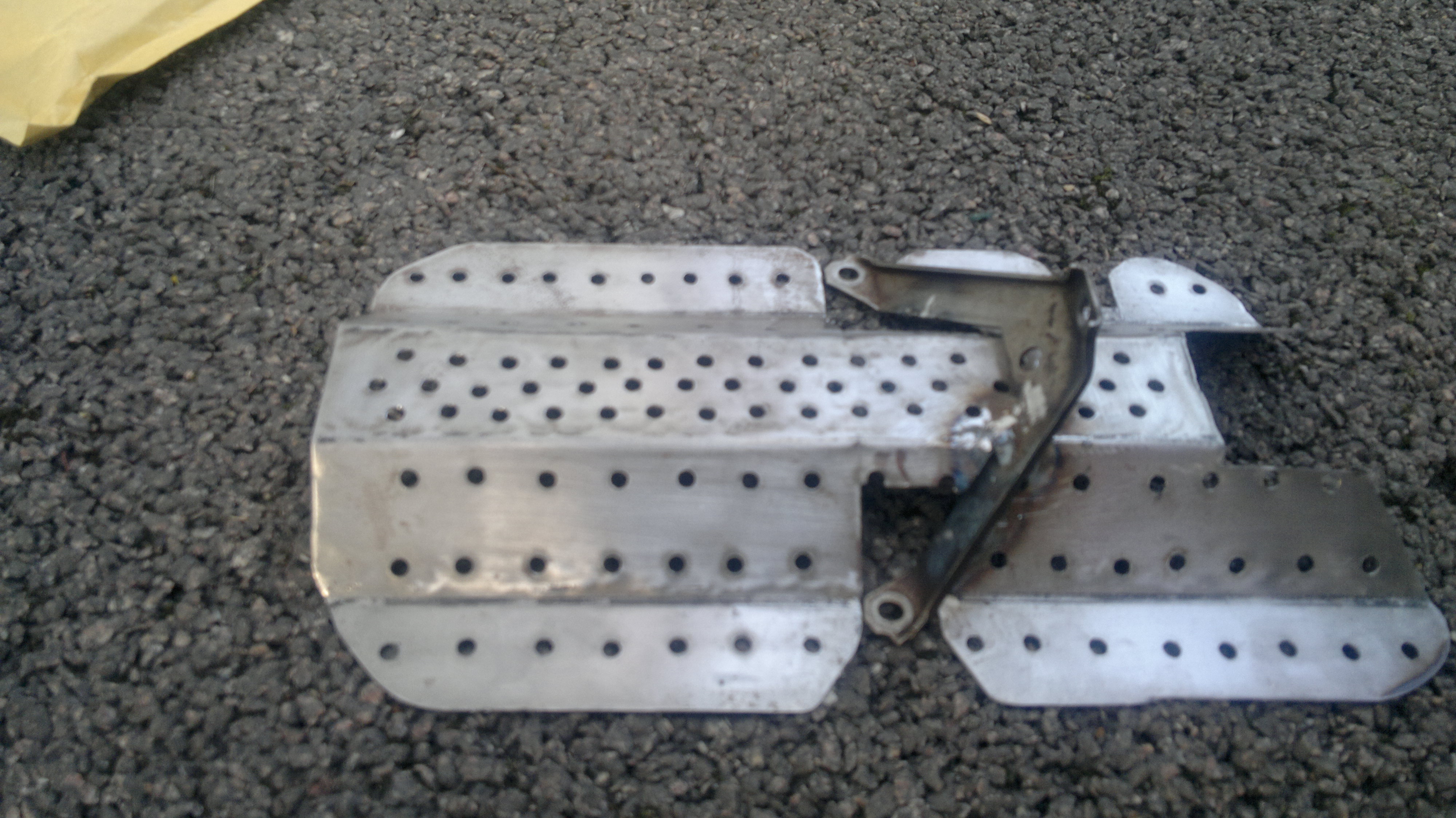

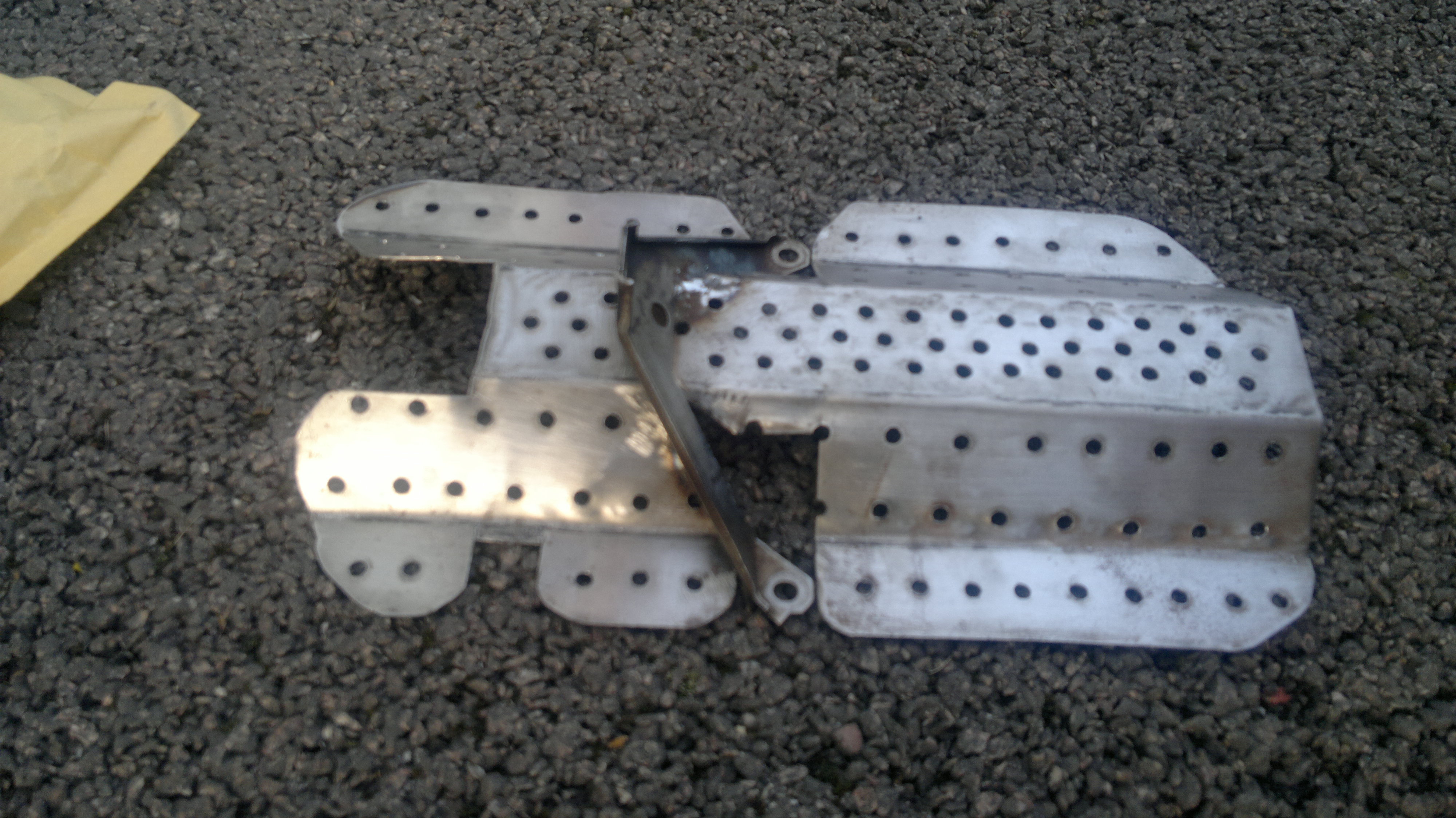

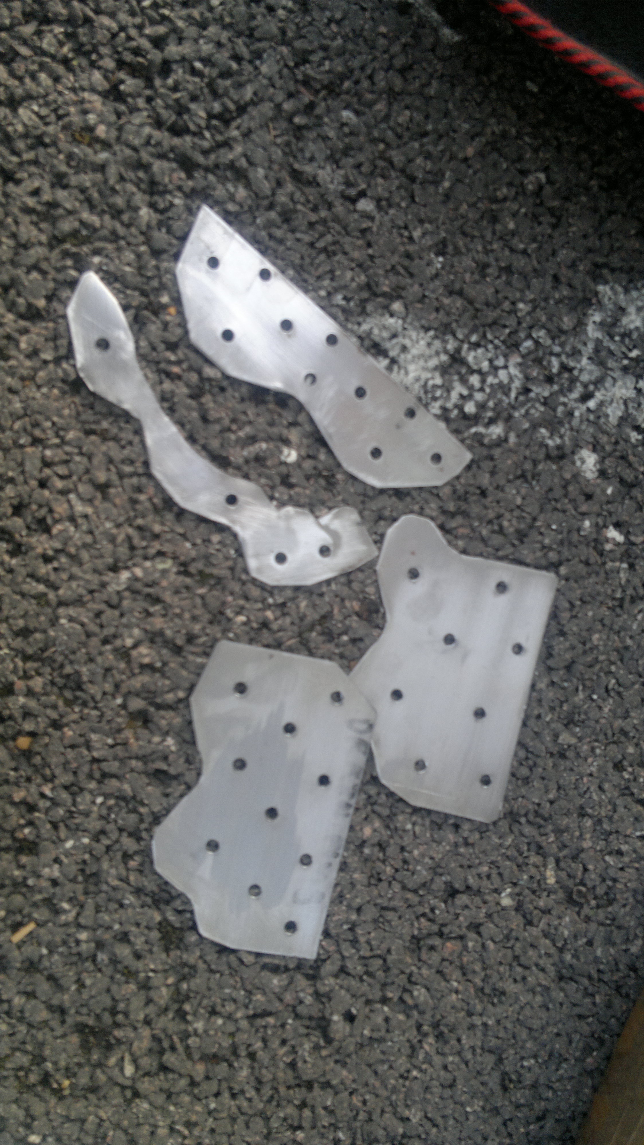

started to look at getting my sump baffled to help stop oil starvation beings I'm using the shallow sump on my afh but while i was looking into thhis i also found out about windage trays so investigated this and made my self one at work out of sheet metal and it fits lovely. pictures to come as i have done it a different way. i then made templates out of cardboard for the sump baffles using a spare sump as cant take mine off the car atm. i then guillotined these out of more sheet steel to size took me all of 20 mins if that i then added 5mm holes spaced out into them to make sure i still get oil flow just not oil surges. i have made it so they sort of box the oil pickup in to hopefully give it a constant supply of oil. Sort of stole the idea for this from skodaboy i believe so thanks.
still have templates too so may think about reproducing these or getting a batch load laser cut depends whether anyone is interested so that people can baffle their own sumps.

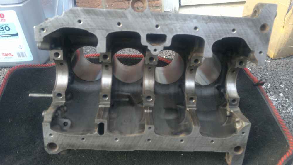

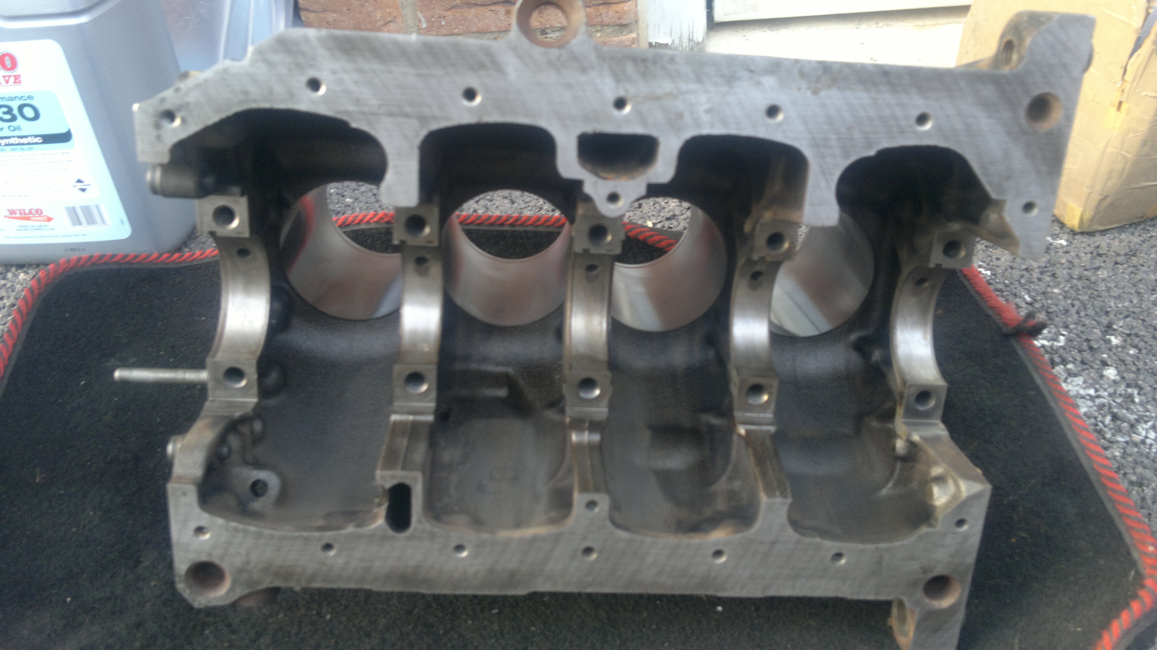

also cleaned the engine block so instead of it being black inside with oil deposits it is now a nice gold colour just waiting for it to be picked up by the engine rebuilders who are going to hone it for me and fit my new piston rings.

just need to buy some bronze now to make the bushings for the small ends for the 17mm gudgeon pins on the standard pistons.

Hey mate just had the engine collected for honing today and they are fitting the new piston rings. and there isnt much you can do to drop the piston size on these as they are quite thin walled at the top and my plan to drop the comp ratio is to use a decomp plate that i will design myself and get laser cut just need to work out the thickness of ally plate i will need to use but its not getting charged til next year atm as it will be going on throttle bodies and i will be using megasquirt i thinks to control fueling at the minute i just want the car back on the road getting bored of getting lifts.

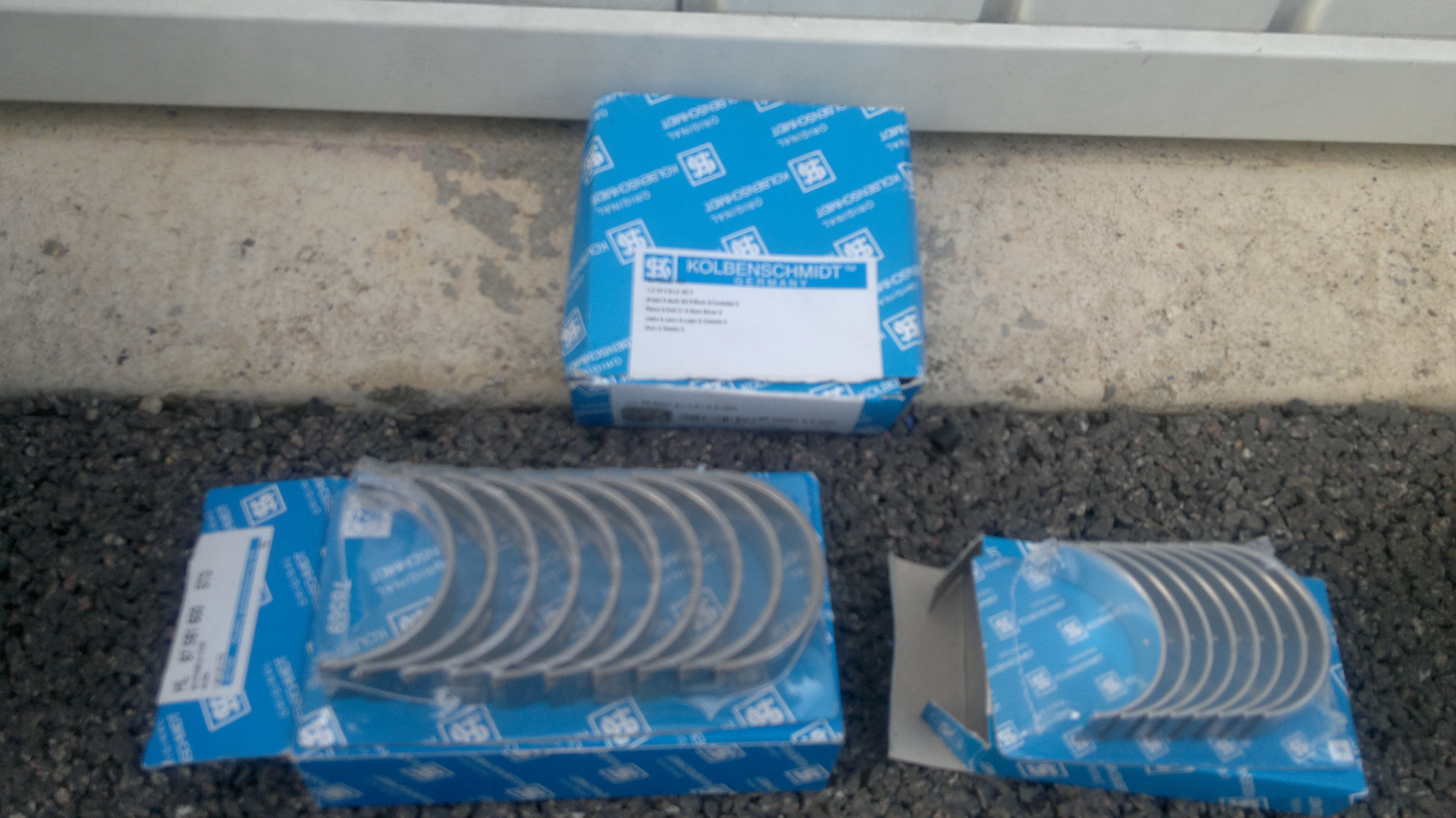

also getting the phosphor bronze bar tomorrow so i can get the new bushes made for the small ends of the conrod and am also picking up the new main crank bearings and thrust washers from gsf tomorrow sometime. so as soon as the block is back from honing i can get rebuilding it.

Fitted poly and nylon bushes to my tcas
got my engine block back from honing
and my new piston rings fitted to the pistons
fitted new conrods to pistons
fitted new main bearings and then fitted lightened, balanced and knife edged crank
fitted pistons into block and fitted new big end bearings
windage tray needs altering as didnt realise conrods rise higher than crank counterbalance weights so just a little tweeking needed
sump baffle plates ready for welding in once i get my good sump off old engine block
conrods attached to pistons gawd the little snap rings were a bitch to get in took me and my dad to do it working together

where did you get the conrods from? look proper built to take big power, id like some if they aint crazy expensive
i bought them from max speeding rods themselves for £275 they are for a 1.8 20vt vw engine and rated to 600bhp or 9000rpm with the standard arp bolts or for extra dollars you can get upgraded bolts that are 1000 bhp or 12000 rpm lol. The only bad thing is they get sent out from bloody china but if you ask them they will put a value off $40 on them so $10 a rod and then you only get charged like £14 quid income duty on them so all in £290 delivered and duty charged. which i think is a bargain then you just have to do the machining which to you kiz would be a pisece of piss. But my afh shgould be ready for a bar of boost when i turbo it next year and add a decomp plate and vernier pulleys to drop the cr ratio. and going to rolling road this afternoon to get it started setting up and dyno'd.
