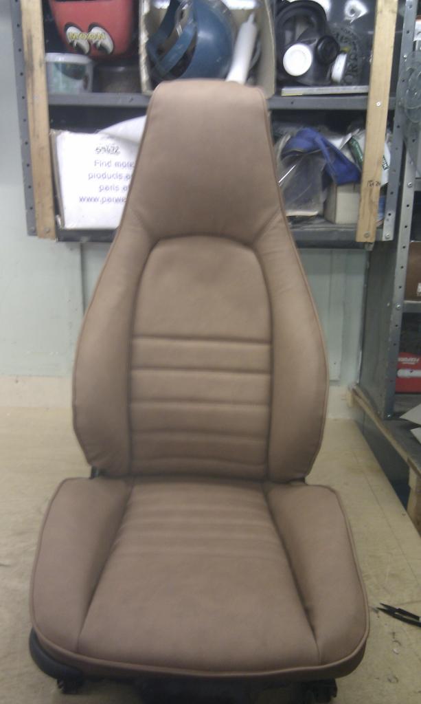

the road trip has taken a bit of a detour. did a couple thousand miles round new england (massacheussets, maine, vermont, new hampshire), a jaunt to NYC then drove another couple thousand from boston to miami in one of those RVs that's a big as a house (no shit). decided to dip our toes into yachting for a bit and have ended up today being offered jobs in the caribbean. so my projects will have to wait a bit longer till i get back to them. a shame as i've got my freshly reupholstered tombstones and modded rear seat to go into the bready.

Wow, sounds like your having a great time. To let you know though we're having unseasonally good weather here, 30oC at least :wink: Seats look lovely mate
