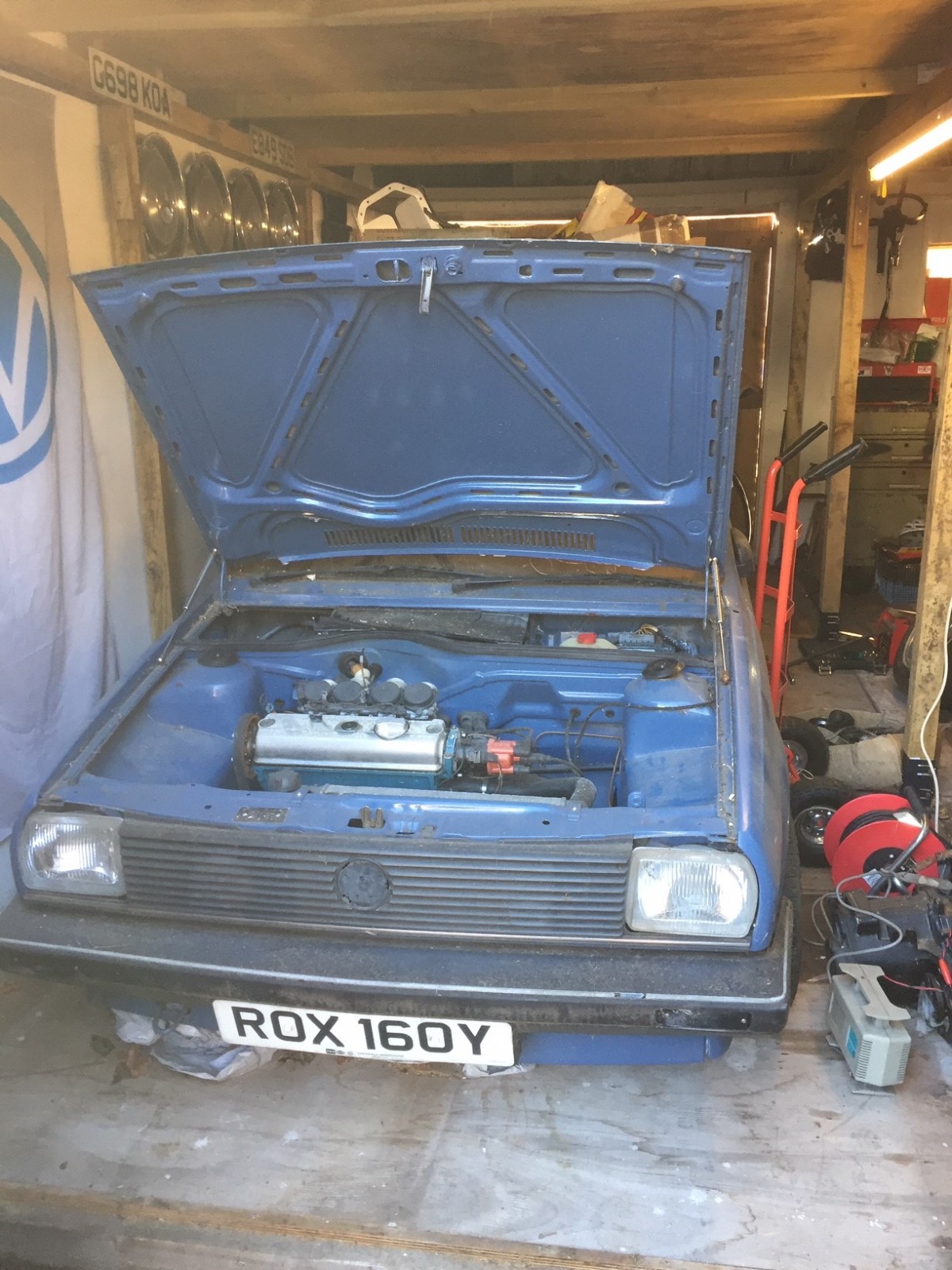

This weekend's goal was to pull the old engine (that's done less than 100 miles since rebuild :-( )...
Then dropped the new one in...
The more eagle eyed of you will notice this is a bit of a bastard engine. It's an HH (mechanical lifter) head mated to an ABD bottom end. The fuel rail and inlet are from a GT, the injectors from a G60 and the TB is from an NZ. This is now all in place to have a turbo manifold mocked up. Once the manifold and turbo pipework is all in place it'll go off to the sprayers to have a proper respray. More updates over the coming weeks

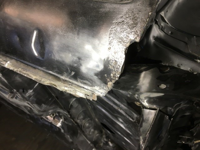

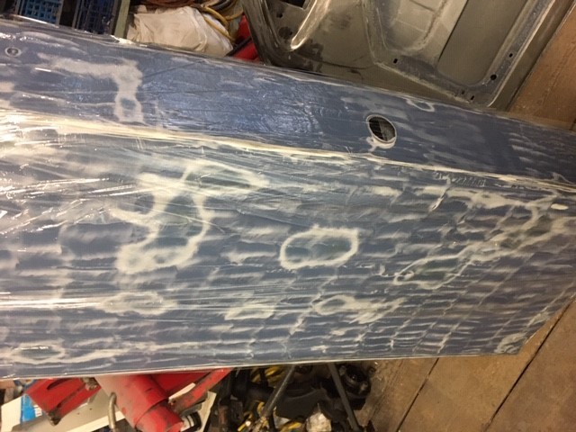

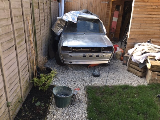

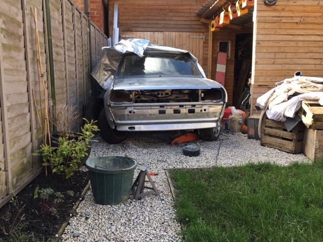

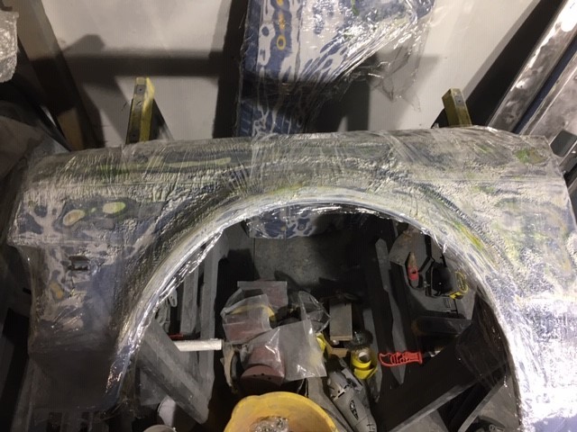

The new year has been a busy one for me prepping the car to get a professional paint job. Originally it was intended I would just rough the existing paint enough to take a new coat, but in so many places, especially the engine bay, it was decided it would be best to go to bare metal. Bearing in mind this is going to be a panel-off respray, the work load was huge, especially inside the bonnet and boot as they are so complicated. Nearly there with only half the roof and drivers rear quarter/sill to complete. Deadline was this week but having been made redundant, that's now on hold. I'm beginning to think this car was never meant to be finished!
Weapons of choice are strip wheels for the angle grinder, a 3M abrasive drill wheel (which is excellent, if pricey at nearly £100!), various wire brushes and patience. A hot air gun was used to remove the stone chip in the wheel arches (will be replaced) and I tried some paint stripper on the panels but I had mixed results. All will be gone over with 240 on the DA prior to delivery for paint.

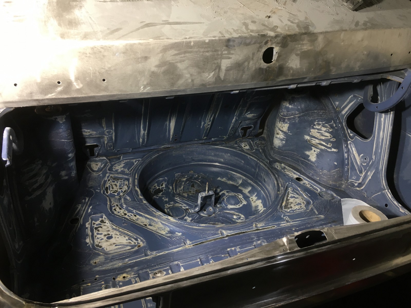

Having found out I’ve lost my job, the spray job has been put on hold (was supposed to be in this week). However, the upside is I have longer to prep the car which means I can get bits I wasn’t going to do done. So the first is the boot area. Although condition wasn’t bad, there were a few scrapes and scratches. I intended originally to carpet the area but now I’m going to get it sprayed. Next I’ll do the scuttle area. Only need rubbing back to 240 and the results doesn’t need to be perfect. There’s plenty of seam sealer in the area that if it’s not totally glossy, it won’t be all that noticeable.

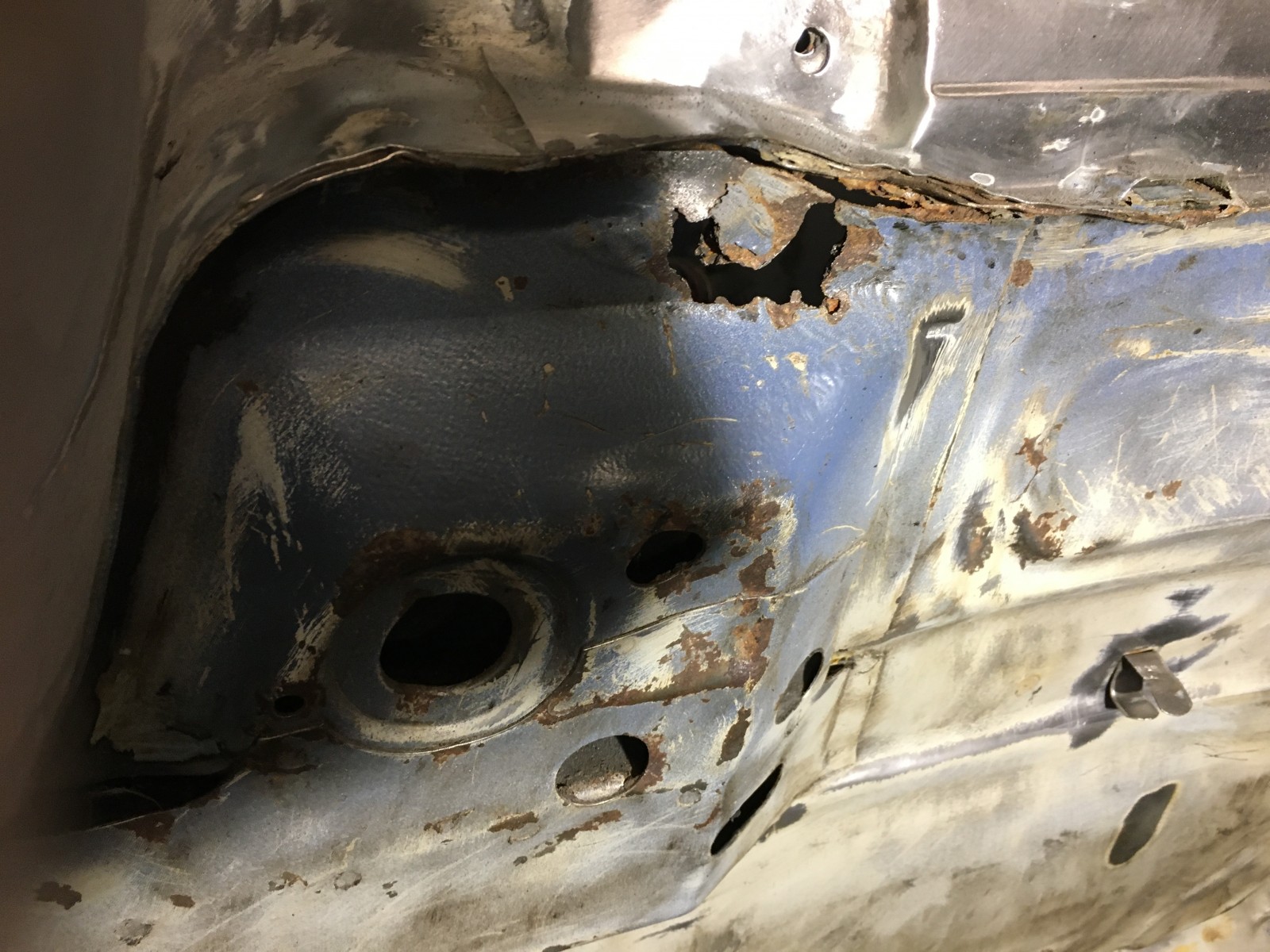

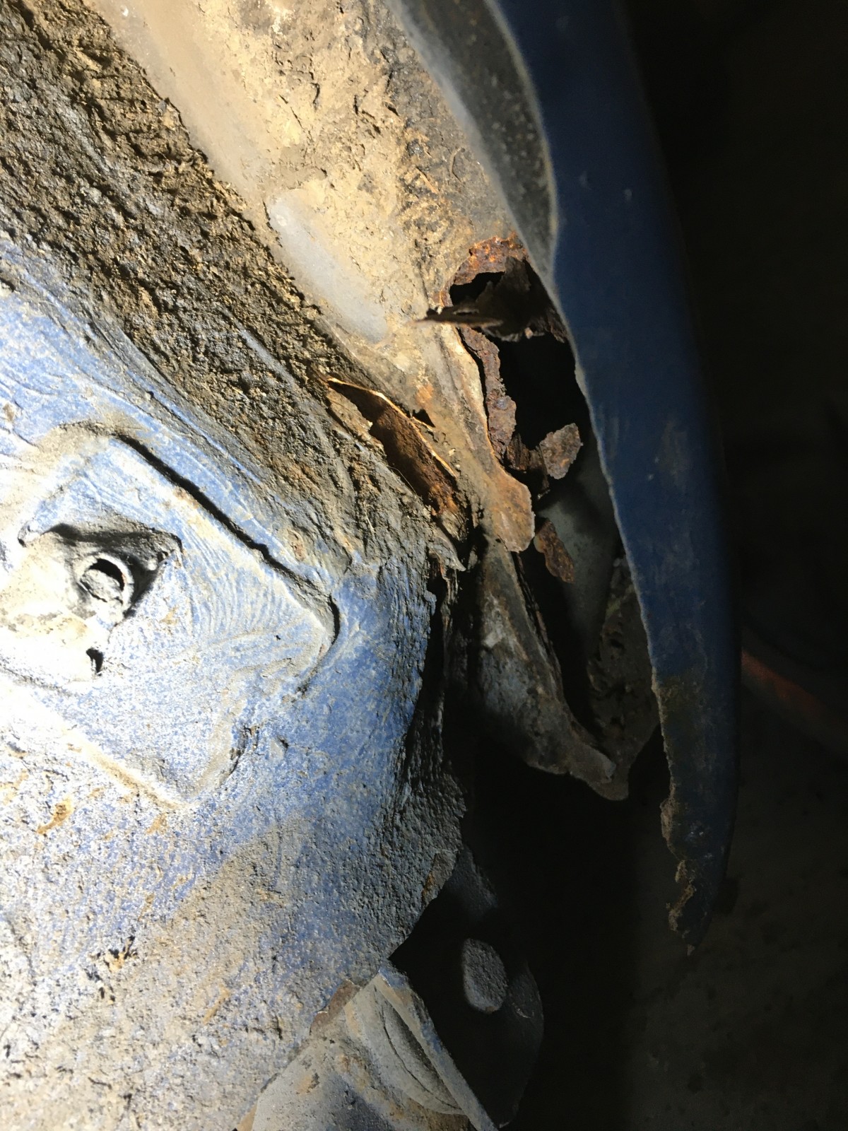

Today’s job was to get the fuel
tank out. It’s an old, smaller type so fingers crossed it was in good condition. Luckily it was. I think it’s been replaced in the past but luckily it’s a VAG one so fitment it spot on. Never done one before and I didn’t know there were so many pipes. The big bore one attached to the neck alluded me and when I found it someone had used a jubilee clip which typically had rusted solid! Anyway, all out now. Unfortunately found this lurking behind. Always thought I had a pretty rust free shell :-( shouldn’t be too hard to sort out for a professional.

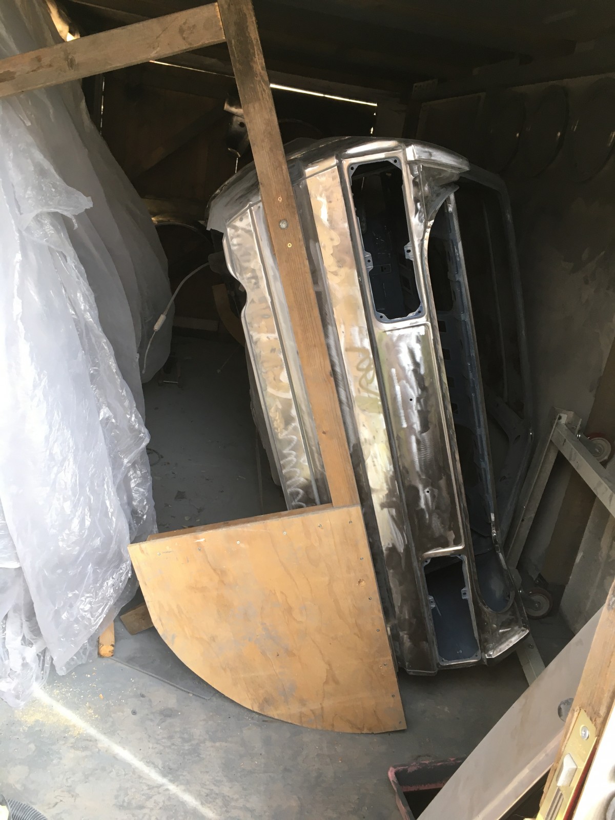

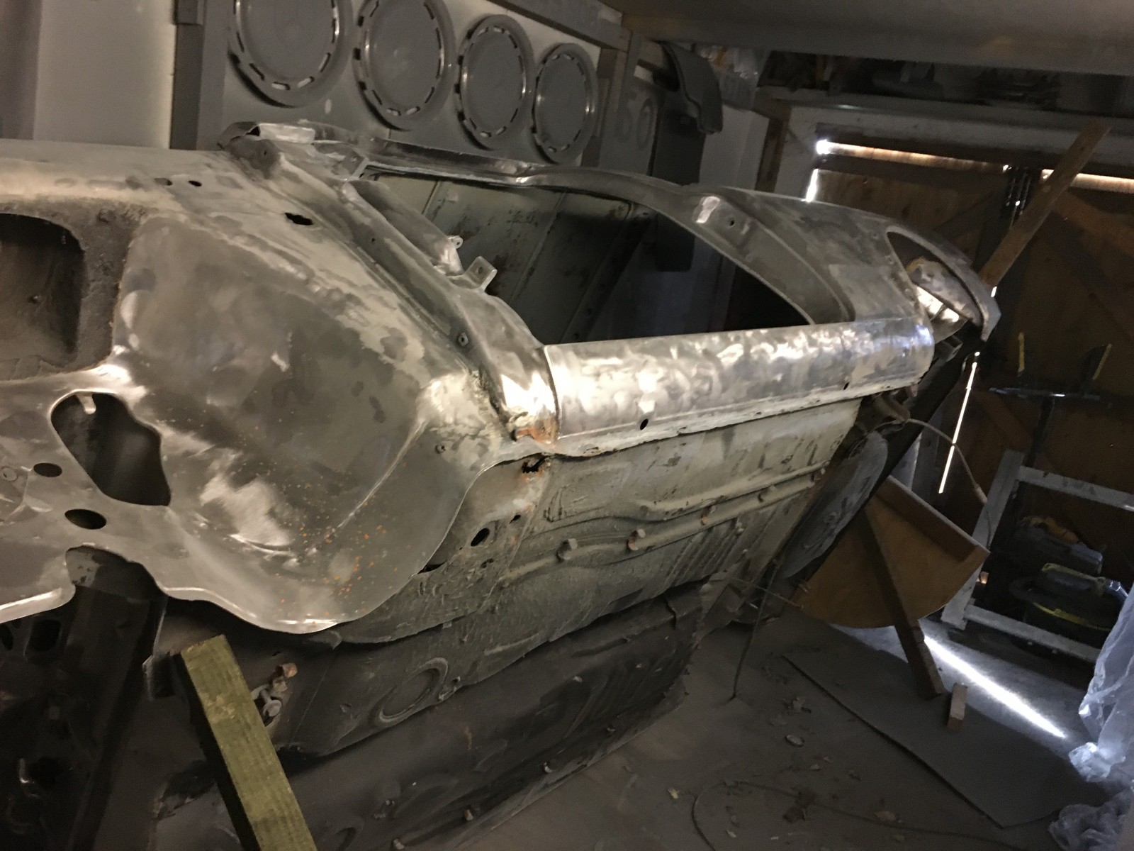

With a bit of time on my hands and no prospect of getting the car to the spray shop any time soon (not to mention finding a ew job!) things have moved up a notch. I didn’t originally intend to do the underneath or strip the car to bare metal but since there’s not much else I can do until the car is out of the garage and being painted I thought I may as well flip it over and take a look. There were some suspected holes in the floor and it’s been welded before. I didn’t have the funds for a ‘proper’ jig at £300-ish and since it’s only going to be used once, I figured I’d make one. A little search on the internet provided a description for a mk1 golf item so I recreated it. Simple as it’s only 2 25” radius quarter circles and some 2x4. Easy. It does sway a little when ‘flat’ but on its edge it’s rock solid. Now to get to work stripping the bottom back. Seems there’s only the one hole I originally feared so should be very little additional welding

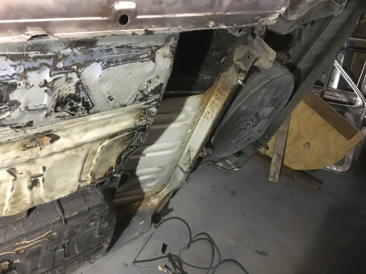

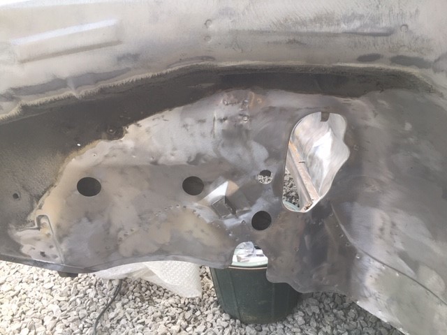

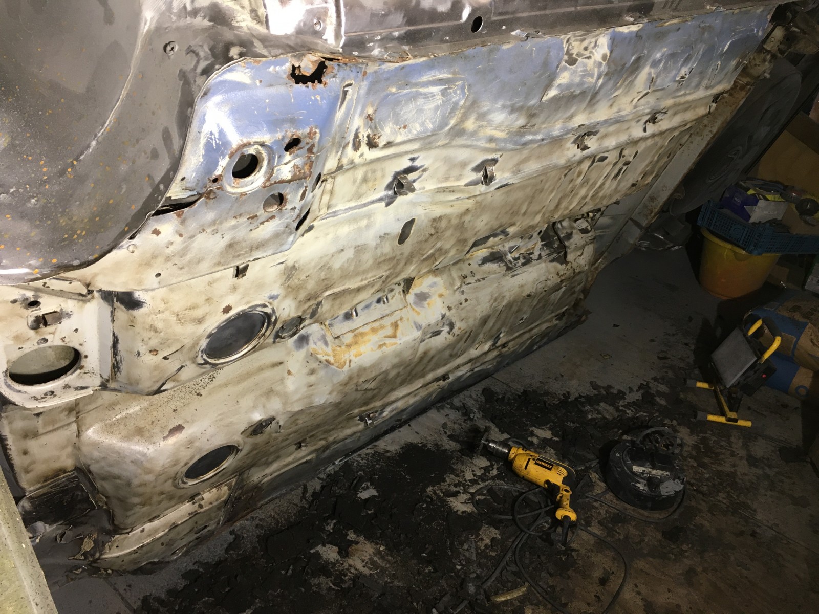

Started stripping the bottom after rolling it over. Years ago, with no consideration of painting the underneath, I painted the floor with waxoil. Brilliant for protection, total
bastard to strip off. It doesn’t really cure and instead sets a bit like a wax (clue’s in the name). Using a strip wheel or wire wheel just makes a mess, so I’m down to stripping most off with a scraper, petrol on a rag to wipe away most of what’s left, them a wire wheel 😅 good job I’ve got time on my hands  🖐 🕰 🤚

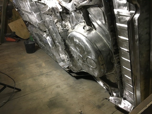

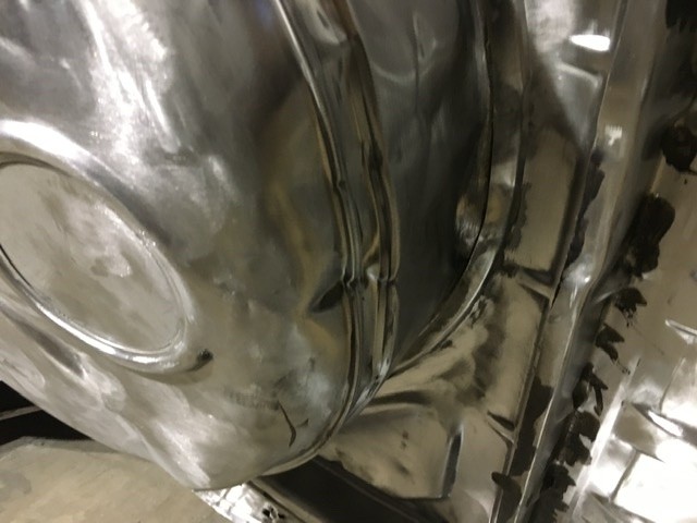

After trying to scrape the waxoil off I found a good old wire wheel works well. Managed to get about half the floor done today. Still need to do around the spare wheel well which has lots of seam sealer and under the boot then strip all the paint off to have it fully bare metal. Should have it done before the end of the weekend

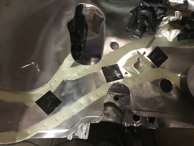

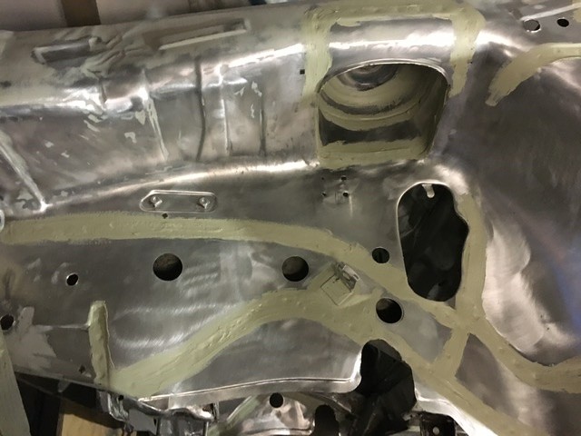

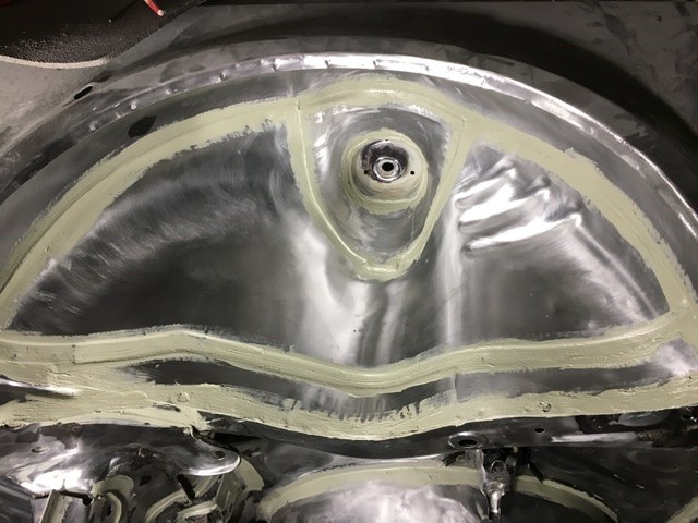

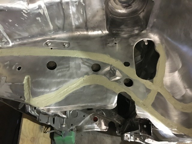

 Floor fully stripped, cleaned and seam sealer added around the seams. Some nasty rust hiding in some areas but not terminal. All remaining rust treated with kurust

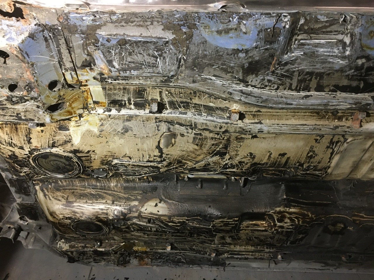

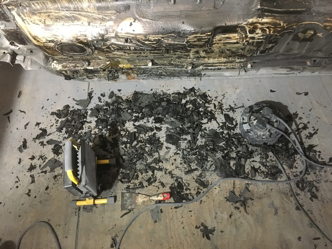

More time spent on This over the last week. Since I’m putting in new sound deadening, I’ve taken up the old bitumen pads from the factory. Hot air gun to melt most of not off, wire wheel for any remaining chunks, petrol to remove the residue then final going over with thinners.
