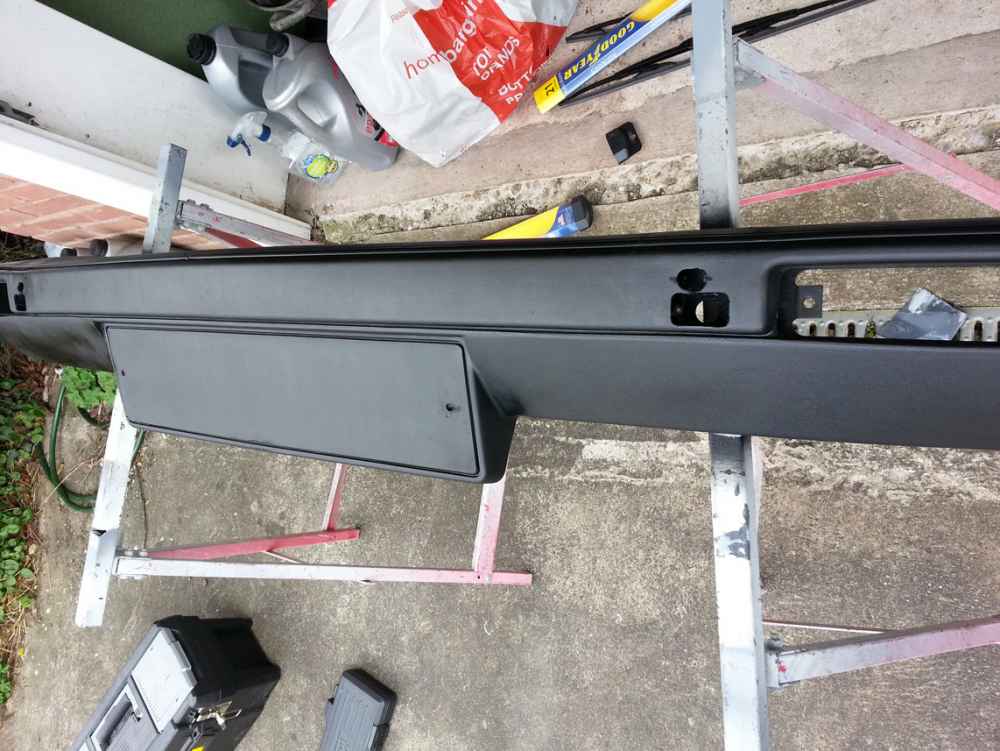

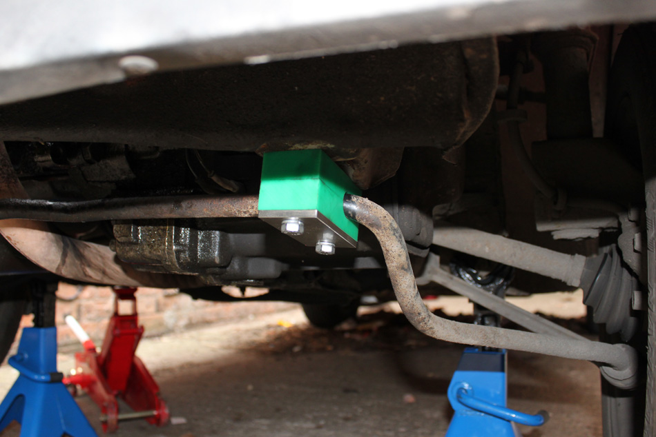

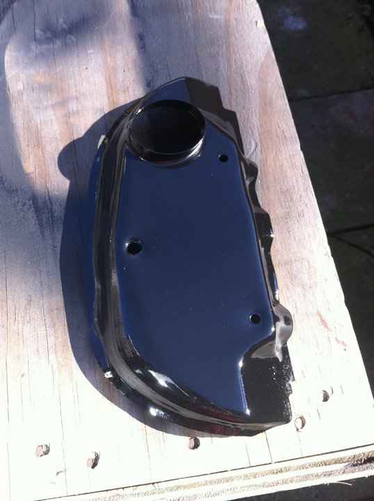

Took the ARB bushes off yesterday and fitted the nylon blocks which me and my friend found a fucking ball ache to do haha ! but they are on there :D got bored too so took the heat plate off smoothed it down and sprayed it black , debating whether to get a strut brace for car , need some new brake discs too and goodridge brake line which i will probably order today :D as I'm at home chilling in the sun ! . hopefully in a month or two will get more work done on performance of car , Stainless 4 Branch as well gettint the cam and carbs on too , !

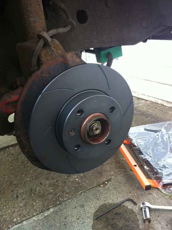

got these on and have also put some black diamond discs on the car ,

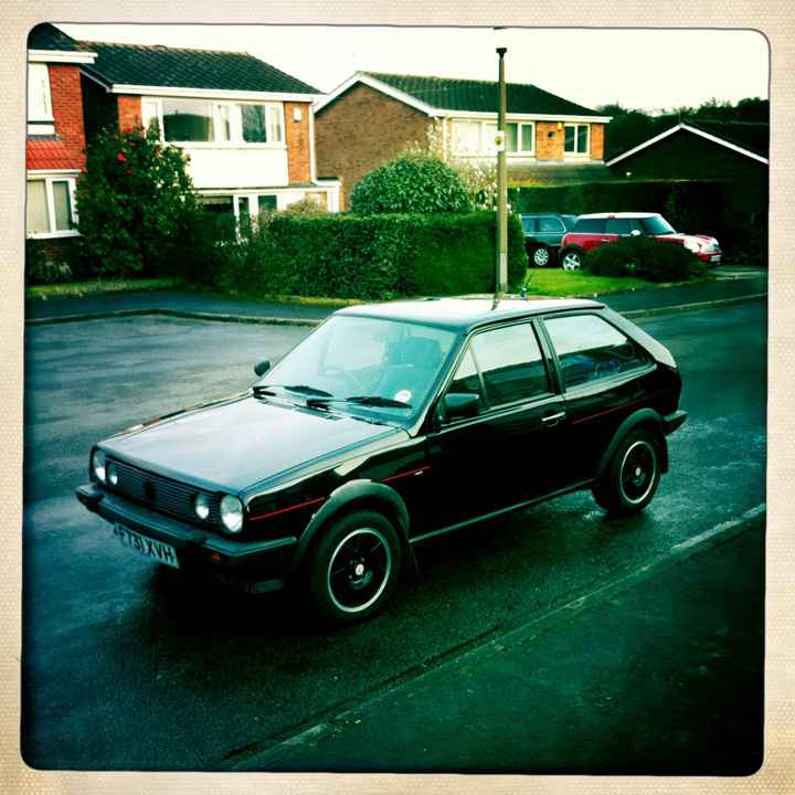

i have also taken the rubber strips off the side too and i am going to remove the red lines and having the paint work all buffed up and made shiny , not sure whether to put some new red tape back on or not , but we will see , :D
Keep it up. I'm quite a fan of the red stripe. Breaks up the black of the wheels and bodywork nicely IMO.

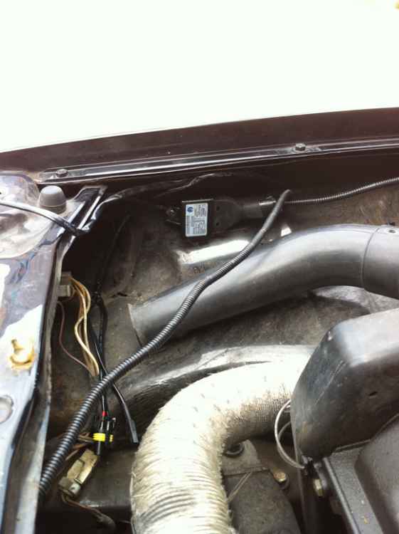

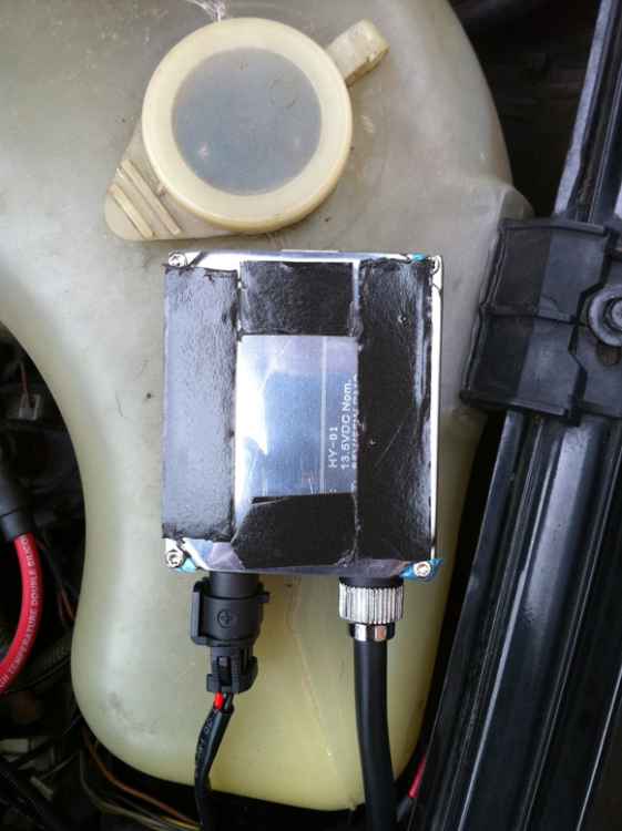

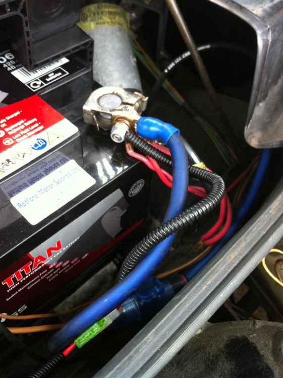

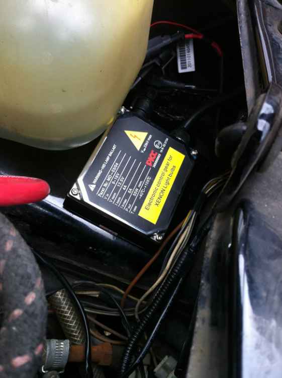

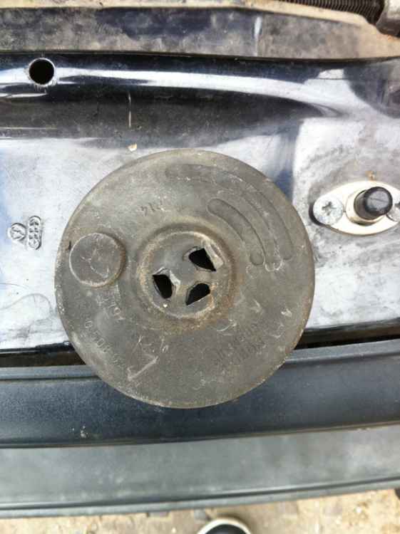

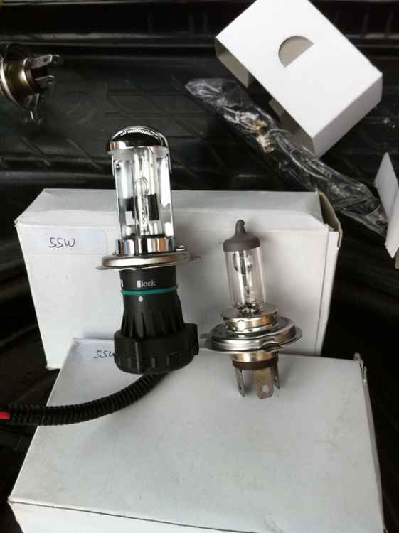

Decided to sort the lights out the other day and installed a HID kit ,
heres a few pics of what i did , ,
Original Bulb and the New one :D
bit of a difference there , !
Hooked upto the battery onto the positive side
ran it under to make it nice and snug
then drilled a hole in the body and screwed her down with the earth cable to earth it

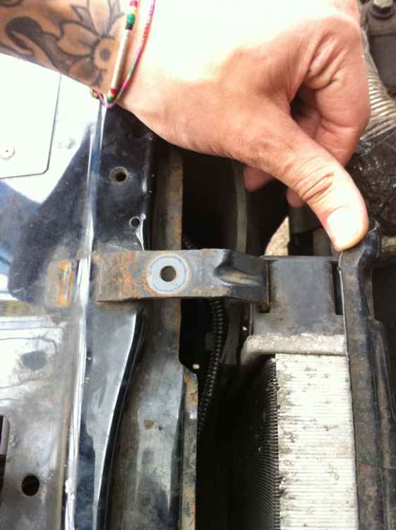

pulled radiator forward and ran cable through to keep it tidy
Had to modify the bulb rubbers though as it wouldnt go over the cables and the new bulb , so just cut the middle out :D
cleaned up the body and stuck some double sided tape on the back and stuck them down

Where did you get yours disks from dude?
they are Black Diamond Front 6 Groove Discs and i think they were about £65-70 and i got them from http://www.motorsportworld.co.uk/

You've put your ARB blocks on the wrong way around. The ARB should be further forward,not further back.
Keeping it like this will make the steering lifeless,increase leverage on the mounts and give arch clearance problems on ramps or lowering.
cool beans dude ! thanks for that :) i will change them around at the weekend as they are coming off for an hour or so ,

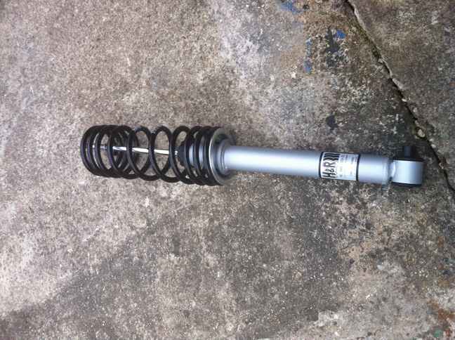

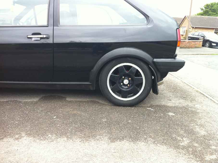

also ordered some H&R Cup suspension which is Front: 60mm , Rear: 40mm , which i have put the rears on and hopefully doing the fronts this weekend ,
which the result is .
, , lots more mods and things to come soon too :D

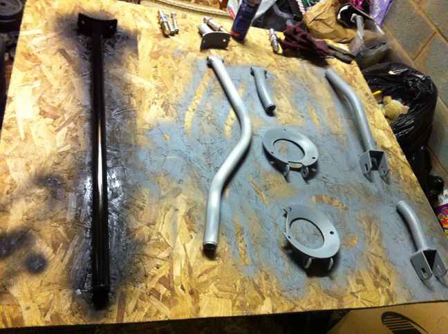

bought some strut braces which i have sprayed up black , started off taking my time and making them all nice and what not . then just got fed up haha and slapped some clear laq over top and left them be ,, might tidy them up at some point but for now they will do lol this is mid way through ,,

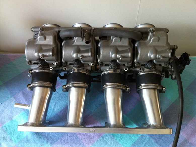

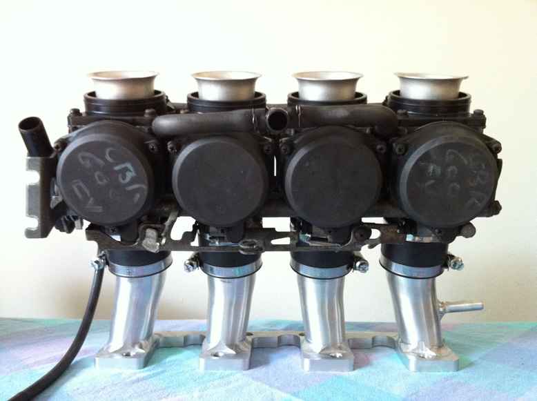

Also sent my bike carbs off to Bogg Bros to have them cleaned and rejetted with a manifold too . which came back today , :D
which i will hopefully get them put on and running soon :D

only managed to get front suspension done on sunday , they are a ball ache ! second set I've done now and i haver no idea why VW make it so hard for you especially compared to a mk2 golf of the same year , also hopefully getting the windows tinted next week which will make him look sweet :D

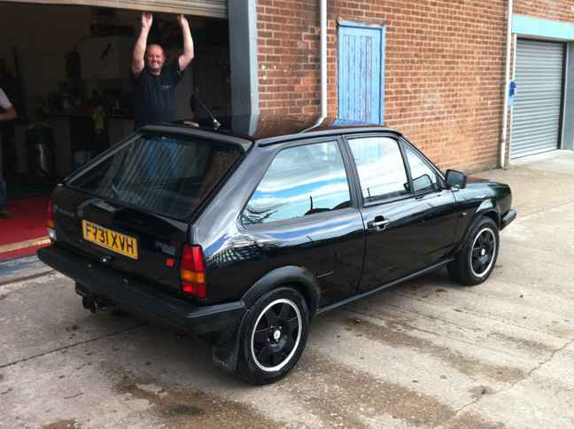

here is the result of the windows being tinted , which i think makes a big difference ,

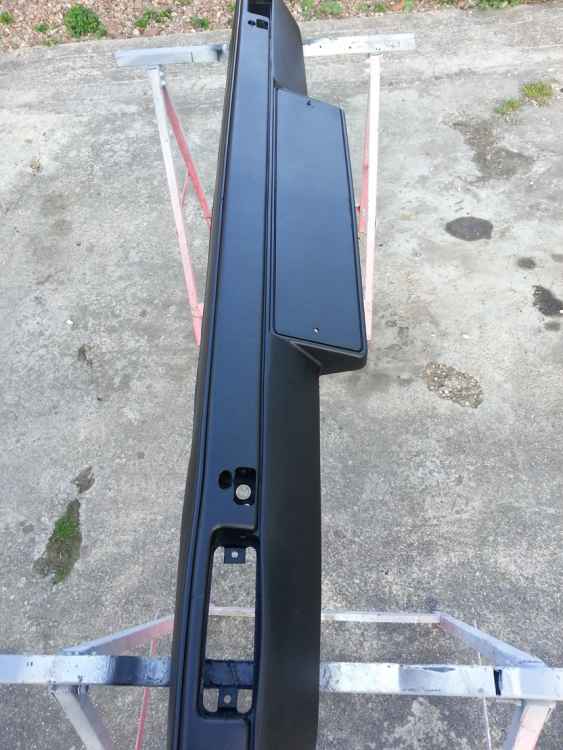

hopefully doing the bike carbs and cam this weekend , wanting to get the bumpers csprayed up too starting to look a little ratty and dull :( . also on the way to sorting out the arches which need a little tender loving care !
