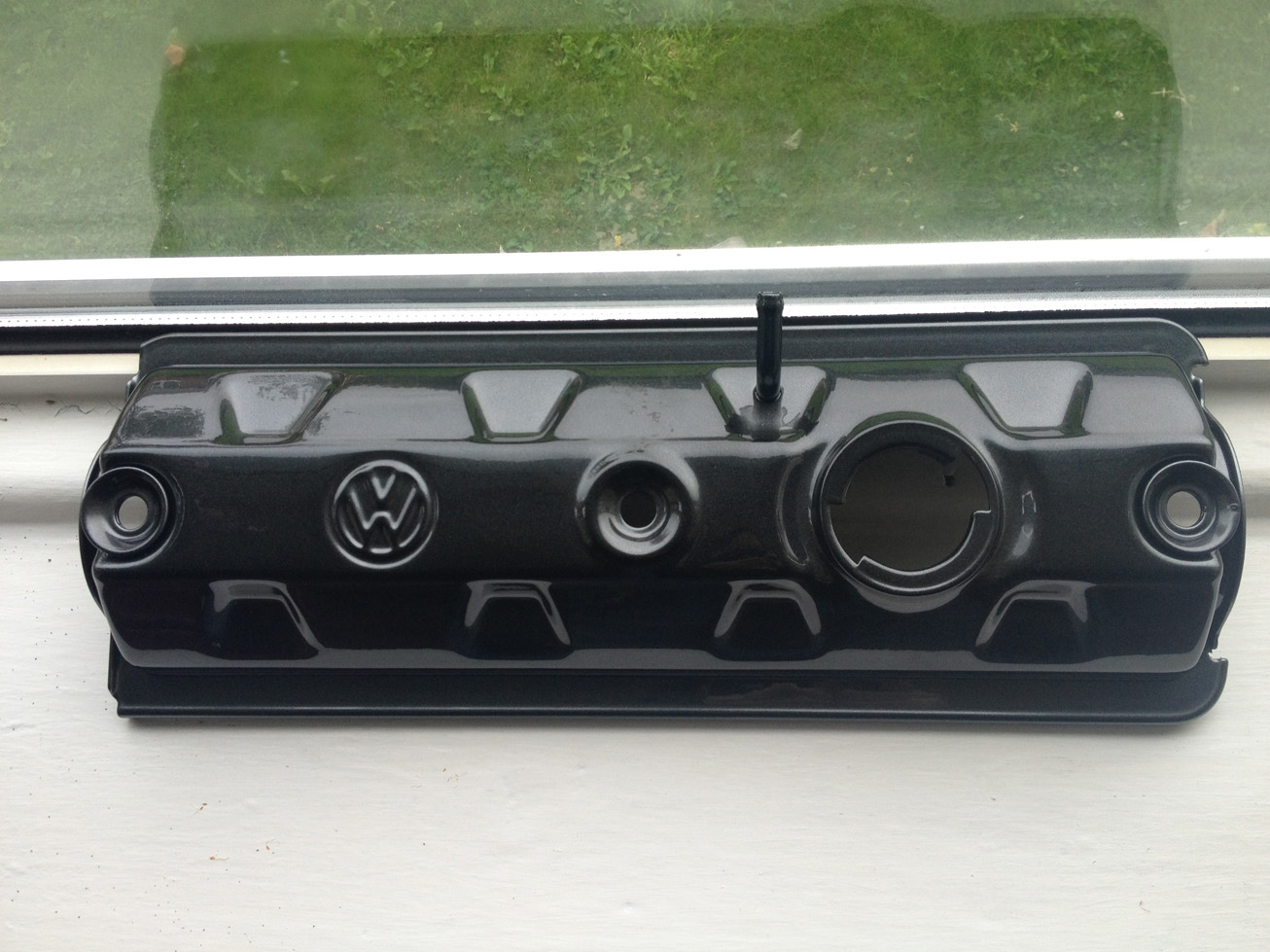

not really much more news on anything , not really done a great deal of anything lol . was bored though and had these lying around so had them painted up

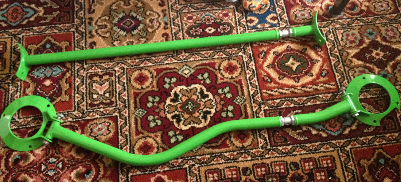

This looks promising - i've spotted the deliberate mistake with the front upper brace though..
shifty eyes haha , what mistake ? hah ,.:(
The fact the bend is round the wrong way haha
Is that just its been put together Wrong ? Or is it wrong ? :( lol
Just been put together wrong.
It just wants the curve flipping over the other way to follow the curvature of the bulkhead :-).
thank god hahah , guess the painter man did that heehe ,. cool cool :D

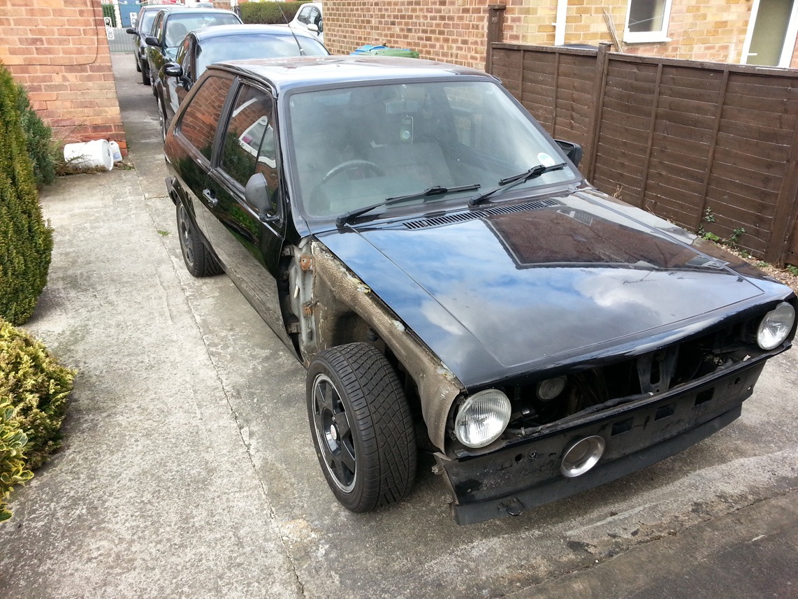

done a little more to this lately

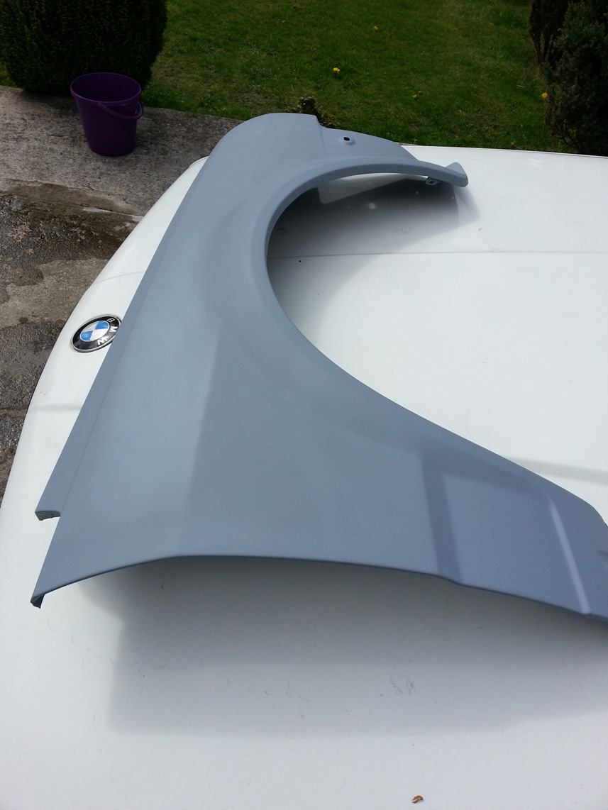

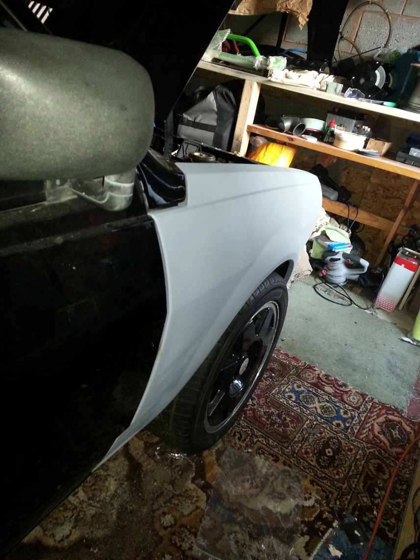

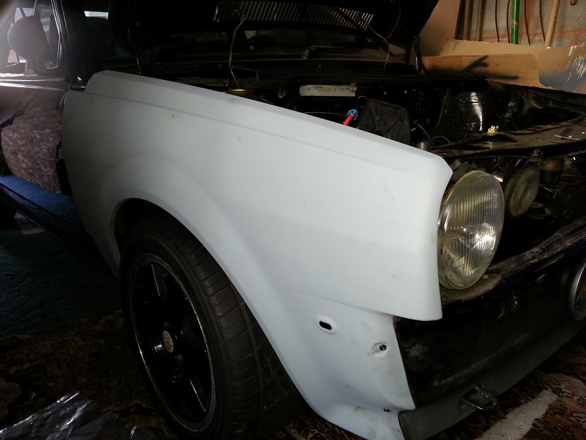

removed both wings of each side in prep to put the new ones on !!
prepped up one of the wings so far and fitted it onto the car ,, needs a little fiddling but looks better than the old sharp mess that was there before ! ! !

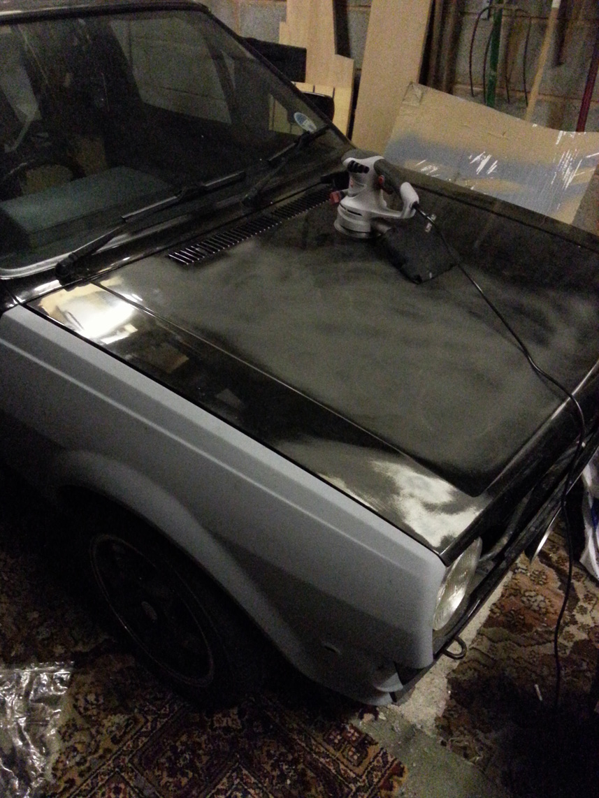

started sanding down the paint too to get ready for a full respray in a mystery colour hehehe :D

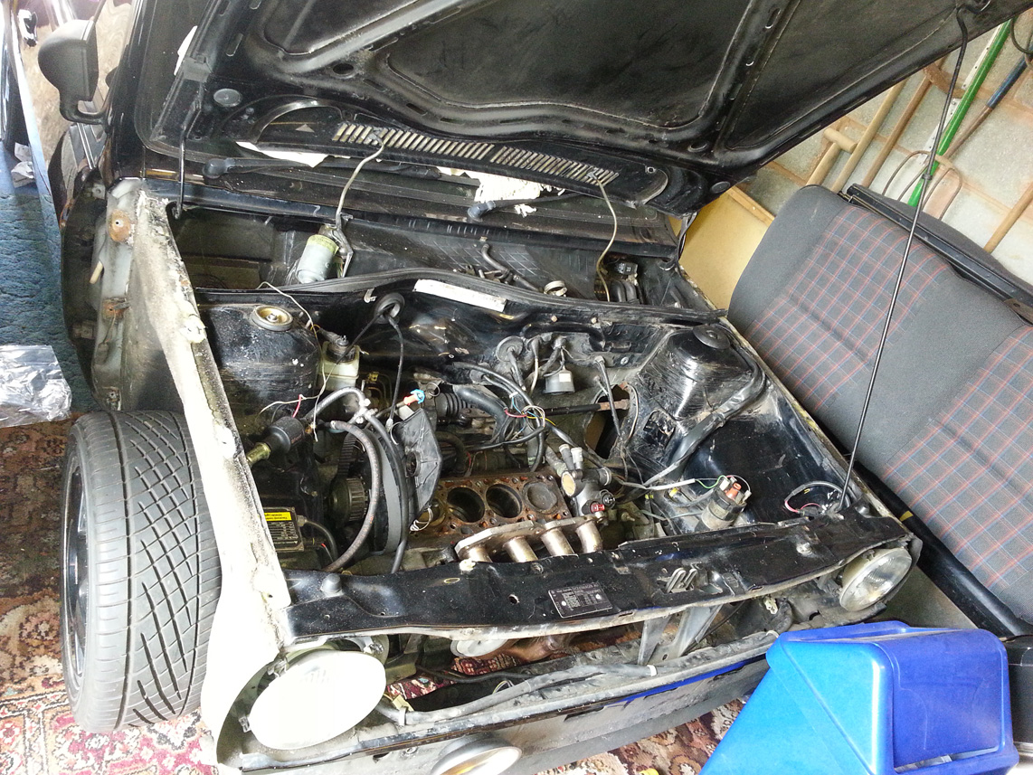

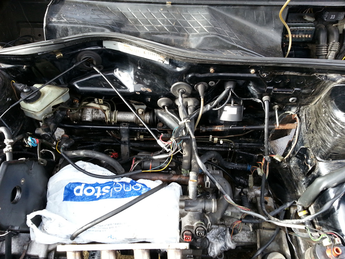

gave the engine bay a clean out to get rid of some of the old grease and muck and illegal immigrants hiding out in there

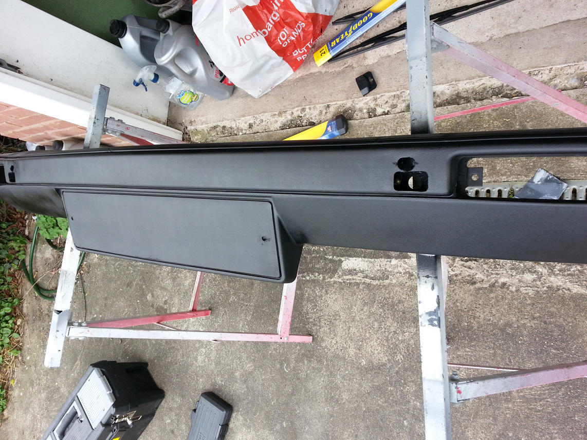

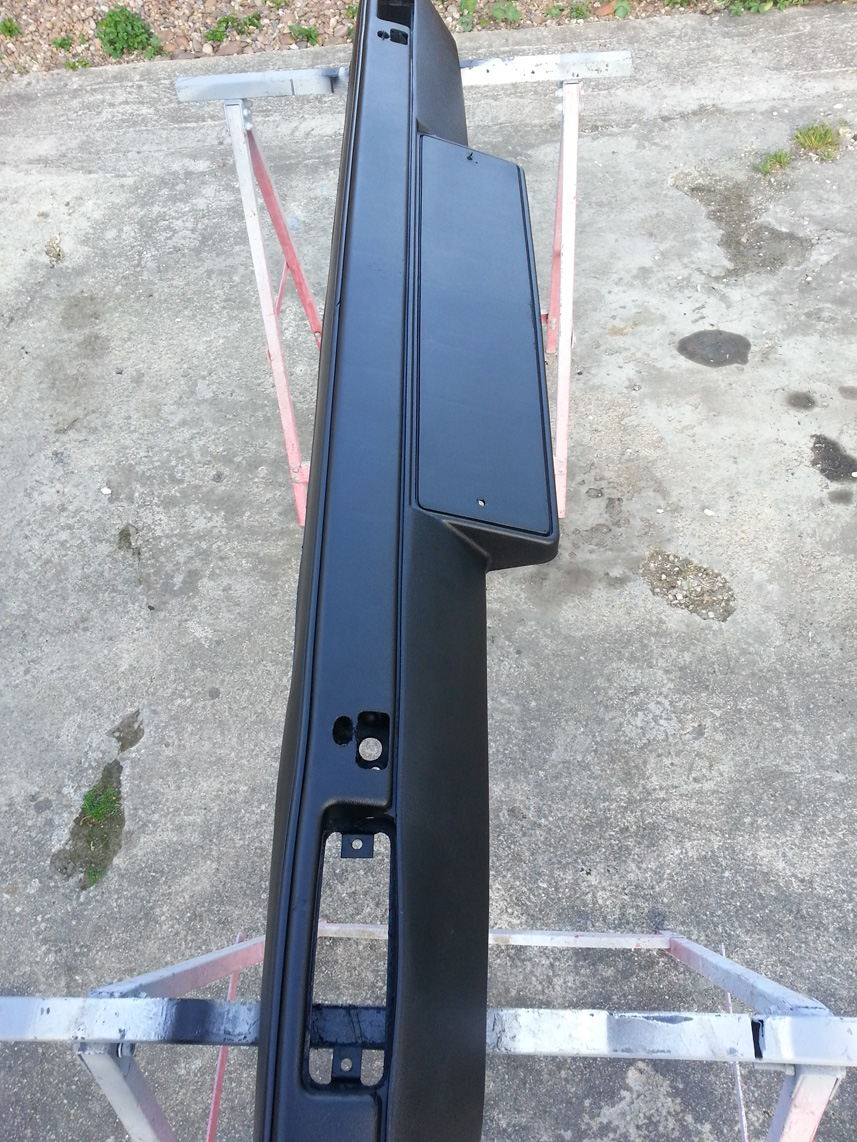

sprayed up the front bumper as it was looking so dull and grey ! but now back to black and looking good :D

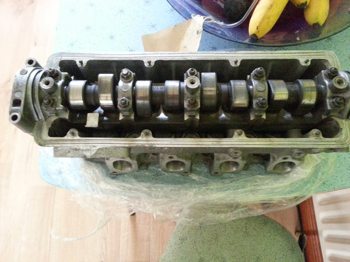

got the cylinder head done finally !!
i polished out alot if the internals to make them alot smoother and remove factory cast marks in the areas it needed using the trusty dremel ! had it skimmed and cleaned up ! had the valve guides sorted and refitted to make all tight as the old ones were all saggy n loose ! relapped the valves and built all back up with the Gt Cam instead of standerd one !
hopefully getting this back in the car on sunday !! so fingers crossed i can have her running :D

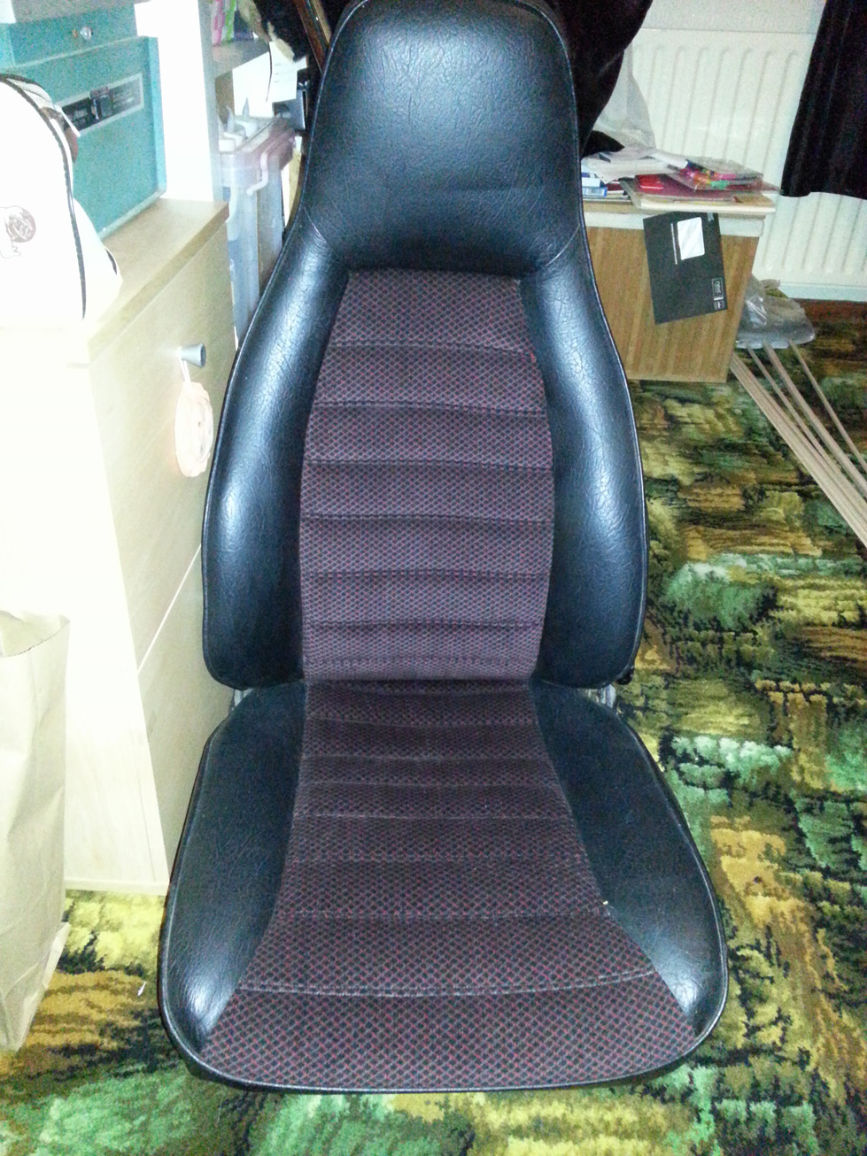

also got some new seats to put in the car ,, just need to get them re clothed as want a different colour ! but think they are going to look really good once finished !!
here is one of them
