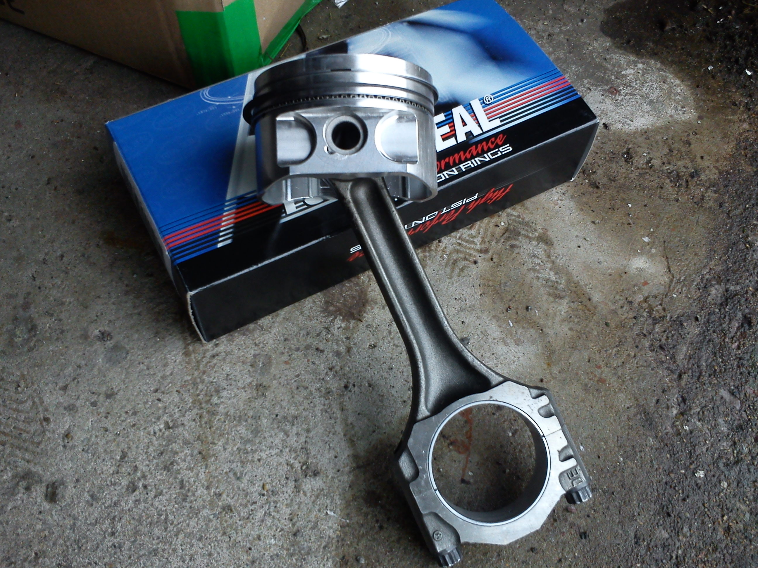

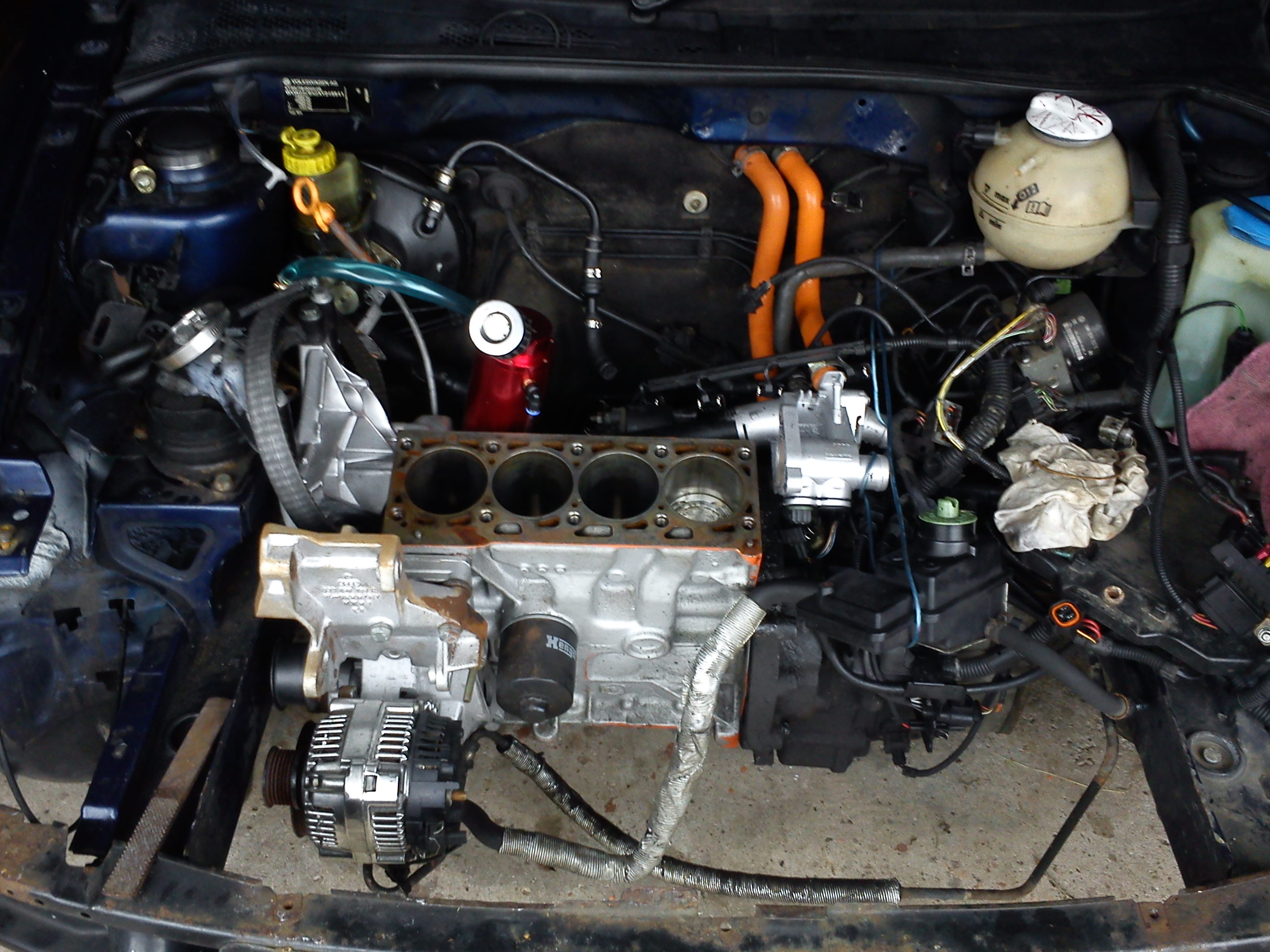

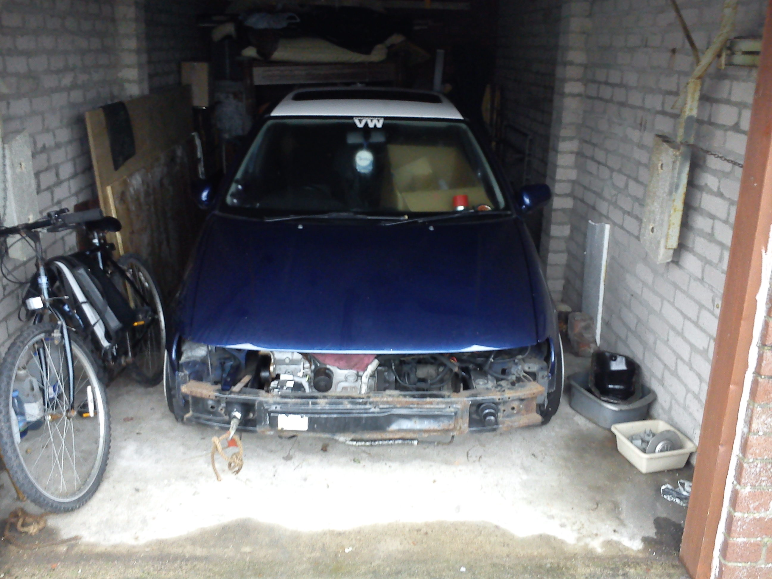

Just thought I would do a small update. And let you all know that the project is still on going and will deffo be at the polo show freshly mapped. I have finally found a company that will make me some piston rings so one of my pistons is getting posted of tomorrow so I can have a fresh set of rings in. Will also be checking the head over make sure the stem seals are ok if not will be getting replaced on next day of. I have the new head gasket ready to get put back together just need my rings and a new cam belt then its just back to getting everything squashed back in the engine bay haha. Then towing car up to local preformance garage to have the megasquirt wired in and mapped. Ill put some pics up soon of her sat in the garage looking all sorry for her self. Just cant wait to drive it. New Update and pics for you all soon. Also if anyone know of where I may be able to get my hands on a turbo manifold for the afh engine let me know. Cheers dan

New update. The piston company where back in touch today with the wonderful news that my piston and a set of new rings will be with me in 2 weeks so all good. Then the work starts all over again. £150 for the rings not to bad I didnt think. Also gonna get myself an oil cooler where I'm gonna fit it I'm not sure sure ill cram it in there somewhere. Cheers dan

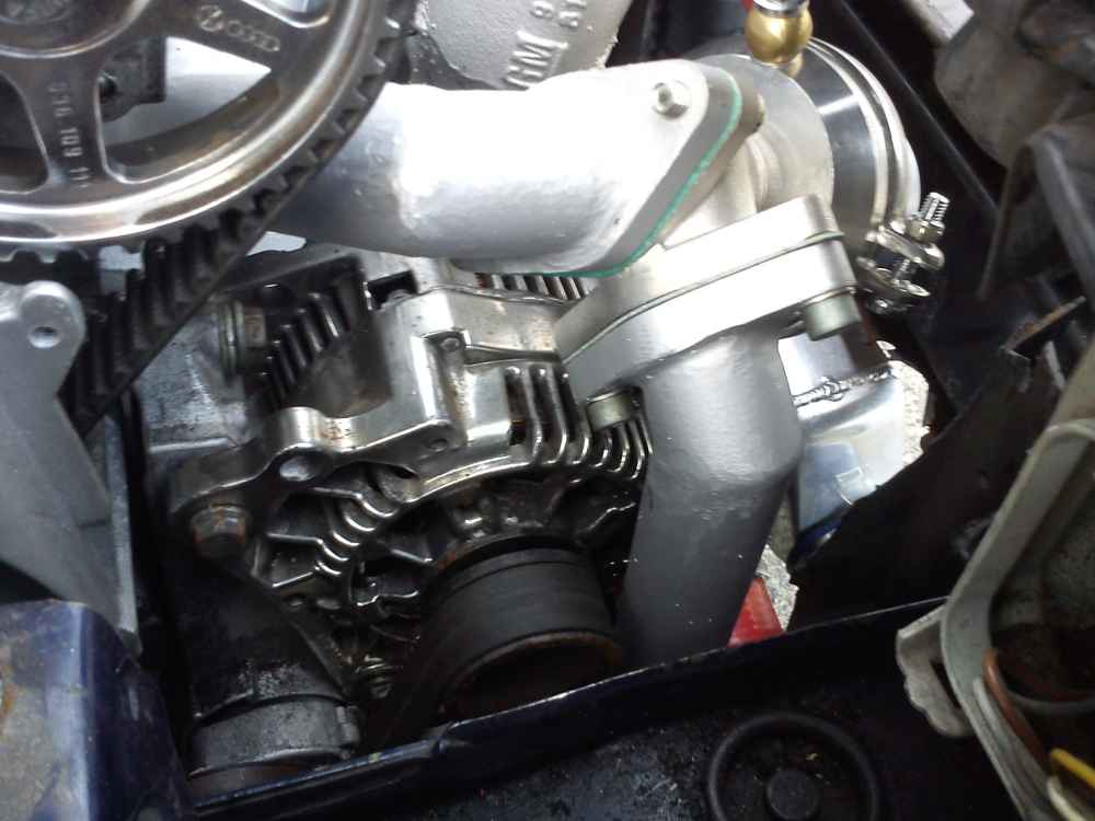

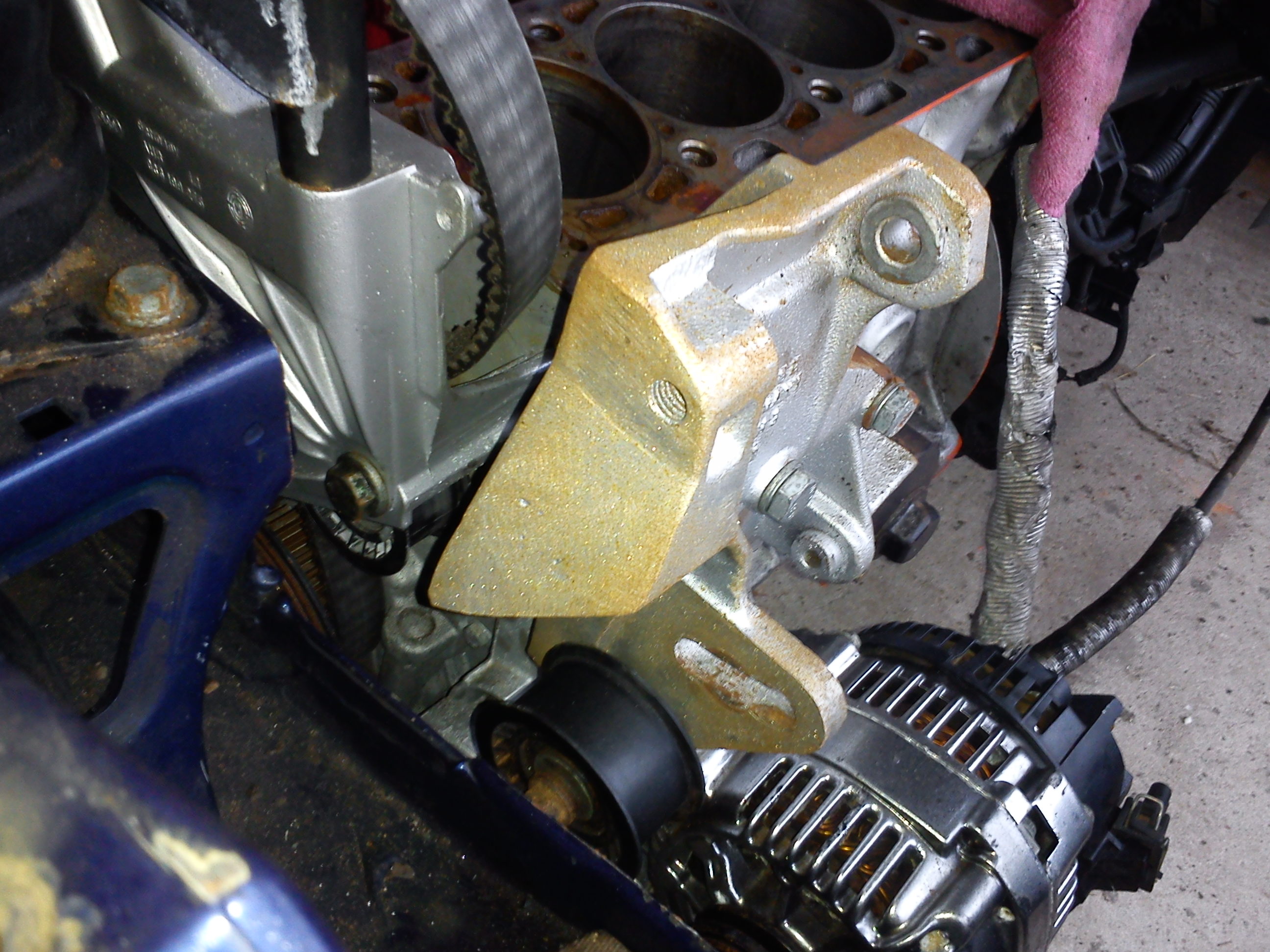

what charger have you used? (eaton from a mini?)
also do you have any close up pics of how you have mounted the charger??

It's a g lader

It's a g lader
ah ok
so designed for a g40 originally?

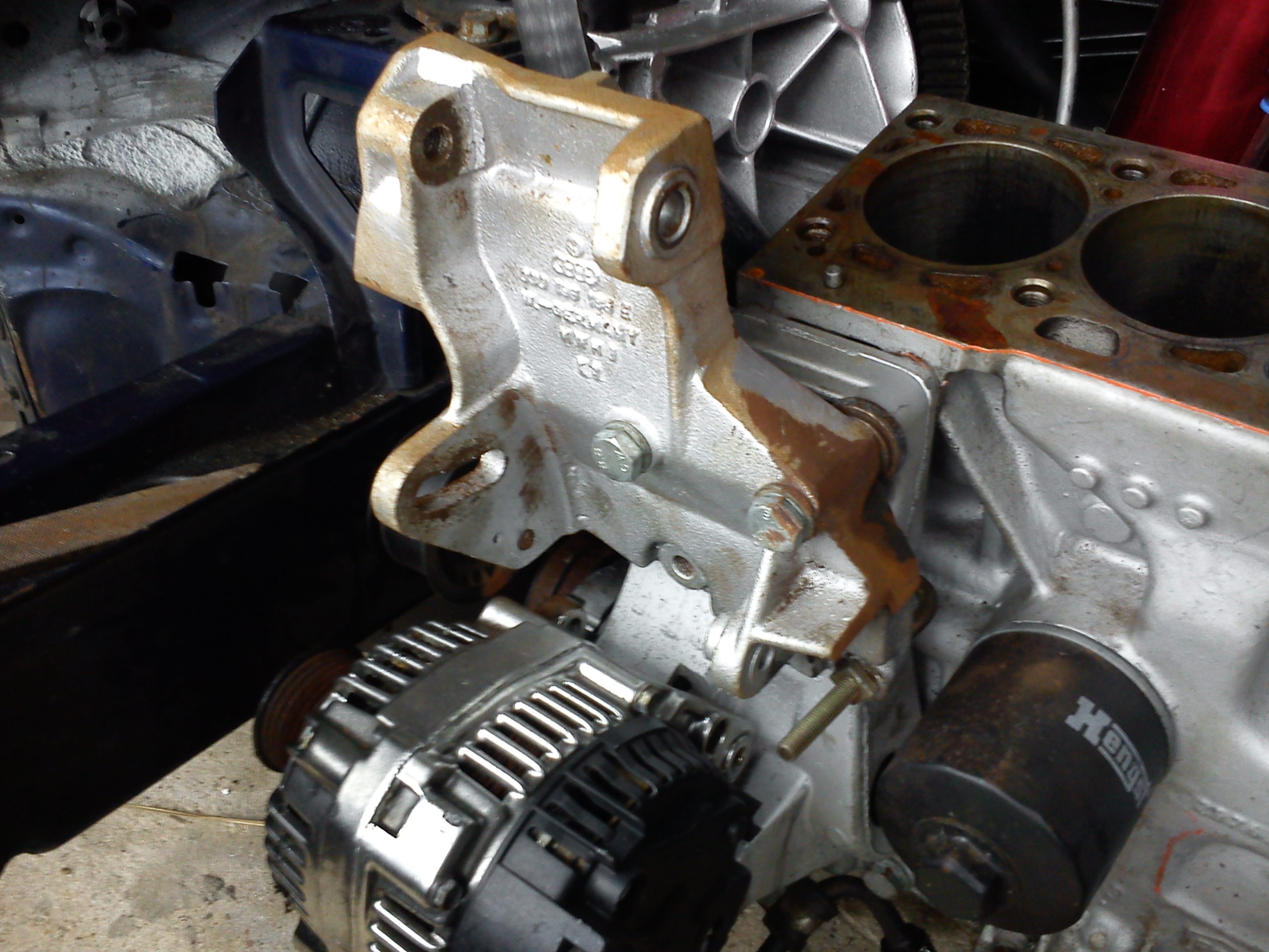

Small update as you now know thanks to bland not much happened as been in hospital. And mobility been a little tricky but I'm on the mend now. Pistons have arrived and just bought myself some nice new files so I can get the correct ring end gap. Also the new top rings are gapless just thought I would add that. As for the charger mount it is an original g40 mount cut down and modified to bolt on top of the alternator bracket so nice and sturdy ill take a few pics of her current state tomorrow as I'm round there doing the rings. Update tomorrow with pictures. Also car will be done for polo show I just hope they have the rr there again would love to show it on the roller. Does anyone know if they are there again this year? Cheers dan
some pics to look at, a few of the charger bracket aswell
the charger bracket is coming back of for a tidy and a respray after some on car trimming

Been round at the garage today. To file the rings all sorted and fitted rings to the pistons. Now just to position the rings in the correct place and put them back in. But thats another day as it freezing outside. Dan

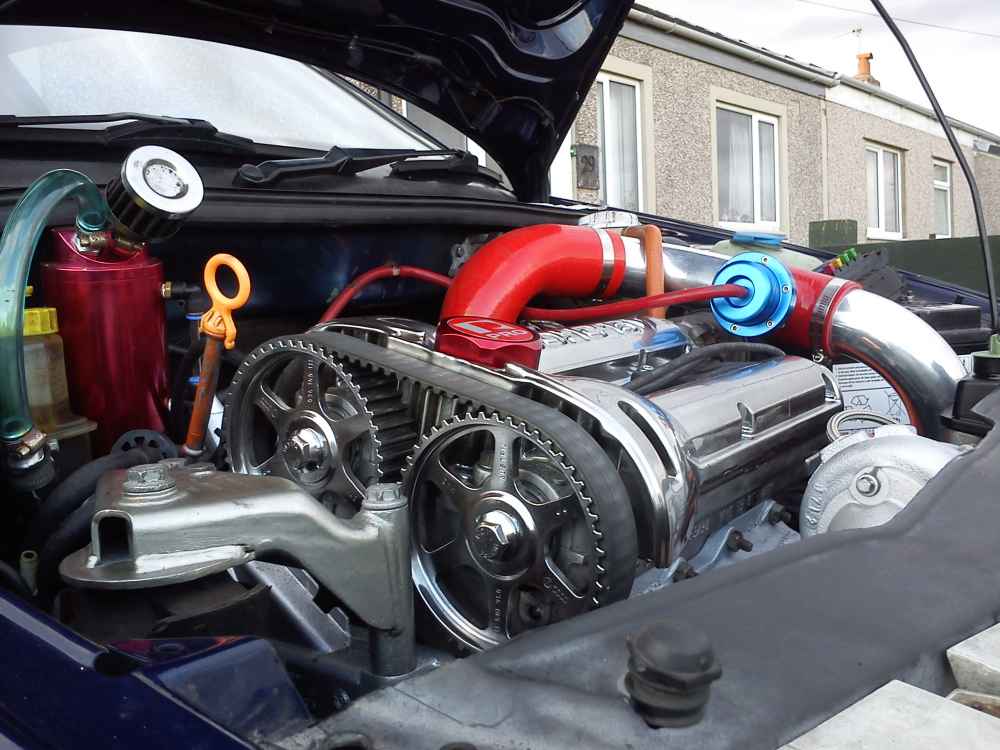

Whats the finish on your alternator dude?
chrome spray i belive
I
It actually chrome plated same as the rocker cover. But thanks anyway ginge
