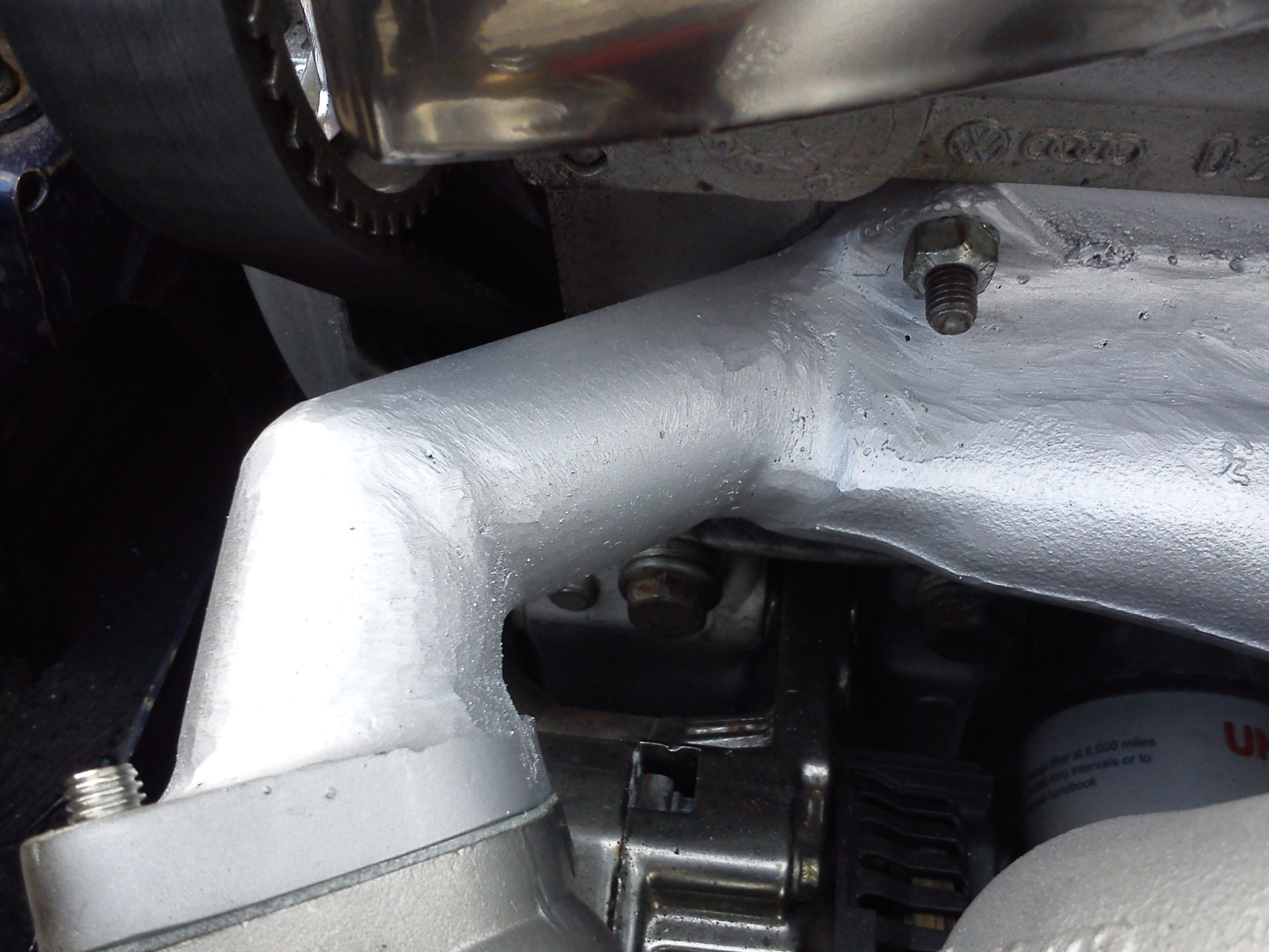

I was gonna take pictures as I made it but forgot to busy just cracking on and getting it done haha. All I did was cut the flange of a standard 16v manifold then cut the flange of the turbo manifold mated them together and welded them together. Then coz the ports didnt match exactly I used a drill file and filed the flange/manifold ports to match when I take it all of to clean up ill take pics of the ports and stuff. Well happy though 4 hours of cutting and welding and it fits perfect.

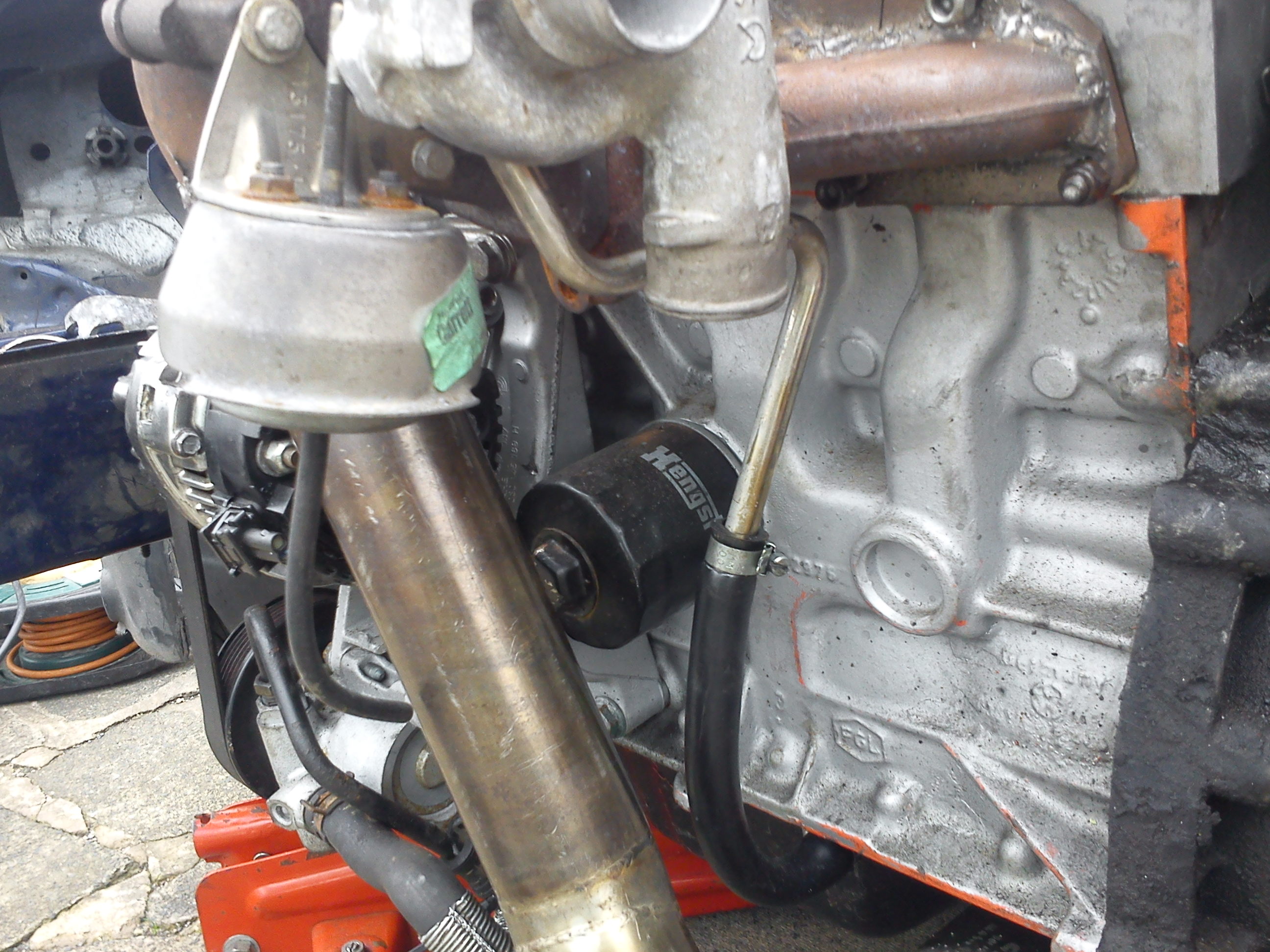

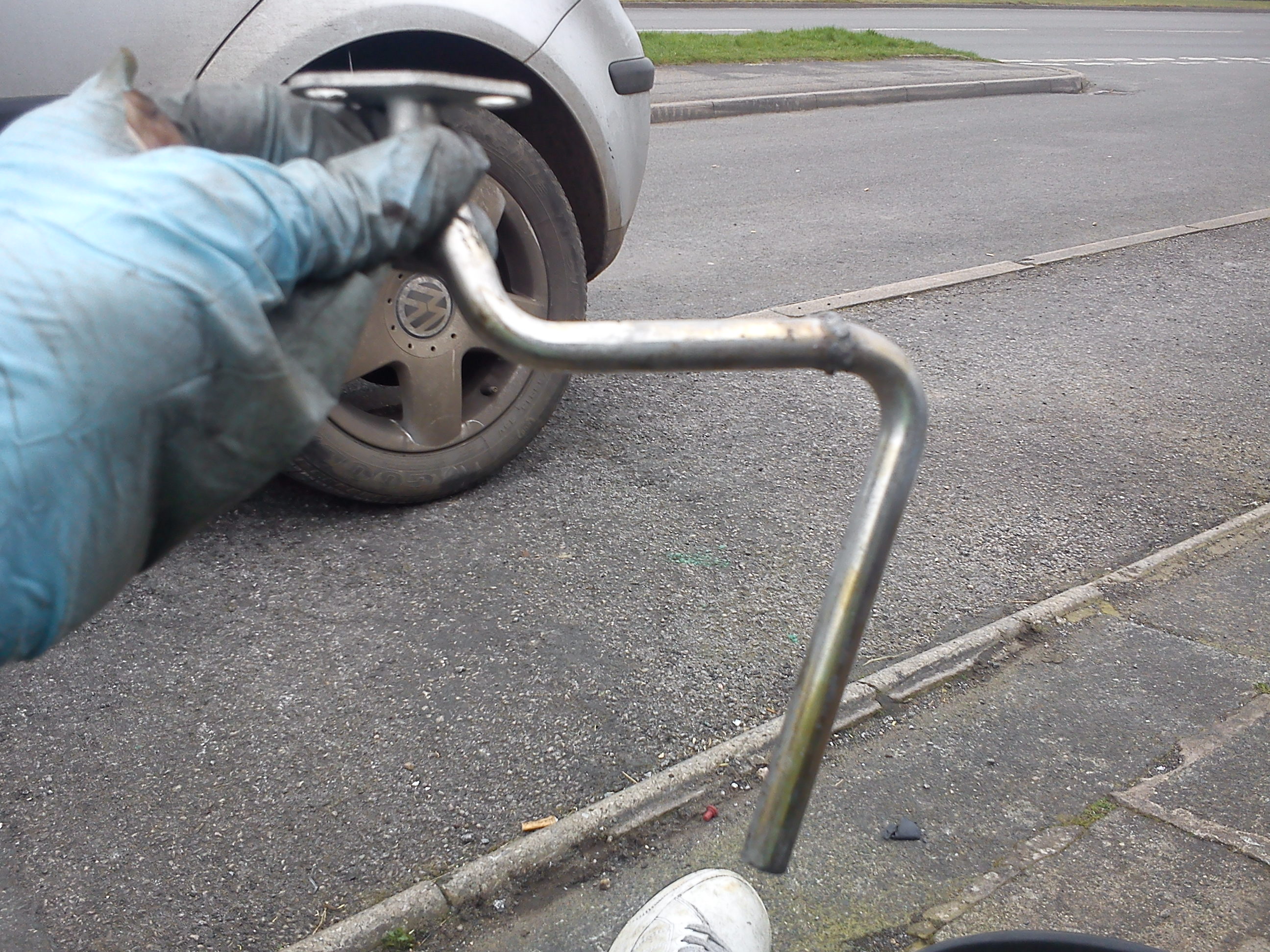

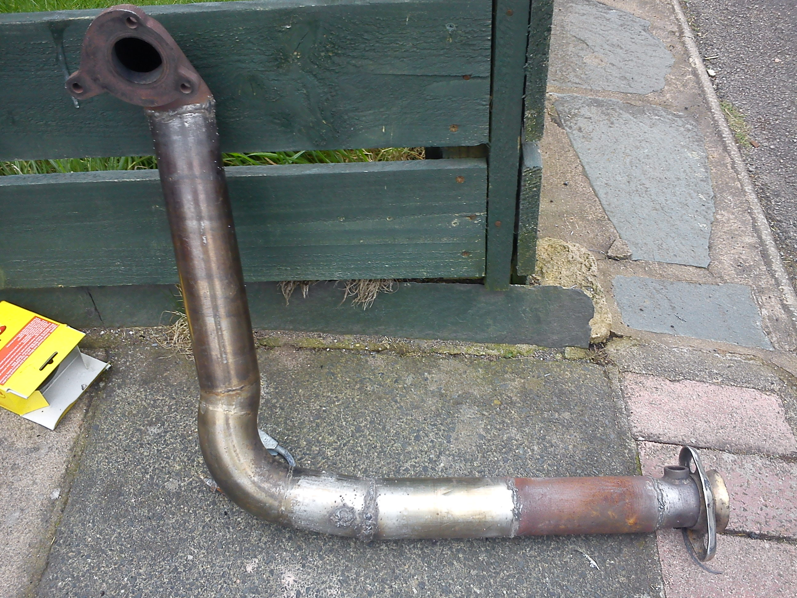

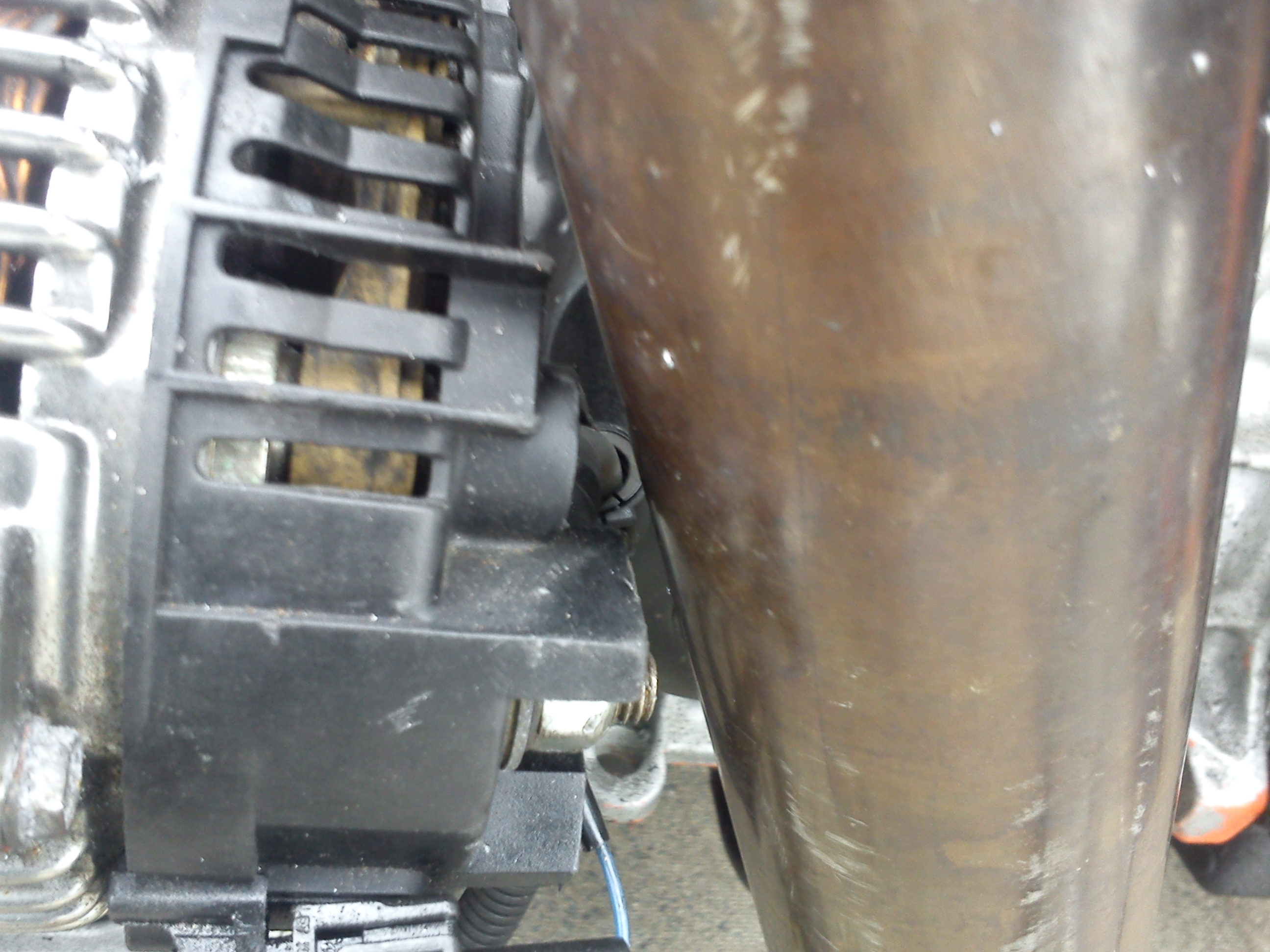

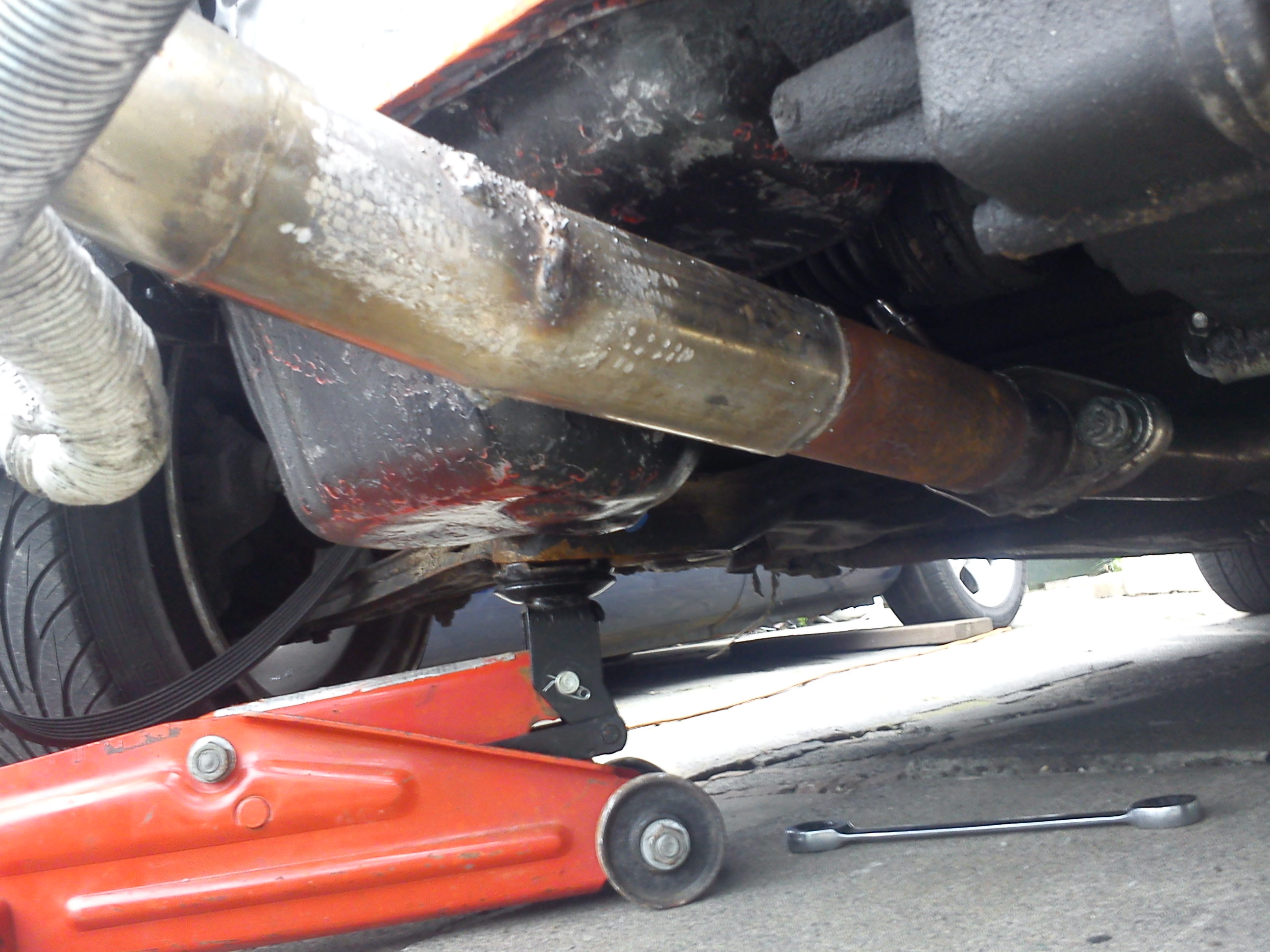

exhaust turbo downpipe made. and made up an oil return pipe. heres a few pics of todays work
enjoy plenty more to come
dan
great work! looking forward to this!

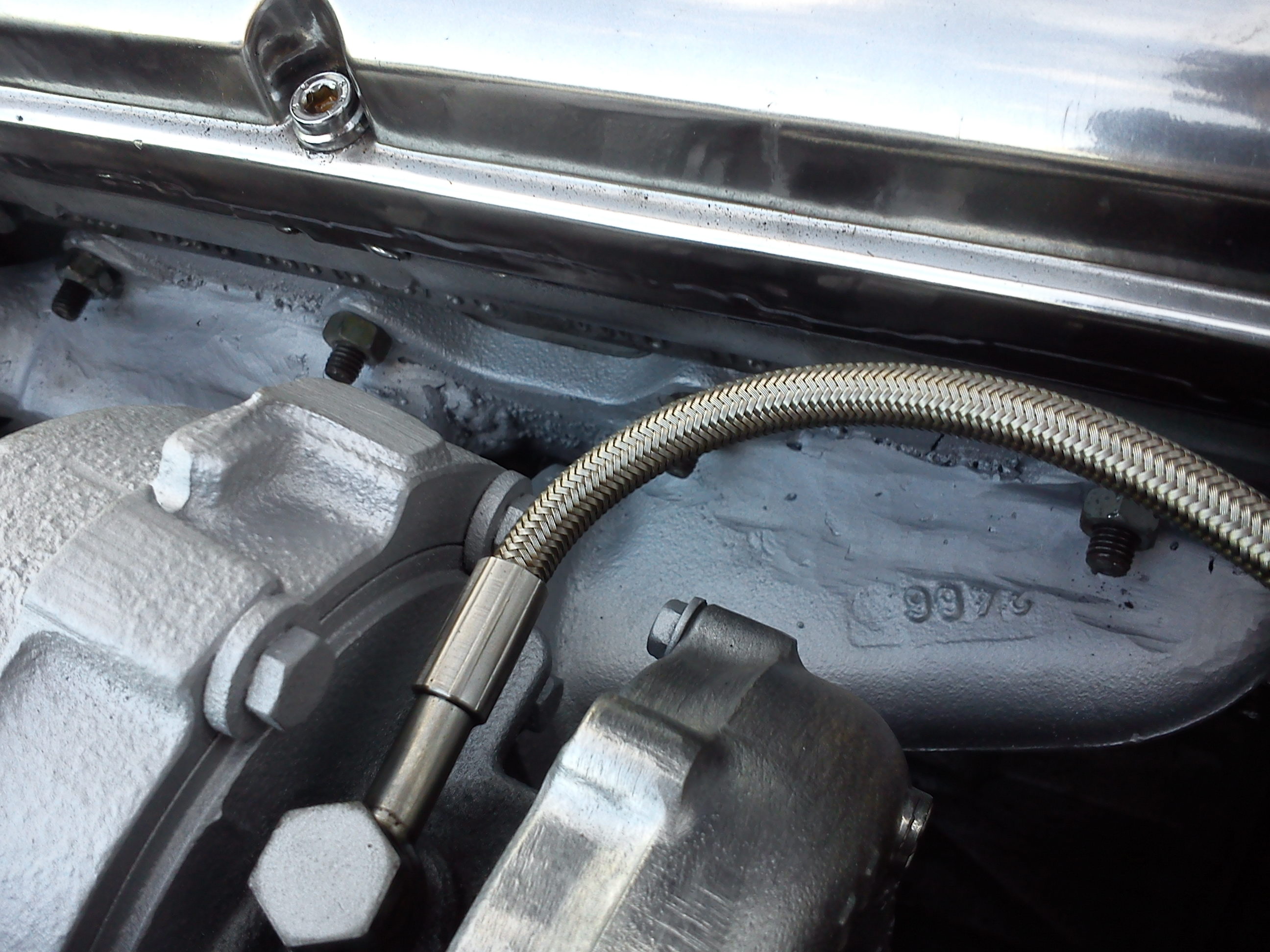

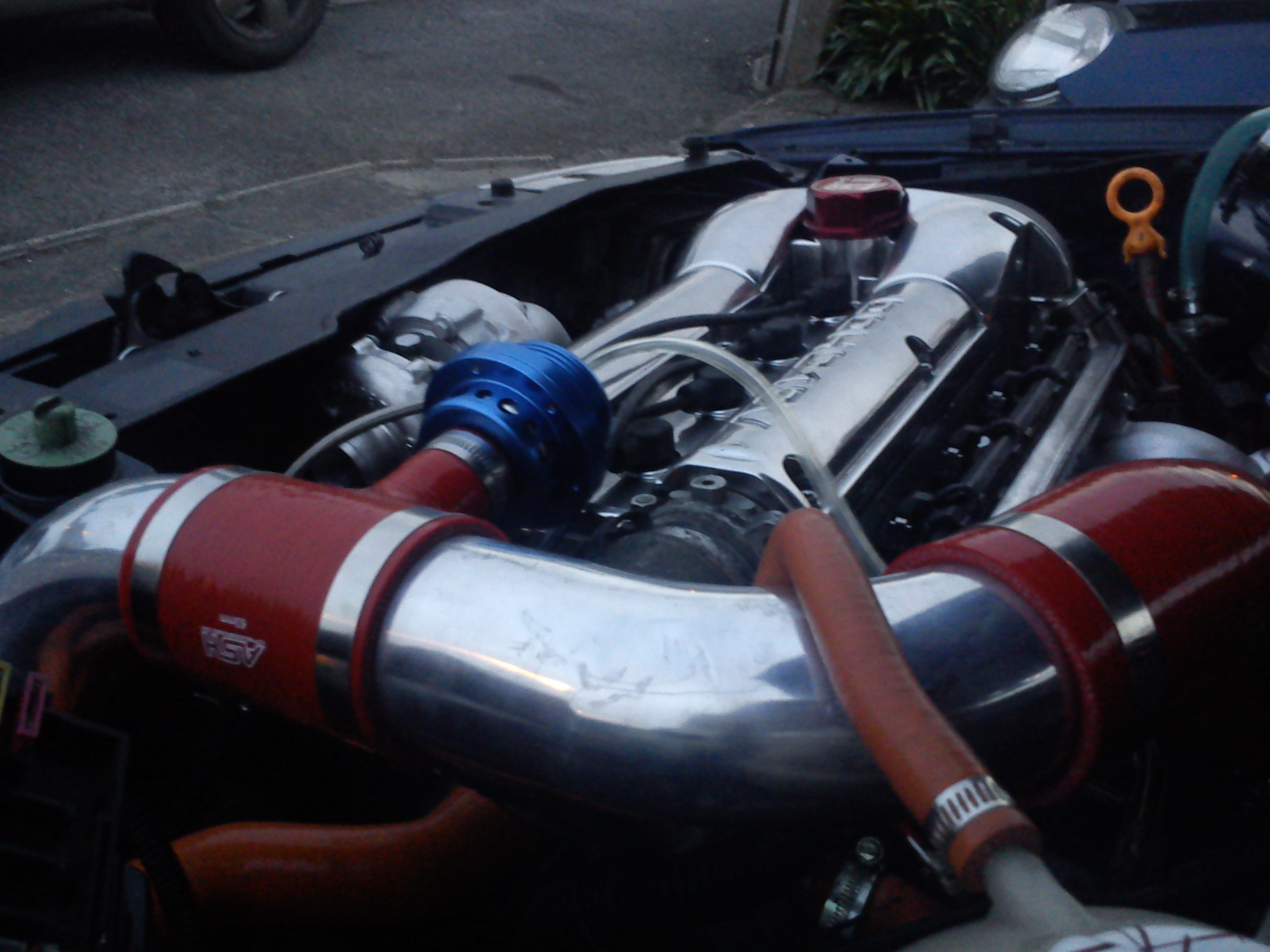

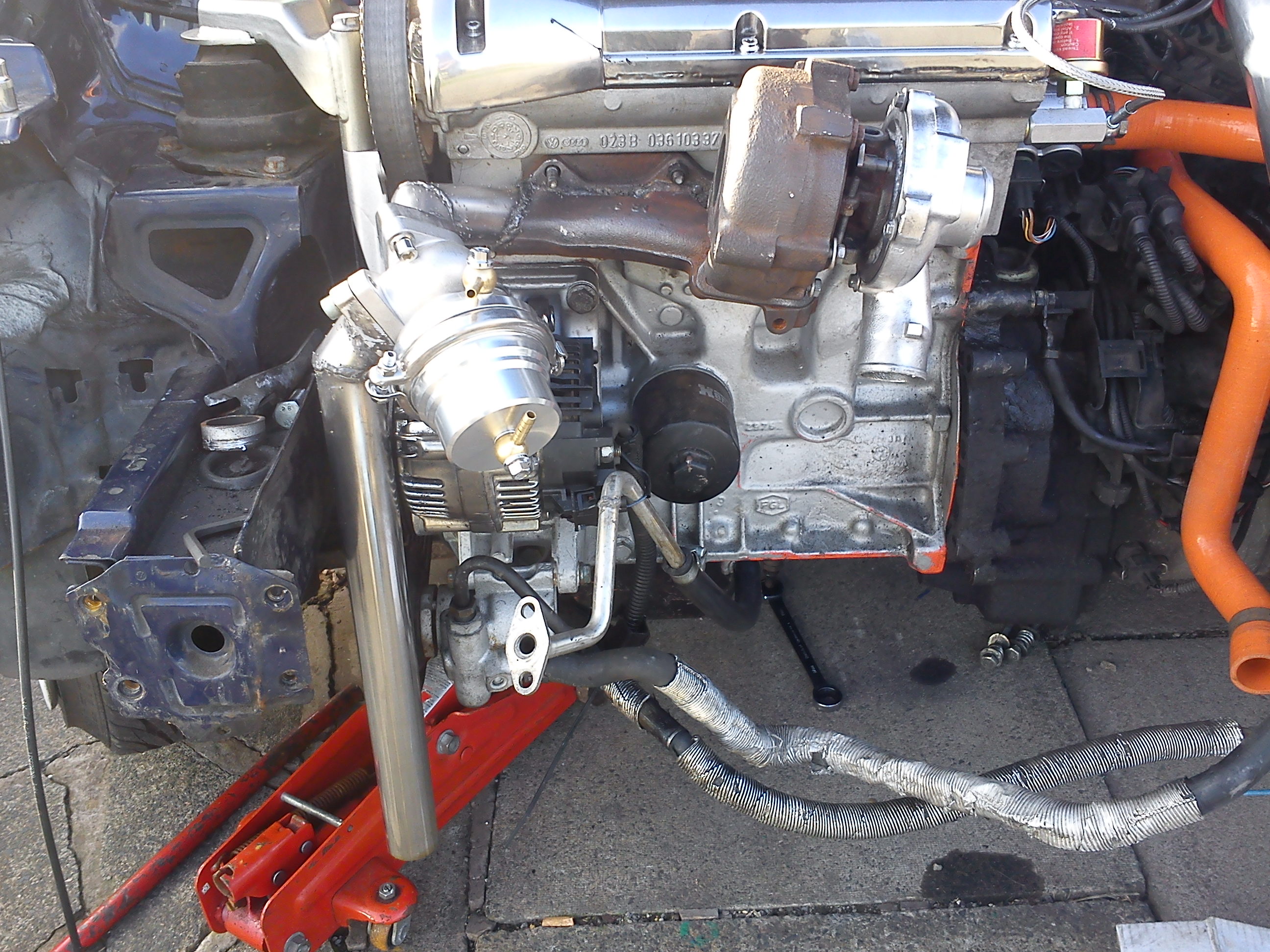

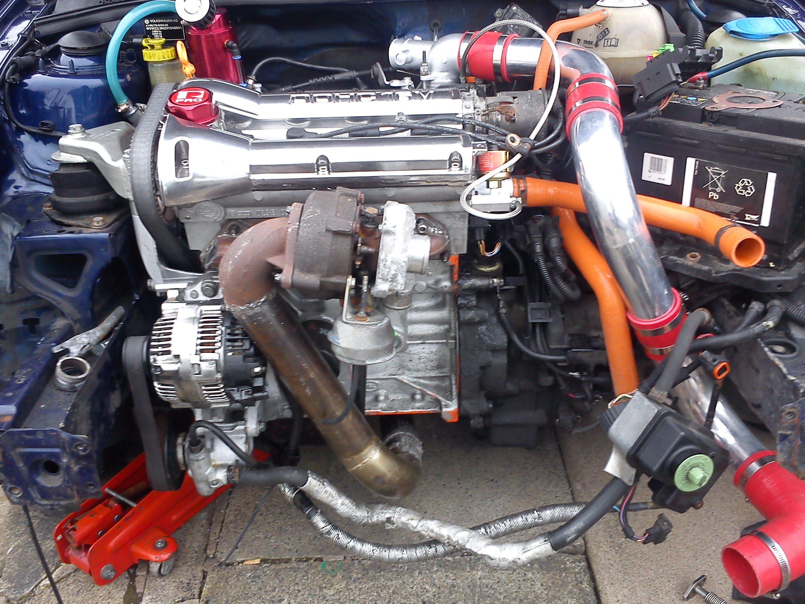

haven't updated in a while anyways car is up and running and sounds mint. i have got it booked into jdm-dyno in a months time to go and have a dta s40 ecu fitted and mapped. anyway here a few pics of what i have been upto car is all together now so will get some more pics of it on the ground and finished.
hope you like.
finished pics to come in the next few days.
cheers for looking dan
i have to say that is a very good effort at a home made set up i live the screamer pipe :) cant wait to see the finished item :)

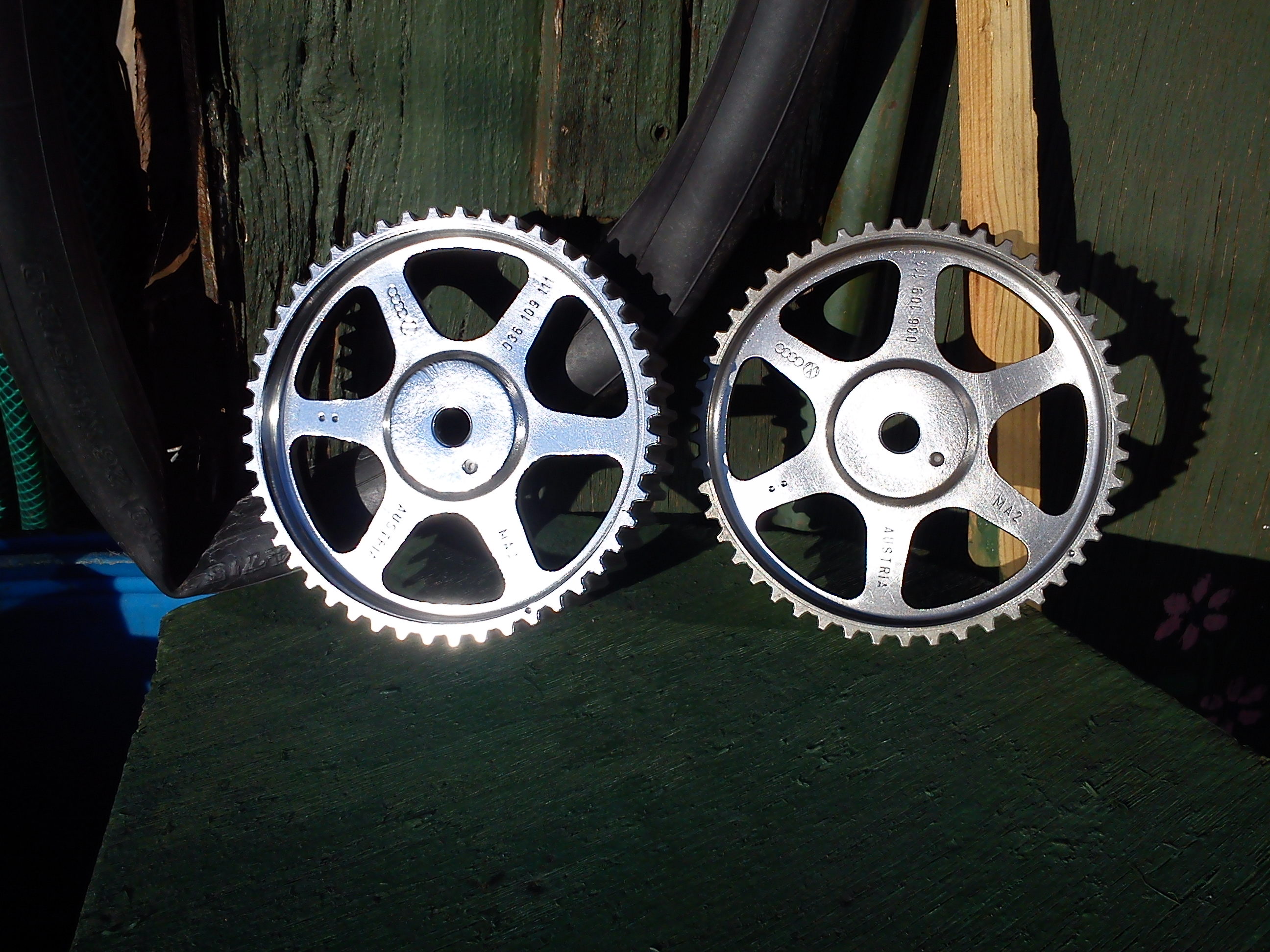

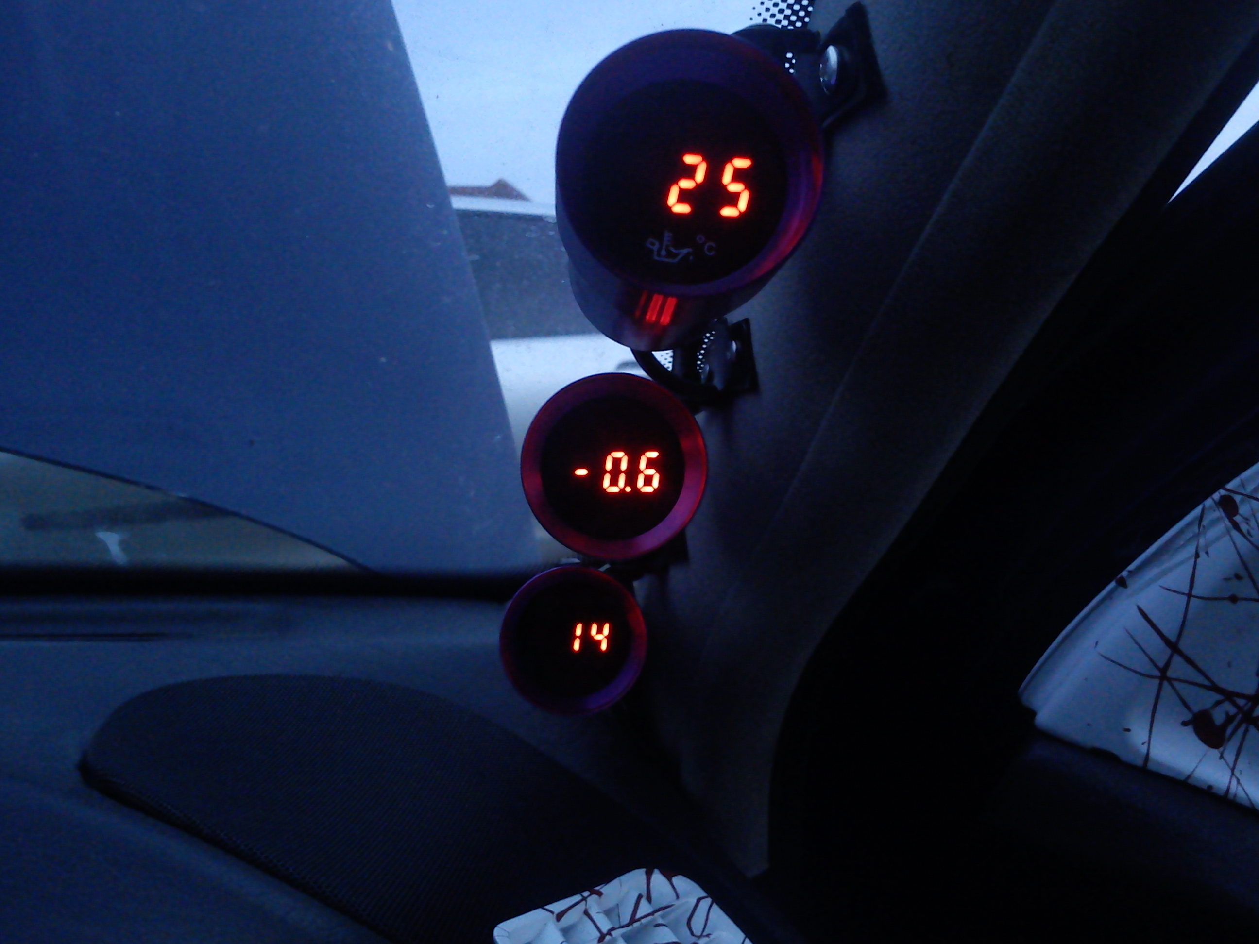

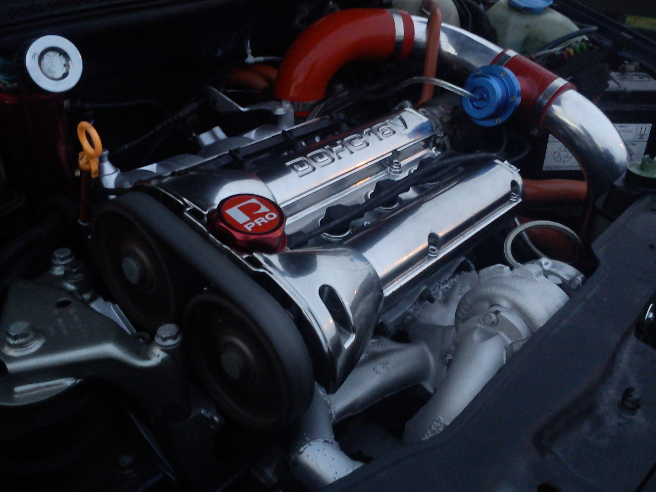

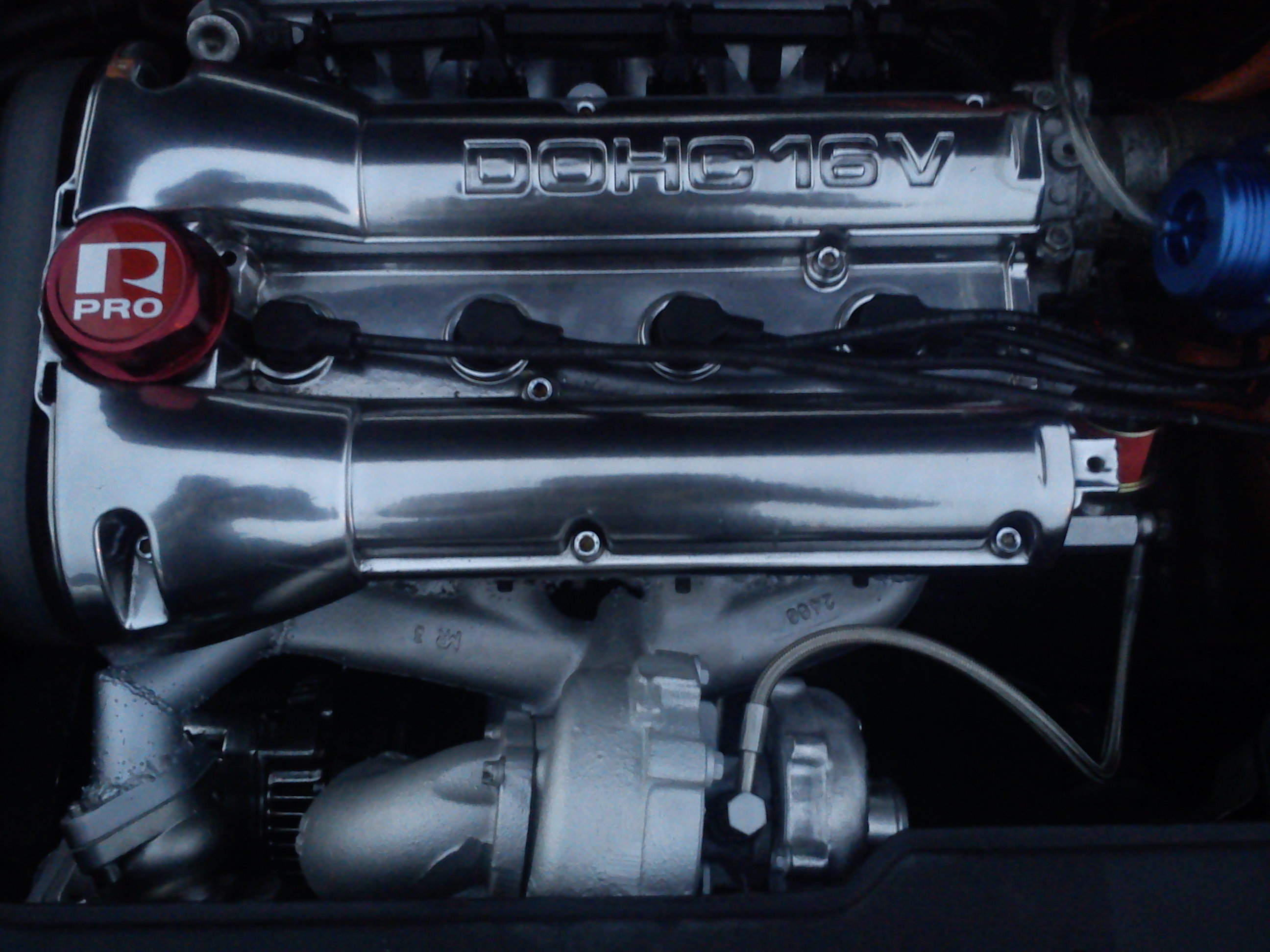

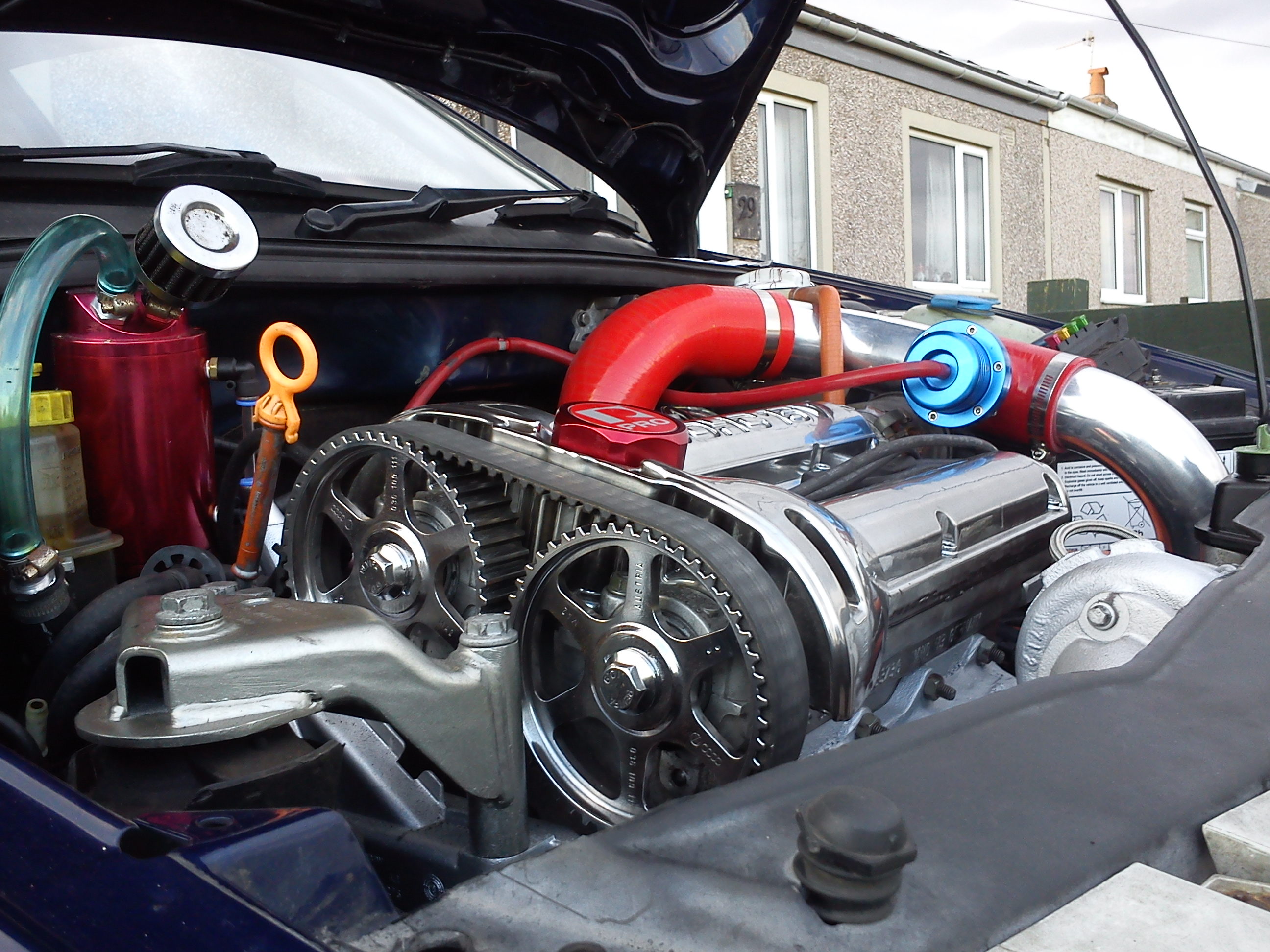

some pics of the finished item. i am going to the performance garage on saturday with a big waad of cash so he can order in a nice new dta s40 ecu to manage the whole build then car goes up in 3 weeks to get sorted. as you will see in the last pics i got hold of some old 16v cam pulleys and have mirror polished them as the old ones on the engine now just weren`t clean enough to fit in with everything else haha.
anyway less blabb more pics

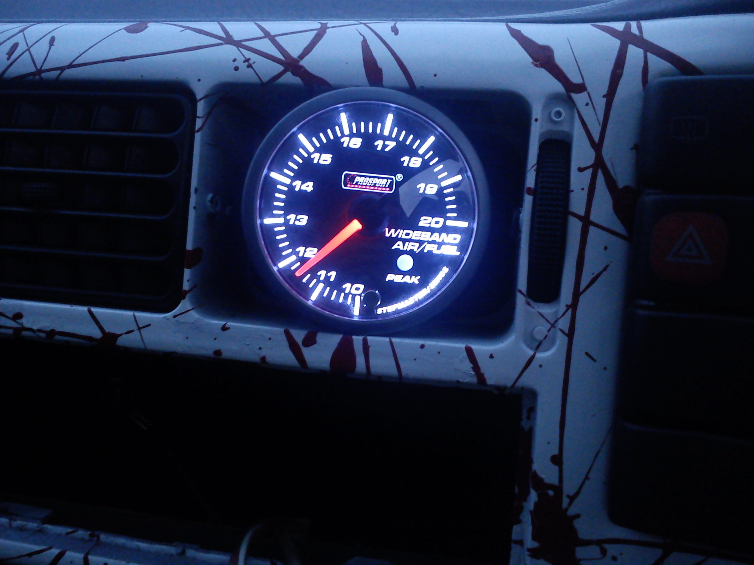

running a little rich haha
hope you like

fair enough mate! looks sick.
effort!!!! nice one dude.
hello sexy ... you come here offten ? ;) .... i have now fallen in love with this :) got any vids mate? hope to see this in person :) what ecu you running aswell ?

small update new dta s40 pro ecu order today for what i thought a good price of £520 posted. cam pulleys repolished and put on. turbo manifold coming back of to grind down all the welds and do them again with cast rods so is stronger and looks neater.

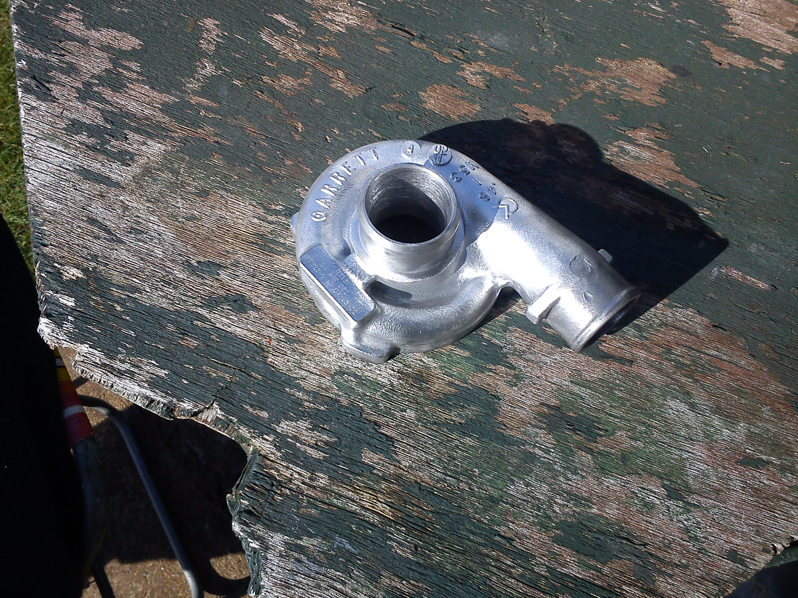

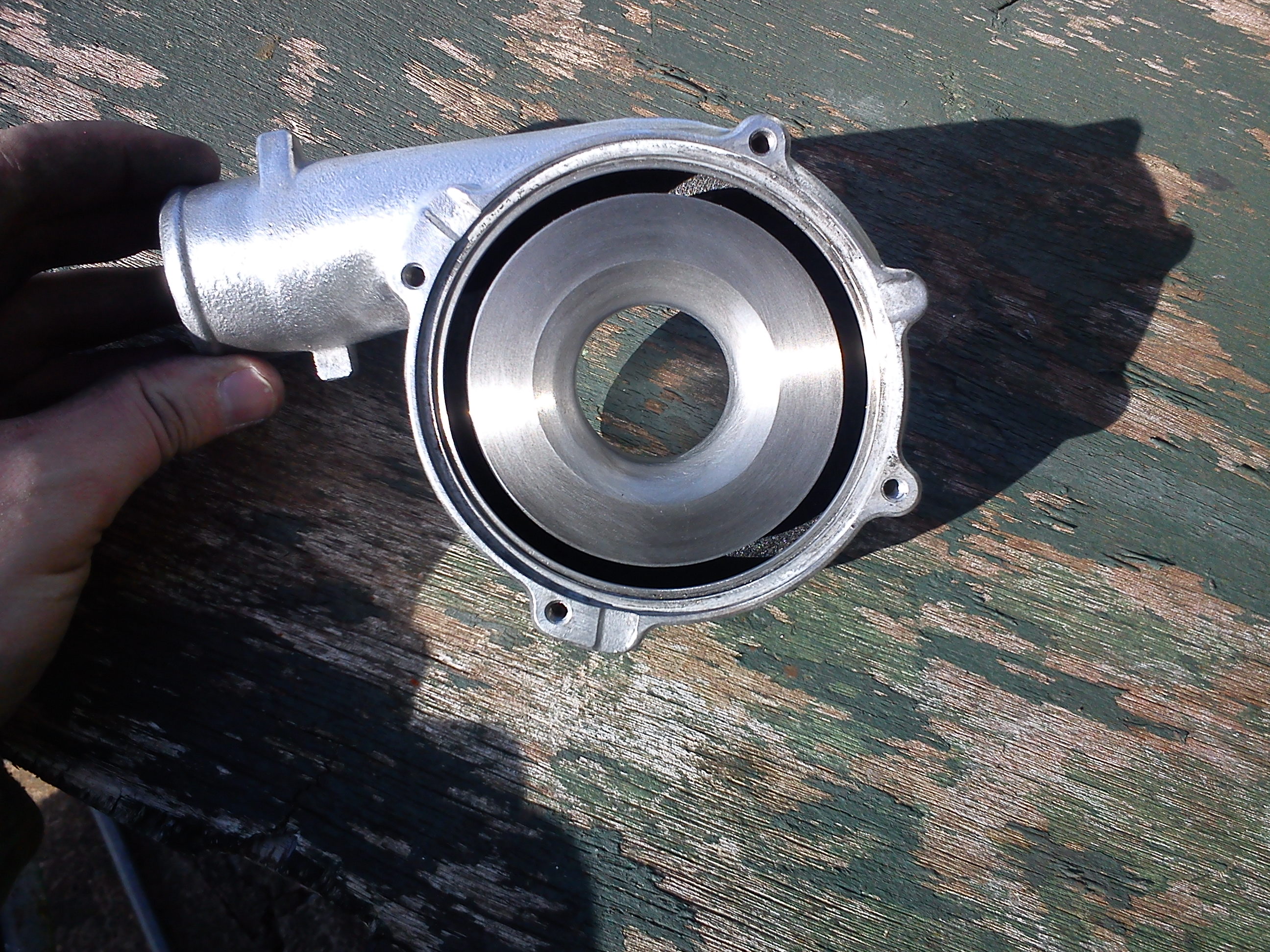

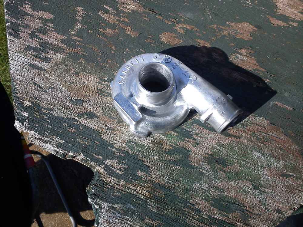

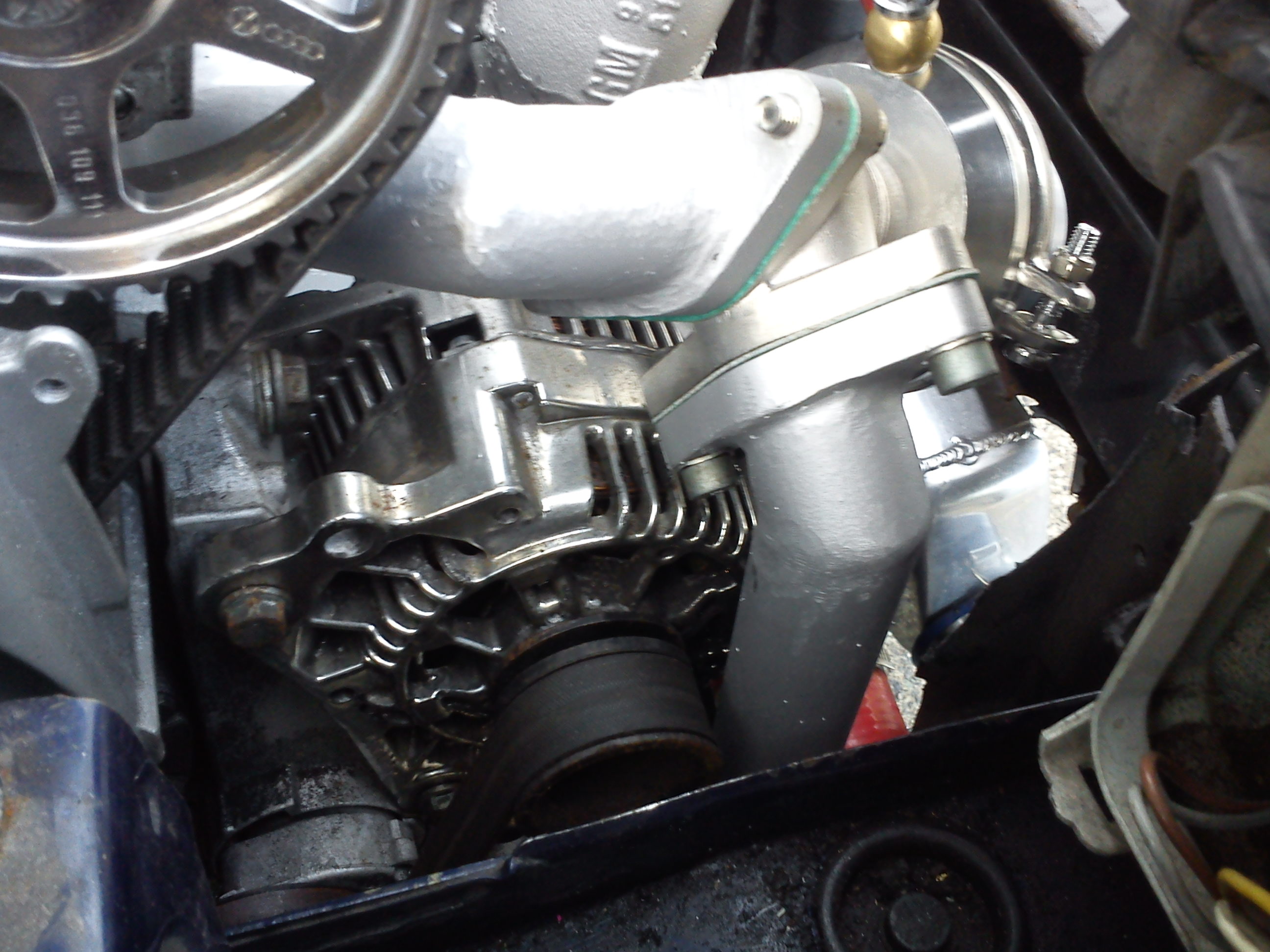

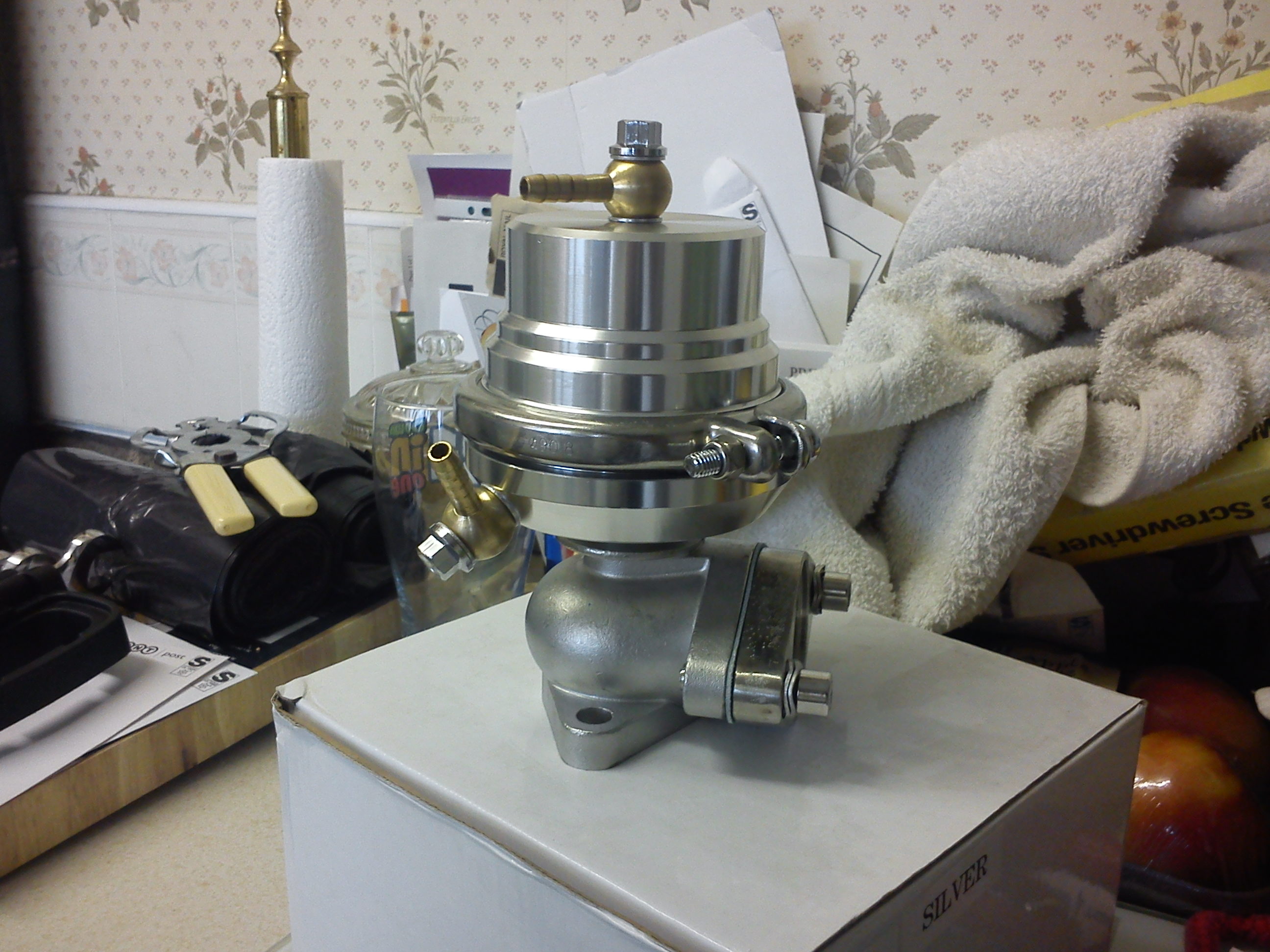

dta ecu arrived in post yesterday morning happy boy :-) turbo and manifold and eternal wastegate and screamer pipe all came of today for a major clean up and reweld. also polished cam pulleys on now heres some more pics everyone loves pics haha
hope you all like
dan
