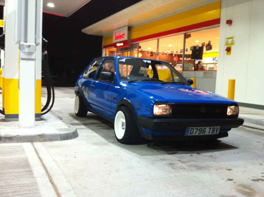

need to decide a colour for the bay and wheels? thinking of shocking pink or highlighter yellow. any body else have any suggestions?

I say keep the wheels white as it looks spot on but thats my opinion :-) I anticipate many pics of this car! really wanted to buy it myself when it was on ebay. I bet you bet me to the 16v conversion lol
looking at getting them wrapped if possible :) but i do like the white makes them stand out
Ohhh don't wreck them with wrap. white for the win! They might need regular cleaning but they look shit hot jus as they are. Great progress so far. I'm so so close to getting mine on the road. =)
