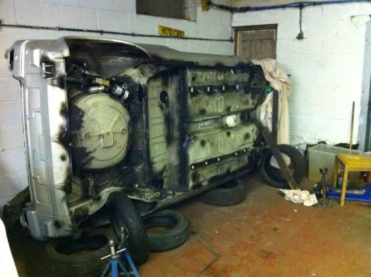

Right, better update the progress. We shall carry on where I left off.
Saturday morning I was awoken by Baker who had kept to his word and was at the workshop by about 10.30am. I was however still in bed!
Wanting to push things on I dragged my sleepy arse up and made my way to the unit to meet Baker. On arrival Baker was loaded up and ready for a trip to Aerocoat to drop off/collect parts.
So after some cutting about in his haggard 6N I was feeling a bit more awake and ready for some bacon sarnies and some work! (it was almost 16:00 before I got into overalls).
Shiny bits..
Jim had bought his foreman up the unit, which saw some heavy use! (Fuck knows whats going on with the camera here).
Jim was already on with filling redundant trim holes along his rear panel. I got roped into holding alloy behind the holes in the boot.
In between this and eating bacon sarnies I continued with the butchery of the scuttle area

I had a peek at then rusty battery tray..
After a bit of discussion with jim (fabrication mentor) I'd made some light..
jim had bought some sheet to repair his sill with. After some pleading he donated some to the cause.
I got this tacked in. Simon appeared briefly so I got him to lend a hand holding brass behind the large gap I'd created with my rough prep. this allowed me to fill it without making it any worse.
Si nobbed off leaving me running a rather brave..
This didn't go as well as i'd hoped. Mixture of fusing and lots of wire and general uncomfortable positions left me quitting while I was ahead..
That was enough for me. Had welded as much as I could. Had a few nasty holes to fill that nrequired a helper with some brass again. Called it a night about 1:00am.

By which time I was ready for some welding round the rear turrets
Martyn was now onto bigger and better things..
More cutting..
Meanwhile I got comfy in the spare wheel well.. wish i'd cut the stud off!
oops..
Martyn got cracking with his home for the clocks and switches.
Meanwhile I lapped up the positionals.. relatively easy compared with the overhead battery tray positions!
This concluded the evenings fun and games around 01:00am.

Time for a wee update.
Several Sundays ago I had a visit from a certain Hobbit. I had no enthusiasm for the project this day as it was soo hot, so we made a start on my finite adjustable stands, so I can get the car sitting level.
Gashed up a few bits of old shit and made use of said Hobbit..
Cool as fuck welding in his shorts! UV tan ftw!
I allowed Dench some input and he reckoned the use of a rotor was a good idea.. i wasn't so convinced, but cba to find anything more suitable. So for a mock-up I rolled with it!
This needs finishing off. A locating plate in the centre and a new base plate for the jack, with gusseting for extra strength. In theory though it works. Need to make two more for the rear beam trunnions/mounting points. Oh and a couple more jacks from vans.
So that was a days work!
