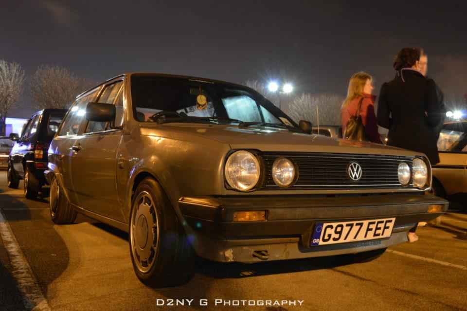

where did you get your grill pal
So the car is finally nearly finished!!
Going for MOT Wednesday so fingers crossed!
will update with pics soon!
Grill came off ebay but it is home made!
