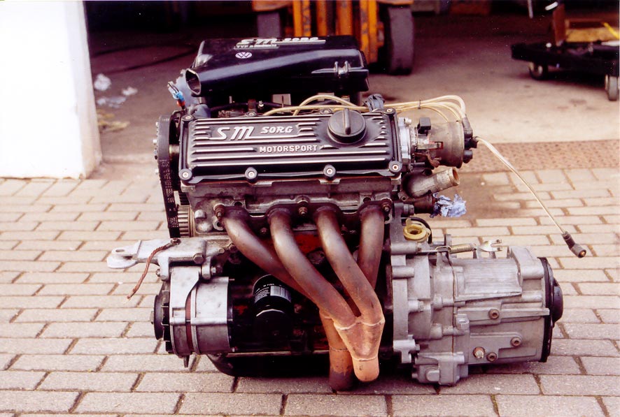

I've got Pinto (or Transit) exhaust valves as inlet valves too.
36mm x 110.6mm X 8mm triple collet groove.
Think originals are 7.95 diameter and 110.5mm. The guides needed careful hand-reaming.
Type1 Beetle might provide a 32 x 8 x 111 exhaust valve.
RTE Sport offer 38mm and 32mm valves, but say they are 105 x 8?
Doubt you can wind the rocker arm adjustment down 5mm.
Perhaps they use lash caps (or smaller guides)?
Indeed. they do offer 'Einstellkappen.'
dvderlm: did you need new valve seats or did they just regrind your old ones? Also, are the beetle valves triple collet? And finally, is there enough meat between the seats to allow larger valves?
Dvderlm , any pictures or specs of the setup?
Picture and the thread with the correct dimensions.
Don't trust my memory, but I'm not far off.
Seats were simply ground. They are German hardened seats not Leyland jelly.
Which is why introducing unleaded fuel in Germany was so easy.
Enough meat? Might depend on the skill of your head machinist.
Mine thought 36.2/29.1mm was adequate for n/a.
You'll probably need piston pockets for 38/32 or 37/33 with good lift cam anyway.
With 34 to 37mm inlets and BOOST, 31mm exhaust is thought sufficient.
Anyone know of 31 or 32 mm sodium-filled 110x8 valves?
Not sure about the beetle valves triple colletness?
Edited by dvderlm
