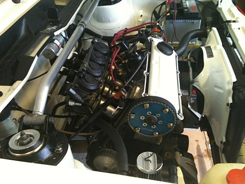

In the upcoming months I'll be selling my ported and flowed 1.3 GF head (only selling as I'm doing a 1.4 16v AFH conversion). the work has been done by JMRacing, with 3 angled cut valves (std size) with new valve guides (short so flow well) and stem seals. all in all its done about 3000 miles on a VW GF cam since installed.
the dbilas cam pulley which might be for sale too
also the r6 bike carb bog brothers manifold (work of art)
http://static.wixstatic.com/media/3d6d76_164fa8c8044a22552972e8d02731c7fa.jpg_srz_488_366_85_22_0.50_1.20_0.00_jpg_srz
any use to any of you lot? PM me if so :)
cheers Ash
