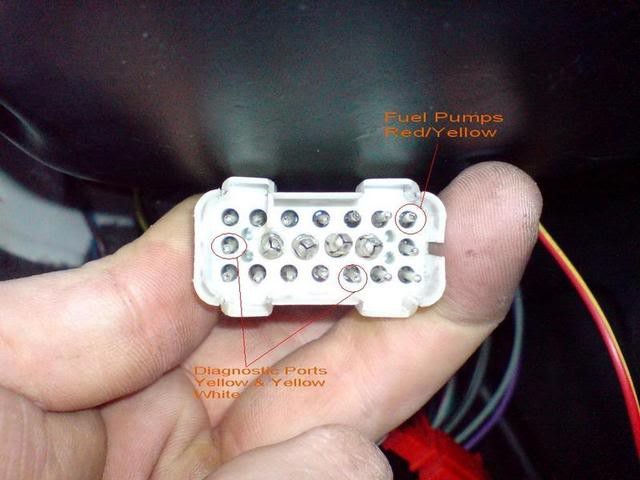

Well I have spent most of the day removing and fitting the fuel pump wiring and the diagnostic plugs. Now I knew that I had to do something with the wiring for these things but not exactly what. So thanks again to Steve (86c) for helping with this.
I have gone for more of a how to with this post as I haven't really found much of this information when searching for GT swap posts.
Basically you need to remove 3 pins from the white socket that plugs into the back of the fuse box. These 3 cables lead to yellow sockets (see below) so they are easy to identify
This is the mk3 socket EDIT new picture with correct locations
As you can see I have marked out the pins you need to remove. You can probably demolish the plug to do this. The bottom one is the lead that goes to the fuel pumps via the yellow sock bellow
You can see the single cable on the left (which leads to the white socket) and the 2 cables on the right goes to the fuel pumps (1 to each)
Each fuel pump also have a brown earth cable which runs into a socket up behind the dash. You can just see this in the picture above (brown cable with the black electrical wrapped round it). This plugs into the same socket on the Mk2
And the top 2 feeds the diagnostic socket via the yellow socket below.
The lift pump under the rear seats also has the fuel gauge sender which is connected via the lilac/black cable and connects into the main loom via pin number 7 (as seen below)
Again I removed this so I can feed it into the same place in the Mk2.
I stripped the 5 cables (2 to the fuel pump under the rear of the car, 3 to the fuel lift pump/sender) from the rear loom A bit of a pain :)
This the same socket on the Mk2
As you can see 2 of the sockets are free but the one at the bottom needs removing and taping up. And the place the fuel pump pin diagnostic pin in the same socket.
The top 2 diagnostic pins simple remove and place them into the same sockets on the mk2.
The other diagnostic socket (the black one) follow it up and unplug it. you should see it works as a plug through so I believe that this is just some kind of power socket. Find the same socket on the mk2 and disconnect it and then plug it back in using the plug though.
All in all this took me the best part of the afternoon :)
Mark
