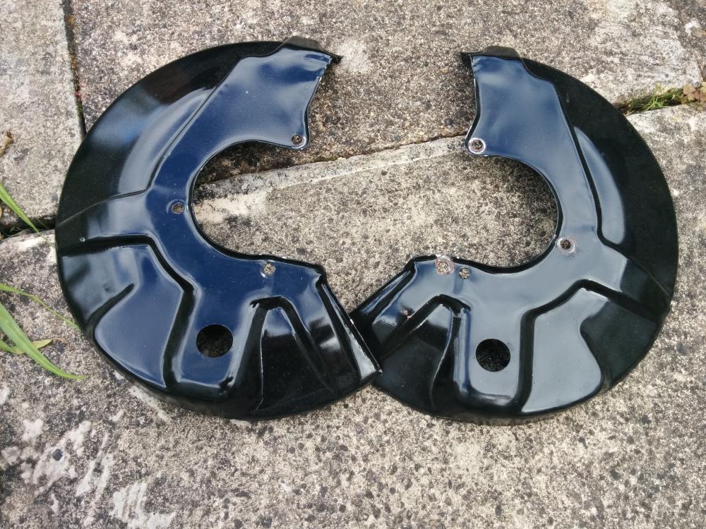

That is a very pretty looking car, good work. I wish I had a decent sized workshop to use during the week. Where did you get the brake disc shields from and what are those wheels, they look the business. :smile:

As for the brake shields I actually have some for sale!!, Brand new but painted in Hammerrite and just test fitted :)

£25 Posted :)

What a coincidence if Jimi doesn't want those shields I'll take them off your hands on Friday mark!
Mine rub my disks even if I bend them back they rub after a couple miles...drives me insane
I'll definitely take them off you, in fact I believe I just found your eBay listing and put it in my watch list. I'm still curious as to where you sourced them from for future reference.
PM sent! :)
[emoji20] I'll get some one day. For future reference I'm sure that vw heritage have them if you get the part no. From vagcat
