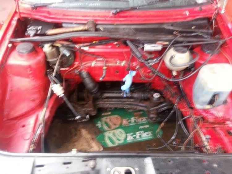

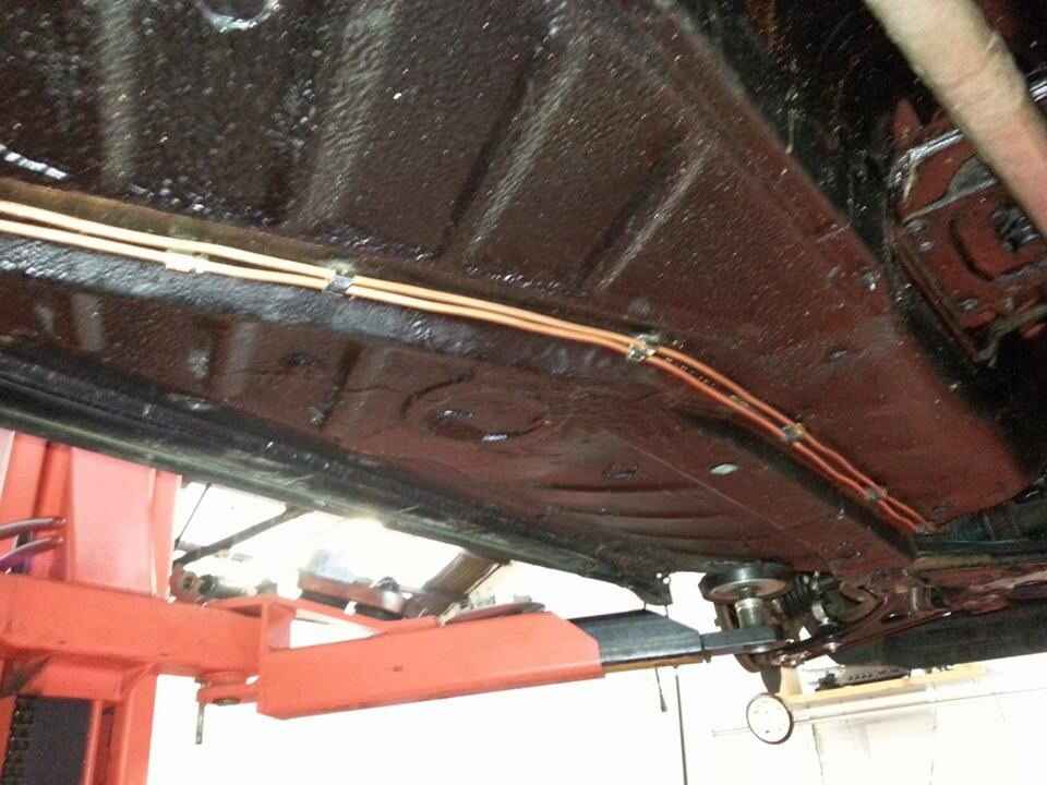

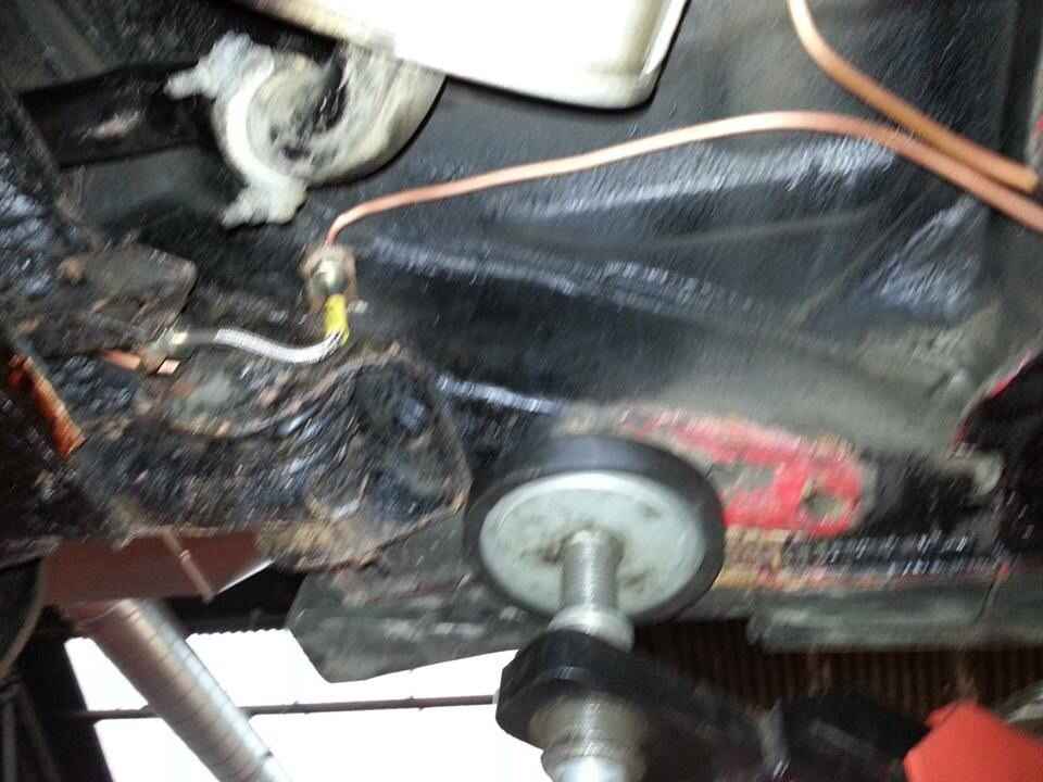

Well loads has happened to this but all under the surface I rolled the rear arches and trimmed the arch trims so I longer get rubbing from the tyres. I then completely removed the exhaust and refitted because who ever did it before done a crap job and it leaked from every join. I then set about setting the timing and fueling and nearly got ot spot on leans out a bit on higher rpms but I will be getting bike carbs after winter. I then set the suspension up a bit better set all the corner weights so equal on each axel as the front is slightly lower to reduce under steer the wieght was higher only down side is the heavy steering but it handles amazing. Fitted a small rev gauge and a limiter just to make sure if dont destroy the engine. The diesle conversion is still on the cards and will proberly happen next year some time.

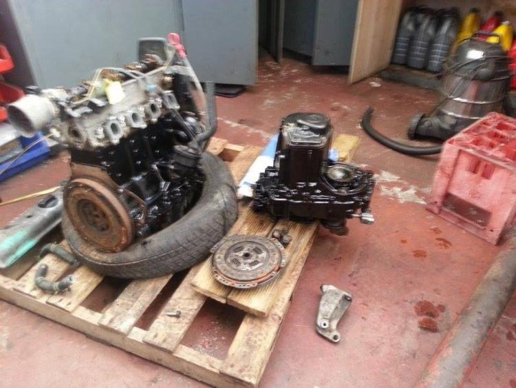

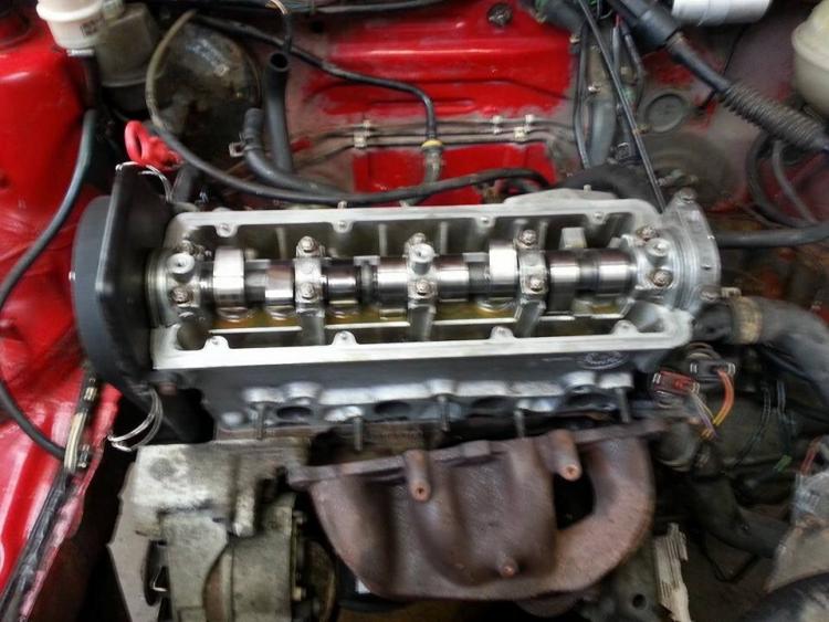

Update time. So someone on here was selling a gt head gearbox and Newman 272 with vernier pulley so I couldn't resist buying it after a 6 hour drive I returned home with my bargain parts. Couple days later I took the head into work and stripped it down to find out it had been ported and polished to a very high standard so I got it checked to see if it was flat and it was so win win there. So the weekend came and I set about fitting the head and cam. post-118433-0-15020400-1382808348_thumb.

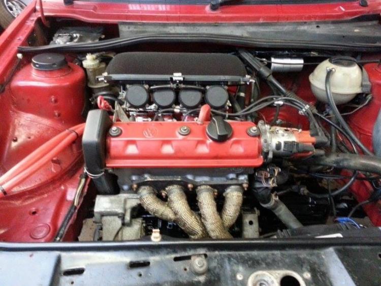

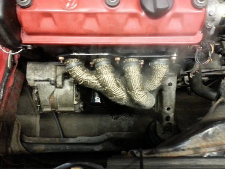

So I got it all timed up and put back together still on the crappy pie burg carb and lovely cast iron goodness they called a manifold. So after a major busy week at work I then decided to start chopping a 4 branch up from a polo to make fit this. They don't sell one for the small block golfs and the polo one needs shortening a lot were it joins the exhaust as the jetta one goes over the subframe. So about 10 hours of chopping grinding welding I got it down wrapped it in some titanium heat wrap to help keep bay temps down then whacked on but of a pain beings it's welded to the loop that goes over the sub frame so you have to remove the front crossmember.
post-118433-0-79572300-1382808623_thumb.
Overall not a bad couple off weeks. I have welded a lambda boss in so i will be fitting my afr gauge tomorrow and can then set fuelling accurately instead of guessing. Then go about setting the timing up. Next weekend will probably involve removing the crappy poo berg to be replaced with some goodness.

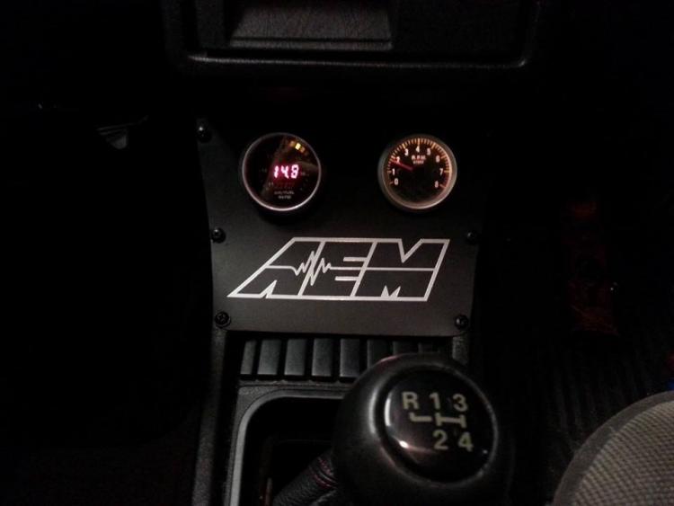

Well I planed on getting the guage fitted up early this morning then over slept then thought I would watch moto gp before I get started. So finally arrived at my garage at 12 o'clock I was just gunna mount it in a vent something nice and simple. But then had a great idea to make a switch panel to cover the storage compartment that would also hold two gauges. I already had my rev gauge mounted there in a pod type holder. So I set about making a plate cut the holes out then only to find out that the rev gauge couldn't be mounted like this so I then modified that gauge and made a holder and welded it to the plate. So got both gauge mounted up then got all the wiring hidden and lambda in.
post-118433-0-50401700-1382902381_thumb.
Not bad for a few hours work nice and clean install. Left enough room at the bottom for switches if I choose to add later most likely be for fuel cut off and ignition cut off and possibly a start button just for the cool factor.
Also I'm glad I spent the money on the gauge as I learned that the thing was running super lean after the addition of the head cam and manifold. It also doesn't like to tick over so will be setting it up tomorrow after work.
Edited by mattieboi6n
14.7 isn't it meant to be, where did you get the gauge from mate if you don't mind me asking, I've sceen a few for sale recently lol, nice jetta mate :) are you planning on keeping the 4 speed?
Wel if it staid at 14.7 it would be fine but once warm and off fast idle went up to 16-17 so not good at all. I got it of the bay and cost £150 couldn't recommending more it's an aem item and was simple to install. I have already changed the box just never changed the knob. Haven't had time to make a aluminium one yet. Ideally the afr needs to be around the 13 for ultimate performance 14.7 is for emissions it's the best mixture for the cleanest burn.

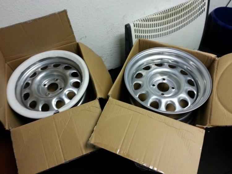

Christmas came early a few days back with parcel force delivering some bullet sixties 15x7 for the front 15x8 for the rear. I was looking for some Porsche wheels but there all over 450 and most with strecth tyres which I didn't want for this as I plan on doing a few track days and maybe some passes at the pod. I looked and looked and found nothing I liked if u guys have seen my polo u will see I'm can of steels so got opted for some bullets.
post-118433-0-09803300-1385924863_thumb.
So I needed some tyres to go with em. So I found a cracking deal on some toyo proxes t1rs and went for 205/50's to give no strecth up front and minimal strecth at the rear which I will still need to get the the clearance on the rear arch. Am yet to fit them as the weather is turning shit and don't wanna damage em. A pic of the rear tyres fitted
