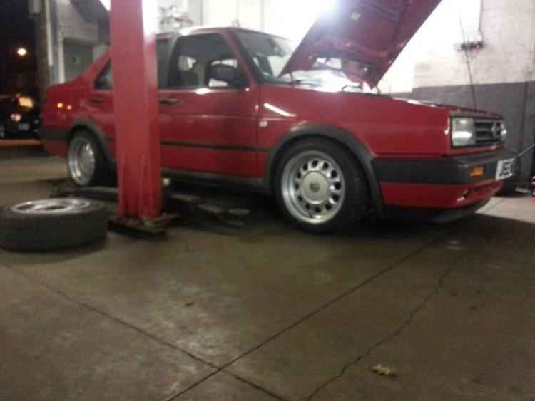

Fitted the wheels today as I got bored at work.
post-118433-0-37608300-1386019270_thumb.
Look much better and really grip well I'm glad I went with the tyre size no more understeer coming out of a corner. And a bad note I need new coilovers these seem to have lost there dampening there where secondhand when I got them and have lasted over six months so can't complain.

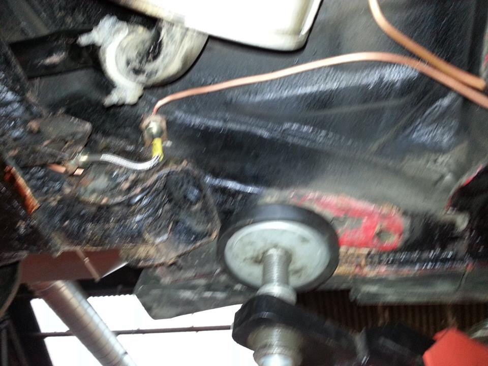

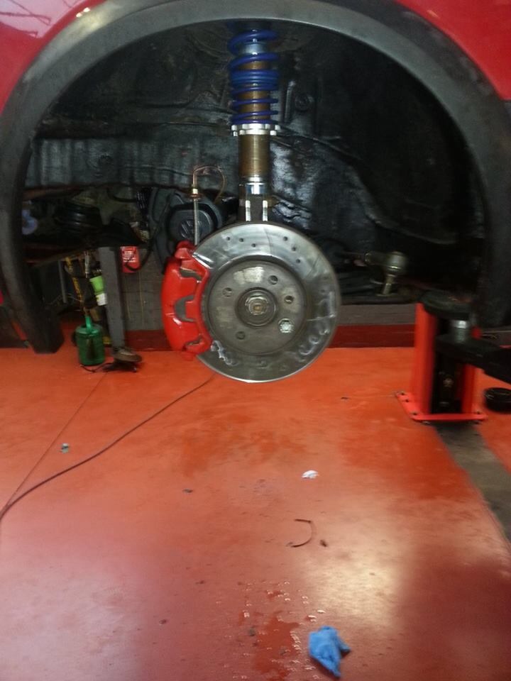

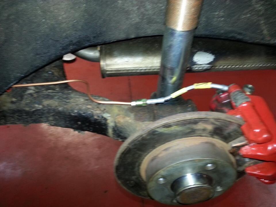

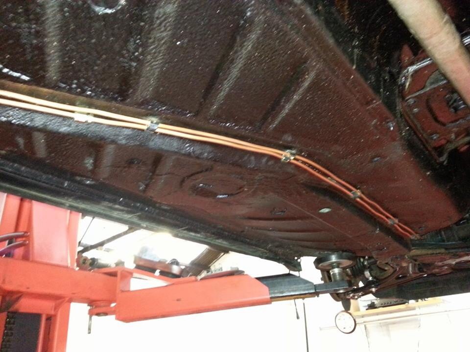

Well small update. I say small but it was a lot of work trying to make this all fit. With this being a budget car and trying to keep costs down. I needed some bigger breaks as the old 1.3 items were no longer up to task. So with some one local breaking a polo gti I gladly hot the whole brake set up. So while work was shut over Christmas I set to it and started fitting soon after I realised I would run into trouble. The first was the ball joint instead of being a pinch bolt fixing it was threaded for a nut to go on so I quickly got two ball joints for 6n2 gti the offered em up to the lower arm and what would u know they don't fit so loads of measuring and then drilled to new fixing wholes in the ball joint and done. Well no that was just one hurdle bolt drive shafts up and it locks the hub so off it all comes then I start removing the material from the drive shaft and some from inside the hub and pow it all fits. The rears was fairly simple all that was needed was some conversion braided lines as I was using the mk4 platform calipers and I had already sauced them. So replaced all the metal brake lines and all the rubber hoses with braided lines. Along with replacing the m/c with the one from the gti. When said like this it doesn't sound much modification but it took about 3-4 days of straight work. But the out come was spot on the brakes now work spot on with a great pedal feel. Here's a few pictures for those who still read this
.post-118433-0-00380500-1389647891_thumb.post-118433-0-31250400-1389647911_thumb.post-118433-0-23209200-1389648326_thumb.post-118433-0-82924900-1389648463_thumb.

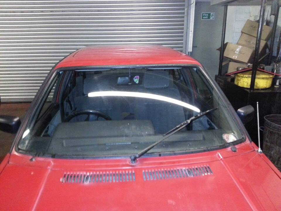

Also did a single wiper mod cost was £0 as I just modded the original linkage to give a full sweep post-118433-0-17812000-1389648591_thumb.
Since then I have straightened the wiper arm and fitted a bigger blade.
