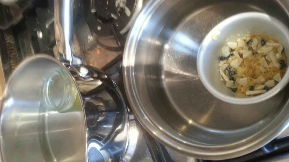

Aaaannnd another batch!
post-913976-0-52009900-1395060386_thumb.
This one is far less greasy! And has an awesome shine if we get some rain I will check the beading
Shame my paintwork sucks so much balls
