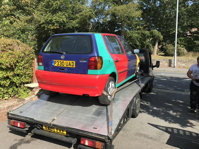

Well I sold it and now I've bought it back! Needs a bit of welding done because it was put on air 😩 But not long and it'll be back on the road and the restoration will continue 😁 Luckily the previous work I had done has held up well! Needs a machine polish to get it back up to scratch though.

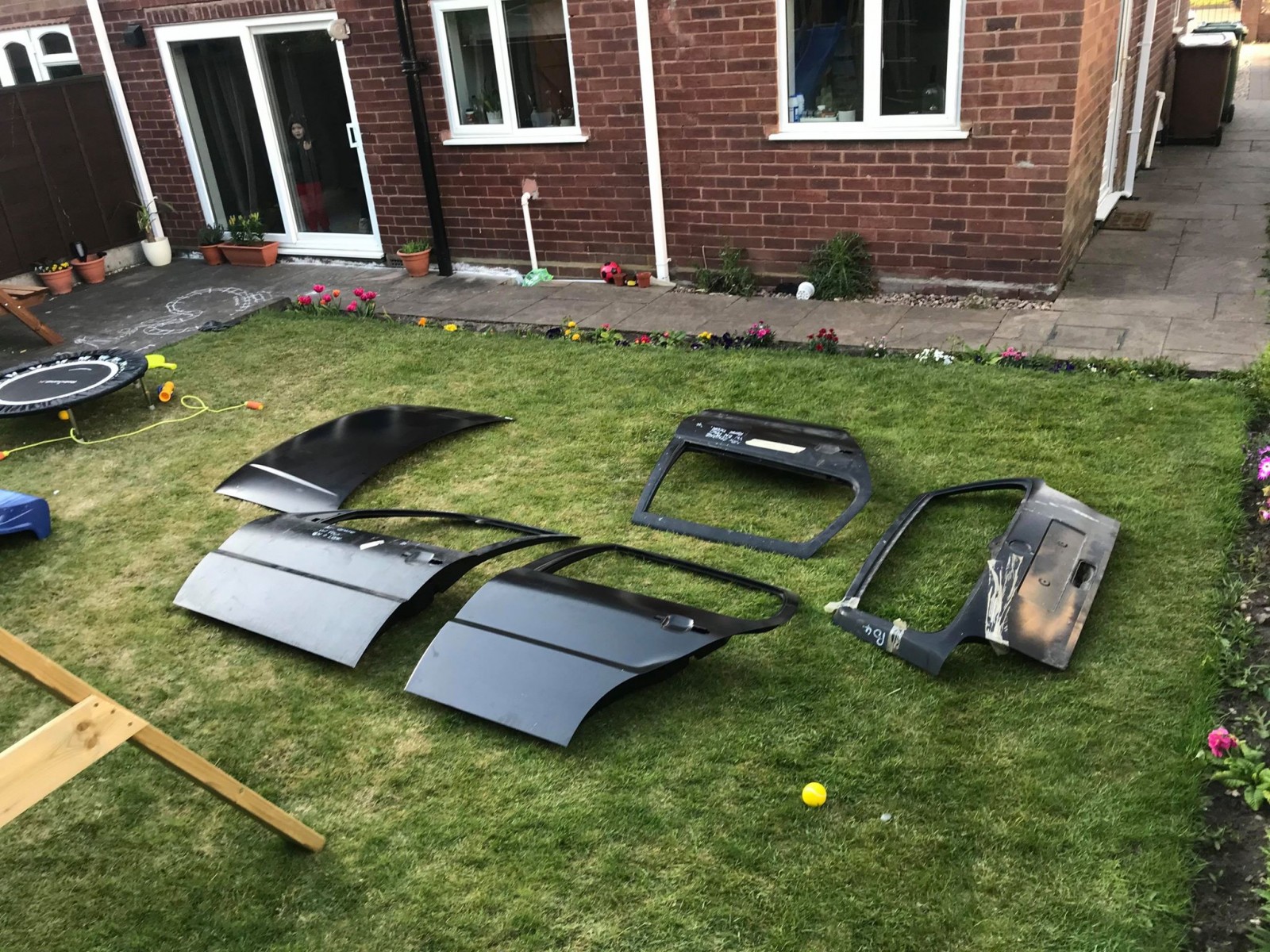

As a result, I've bought all new genuine VW panels (bonnet, wing, doors, boot). I am only missing one door (driver's side door) so if anyone has a new 6n door in their shed collecting dust give me a shout 😄
Now the Harlequin isn't that rusty but all panels have been painted a few times before with varying quality and products. Most panels have minor surface rust so I thought why not go all new?

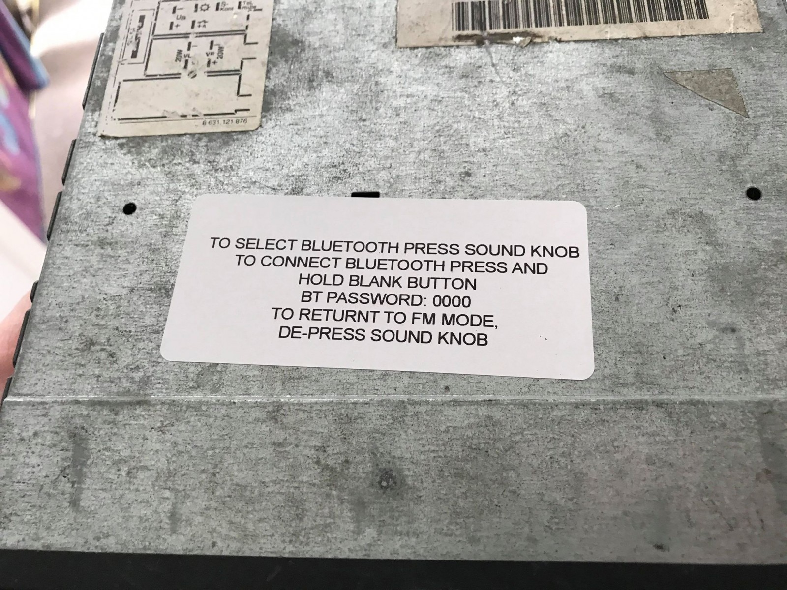

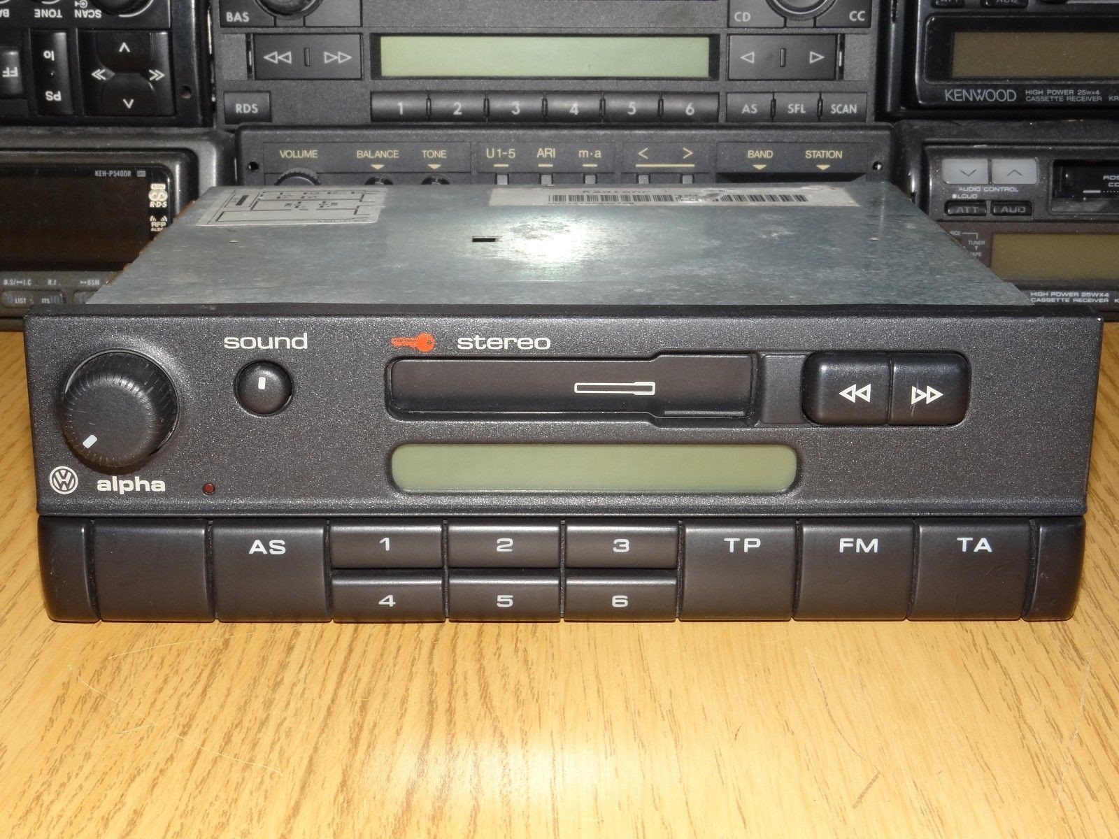

I also picked up an OEM radio. Now I couldn't live without bluetooth now. After searching for a bit I found this! An OEM radio with bluetooth retro fitted!! It cost the same price as a standard one from germany as well! Very pleased!

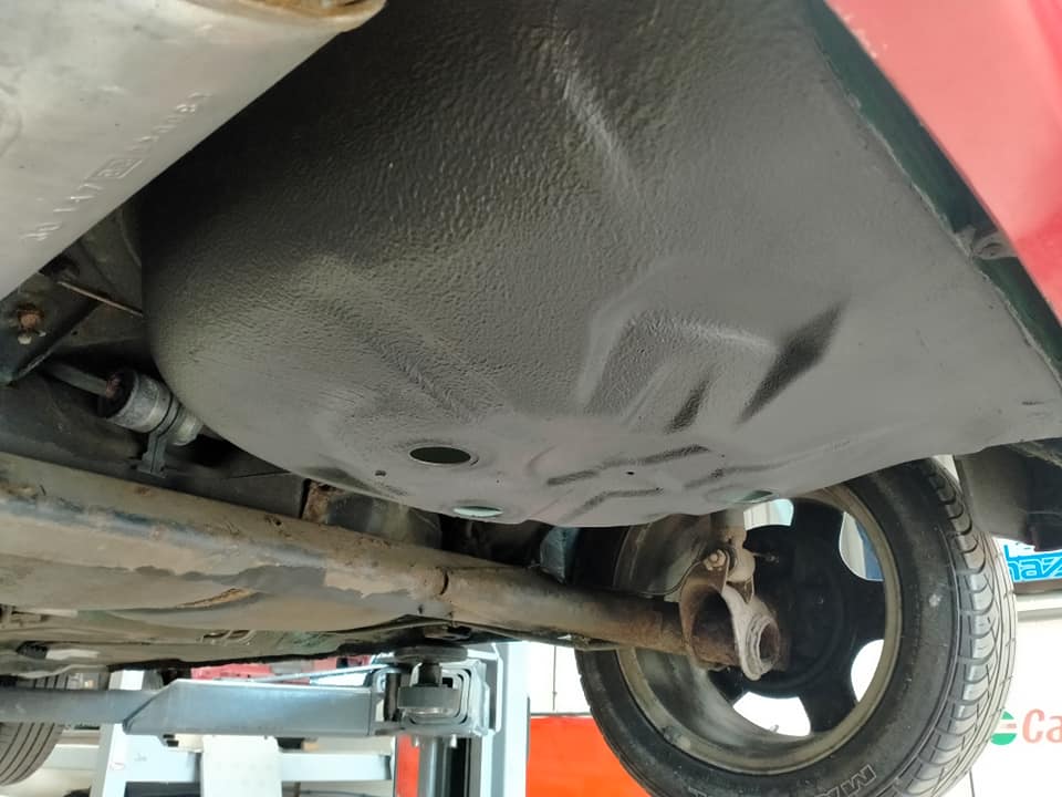

Well I've had a lot going on since I last updated this but I finally found the time to get it booked in and have the work done. Can happily say it's now fully MOTed, taxed and insured ready to enjoy!
All work was carried out by DFTR Automotive in Dudley (near Merry Hill). This is the second car of mine they've done welding work on and they are exceptional. Very nice guys and their work speaks for itself.
It's had:
- New cat
- Oil + Filter change
- Auxiliary belt
- Front brake pads + discs
- All new brake pipes on the rear
- New ignition switch (cause of the starting issue mentioned by someone earlier on)

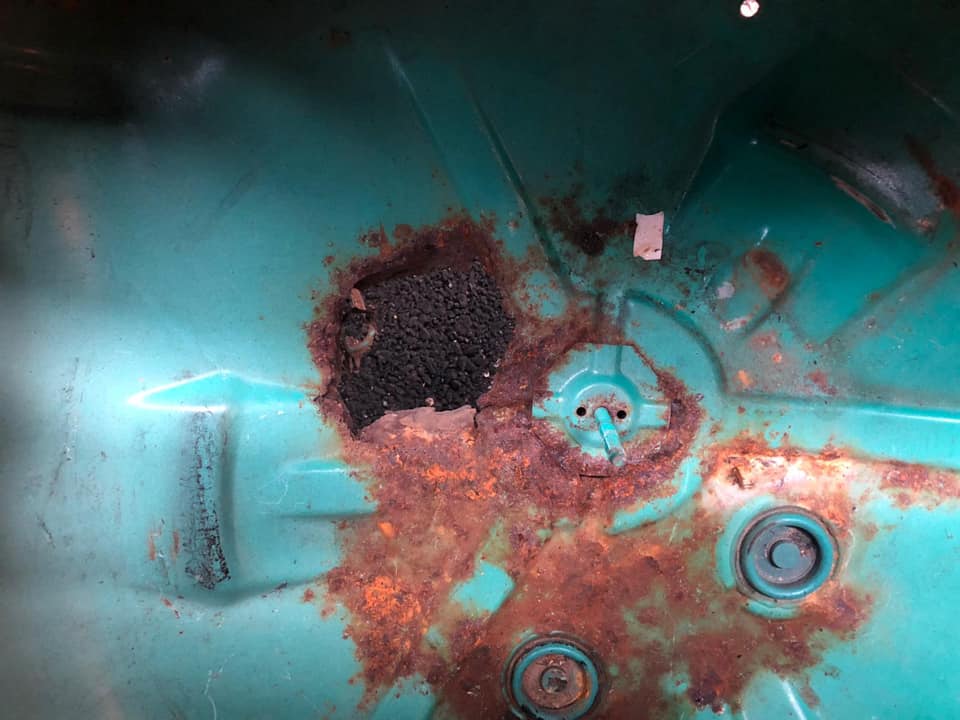

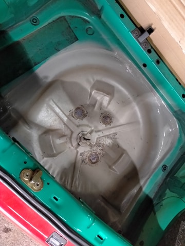

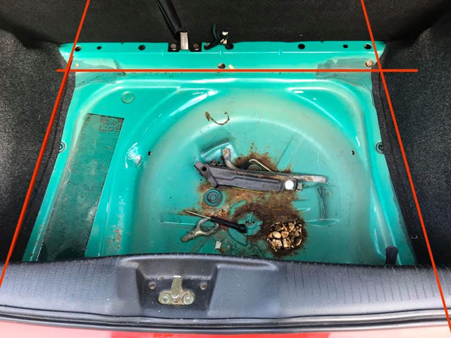

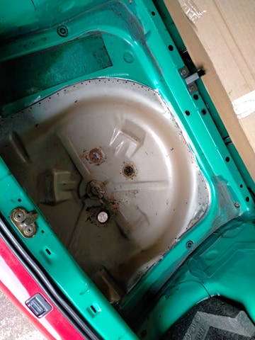

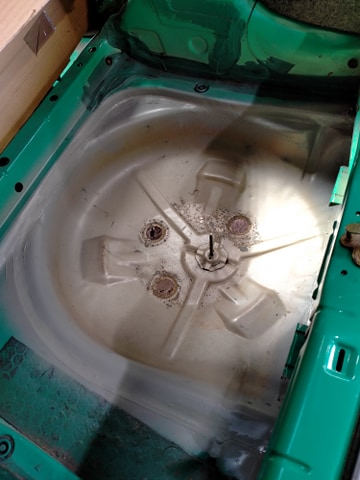

- New boot floor welded in

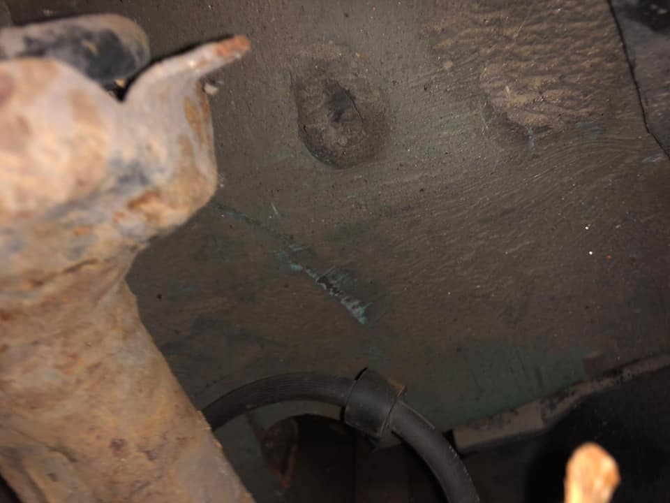

- Chassis notches welded over
- Repair in the rear inner arch
The car underneath is now completely solid and it drives faultlessly (famous last words).
Plans for the near future are to paint the welding work body colour, new tyres (current ones are a bit old) and need to get my new wing resprayed and fitted.
Boot before:
Mocked up:
Welded up:

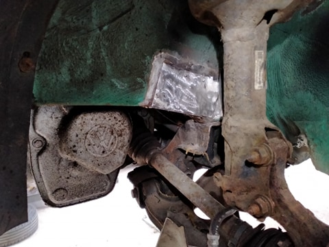

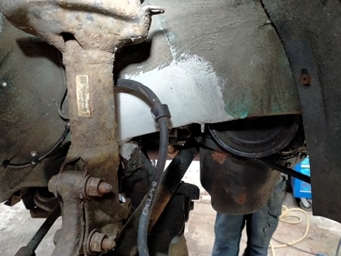

Chassis notch before (still gutted that this could have been avoided!)
During/done:

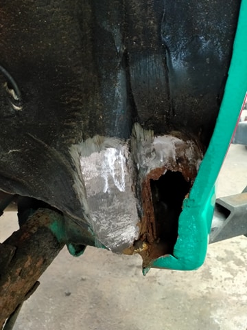

Only have a before for the inner arch repair. They cut out the rust and made a repair panel, will get an after photo on the weekend:

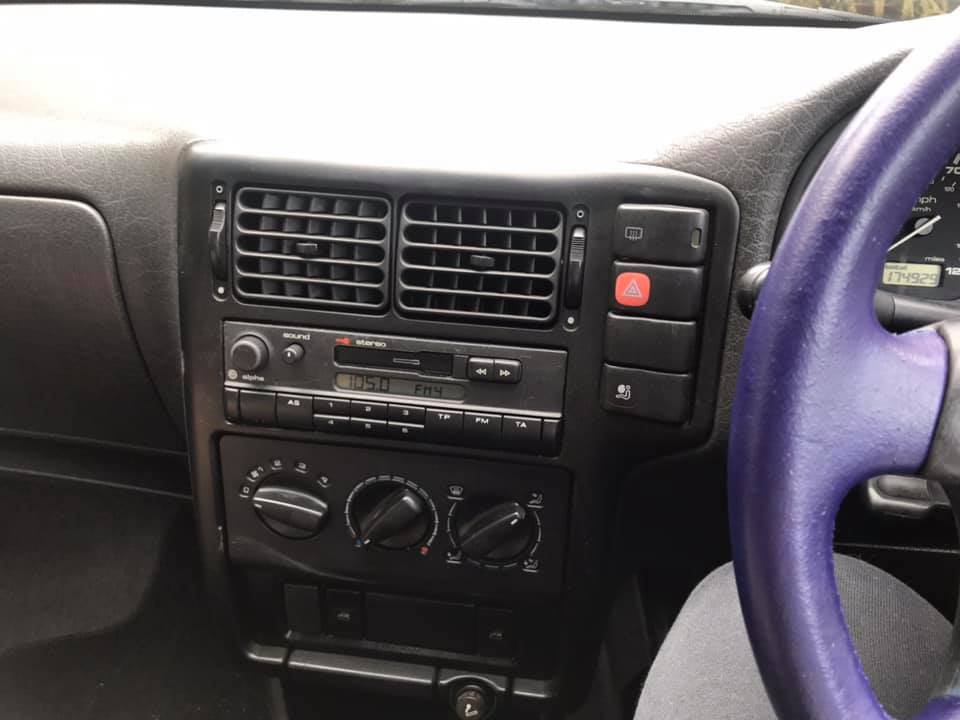

Also fitted the radio I bought ages ago. Bluetooth works really well and is easy to use once you've figured it out. Much nicer than some modern multicoloured thing (the irony 😅)
Edited by VdoubleU
  • 8 months later...
Where did you find the oe radio with bluetooth , have been looking for a while but no avail !
