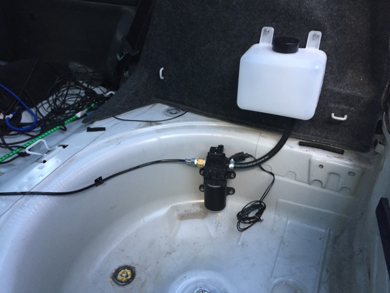

One of my next planned mods is to run water methanol injection. I could (maybe in heindsight should) have purchased a pre assembled kit from the likes of devilsown, AEM, Aquamist etc etc. However I decided to give it a go myself with making a kit.
So so far I have:
- 12VDC pump compatible with meth.
- Tank (drilled hole for tank fitting and level sensor)
- Lines/fittings/check valve
-Nozzle
Ive already run the lines in the car so that part is done. I've all but finished thecontroller now. Using an arduino nano clone, small ish project box to fit it in.
The basic concept is for the pump to come on when the car reaches a set boost pressure 7psi for now, once this condition is met the pump will start at my set minimum duty cycle of 50%, it'll then ramp up the duty cycle as the airflow through the MAF increases. I've taken a voltage feed from the MAF and MAP sensors for this. By looking up the maps for these I was able to determine at what voltage I'll see what boost for the map and airflow for the MAF.
Here it is as it stands now. Need to make up the adapter look for MAP and MAF then wire it all together.
guess this is my own DIY progressive controller.
