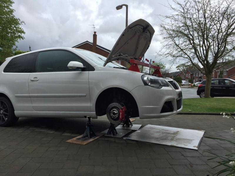

  • Finally given it a wash and also fitted the new brakes all round         Motul RBF660 gone in :) very happy with the pedal feel and with how the brakes now look

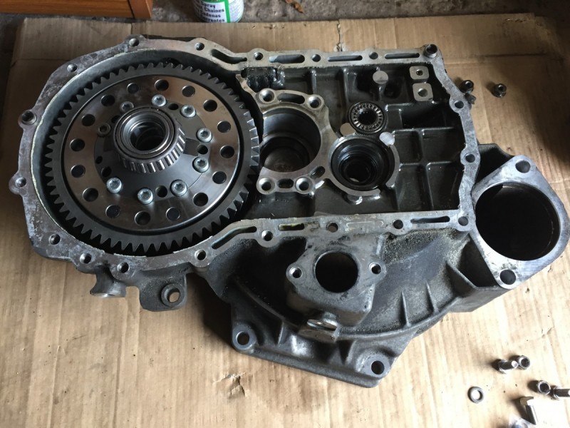

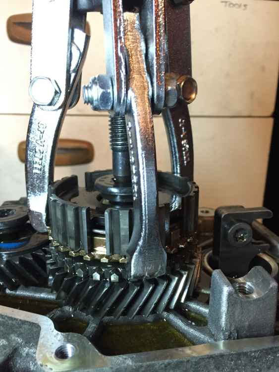

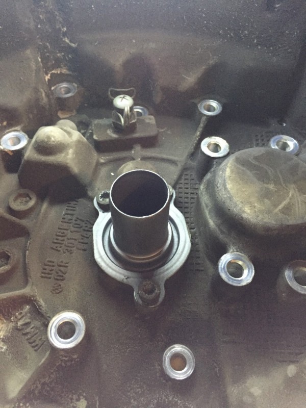

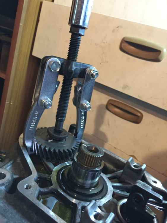

Picked up a spare gearbox box for the polo with the intention of rebuilding, replacing bearings and possibly some worn synchro rings if need be and the all important addition of a LSD (brand TBC)
Never stripped a gearbox in my life so was pretty keen to give it ago. Below are some pics of the tear down as it happened. Modified a set of pullers to get the 5th gearset off, once that was done it was fairly plain sailing. Hopefully I can source some
beaeings and give the box a proper refurbishing whilst it's apart, may as well donit properly since it requires so much effort.
Choice of bearings will likely be SKF or FAG as this is what they seem to use from factory. It's all but stripped now but thought to update, I needed to strip it before buying a diff to be sure I was actually able to do it! Can't wait to build it back up, pointers from any experts on here would be handy also as I'm new to messing with gearboxes.
I was a tad careful and proof marked a lot of the bits that I removed, I also marked up and bagged all the components to be sure the right bits go back where they should and not just where they may fit :P

In in other news - the differential is out of the box along with the standard bearing races and diff seals.

Crown wheel is now separate from the standard open diff and ready to be bolted to a new unit.

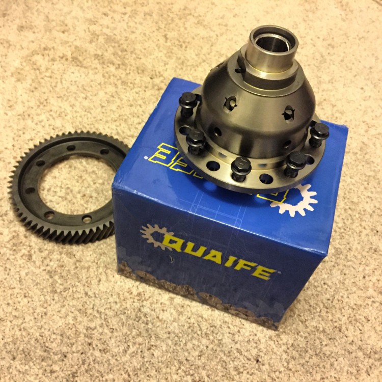

Diff arrived today! Went with the Quaife ATB LSD from TSR performance - must say delivery was super quick, paid for mid day and arrived next day so pretty good I'd say.

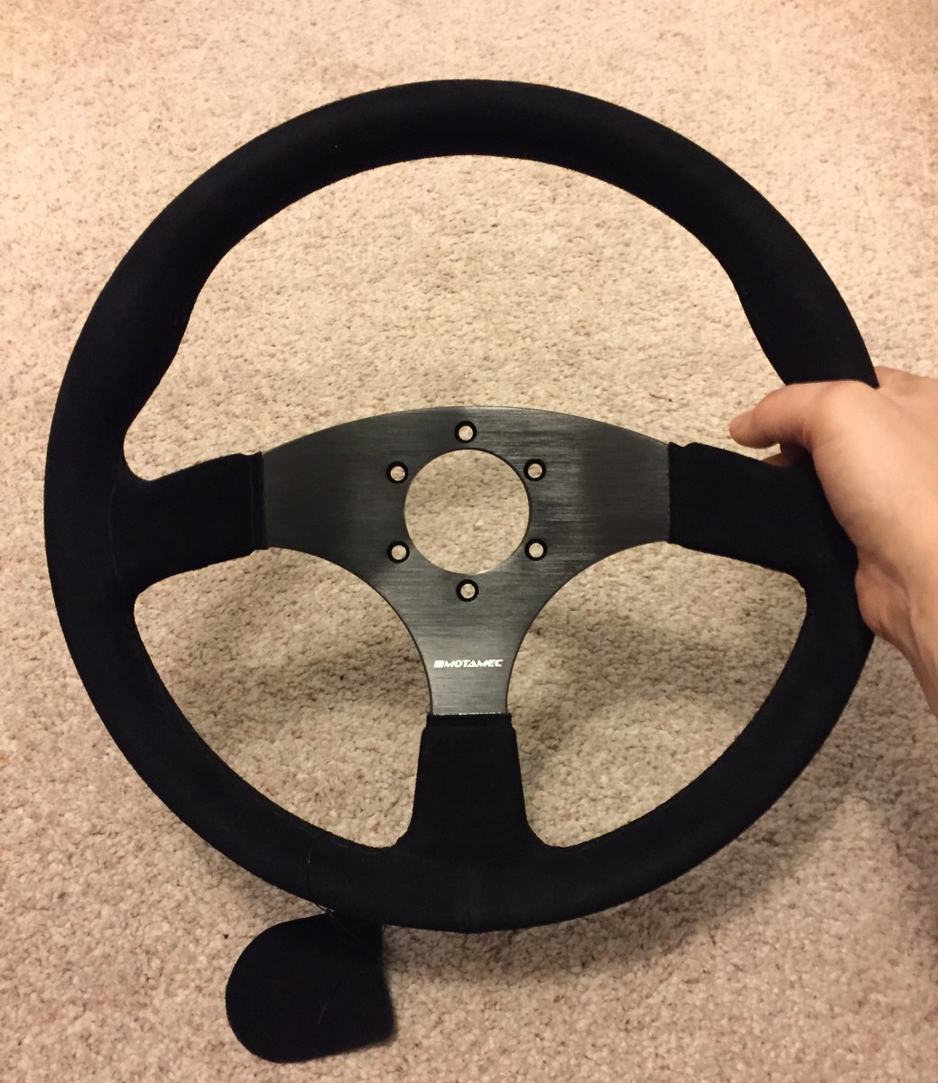

Something new :D
350mm wheel pretty much flat, 5mm dish if that. Should be a bit better to drive with in tighter corners!

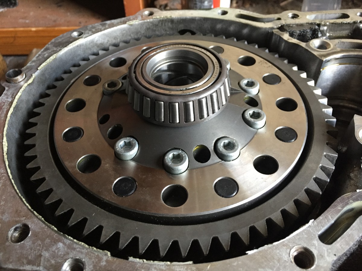

Ordered and fitted the diff bearings, crown wheel now bolted to the diff!

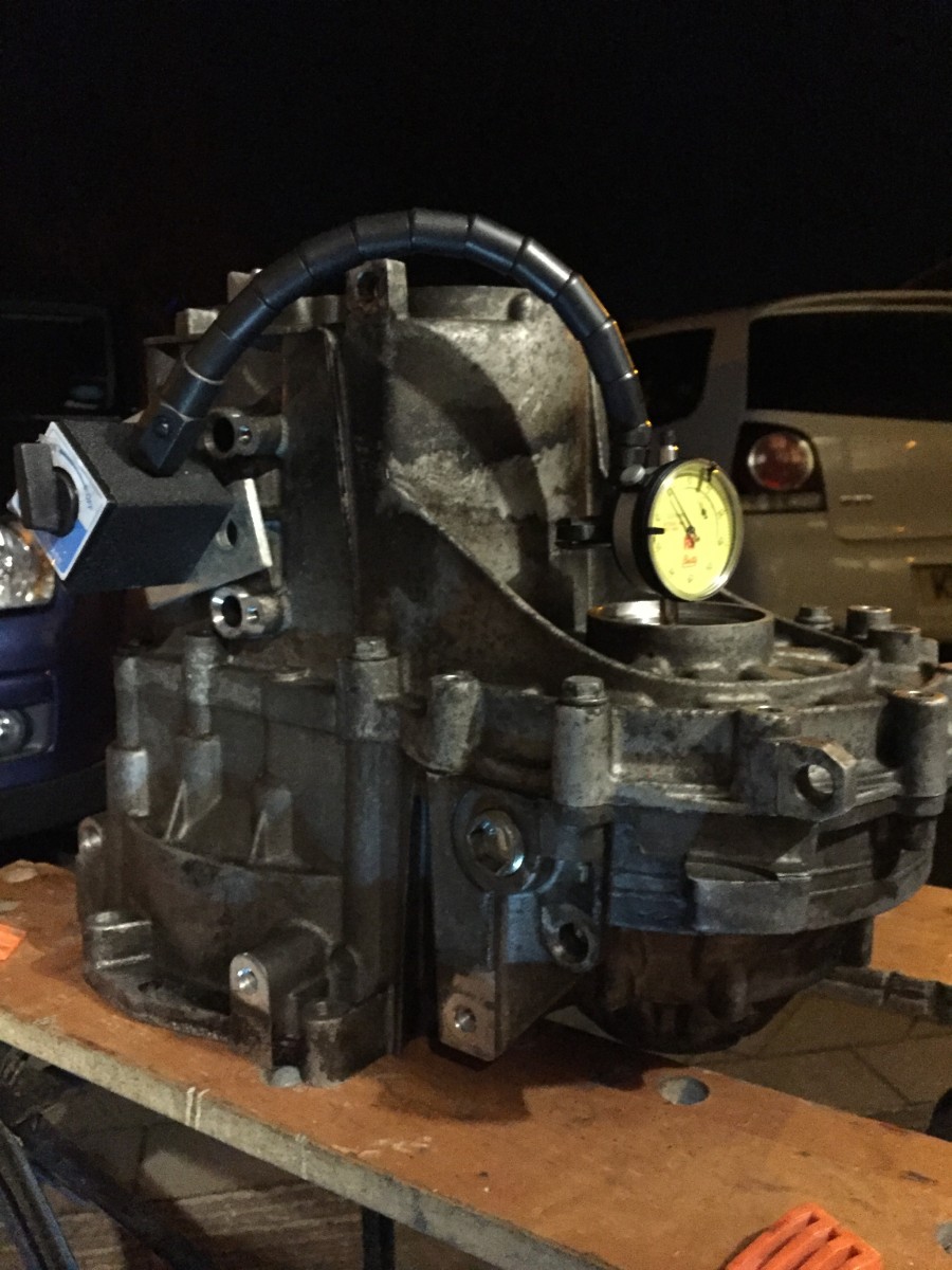

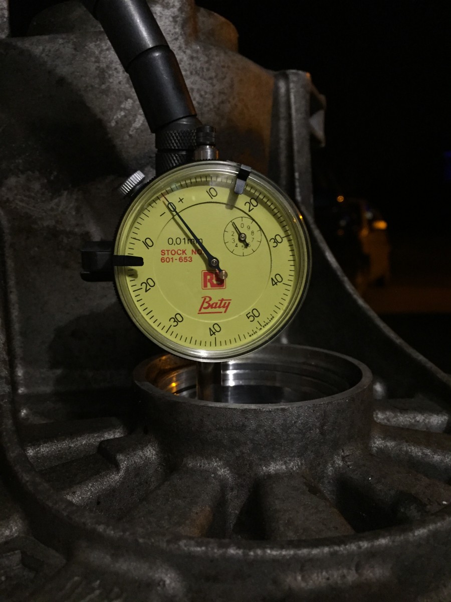

Started to re assemble the box and checking the bearing play with a DTI to ensure correct shimming of the diff. Do it once do it right ;)

Checked the play in different positions just to eliminate any errors. Was getting about 0.43mm play so will shim according to VW specs as taken from elsawin!

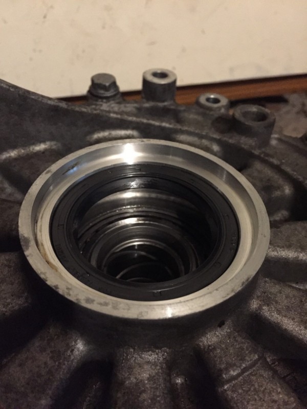

pics of newly fitted spare seals. It's had new diff housing seals and a whole new input shaft seal just for peace of mind! 5th gear with new bearing and sleeve.

Fitted the steering wheel and boss kit over the weekend since we had such good weather so here's a couple of pics.

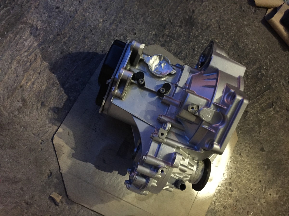

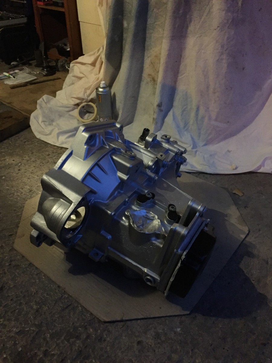

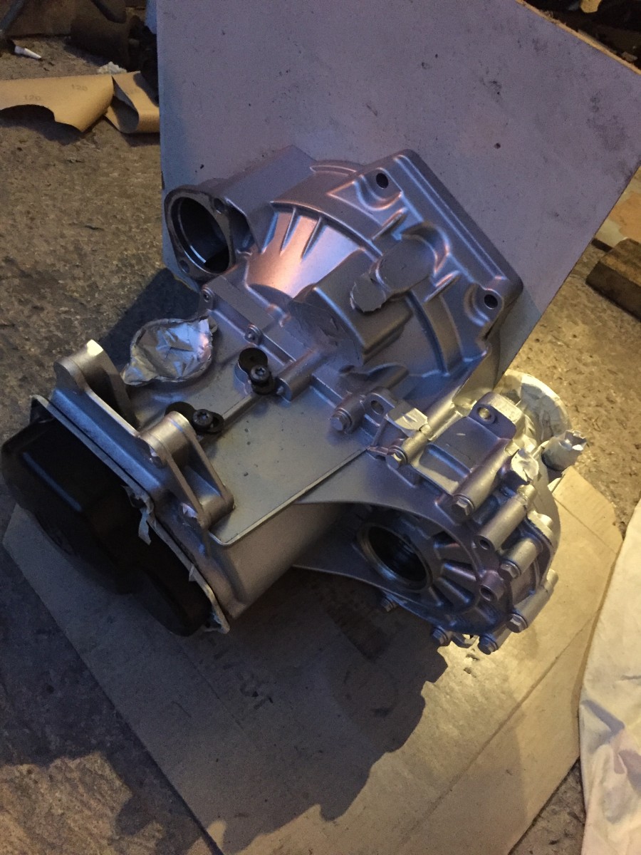

Started cleaning the gearbox at the weekend and eventually got round to giving it some paint. Decided just to go an OEM silver with the gearbox rather than anything fancy.
Ordered some fuchs sintofluid gearbox oil via Opie oils so once it's painted it'll be ready to be fitted to the car and filled with some new oil!
Need to get myself an engine brace/beam and some other bits and bobs to make the gearbox change go smoothly as I've never swapped a gearbox out before.

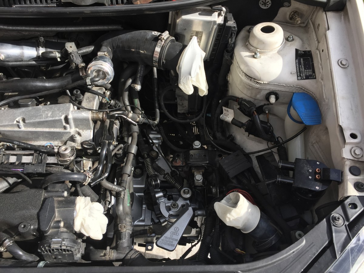

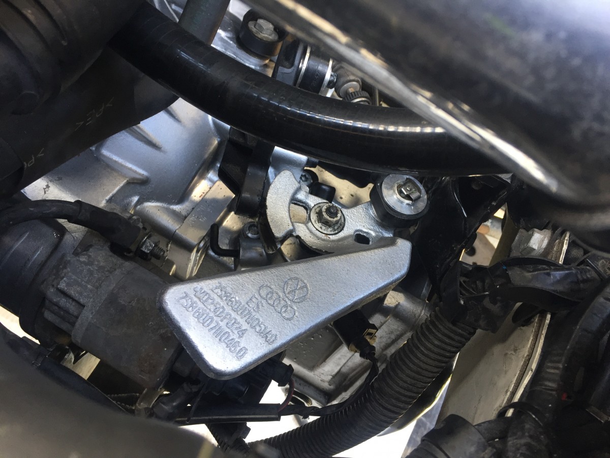

LSD box is now in and fitted. No issues so far! Filled with some fuchs sintofluid recommended to me by opie oils
Took me a while to get the box in and out as I was doing it on my own and being careful not to foul any pipework on the way in or out. Had to take breaks in between the rubbish weather.
Out with the old ? feels smoother than the old box and less of a whine, I was having a slight whine on acceleration in 1st gear which I suspect may be down to the fact the diff seems to have some minor play, very little I might add but some nevertheless. Possible plans to refurb my spare box in the event I ever run into any problems with the current box. I'm in no rush to be swapping a gearbox over again though lol

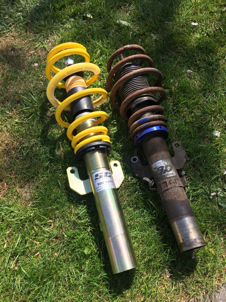

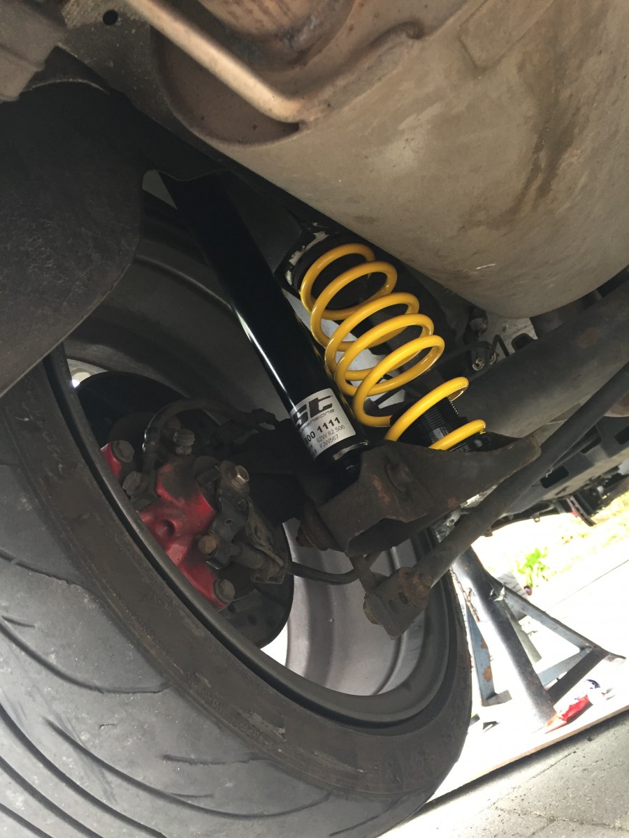

This weekends job was new suspension. I knew the AP's had been on the car for quite a while. I've had the car for 3 years and even the previous owner didn't fit the AP's and he had it for 2 years. The rear dampers eventually started leaking so it was time for a full new set up since it was looking to be about £150 for new rear dampers. I knew the fronts were old so what was to say that they would last much longer.
I went with a set of ST XA which are made bun KW and supposed to be the same as the V2's minus the stainless bodies.
They got fitted this weekend along with new droplinks. So the car has had track rod ends, balljoints and droplinks so it should be good for a decent amount of time now.
Picture of the old AP's vs new ST XA's

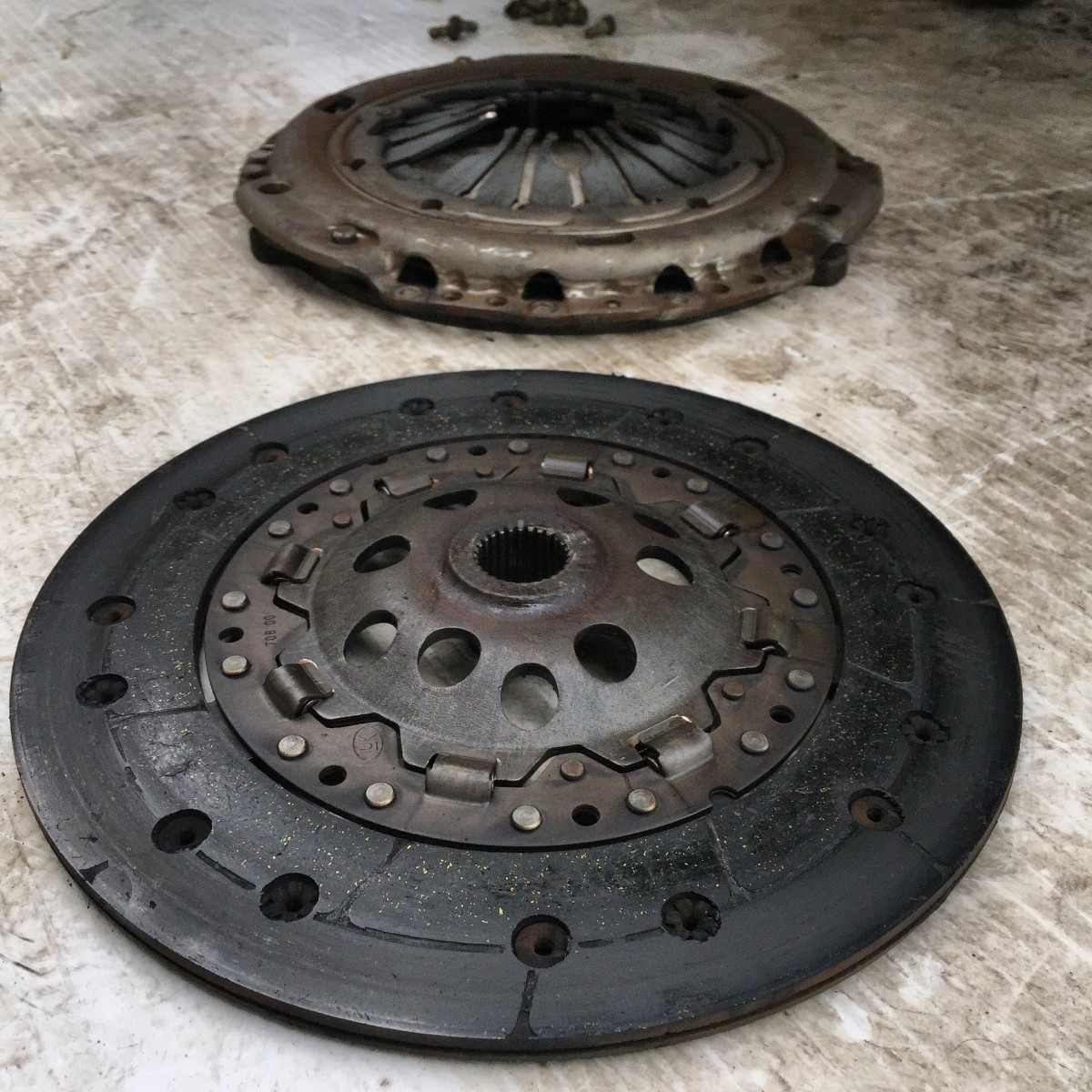

So, since fitting the diff the clutch has started to slip. Que the 'should have done it when you had the box off' the clutch had been absolutely solid up until this point so never thought it would have been an issue.
it started slipping at full throttle around 3k rpm. I promptly ordered a clutch knowing that a trackday i'd booked was just a couple of weeks away. I'm also on 24/7 callout for work at the moment so thought it best to pay someone to fit it ... that is until I was quoted £300 just in labour. So I set to work taking it apart again on Wednesday evening, had the box out that night. Last night the new sachs VR6 clutch and 7kg G60 flywheel was fitted, new flywheel bolts and pressure plate bolts all torqued to spec. Box is now back in with just driveshafts and dogbone mount to reattach.
Hoping everything is ok once totally back together.
Heres a picture of the old clutch and a picture of the new one installed.

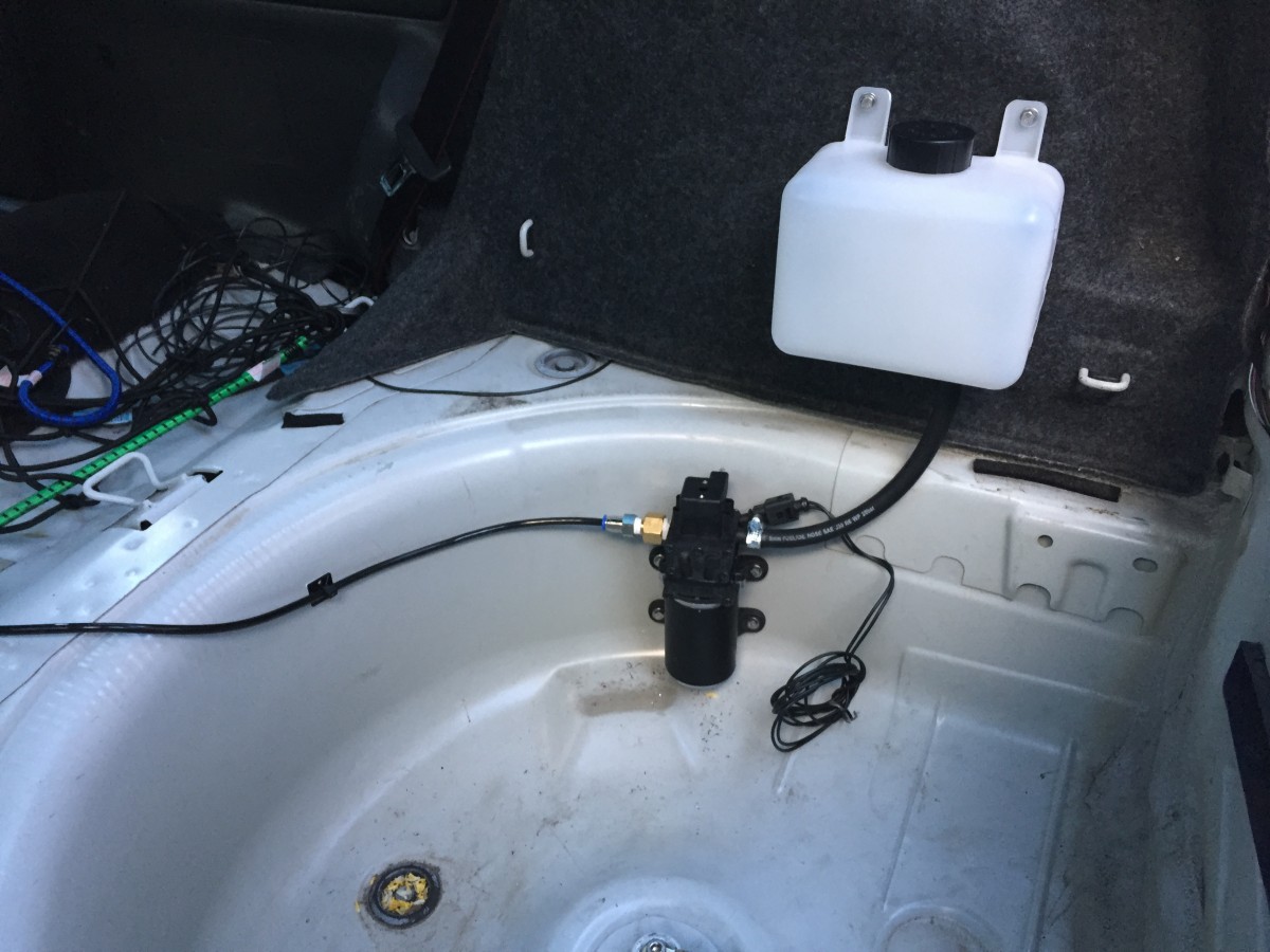

tonight I finally got round to starting the meth install, or at least the hardware side. Tank mounted, pump wiring taped up with the OEM cloth harness tape and fitted with an OEM connector ready for power once I've sorted the electronics side.
Decided to run a solenoid rather than check valve so made a bracket for that and mounted it up. Again wiring was loom taped and fitted with a nice OEM connector. Still lots to do but closer now than I was early today haha.
