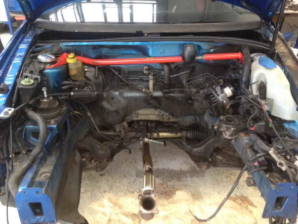

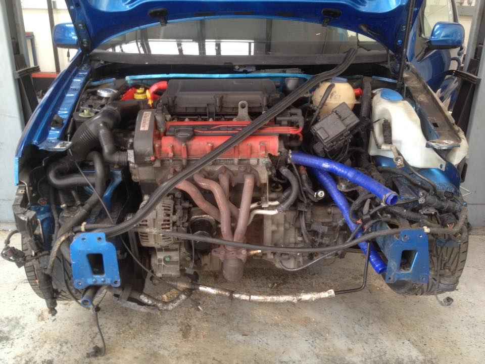

thanks :) and oh the exhaust basically I bought a 4-2-1 manifold that you can see in the pics, then I just found some 1.75" or 2" old stainless steel pipe, but you can buy it on ebay new if you want, (can't quite remember the bore size) and I welded it on to the end of the manifold, then bought a universal flexi section and welded that in-between the decated section of pipe I found as my flexi was destroyed from lows :/ then joined it onto a sportex de silenced middle section which you can buy on ebay and then I found a second hand DTM back box (which are bloody expensive new) which already had the length of exhaust that goes over the rear beam and joins up to the mid section on it... which I would expect if I bought it for the full £250+ something price that it is new, but only paid £40 and it was in really good nick :)
Fair enough :P I've actually got the same mid section on order :) now just gotta get her back on the road with a new gearbox
nice one :) hope all goes well with the box did you get a reconditioned or second hand?

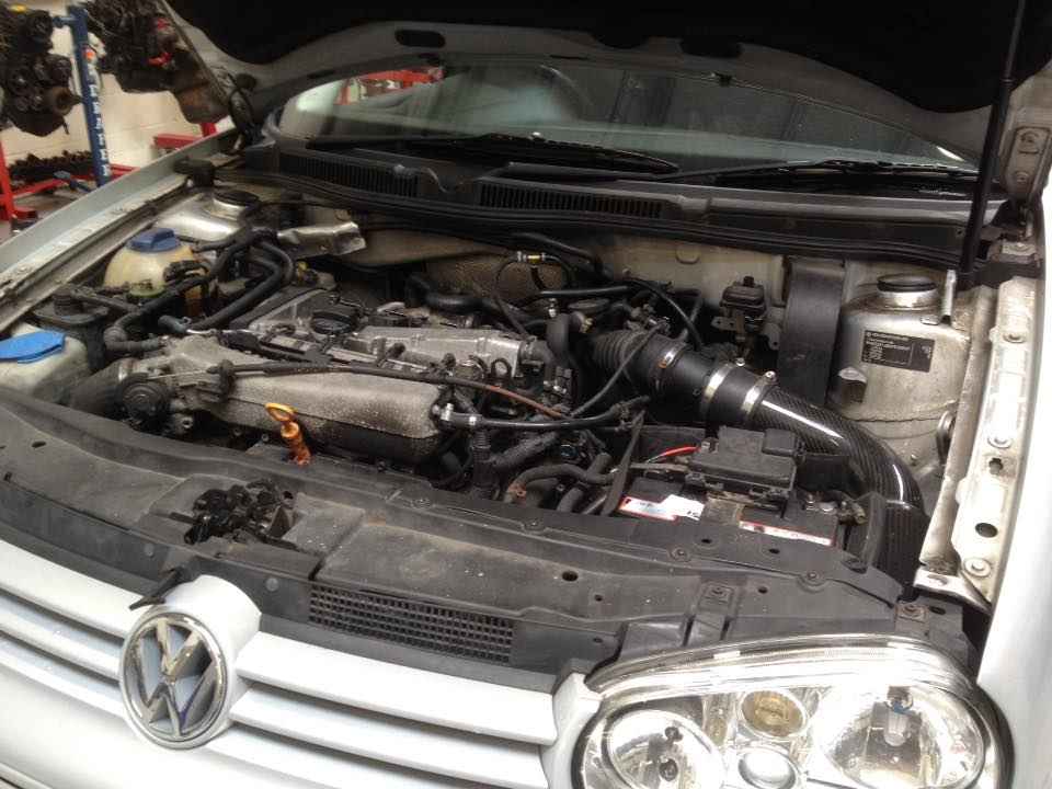

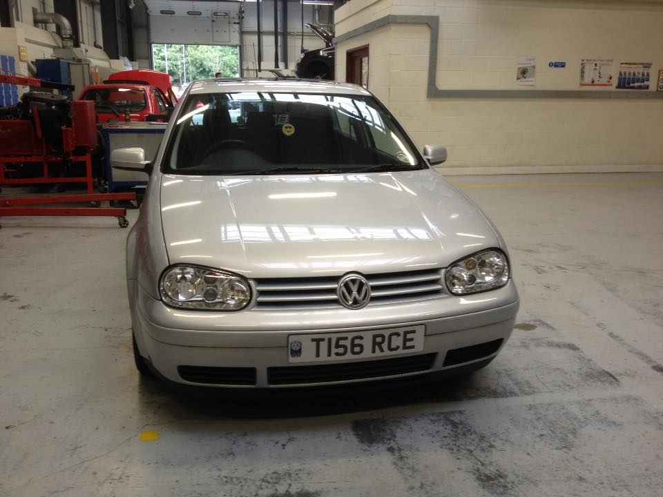

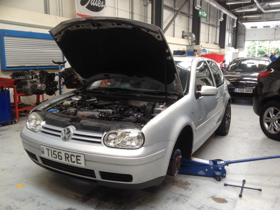

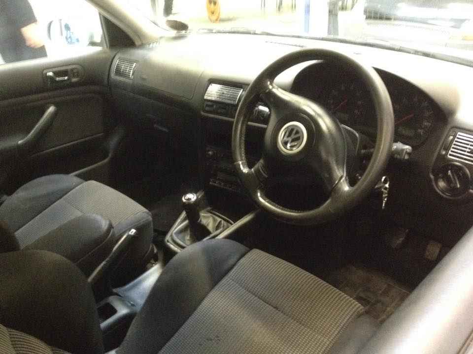

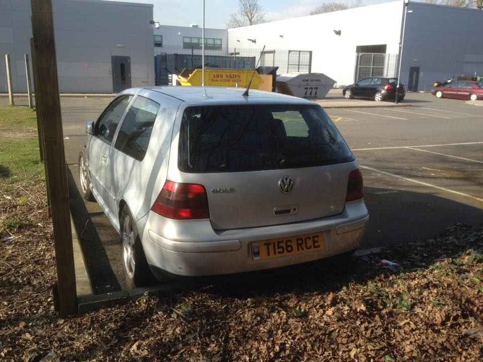

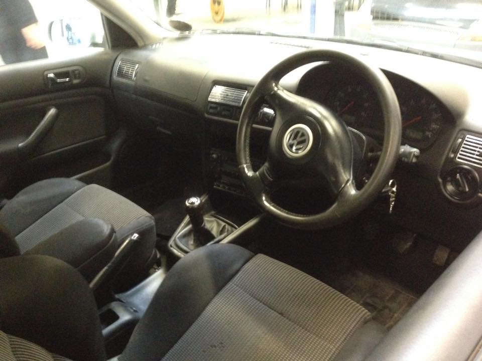

Sorry guys really been slacking with updates to this! but yeah basically I was so happy with the way the car was at this point couldn't really have asked for much more... except for power :paranoid::tongue: don't get me wrong the GTI was quite nippy, I hit 130 in it against a focus ST on the A13 during last years London tunnel run, but nothing quite delivers power like a turbo car of which the GTI wasn't... plus on a N/A your really limited to how much power you can gain from stock without spending huge money, happily however a mate of mine said he was selling his mk4 golf GTI and the temptation was really to much :unibrow: it wasn't long before I caved and bought the golf to start 1.8T'ing the polo... heres some pics of the golf the day I got it

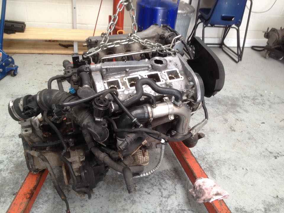

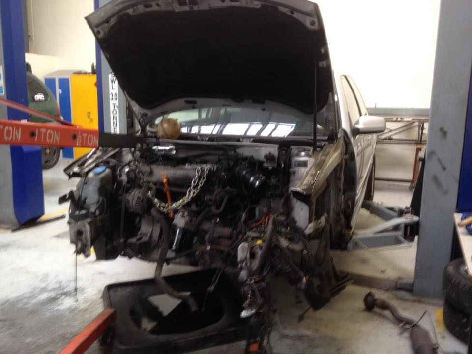

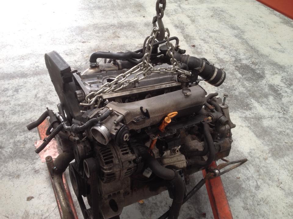

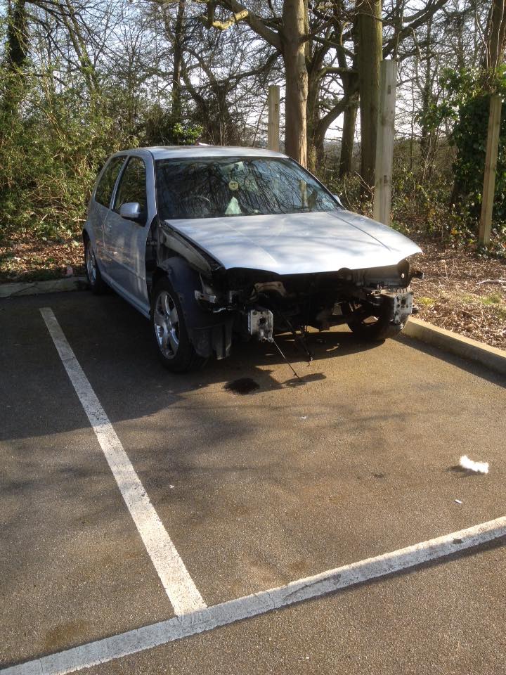

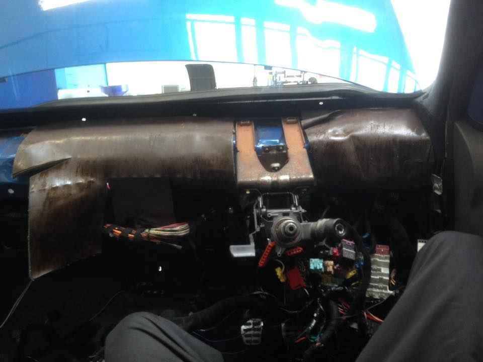

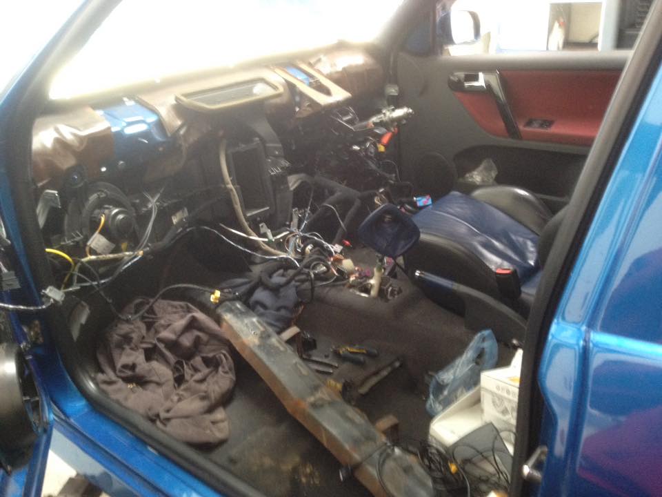

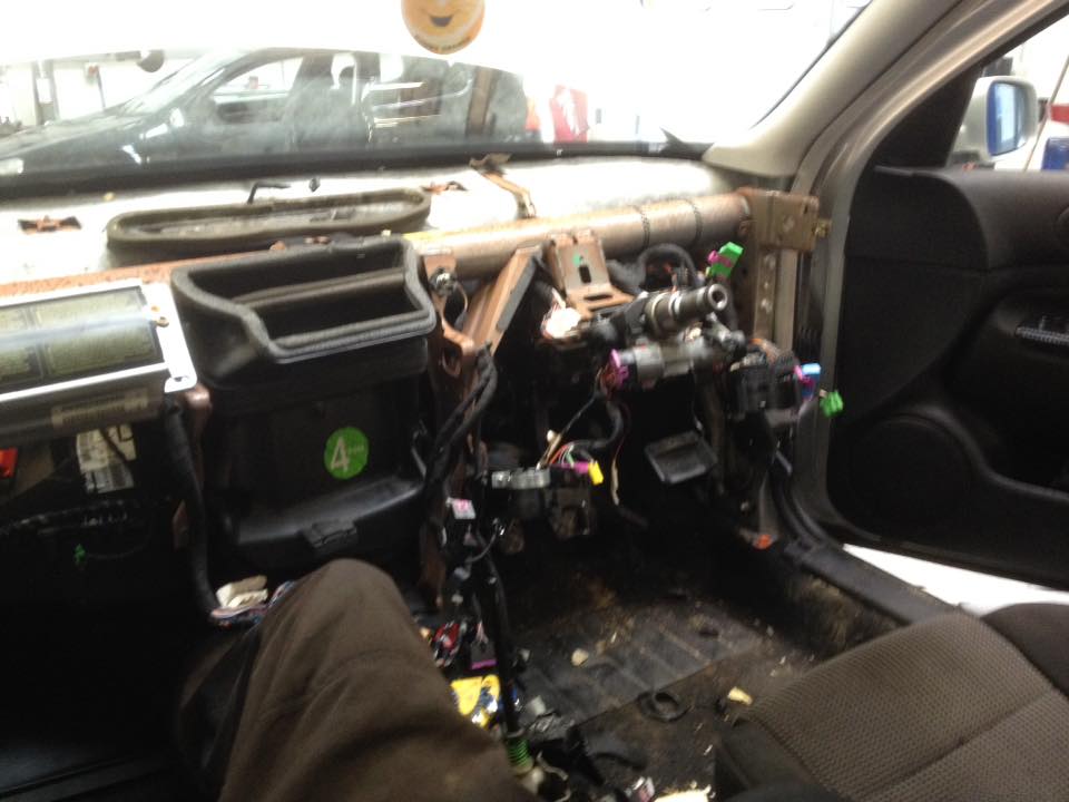

First step of any project is to strip the doner car, so I started knocking it out, got the engine and dash out first to be honest the dashboard was surprisingly easy to take out...

It's a motor vehicle course mate, the main lecturer there basically wants to see people learning through a real passion, better then mucking about not learning anything in his eyes... aslong as I do as i'm told an stay out the way its fine but tbh I don't have it that good id rather do it in my own garage (which I don't have) because here I'm limited to the time I can work on the car, kids come over an start touching the car :x and I have to endlessly push it around when teachers want to use that particular ramp or area so I mostly just do it outside anyway to save constantly moving the car... and samy I got the 1.8T out the golf I bought in the pictures above, which no will not be a straight swap and not many people have turbo charged a GTI but I have seen a couple and the engine had to be completely forged, custom exhaust manifold, custom mapping and management ECT none of which is cheap and after that it didn't produce much more power then standard, with 1.8T's skies the limit, but that couldn't do much more then 2 or 300 brake as it was never built to be a turbo engine and there's not many upgrades out there to buy for it either, and btw I've already got bigger brakes along with other things that I showed a previous post

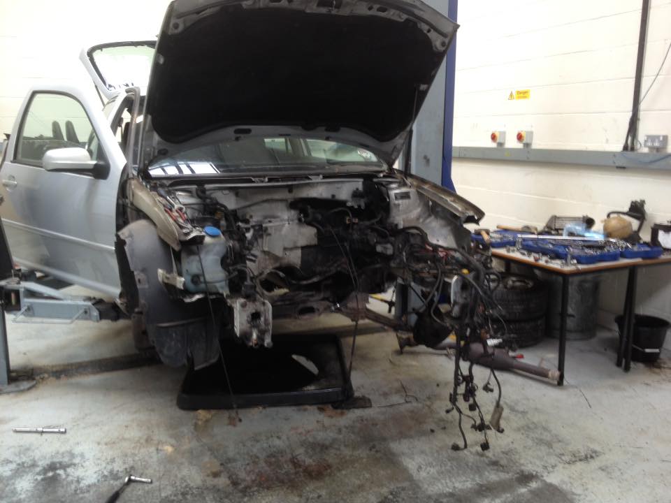

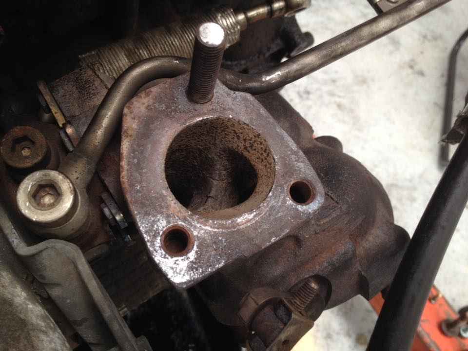

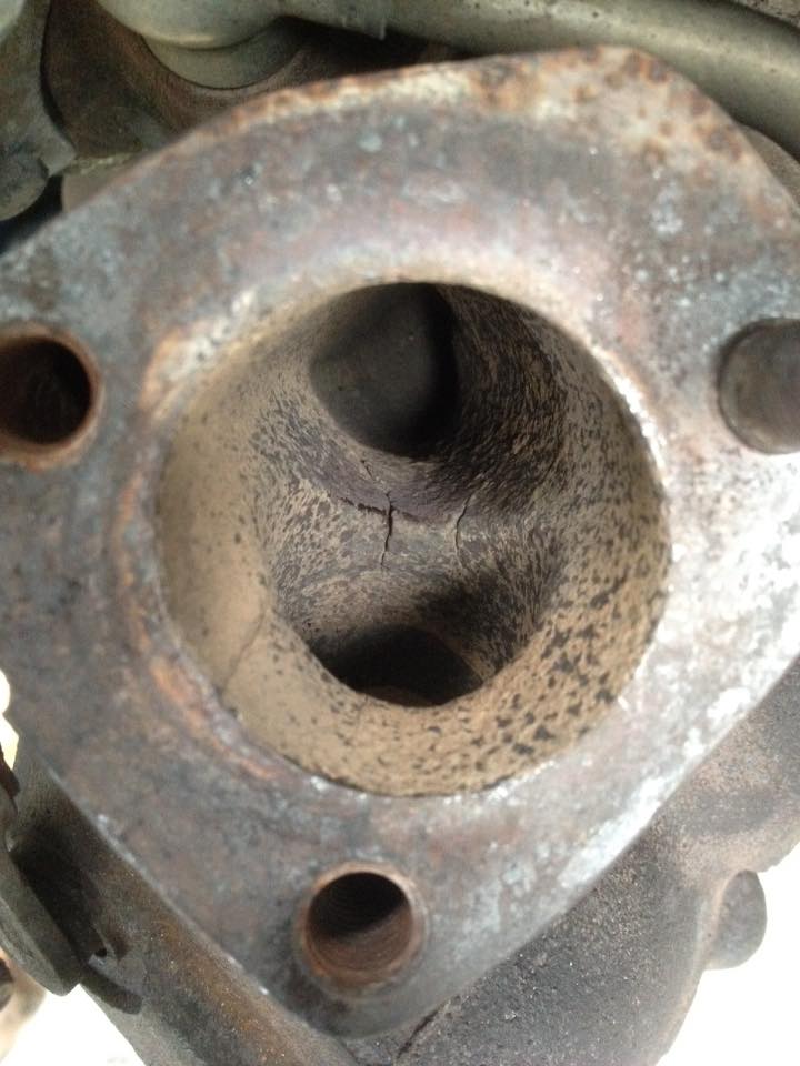

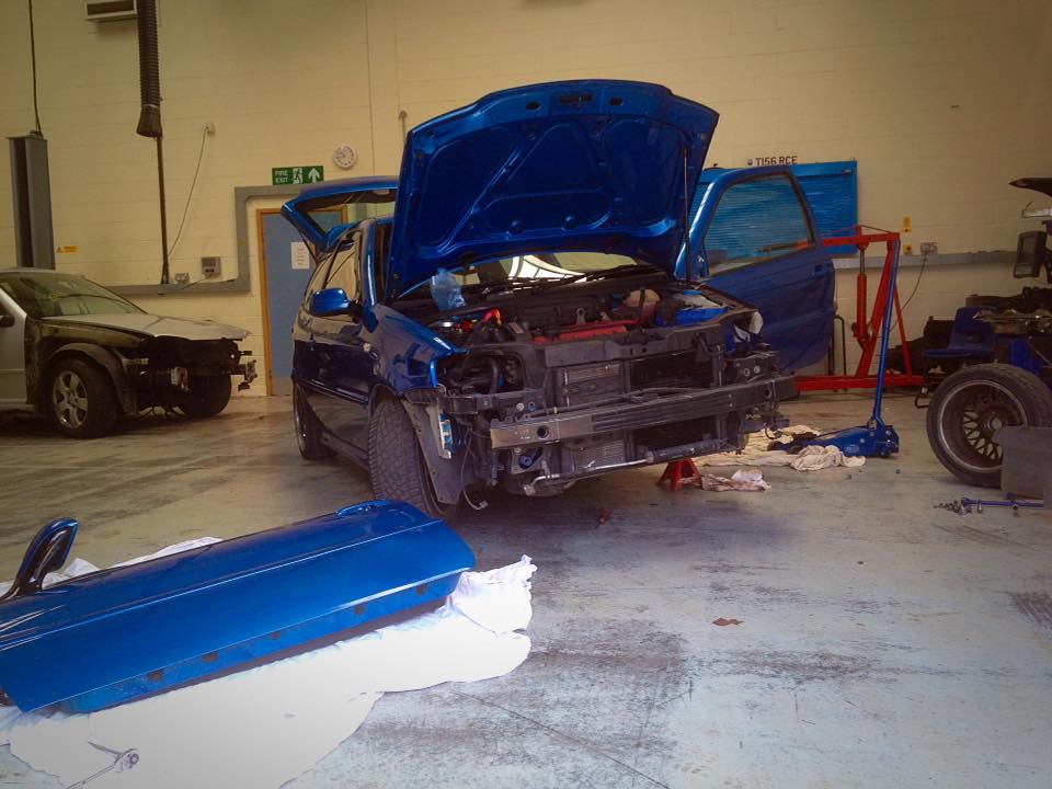

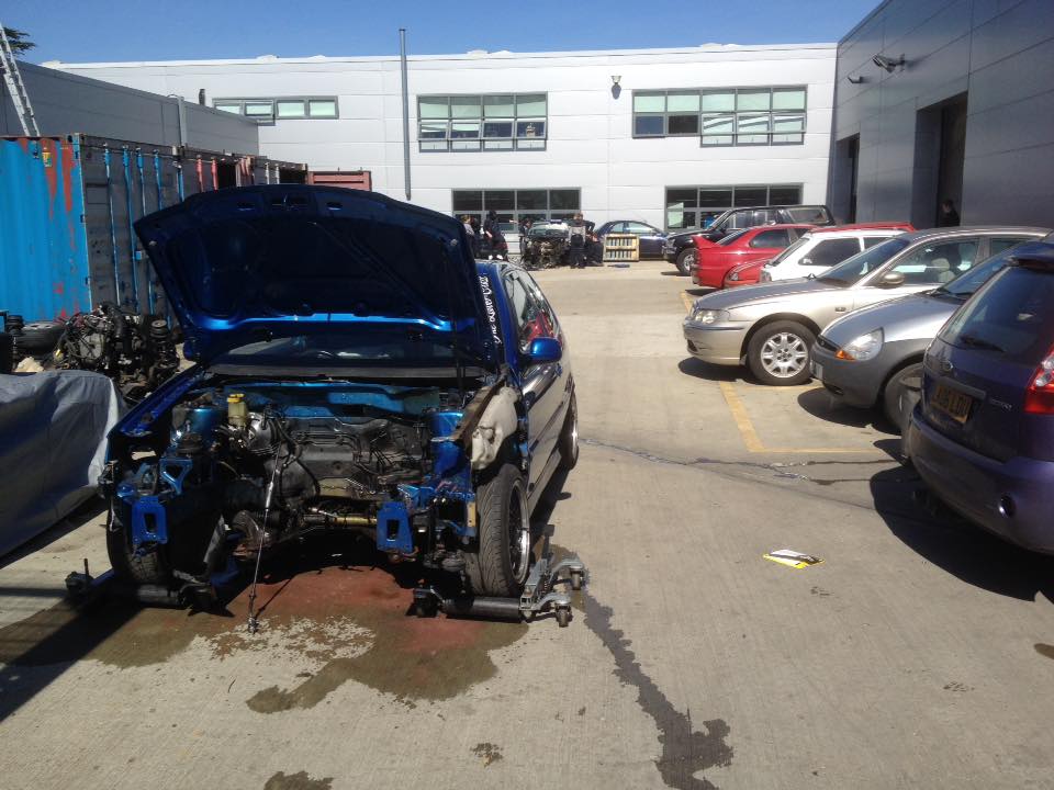

had a bit of bad luck when I checked the ko3s to find it was quite badly cracked... seeing as though there was no point putting the car back together with a cracked turbo I soon started searching for a larger ko4 setup instead :) also got the polo stripped down, engine out, dash out, loom out, and most ancillaries out aswell, basically wanted to get everything out the way so I can solely concentrate on fitting that big lump :tongue: also jet washed the bay with degreaser just to make everything allot easier and cleaner to work on!
