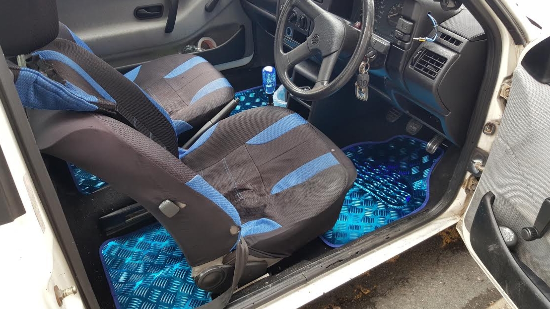

...but I bought some blue chrome floor mats, which are nice.

The chrome floor mats are interesting. Do they still have protective plastic on or are they that blueish colour?

Floor mats are indeed blue, but it's the wrong kind of blue :-( they're also terrible quality, so I'm planning on replacing em a second time with a darker blue set, and maybe throwing these in the Rover or something... :tongue:

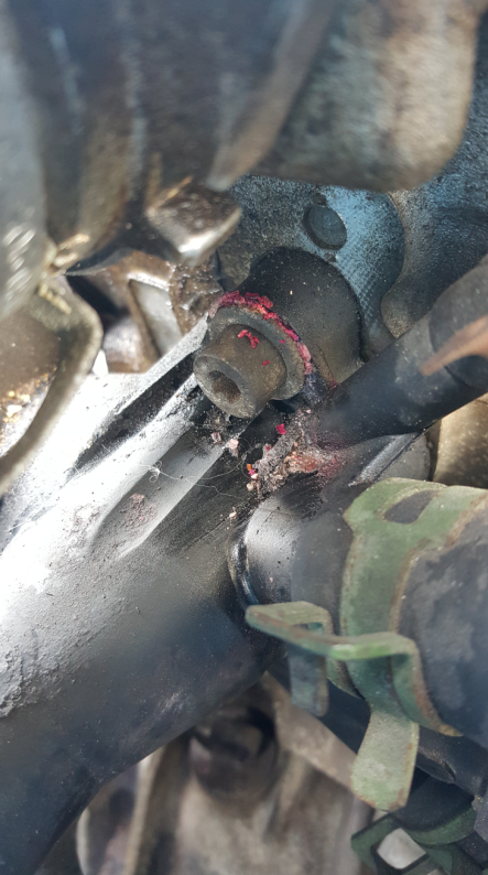

Think I've found it, noticed this today just below the distrubutor:
When you say the brakes are loud, what sort of noise is it? A high pitched squeal?
Also, I would be replacing that full thermostat housing. It could be cracked. Throw in a new thermostat whilst it's out. The bolts for the thermostat elbow might be seized in the captives so I'd order an elbow and save any hassle. And have 2 bolts ready too (m6 I believe). All parts are on eBay from KMS. Usually Febi items as well.

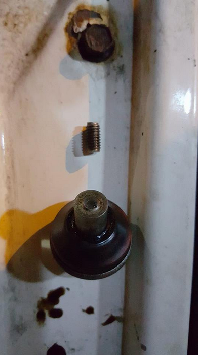

Well, I have one more tiny little problem to add to my to-do list... a snapped cam cover bolt. I'll get back to all that other stuff once I figure out whether or not I'll have to rethread the cylinder head :(
Yup they don't take much to snap. How much of the bolt is sticking out of the cam carrier?
With the pressure of the cover off it, the bolt shouldn't be too hard to wind out if you can get something on it to turn it.
Practically none - less than half a milimetre and the walls of the carrier made getting anything on the sides impossible. However, I did notice that the top of the stud was slightly uneven where it had broken off, so I tried giving it a push counterclockwise with a flathead screwdriver. It just kept slipping off at first, but eventually I got it to turn about a milimetre.
It took me 45 minutes in total, 3 screwdrivers and 2 pairs of pliers, but by 2:15 AM I managed to get the damn thing out.
You don't know what satisfaction is until you spend 45 minutes trying to remove a broken cam cover bolt at 2AM, and finally succeed.

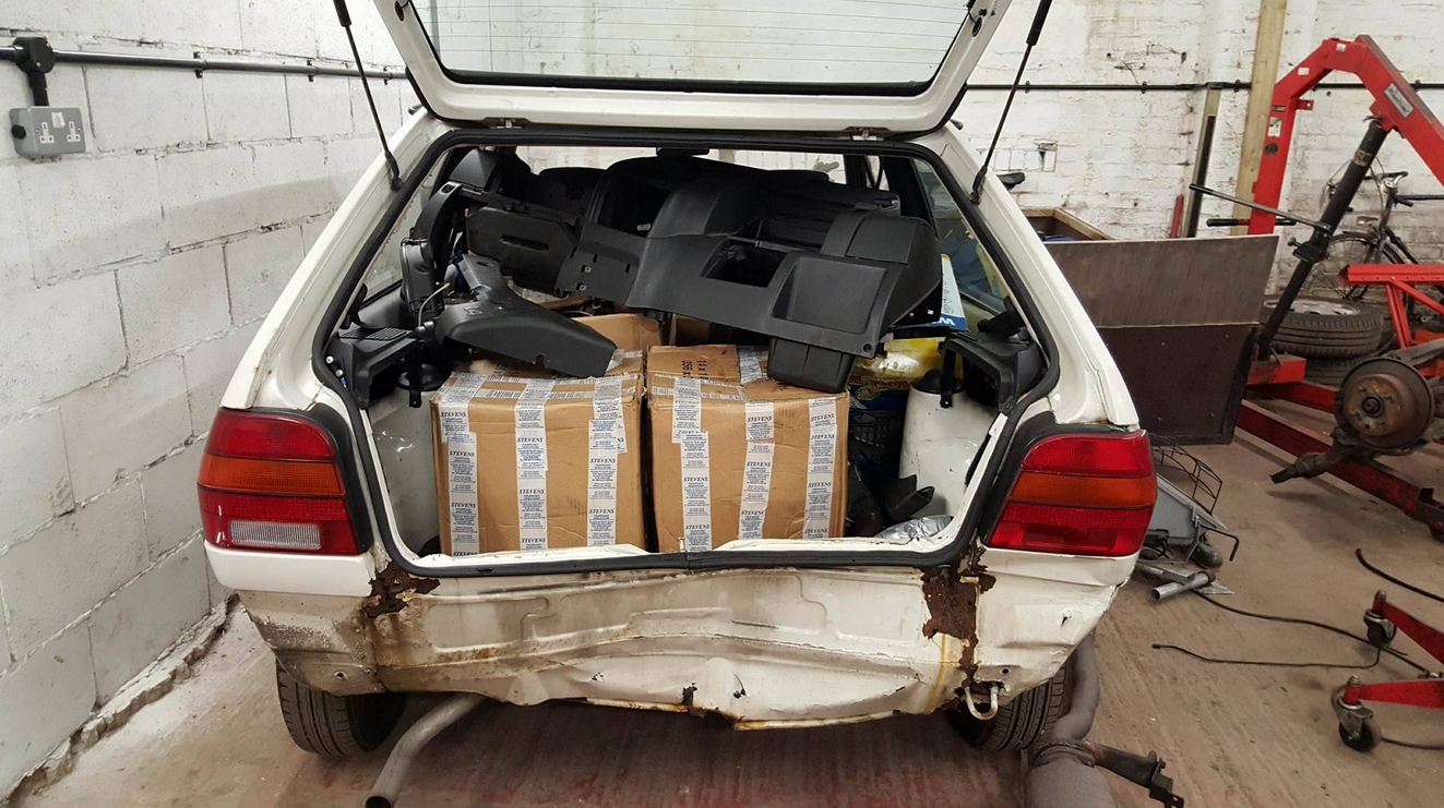

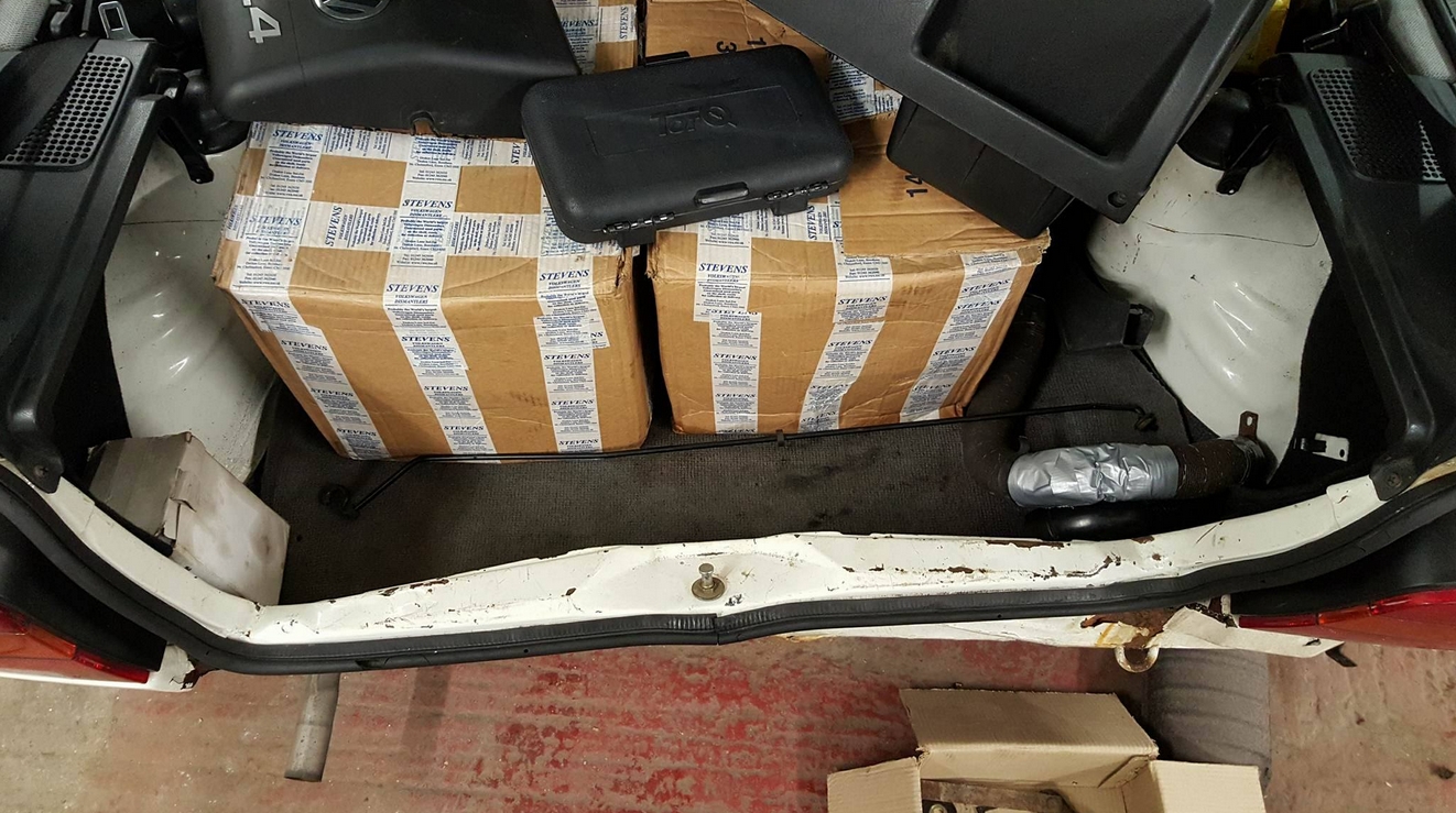

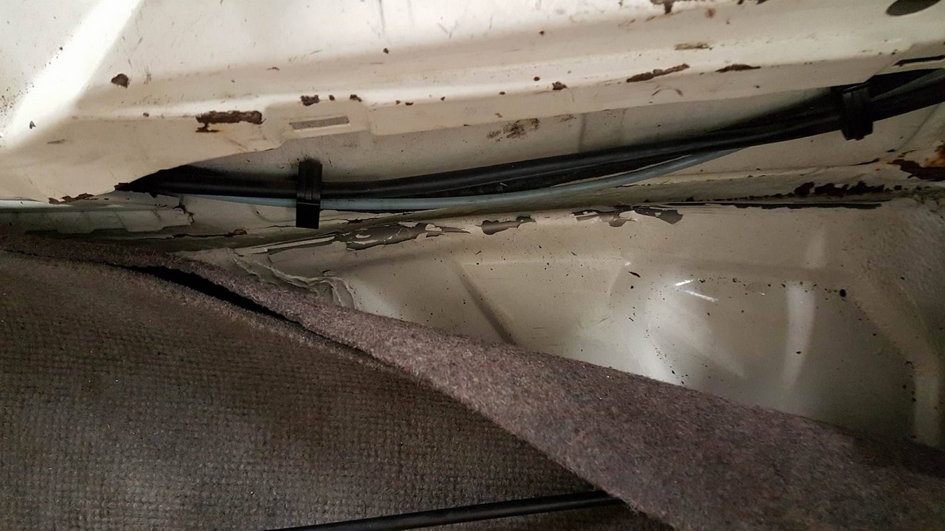

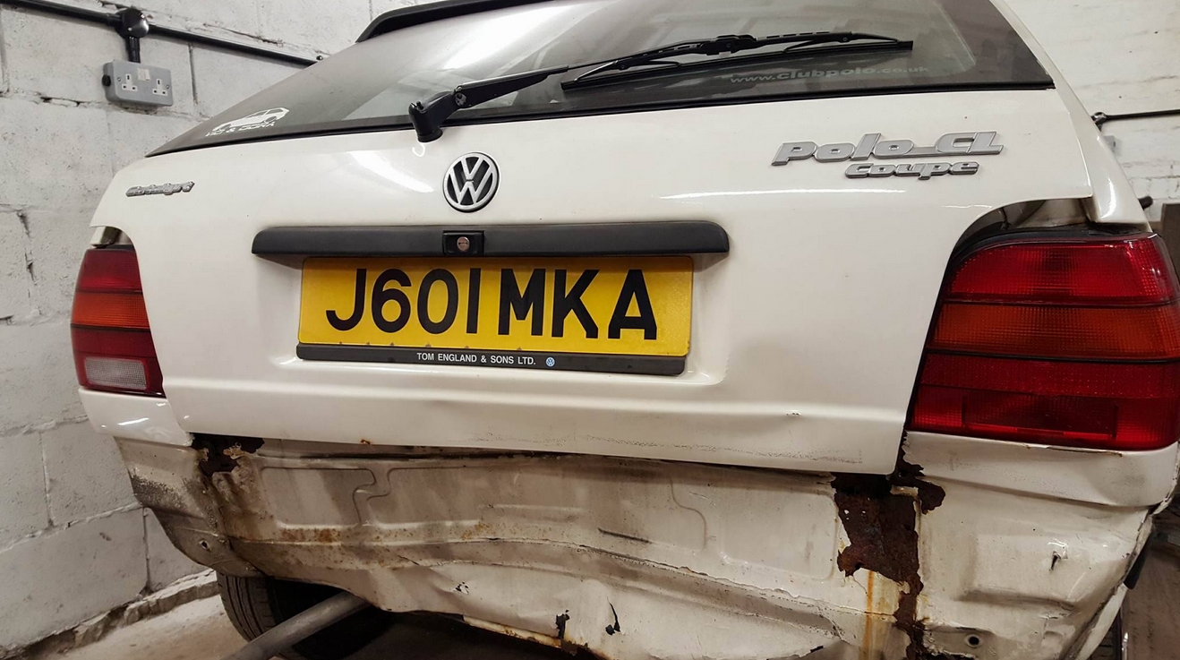

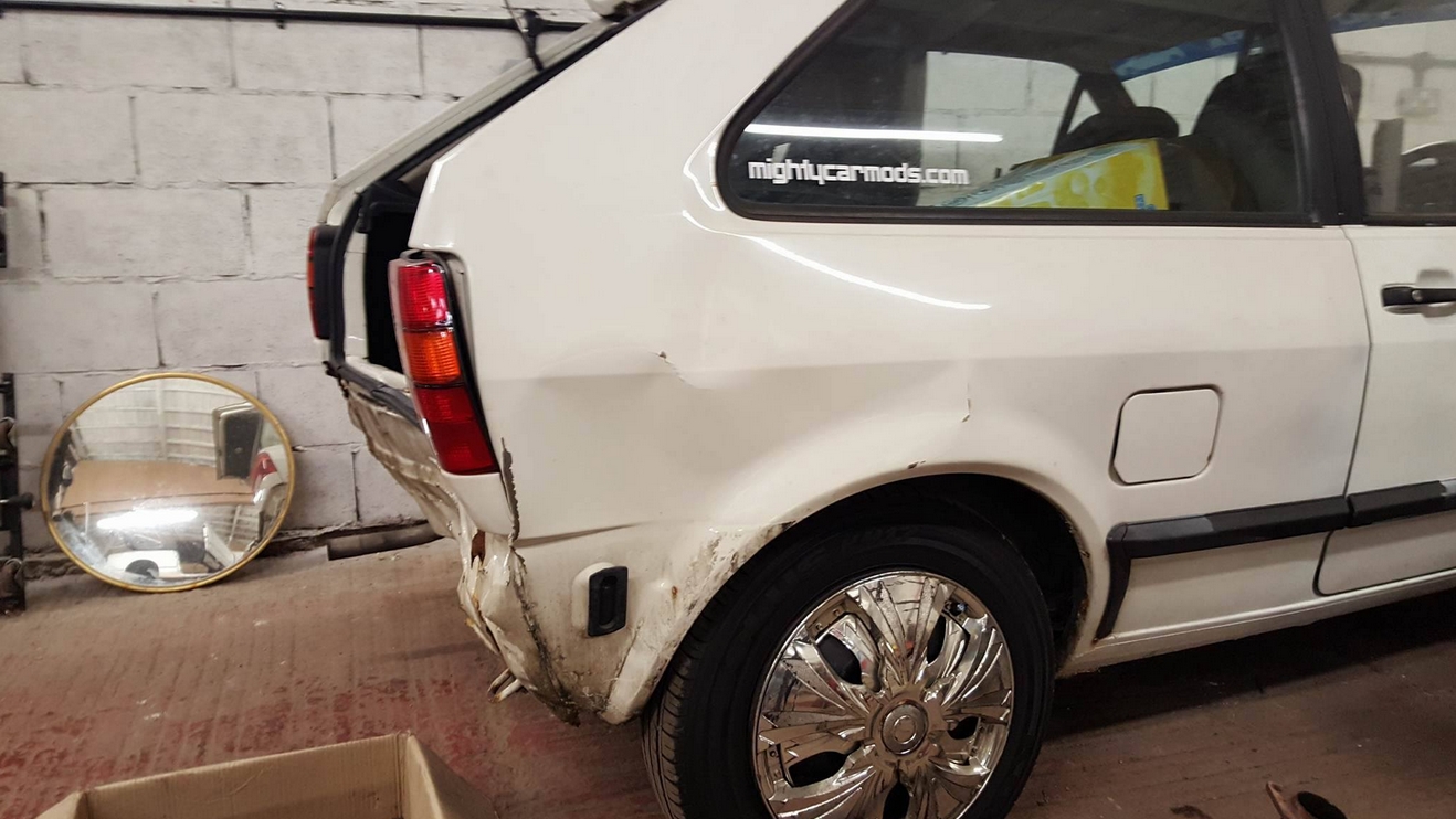

where are the crash damage pics?
Went round today to steal some LEDs so managed to snap a few
Can't see much of the underside though but it needs a boot floor & I think a rear axle.
It's quite handy as a storage space tbh. Holds 4 wheels, a gearbox, a dash, arch trims, pancake filter, and a whole bunch of other stuff, and would still be driveable :tongue:
