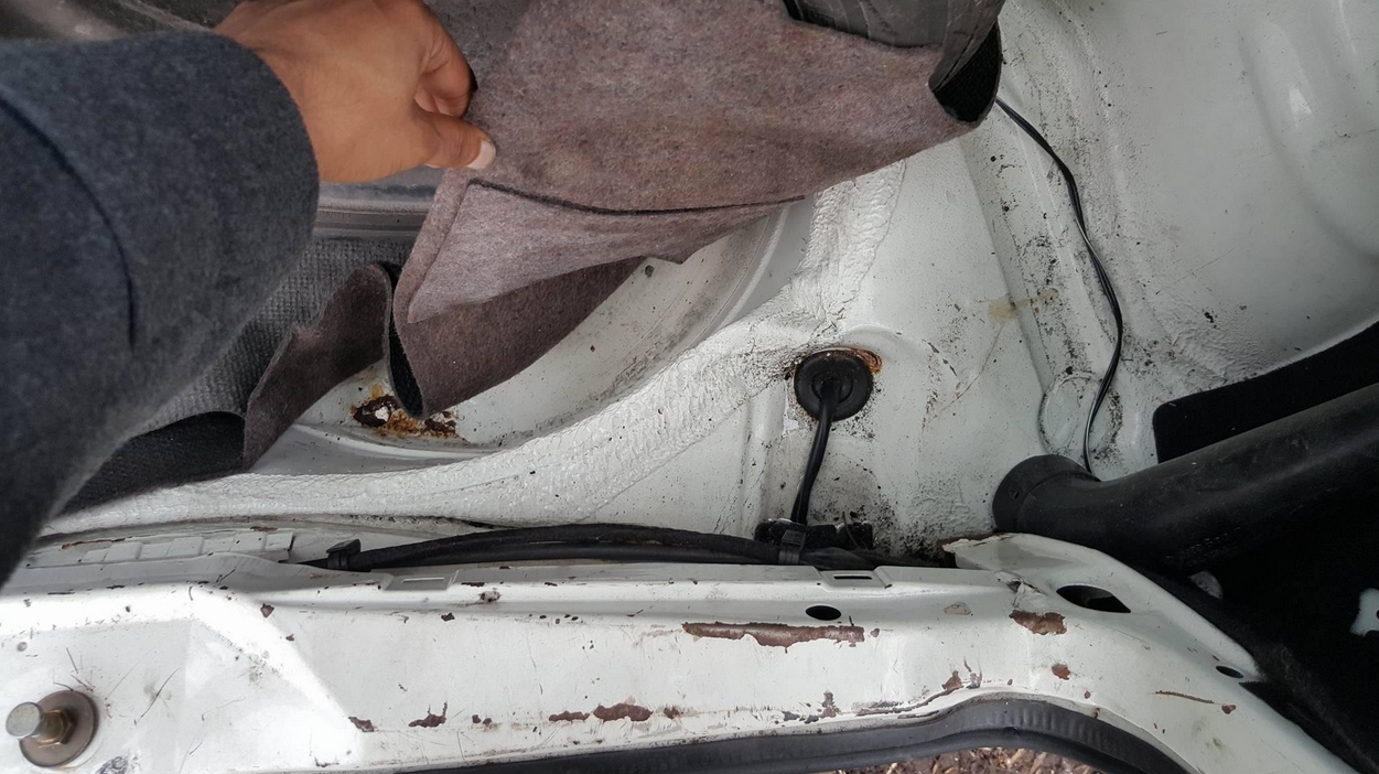

Can't see much of the underside though but it needs a boot floor & I think a rear axle.
It's quite handy as a storage space tbh. Holds 4 wheels, a gearbox, a dash, arch trims, pancake filter, and a whole bunch of other stuff, and would still be driveable :tongue:
that damage is bad, honest advice vio strip it re/shell it. you will have a cleaner rust free/ damage free polo too

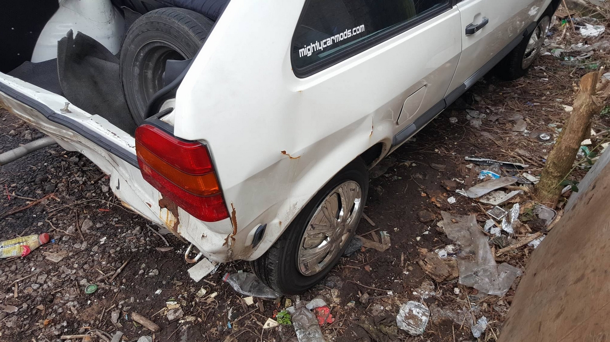

does the garage have any pulling equipment ? its not just a matter of finding the obselete panels and welding them on , first you have to strap the car down and pull that damage back out , for lesser damage folk have chained it to a tree and drove off to pull it out but yours needs more than that
By pulling equipment do you mean a piece of rope and a Toyota Hilux? They have that :tongue:
need something like this , skilled user can often save alot of the panels
It is too bad mate. You can't repair that. If you do it would never be as good as a normal undamaged shell.

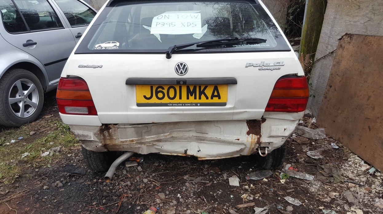

The rear lights are pointing in completely different directions, the rear quarter is creased, the boot floor is bent in more than one direction and that is just what I can see from the pictures. Once you start digging who knows what else you will find.
You've started stealing stuff off it anyway, that's the start of a long winding road that will eventually lead you to giving up on it. After you've spent a fortune on storage costs and the odd part you will buy for it from time to time.
Yeah mate that cars gone. You wouldn't look like a knob to just change your mind and give up, you would be respected for letting it go, the damage is beyond almost anybodies capabilitues who even specialise in body repairs.

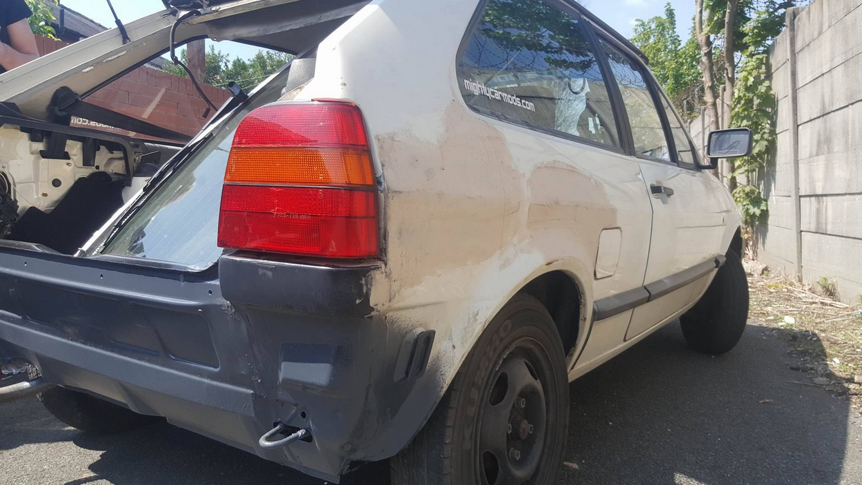

So here's what £275 got me

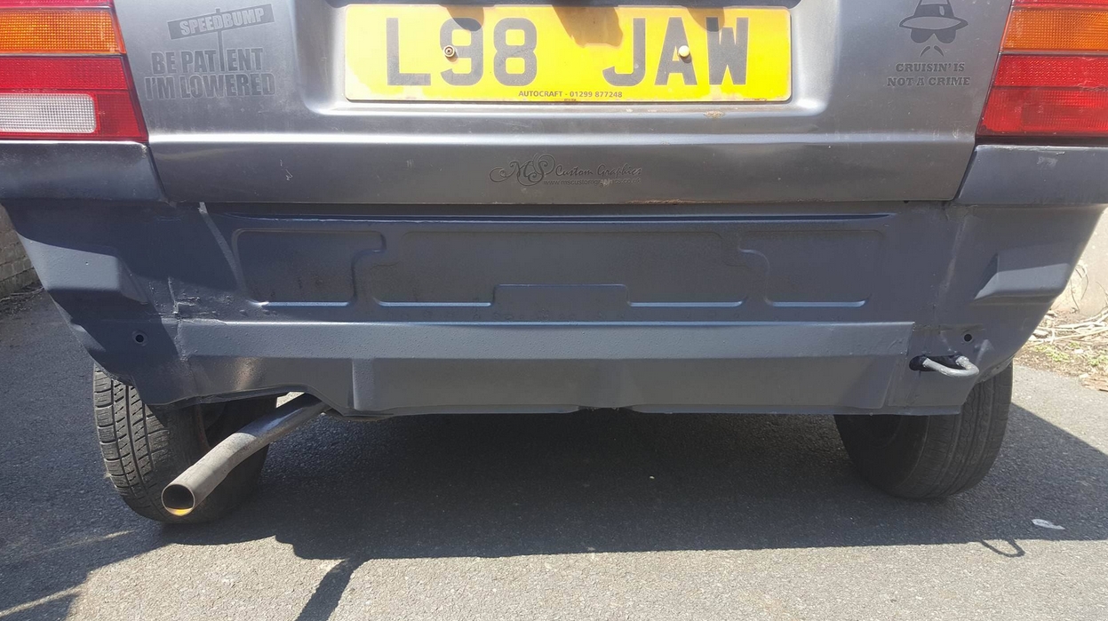

New rear panel and boot lid
Quarter panel got pulled out and they started with a bit of body filler

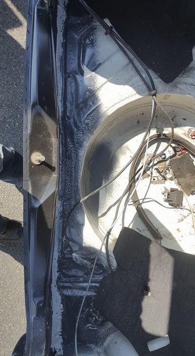

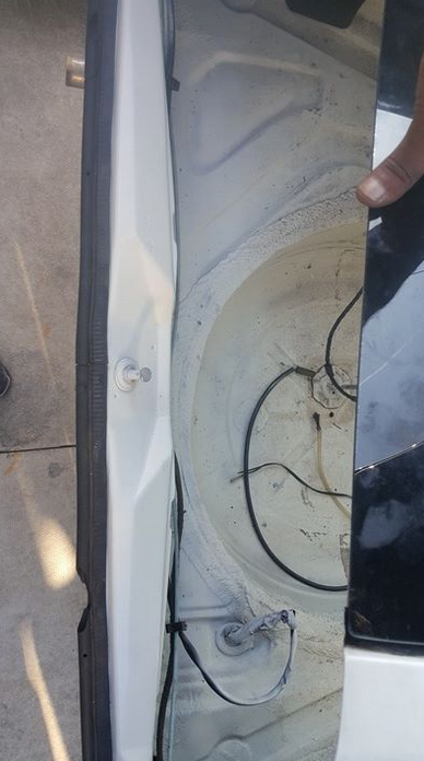

Boot floor straightened out and the hole in the wheel well welded up

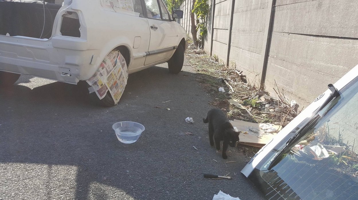

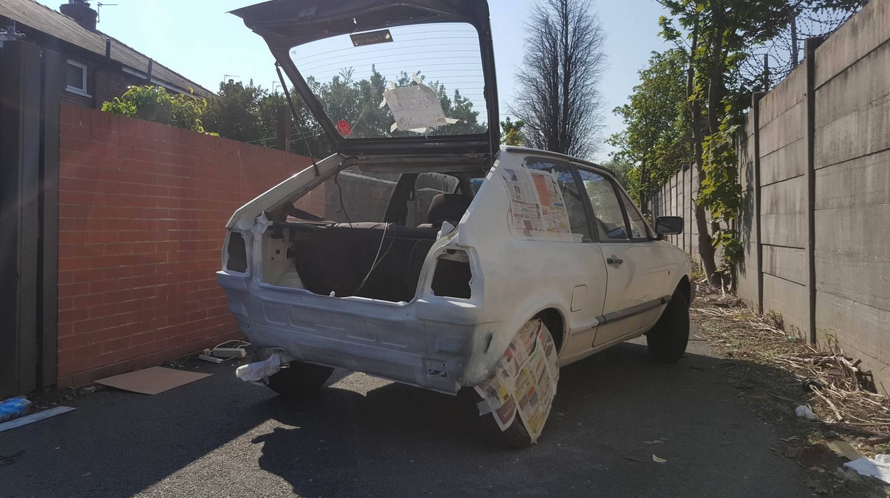

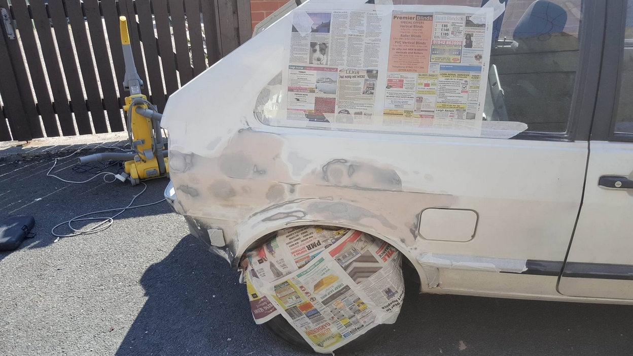

I can't do much on it until I get the Nissan out of our garage and can get Dora in, but I figured I may as well paint it to keep the rust out while the weather's good.
Some additional body filler was needed to get the quarter panel back into shape, which it's pretty close to.

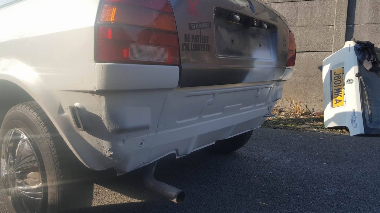

Naturally the ONE day I need VW alpine white paint, Halfords runs out of it. So I ended up painting with BMW alpine white and hoping it wouldn't look too bad. It's only until I get it wrapped anyway. That's still on the agenda.
caaaaaaaaaat
It isn't the perfect shape as yet and the os light doesn't sit flush, so I'll do some more filling once she's in the garage. Results so far
(Partway through I decided to touch up some rust on the new tailgate as well. Didn't have enough to paint the whole thing and I need to get the stickers off anyway, so that can wait)

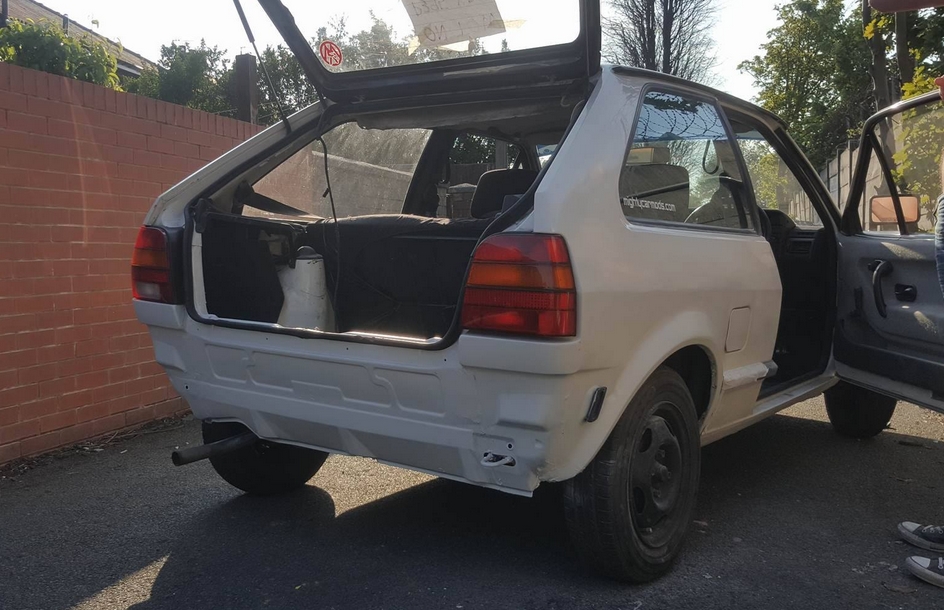

Getting there :smile:
That's come out really well and not a bad price considering the work involved.
8>)
From the original rear end footage I thought the crash damage to Dora had made her shorter than a Smart and bent as a banana.
If the boot closes nicely and you can make sure there's no leak around boot seal or lights that should last well.
