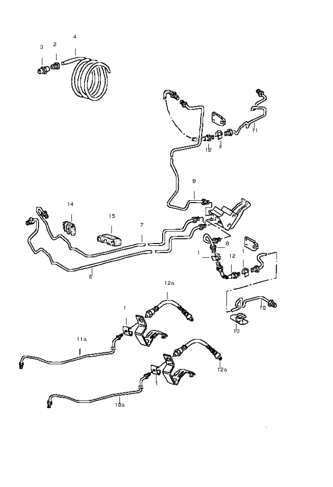

How long do the pipes and hoses need to be? Because when I search for brake pipe and brake hose (on the rear) it comes up with basically the same thing.
If you can measure the length of the pipe most motor factors will make the pipe for you with the correct end fittings and flared and if you've only got 1 pipe to do it'll be a lot cheaper

post-36925-0-71578700-1431902627_thumb.p
(6) shorten to: / F >> 6N-TY000 030 / F >> 6N-SW075 000 2830MM rhd /
(6) shorten to: / F 6N-TY000 031>> / F 6N-SW000 001>> 2545MM rhd /
(7) shorten to: / F >> 6N-TY000 030 / F >> 6N-TW075 000 2815MM rhd /
(7) shorten to: / F 6N-TY000 031>> / F 6N-SW000 001>> 2595MM rhd /
8 shorten to: 220MM /
9 shorten to: 1670MM /
10 shorten to: / for models with drum brakes 480MM /
11 shorten to: / for models with drum brakes 595MM /
So with your chassis number you can work out what length you need :)
No idea what my chassis number is.

From the picture what # do you need to replace ?

The rear hose I've got is to replace the ferrule. The pipe is just 'offside rear brake pipe excessively corroded' so at a guess I'd say #6? But I literally have no idea. My brain's melted by this point.
O/S rear would be #9 or #11 #6 would be listed as front to rear pipe
