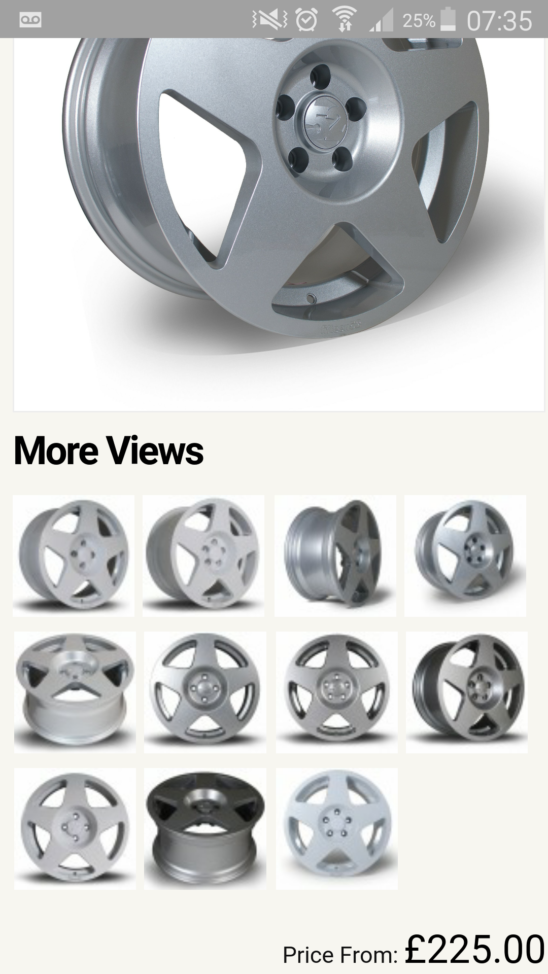

Saw these and thought of you,(they come in 4x100) not sure if they would fit though (17" x 8j ET30). Guessing they are too big but that would be such a shame as new sets are 225 quid only. Before postage of course
http://www.fifteen52.co.uk/wheels/tarmac.html
You sure that's not per wheel? I'd have thought that's what it is. But year 17s are too big anyway. The Borbet A's I want are 16x9 and they'd give me enough of a fitment headache.
I don't know mate, I assumed they were an affordable wheel due to the name not being huge yet and them being cast wheels but you could be right. Then again with Ken blocks name using them as his main choice of wheel they must have a higher price surely.
I thought 17s is pushing it lol never mind
Fifteen52's were quite high profile now I thought? I'm not sure. If they came in 15s or 16s I'd look into it but I'm not a fan of 17s on a mk2. Can't go smaller than 15s cos they won't fit over my 280mm brakes if they're any smaller. :lol:
