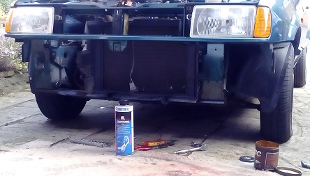

Had another brake in the weather so I took front bumper off and done the same as the back. While I was at it I cleaned the front end and gave it a coat of dinitrol 3125..

Looks good I used black satin spray, where about to get this from
Thanks I got it from ebay its called for ever black , comes with cleaner before you apply then foam sponge on a stick ..
