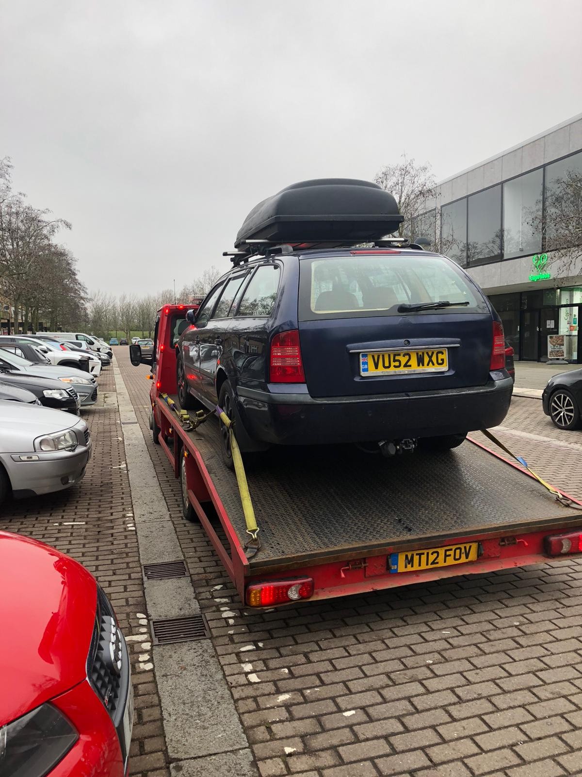

Time wrap this one up, it was off to the scrappy today
It had been a great car but a failing left knee and hips made it painful to drive so it was time to go, it has been replaced with a Touareg 3l V6 tiptronic
