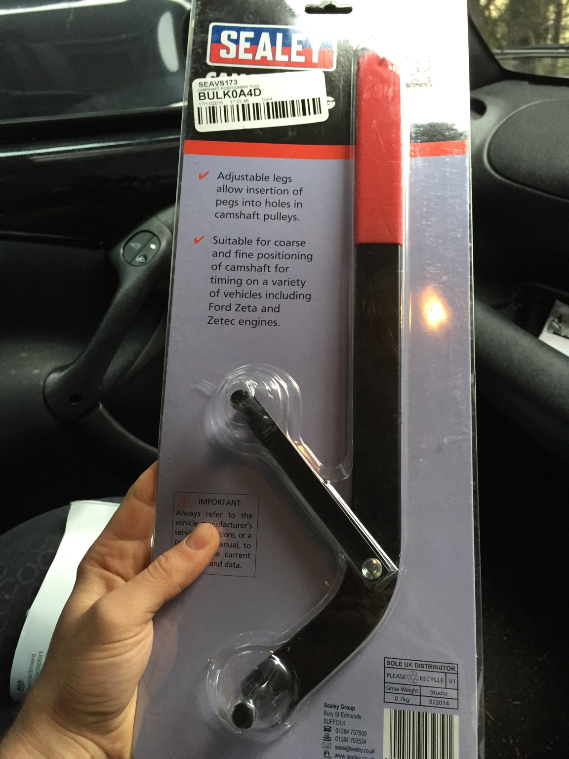

Firstly the Sealey tool is useless and doesn't fit on the crankshaft pulley as the two rods are way to wide to fit in the pulley holes!

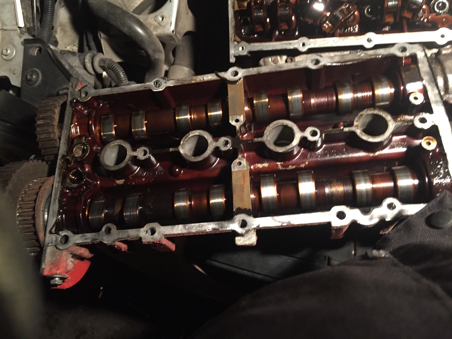

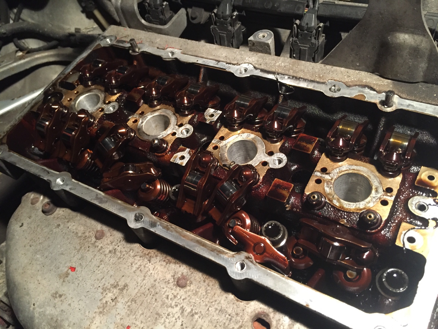

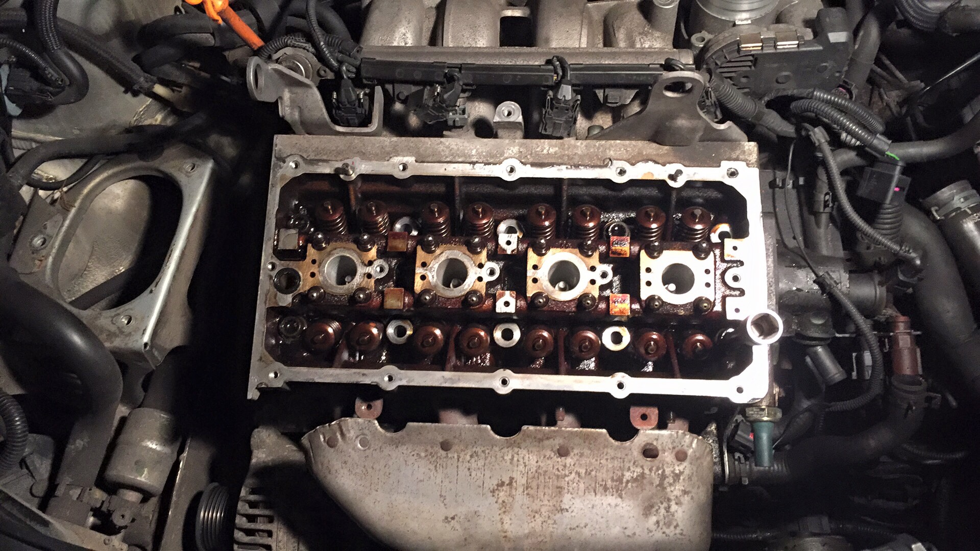

I then removed the timing belt after marking it all up and then removed the rocker cover and this is what I found!
Notice the marks at the bottom right where the hydraulic lifters have hit the head casting.
Both camshafts seem to be ok and are moving freely and don't show any signs of damage at first glance.
Before I remove the head what damage do you think have from the picture? I may have just knocked a few of the hydraulic lifters off when I removed the rocker cover.
The hydraulic lifters jump out of place for fun - something you'll learn when it comes to trying to put the cam carrier back on. I'm not sure i can see any damage in the pictures, just the dislocated lifters which is what happened when i removed the cam carrier.
If you have already removed the 4 exhaust bolts at the downpipe flange you can remove the head without removing the exhaust manifold.

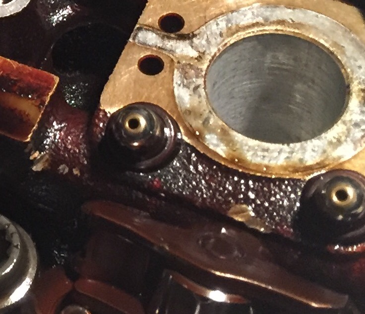

Here is another picture of the damage I mentioned. I will have a go at getting the head off tonight and then we can see the extent of the damage from the cambelt going.
If you are looking at the metal removal to the left of the oil galleries then, depending ow much history you have on the car, you should think about if
The damage happened when the belt shed it's teeth, or
It was already there
If it happened when the belt shredded, then I suspect that there will be damage to the rollers/tappets, so check those carefully.
It would seem to be difficult to force those out when the head is on, unless the valves are jammed open wide and therefore there is room for the rollers to move out of place. I'll defer to those who have more experience of these engines though.

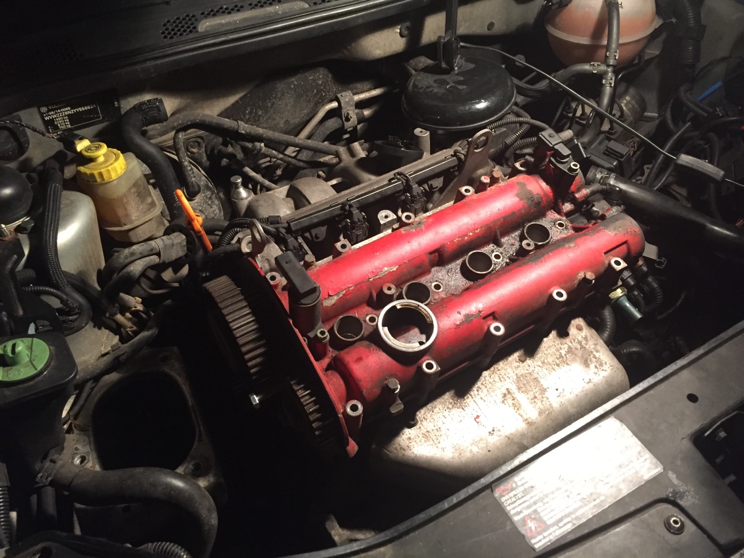

Ok getting the head off tonight, so will update some pics later.

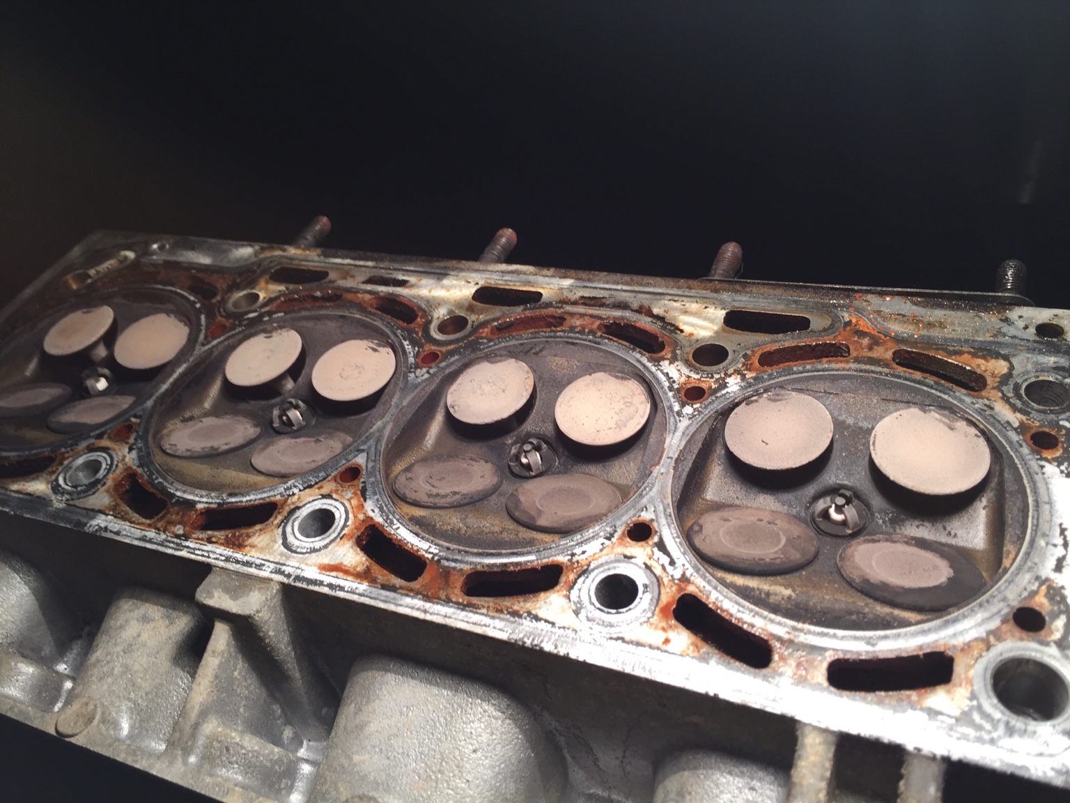

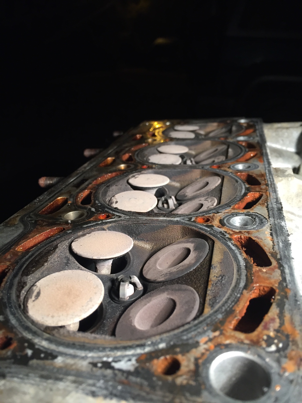

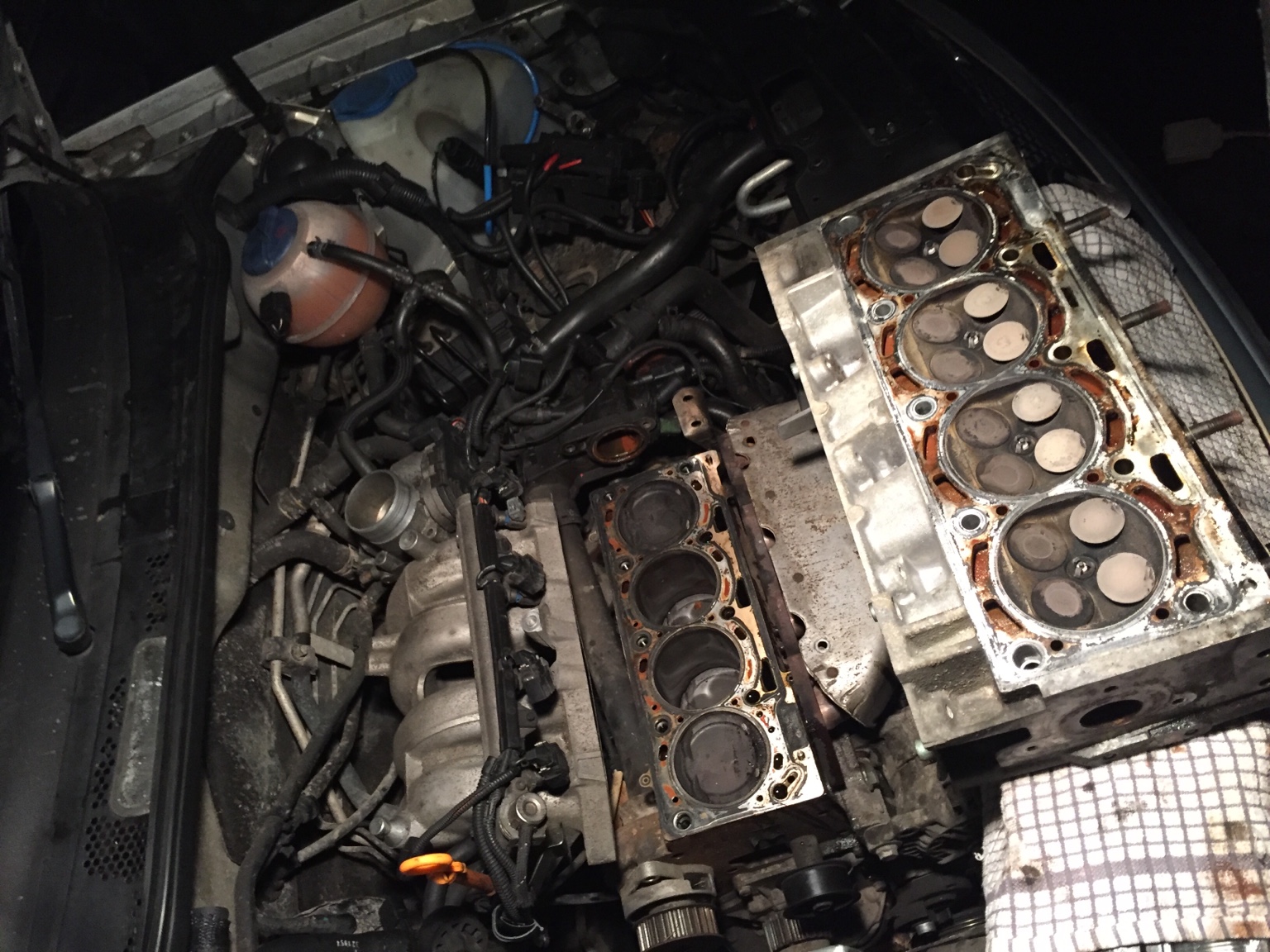

Quick update, 8 bent valves! Looks like a new head for me. Anyone got one!?
I can't feel my fingers!!!
That doesn't look too bad, you might need to get new valve guides but other than sticking new exhaust valves in looks OK unless there is damage we can't see in the pictures ?
Think it's just cheaper to get a new head than replacing all 8 I think the valves are about £7 each at Ecp
036109611K exhaust valve
How hard is it to change the valve guides?

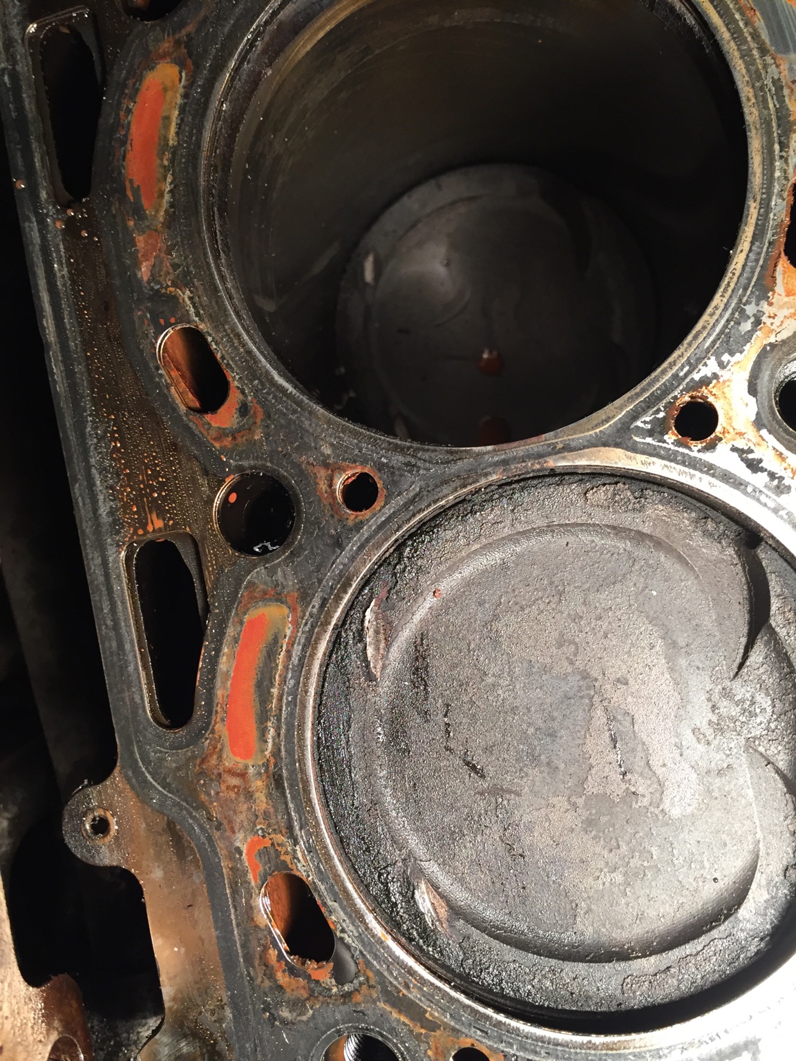

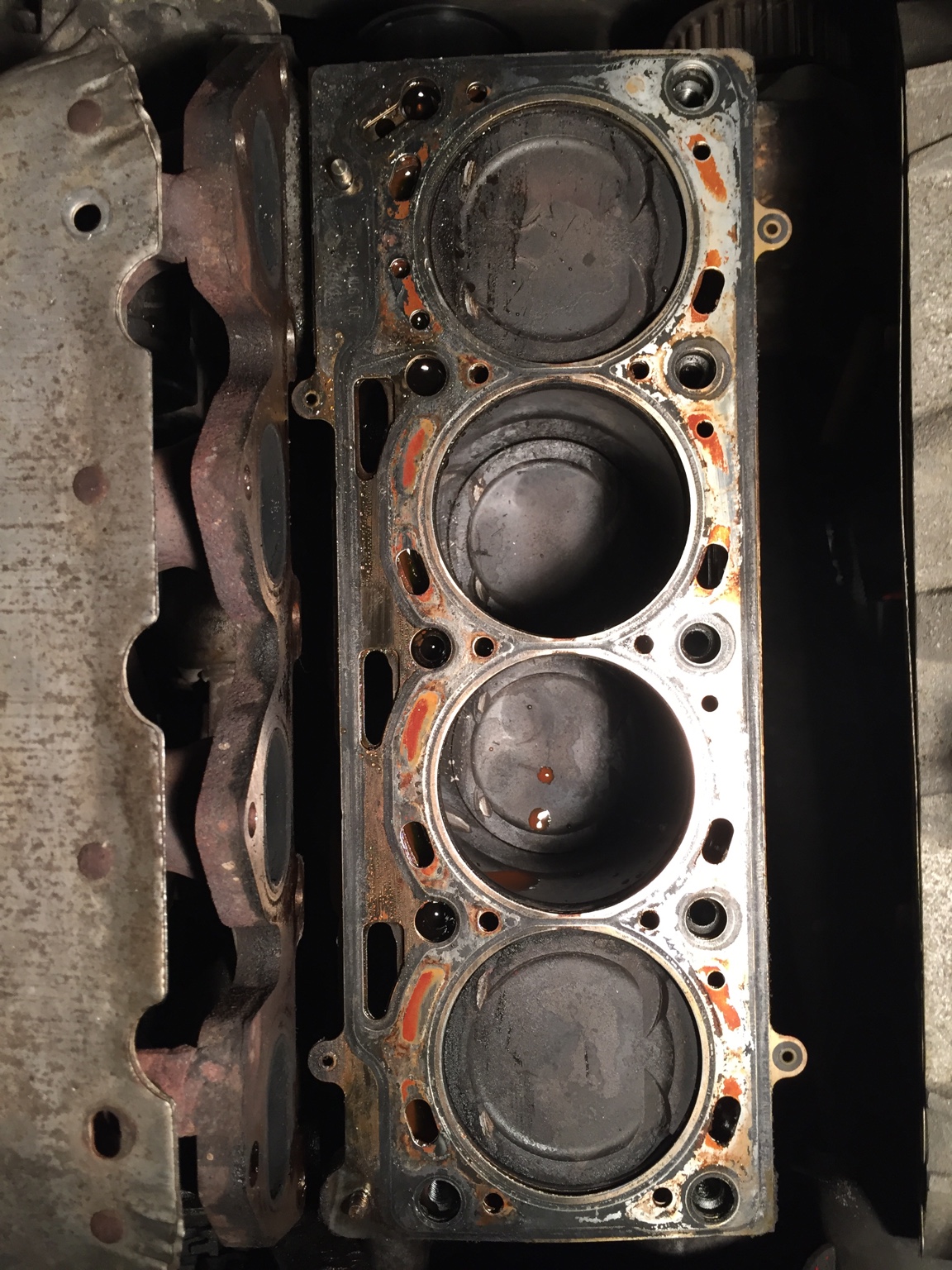

Tonights pictures are much better quality and I can now see where all 8 valves have clattered the pistons - a lot more than the kiss I suffered on mine.
I agree with Nige, that you should simply replace the exhaust valves, if the valve guides are in good condition. If they are worn /damaged then you have to do the equations for purchasing the the valve guides plus any labour / machining involved against the cost of a s/h head............ though you do at least know that apart from this your head is in good condition.
You should also make sure you carefully remove the high points on the pistons. If you don't they are likely to suffer from localised increase in temperature and potentially pinking.
Take the valves out and see what the guides are like
I believe the valve guides are a cold press out / press in job. Maybe warm head and frozen guides means they can be gently tapped in without a press. I haven't done it on a 6N2 so cannot speak from experience,
Inspect the guides for damage first, then you'll need one new valve and a dial gauge (or a good engineering feel) to check for wear in the guides
