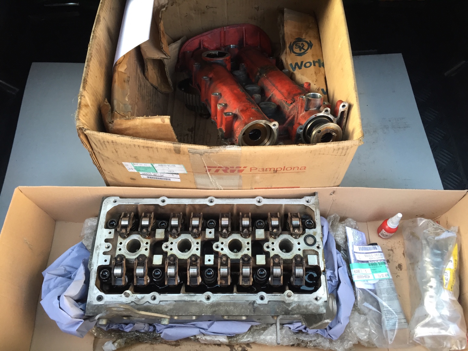

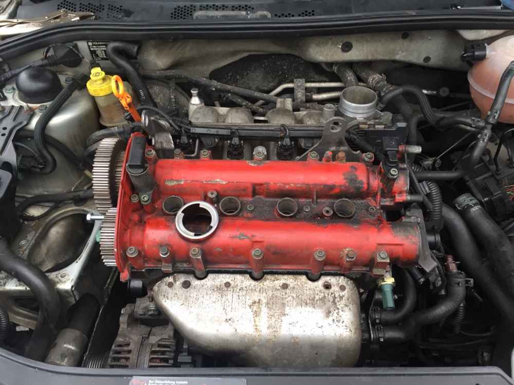

Apparently the donor engine I'm going to rip apart this weekend had a full service history and was in really good condition. Here are a couple of photos. It actually looks a lot better condition than mine haha.
Don't think I will bother getting the head skimmed as I want to fix it for as little money as possible. So far I'm looking at £139 [emoji3]

I have one her you can have if that ones no good mate. I replaced mine as it was burning oil. Turned out to be rings stuck in pistons. The head is in good condition.
Cheers for the offer mate sent you a PM.

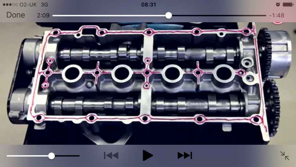

Don't go too mad with the sealant - the last thing you need is an excess coming off and blocking an oilway
I watched a YouTube video by Elring and got a good idea of how much I should be putting down.

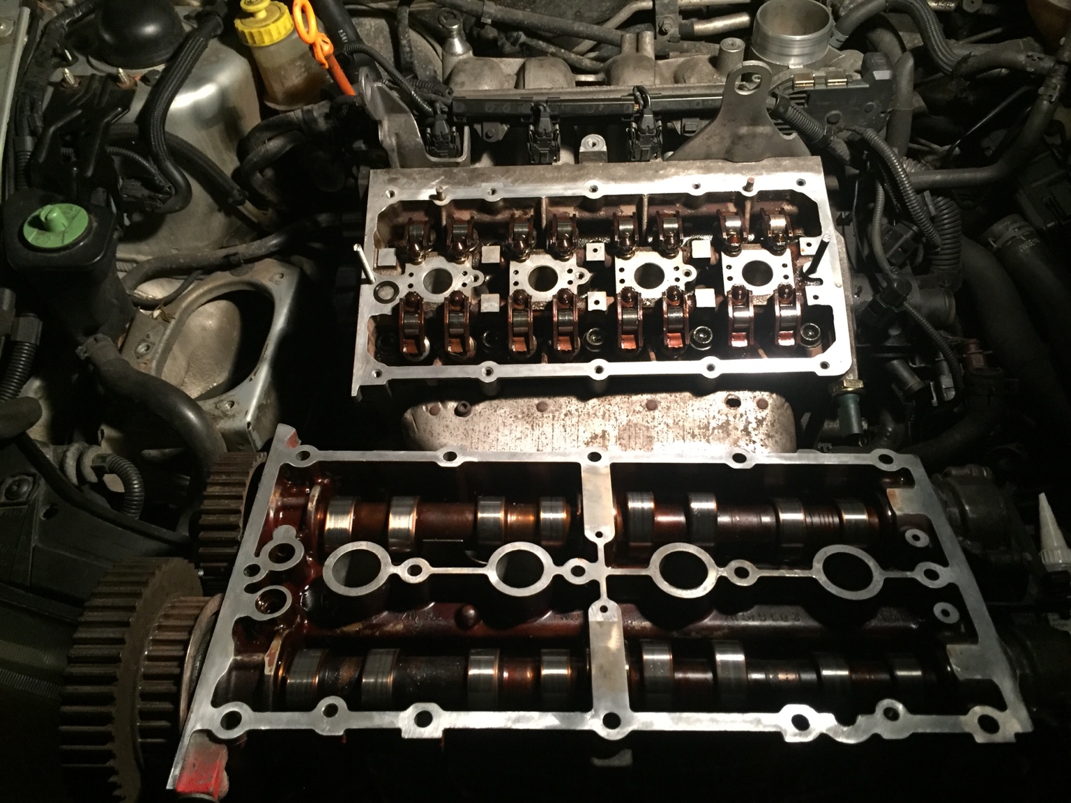

All set up ready to go

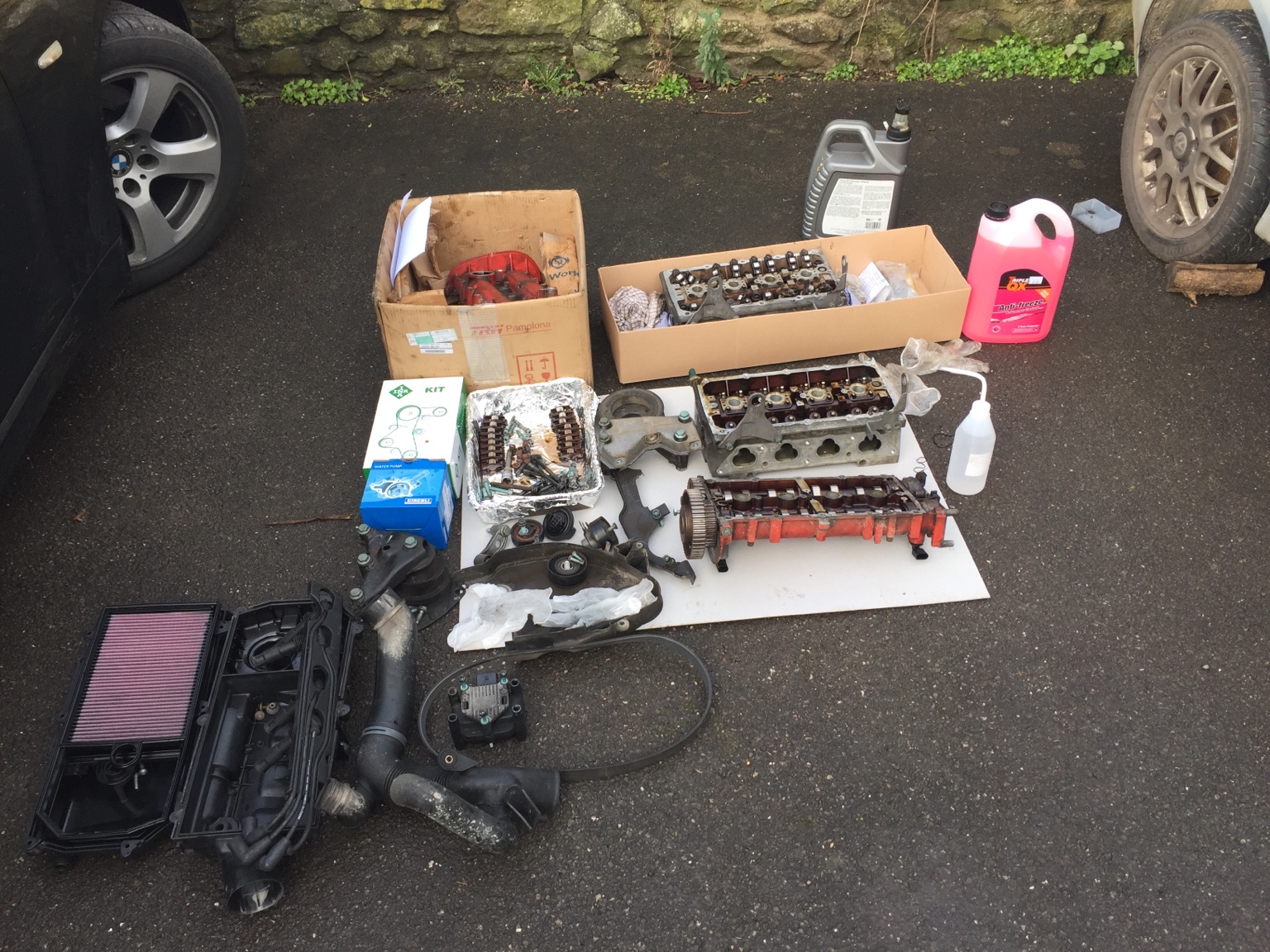

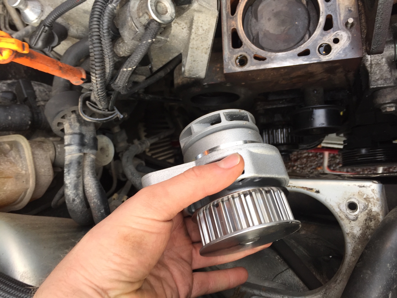

Water pump removed and cleaned up ready for the new one post-922152-145357855152_thumb.jpg

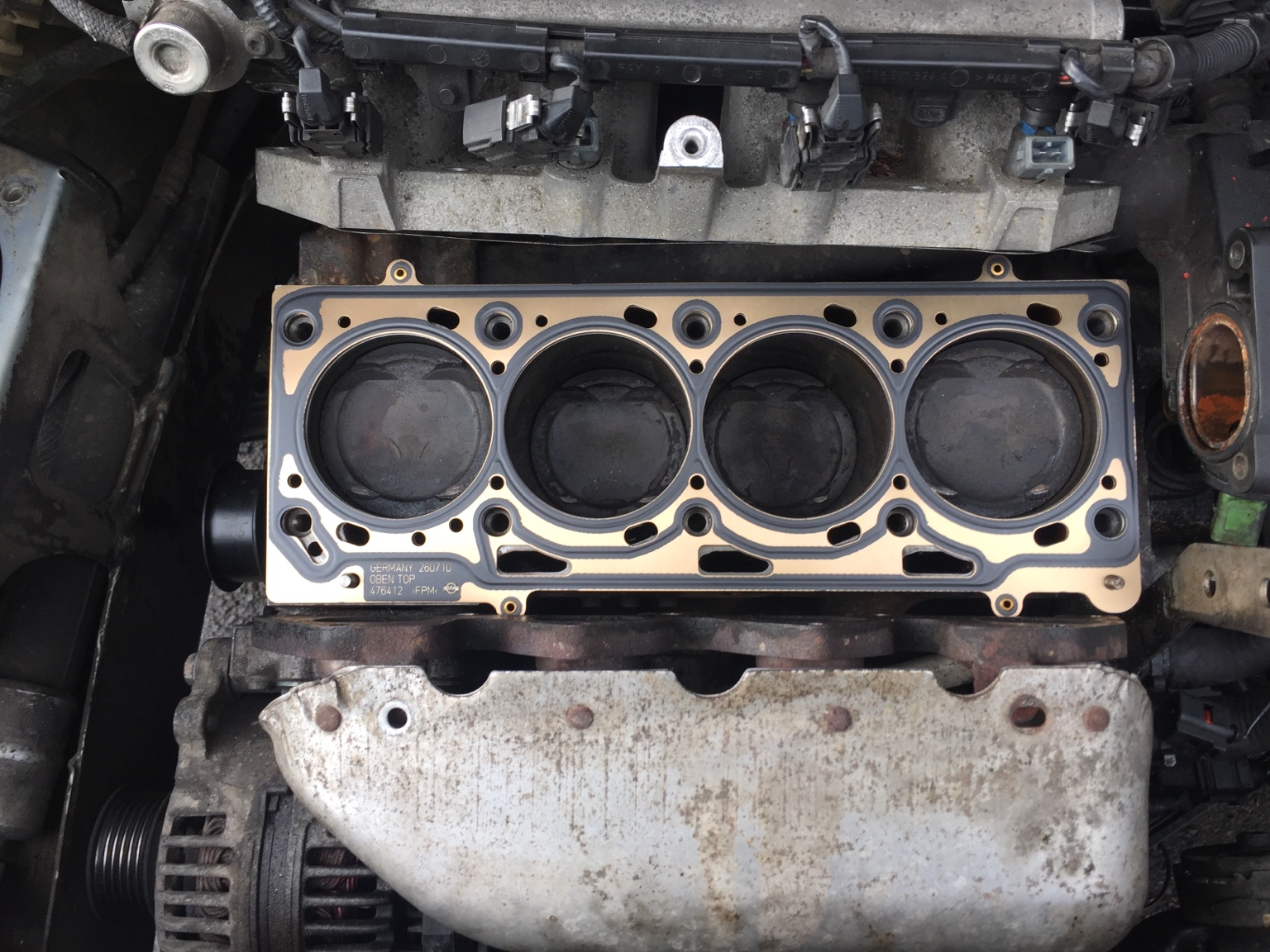

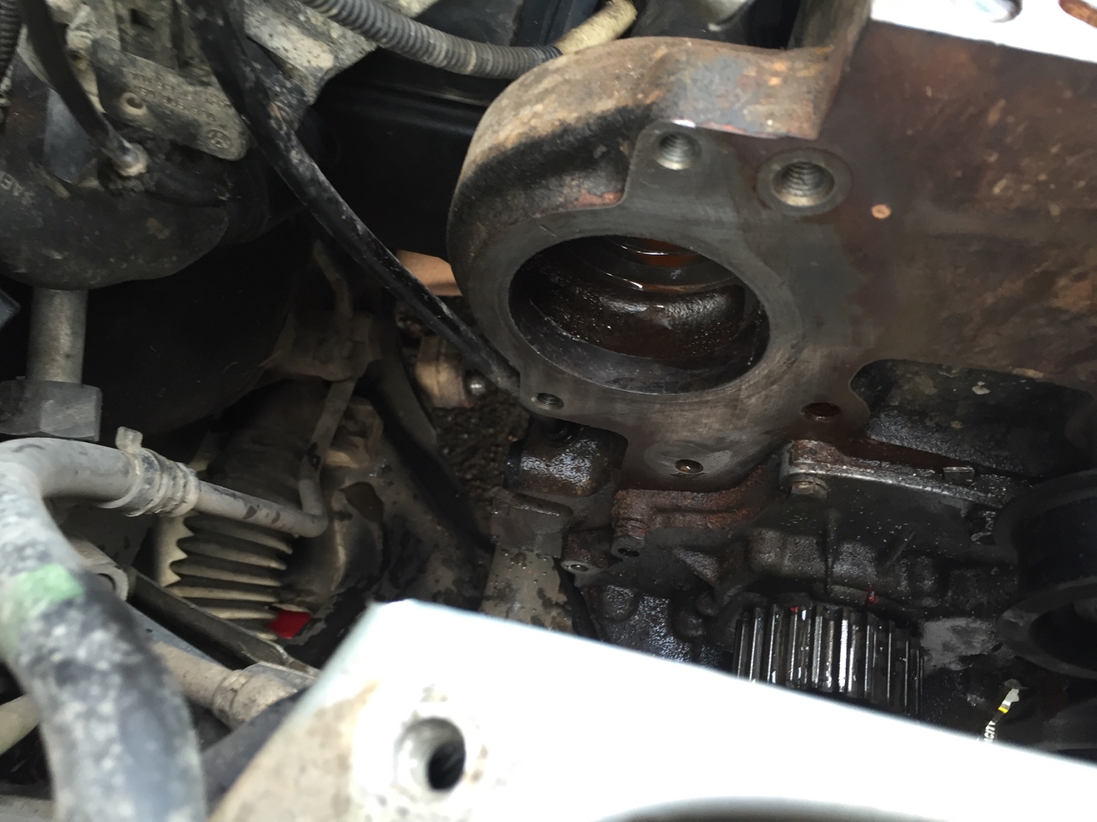

New head gasket in after the area was cleaned post-922152-145357885789_thumb.jpg
Rocker cover cleaned ready for sealant, new cam belt guides and tensions installed post-922152-145357891144_thumb.jpg
