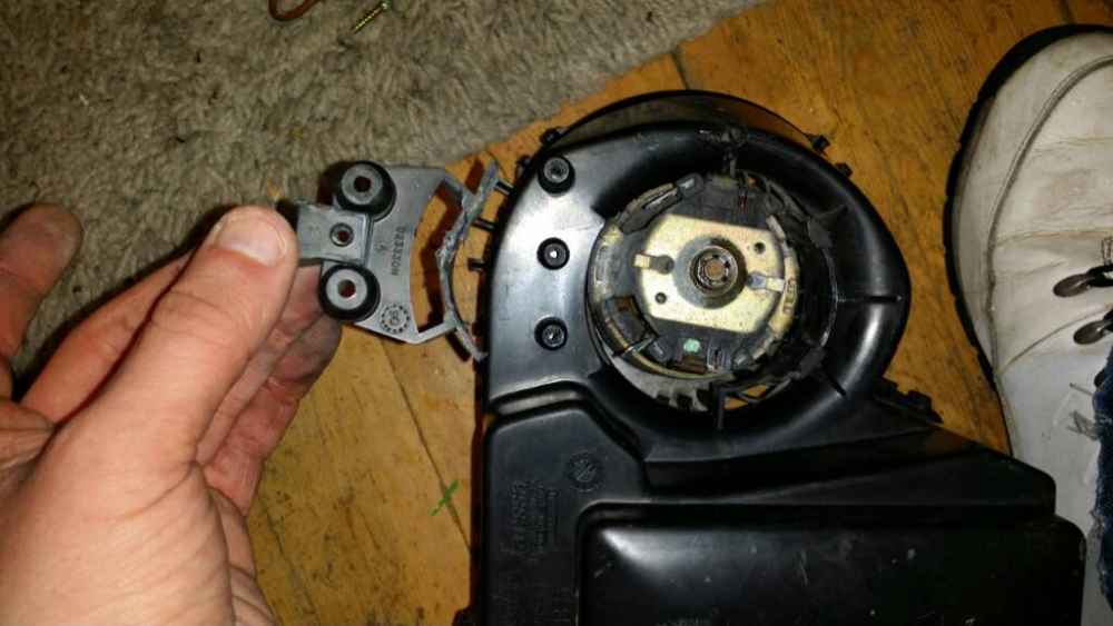

Got a step on how to actually remove the motor from its housing.

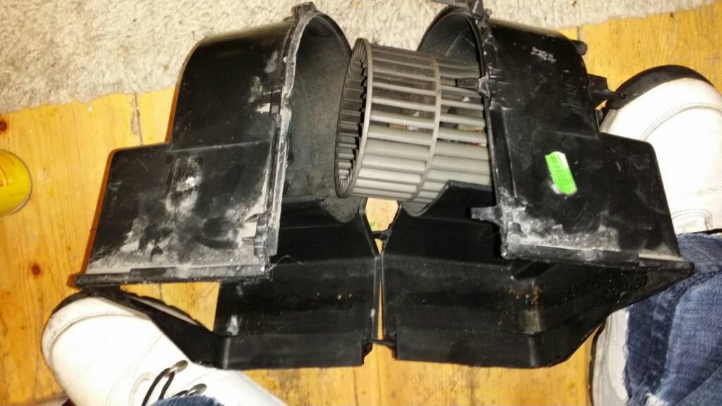

Use flat head to pry open the two half's.

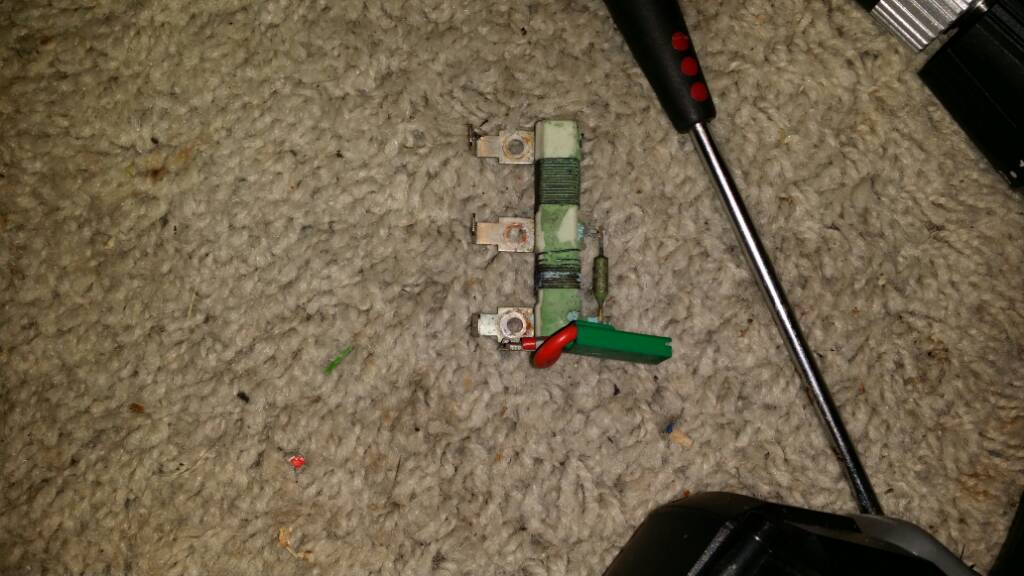

Remove plastic holder from under motor control.
Motor just pulls out.
Tip:
Just take it easy on the tabs on the housing once you get one the rest will just pop out with a nudge.
