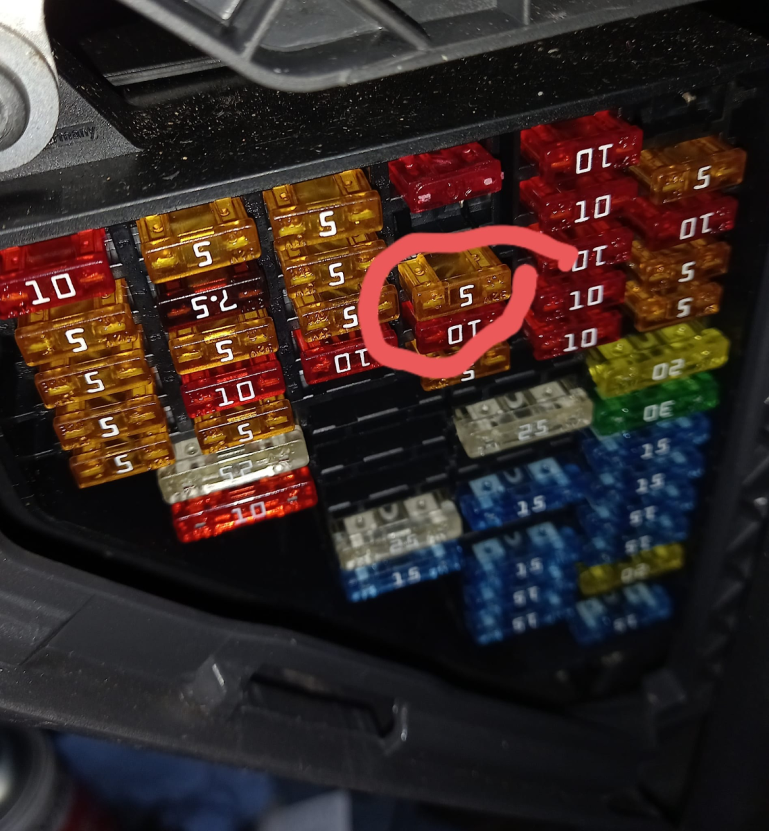

A 2002 (9N) car won't have exactly the same type of motor module as this thread is covering, but the power wiring is mainly the same.
I'd suspect a broken wire in the driver's side door bellows might be your problem. One thing to try is to use the key in the door lock to unlock the car, but keep it held fully round and see if the windows go down, or not.
If they do go down, there must be at least the main power feeds and earths intact, but there is also an ignition switched 12V feed from fuse 18 on a black/blue wire that it would be good to check at the module.
This one:      Edited to correct this duff info. That feed is only present on the 9N3 variant modules.
Edited by Pete1
The easiest way to check it's not a power issue is (if the car's got central locking), put the key in the drivers door and hold it in the unlock position. The windows should drop. You can close them by holding the key the other way.
It's not an exhaustive test, but if it does work, you can be reasonably sure that the motors are getting power on both sides of the car, and that it's probably a control issue.
If you're swapping a module for a second hand one. Make sure you match the part numbers on the unit, and be aware that the second hand one might not be a lot better than the one you took off.
When you open the door, you'll see where the wiring loom does through to the car just below the check strap. The multiplug is in the A-pillar. It's worth pulling the rubber cover back and making sure both it and the wiring is undamaged, plugged in properly, and there's no corrosion in the multiplug. Make sure you put it back properly after.
My apologies @Highbury I've misinformed you about that fuse 18 feed, that doesn't exist on the 9N version. Forget that. I'll edit my post above to improve accuracy.

Hi I’ve done the turn the key to the right hand side, the drivers window stays up but the passenger window drops!
Try this on driver's side:
The fact that switch doesn't light up, and this latest test result suggests to me that some broken wires may be found.
