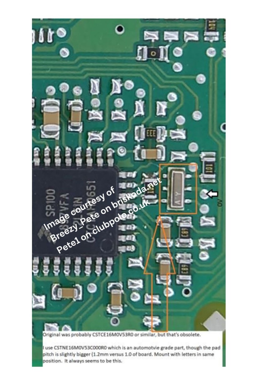

I've spent some time trying to reverse-engineer the little circuit boards, and have a few observations that may be relevant.
Firstly this only applies to the parts with numbers 6y1959801, 6y1959802, 6y2959801 and 6y2959802.  These four parts cover left and right sides for each of LHD and RHD cars with front electric windows. I've not looked at the variants that include rear electric windows.
On later MK1 Fabias (sometime mid-2004 on) where these were first used I think, they are mounted a different way round, such that the part numbers make more sense on them than they do on the 9N3.  The third digit being a 2 would normally signify a RHD part, and the last digit being a 2 would normally indicate fitment on the RHS of the car, so on a RHD Mk1 Fabia 6y2959802 is driver's side unit , 6y2959801 is passenger side.
Due the units being mounted differently compared to mk1 Fabia when used on Polo, Mk2 Fabia, Transporter and Skoda Roomster, all of these have the opposite, 'seemingly wrong' part allocation, where 6y1959801 is RHD driver's side etc. Everything is opposite.
If the third and last digits are the same (both either 1 or 2) it's a master (driver's side) unit, if they are different then it's a slave unit for the passenger side.
They are connected to each other (and no other control units) data-wise  by the LIN bus system which is implemented  by the chips on the boards. Previous generations used CAN bus, LIN is cheaper...
The chip that does most of the legwork on these boards is MC33689 (suffix DDWB on the two units I've looked at so far) the sticker with what looks a bit like a QR code usually covers the top of the chip in question.  This chip directly powers the relay coils, generates the LIN comms stuff, and even supplies the 5V rail for the square microcontroller chip next to it.
Datasheet can be found here: MC33689, System Basis Chip with LIN Transceiver - Data Sheet (nxp.com)
A week ago I came across a supplier of these chips on ebay that included the word 'vulnerable' in the listing title, but no further details about what the vulnerability might be.
Then I found this: MC33689, MC33689D Device Errata - LIN Dominant Issue/Low Voltage Reset Weakness (nxp.com)
I can't help wondering if the 'deep' problem with these units all stems from one or both of these built-in hardware flaws, and that the fixes involving replacement relays and capacitors may just be improving the local voltage conditions such that the inherent weaknesses don't show themselves as often or at all?
There's a newer version of the chip - MC33689DPEW - that may be a drop-in replacement, I'm awaiting one in the post to try on a faulty board.
It's non-trivial to change the chip, but potentially a hell of a lot cheaper than buying a new module from the dealer.  This latest chip version is probably what comes on a new-bought-today replacement, but I don't fancy buying one just to see. The suffix DDWB chip can't be ordered new from the manufacturer. (See revision history section at the end of the datasheet).
Anyone with a unit manufactured in the last few years (2014 on, say) brave enough to peel back the sticker and see what chip is on there?

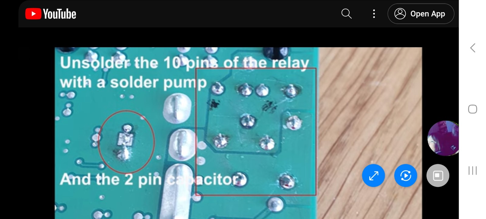

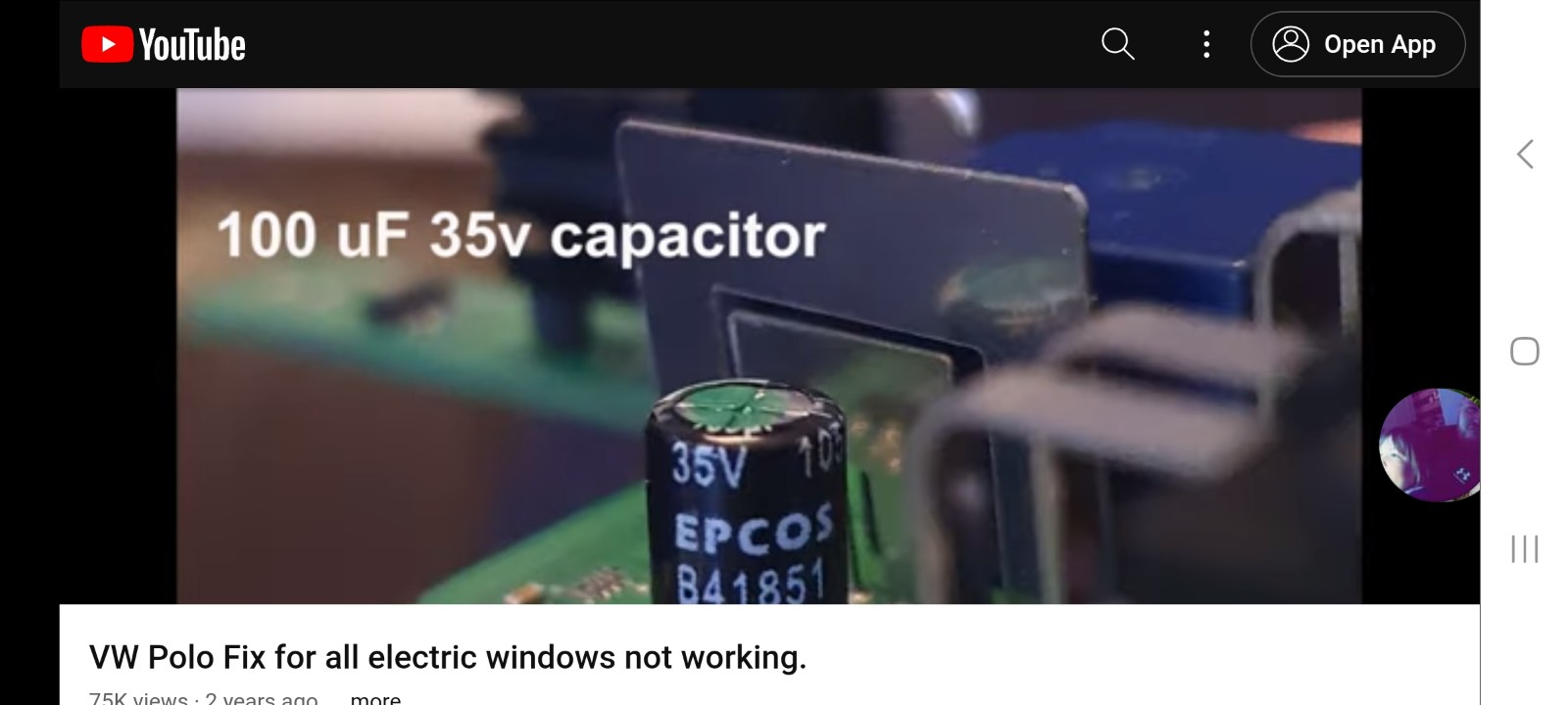

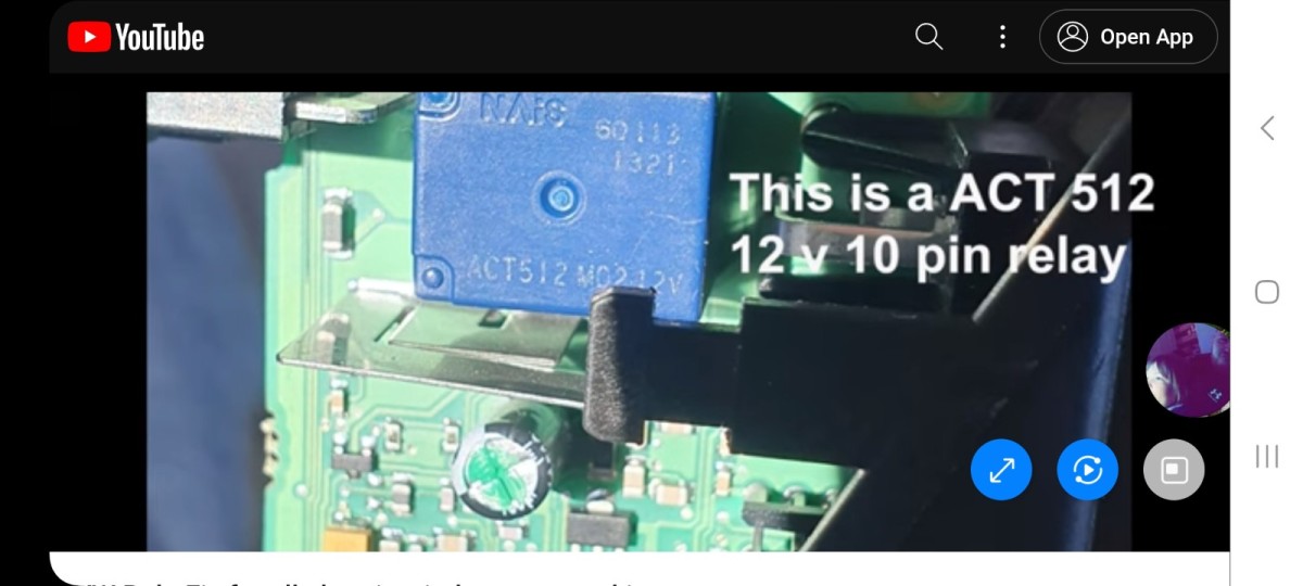

On 21/03/2016 at 10:01, vwfan3 said:
Hi
Is the relay also fixed to the control board ?
If so, where are you getting the relay from ?
Also, please put up a picture of these components on the control board.
Thanking you in advance.

@jasnben have you tried changing those bits? I think it will only lead to disappointment for most people.
