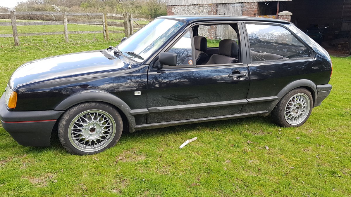

that looks pretty good, what suspension kit did you use

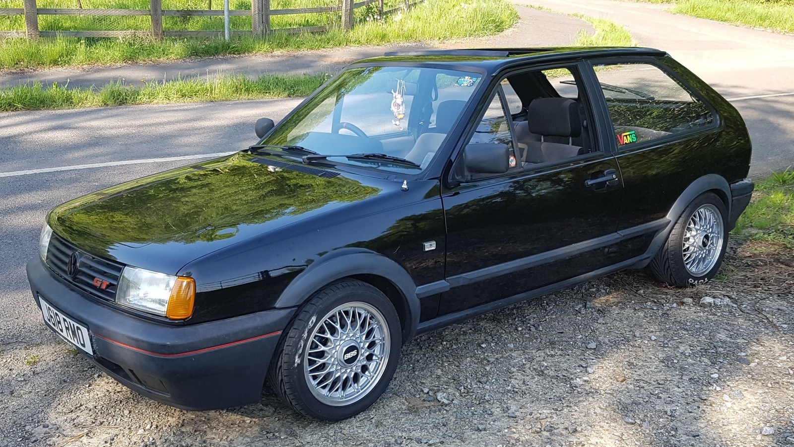

    Had the polo out yesterday and Kiran_182 came over with his and we messed about with my ignition timing, pulls so much better. Kiran also told me to give it a clean and add some more pictures so heres

    So mainly been doing little maintenance bits to the polo these last few months but it's running really well, love screaming it down the local country lanes!

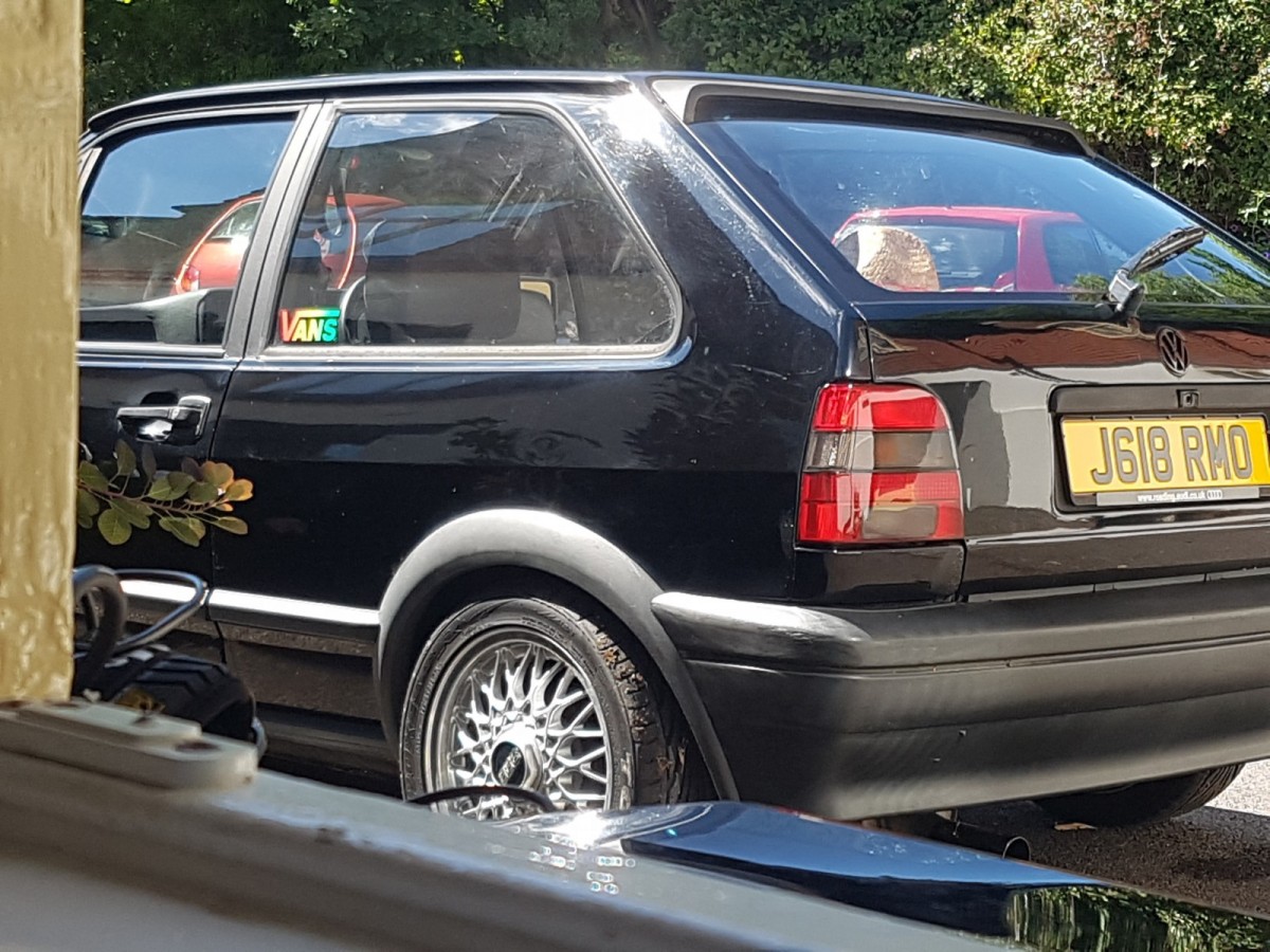

It's the HnR 60/40 kit which sits pretty well in my opinion. I'd recommend it to anyone thinking of getting it.

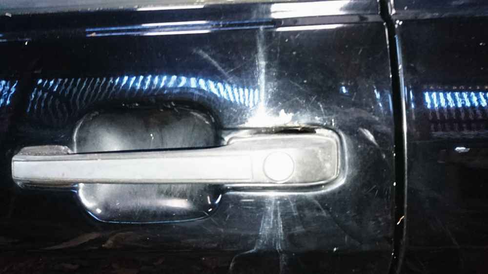

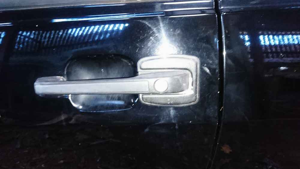

Fitted some handle guards to stop anyone breaking in so easily although my passenger door has already been done as seen in the pic. I will end up taking them back off for paint but wanted to see how they fit
good stuff, really honest car youll have a great time with it

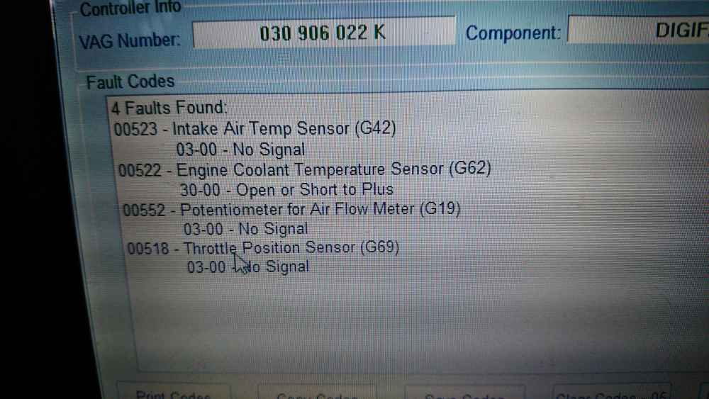

Think Ive diagnosed the light throttle hesitation with the blue temp sensor in the thermostat housing as if I unplug it the car runs sweet so I'll try one of those first.

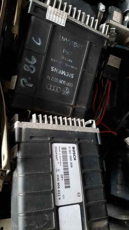

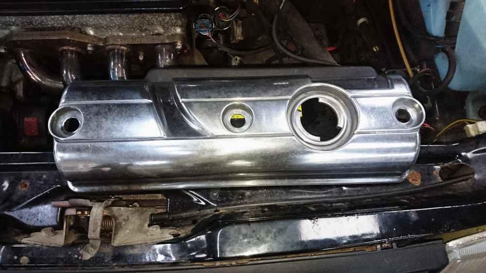

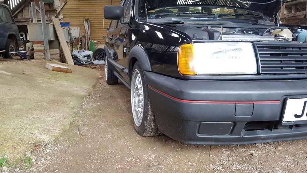

So I've put the gt away for the winter, needless to say I will be working on it most weekends. Still trying to sort out the lumpy running issue, changed the blue temp sensor and wiped the fault codes. It still doesn't run great, when checking measurement blocks the ignition timing is fine till you increase revs lightly then it tells me it's advancing the timing way too much, not sure what's causing this, could it be a bad dizzy or the chip? When you unplug the blue temp sensor to set the timing static it sits on 6 degree btdc which is about right. Anyone else had these issues? On another note I got hold of a 6n rocker cover and polished it up a bit, it's not the best but I'm happy with it.
I suffered from a "kangarooing" effect when my throttle body sensor went. It was intermitent and gradually got worse. Thought I might mention it as it came up on your warnings.
Also the GT uses the throttle body sensor, Air flow mass and lambada to set up air fuel mix. So having a dodgy one of those can mess up your running. As well as the blue temp sender but you have mentioned that
hope this helps

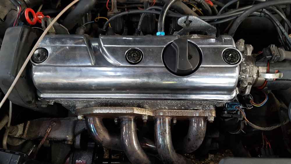

Sorted out my running issue today but putting my spare standard ecu in . 20170128_150459.jpgAlso finally got my 6n cam cover fitted! 20170128_144740.jpg20170128_145021.jpg
not bad shine, black is the best colour for these cars

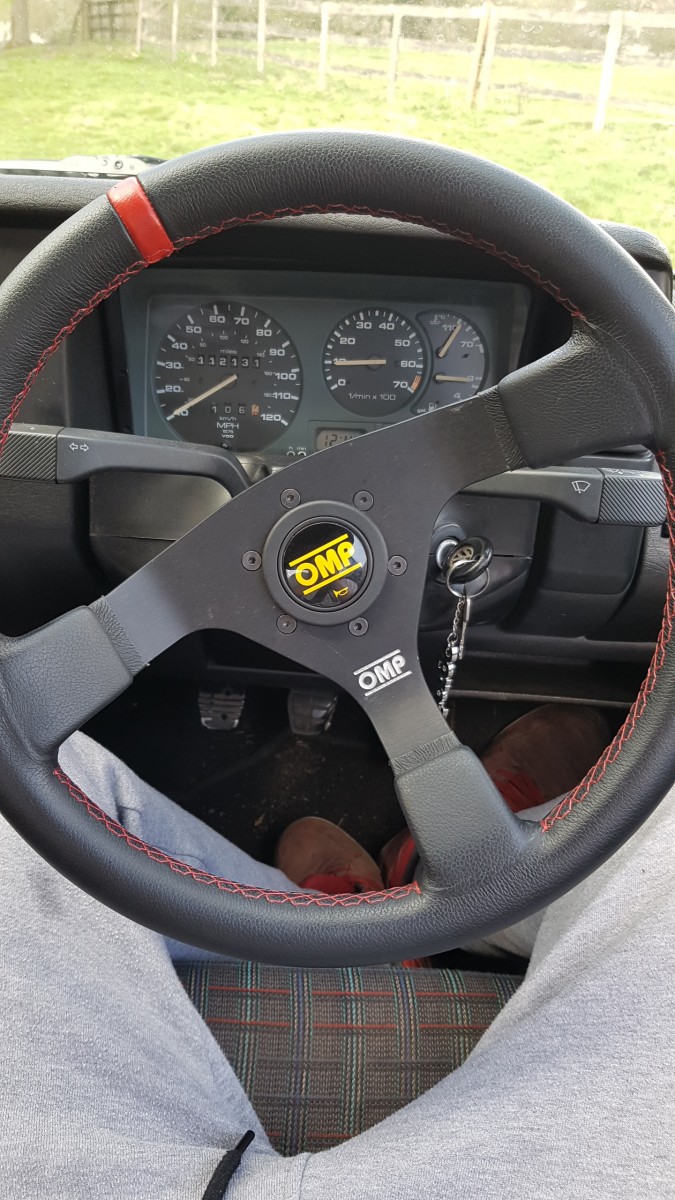

Not much of an update but fitted my omp steering wheel today and got her out for a wash.
