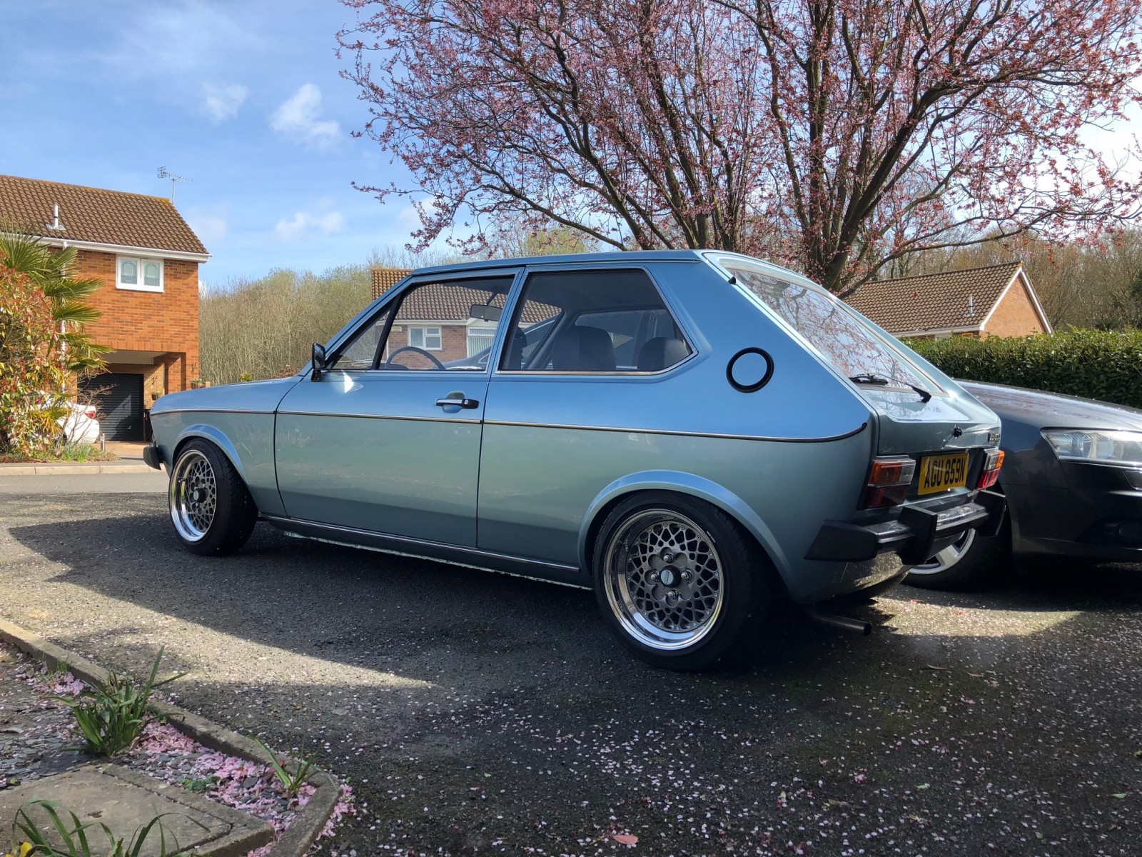

Apologies for the the lack of updates - photobucket screwing everyone destroyed any enthusiasm I had to keep build threads updated!
If you follow me on IG (@charleston_) you'll know where I'm at, but if not it's basically done. Just a bit of height and camber adjustment, brake tweaks and few bits of trim to add.
The pic below was as soon as it came home, and I had chucked two wheels on. The rear arch currently sits on the side wall (hence camber needed) and the front it too high. After adjustment I should lose most of the tyre into the arch.
