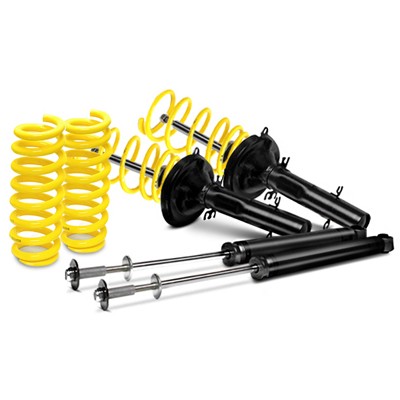

Spring and shock kit:
As mentioned above, damping can be an issue with lowering springs - not just the damper settings themselves, but also the range of travel the damper has - generally a lowering spring will be both shorter and stiffer, so to ensure it has the correct amount of pre-load, dampers matched to lowering springs tend to have reduced travel.
You can spend between £100 and probably £1500 on a spring and shock kit.
Cheaper kits will do the job - but probably won't be as good a quality, or have had any of the R&D which a more expensive kit will have had (Bilstein for example)
Dependant on your vehicle platform, ride heights can be adjustable with a spring and shock kit via a circlip on the damper body, however, not as accurately as 'coilovers'

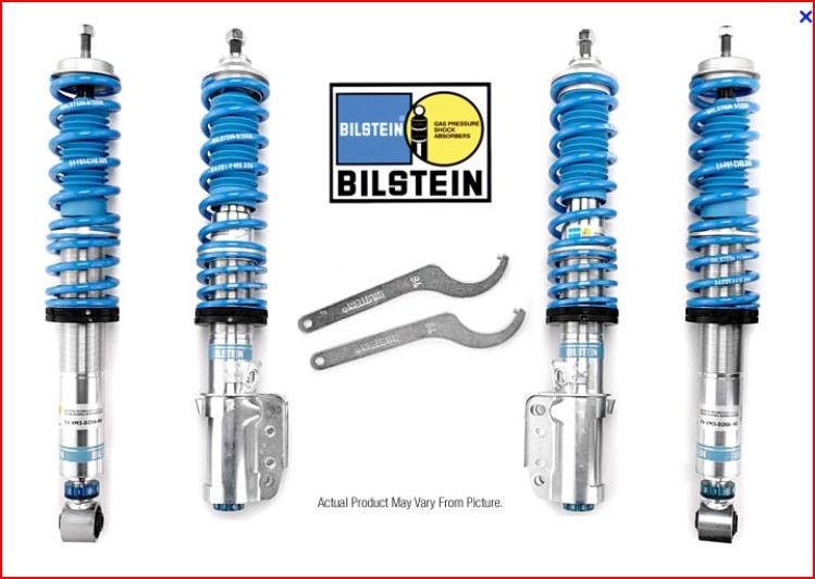

Coilovers:
People commonly describe a lowering kit with threaded height adjusters as coilovers, when really coilovers just means a coil spring over the damper, so technically every standard polo has coilovers on at least the front, and on the rear on some models too.
However, for ease of description, coilovers are a spring and damper kit, which generally has threaded adjusters for adjusting ride heights.
This is what people tend to go for to get their cars really low (although a lot of them aren't actually approved to go as low as people run them)
These are great for tweaking your ride heights, and particularly if you have a track car, setting up the corner weights accurately.
Again, you get what you pay for, cheap coilovers can be had for around £150 and up to and over £2000. Cheaper ones tend to again 'do the job' by lowering the car, however handling and ride quality tend to be somewhat sacrificed. More premium brands such as KW put more development into their kits, therefore you are paying towards that, but essentially end up with a better product.

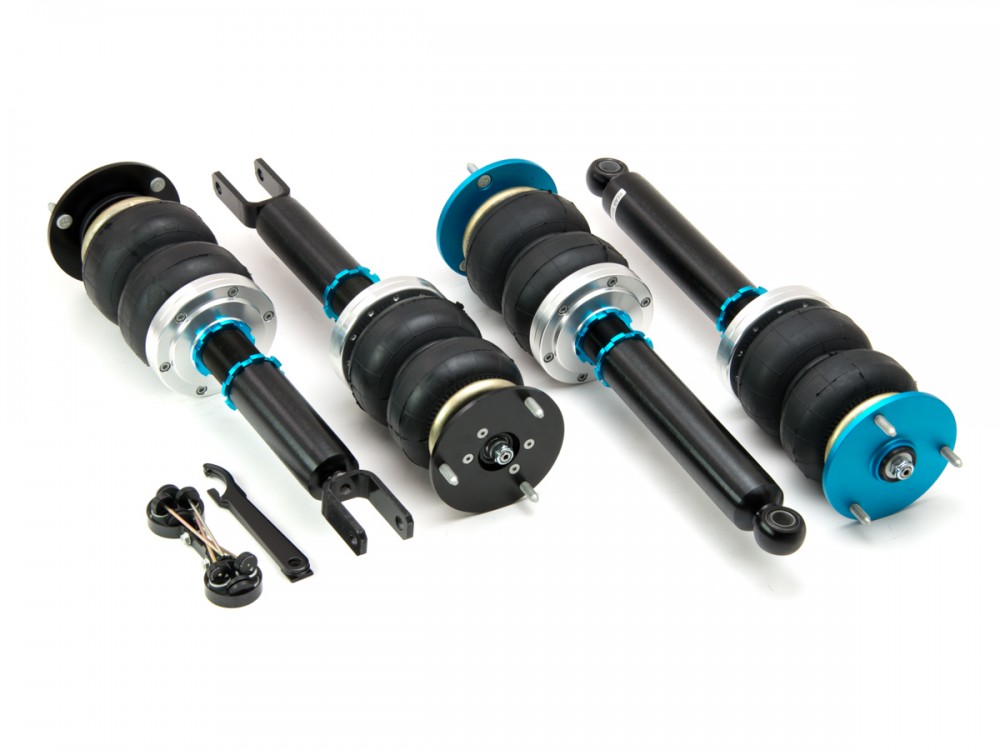

Air Ride
I don't really have any experience with after market air suspension, so wouldn't like to comment on what is good and bad.
Air will let you drive your car at a sensible height, then release air from the air springs to lower your car to look better.
Air springs can be a very tunable component, however I have no idea how much thought is put into this for after market kits. Certainly sleeve bags can be made to have linear and non linear rates so you could essentially make a great kit if the effort was made.
From what I have seen a lot of kits use bellow style bags, which I don't really know anything about.
Air can be bought cheaply second hand, or you could pay up to £10000 getting a good kit professionally installed.

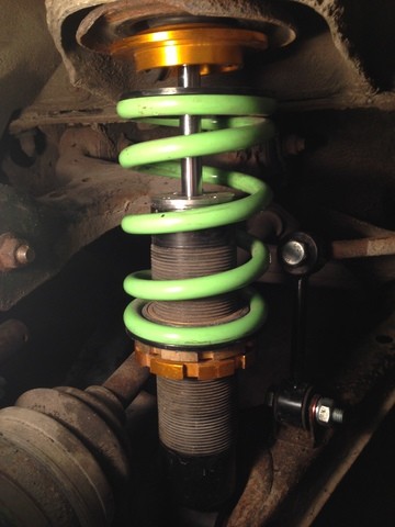

Here is an example with a tender spring correctly fitted. The vehicle has its wheel off the ground, so the damper is at its maximum rebound travel, yet the spring is still preloaded:

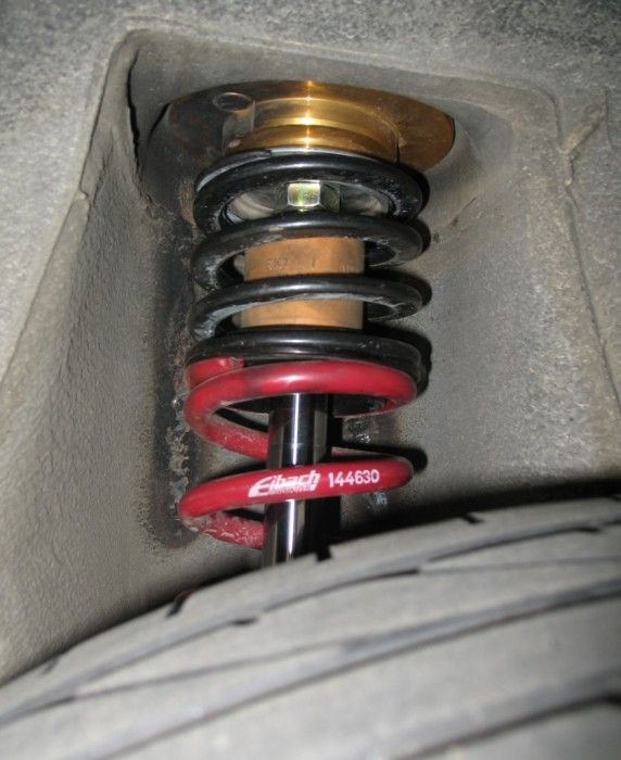

Here is an example without a tender spring fitted, note the gap at the top of the spring, this means there is a lot less force acting on the tyre (basically just the weight of the unsprung mass hanging down) but also when the suspension is compressed again it will have very little force due to no spring resistance, and then a sudden large build up of force:
