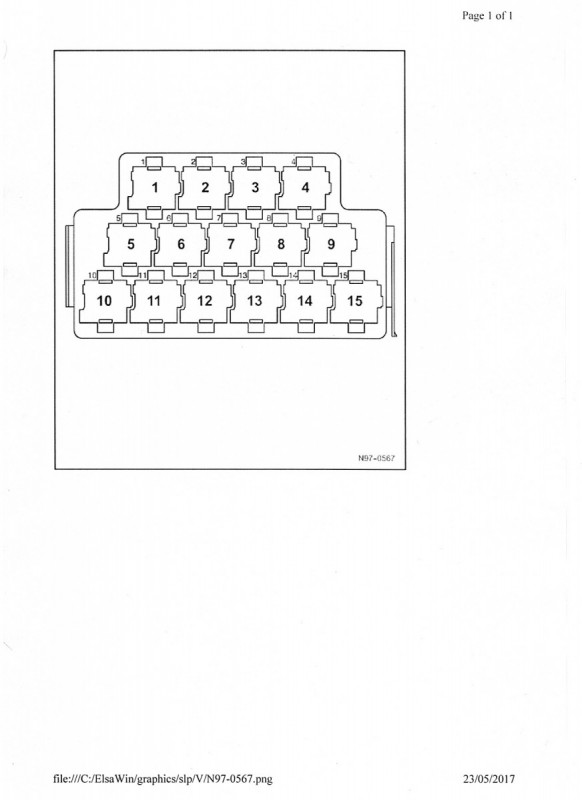

I don't have an internal schematic for the speedo, so can't say why that should happen, but sounds strange that is the only thing that seems to be affected ?  The seatbelt switches a hard ground to the speedo pin 20 (Yellow wire) on the 32 way connector The switch in the seatbelt catch goes via a 6 pin connector under the seat
