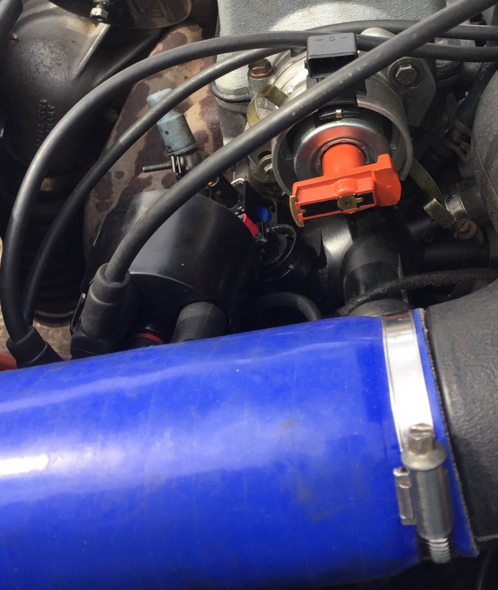

The car hasnt got a got it not started it today it's been raining which picture are you asking about the piston?

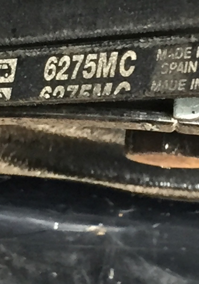

  • You've got it running with timing light showing still crank pulley line marker at Z (for Zündung = ignition). The Z is the 5 degree mark for that pulley. That sounds fine, there's sparks and fuel
  • Yes the timing mark jumps about quite abit whilst looking at it
  • As said before though low compression can also cause the same wobble
with the timing marks aligned on both pulleys and rotor arm ...number piston needs to be at the top of its travel
Yes it's at the top put a screwdriver down the spark plug gap it was sitting perfectly
well then its timed as long as youre sure ....with the dizzy adjusted so that the rotor points at number its good enough to run then fine tune with a strobe , if its all set like that then you have other issues
I'm 110% but it still runs like a bag of nails which baffles me
