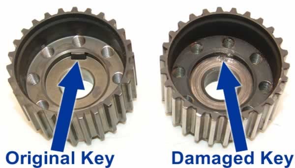

However, if you do use this method, once you have found the top of the stroke, if you then rock the crankshaft backwards and forwards a few degrees, you will be able to 'feel' the APPROXIMATE dead centre position, at which point, if your key/keyway is in good condition, the factory TDC mark on the pulley should line up.

I did think that I also thought it could be several factors the bottom end has been sat for over two years so have things moved?the head has been skimmed twice so that may affect the cam marks and the engine is that heavily modified I’ve had to rebuild the engine and put all the standard parts back on to get it to run properly again and then gradually put the performance bits on slowly and build it back up as I go so it’s been a slow process
I’m starting to think about a pulley now
