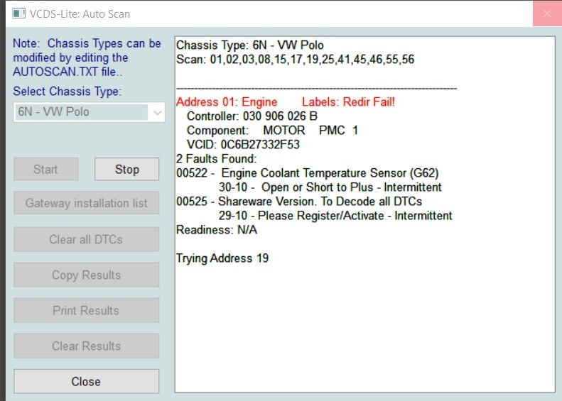

Just now the misfire lasted till the end of our road and then was back to a normal ECU-controlled warm-up fuelling schedule. So I guess one question is why are all the plugs so sooty in the first place? The only thing I can think of that wouldn't have any other ramifications is the blue temp sensor (Hella brand) is off and a VW OEM one is needed. That or just its a 25 year old motor and its 2 degrees outside at the moment!
dont think a leaky valve would heal itself up with heat
generally running too rich could be the fault...a lambda controlled engine should have clean plugs all the time , mine look like new after a few miles
at first start the lambda doesnt kick in for a while...maybe something to do with that , could it be doing its job and leaning things out
has it had a blue temp sender latley....this gives the ecu its temp reading and if wrong the car will thing its very cold or hot when its not
Aye it has - that Hella brand sensor is new in recently. I guess one thing to do would be to look out for an OEM one? Bit loathe to swap out this one now that I've just put in a load of new coolant eh...
