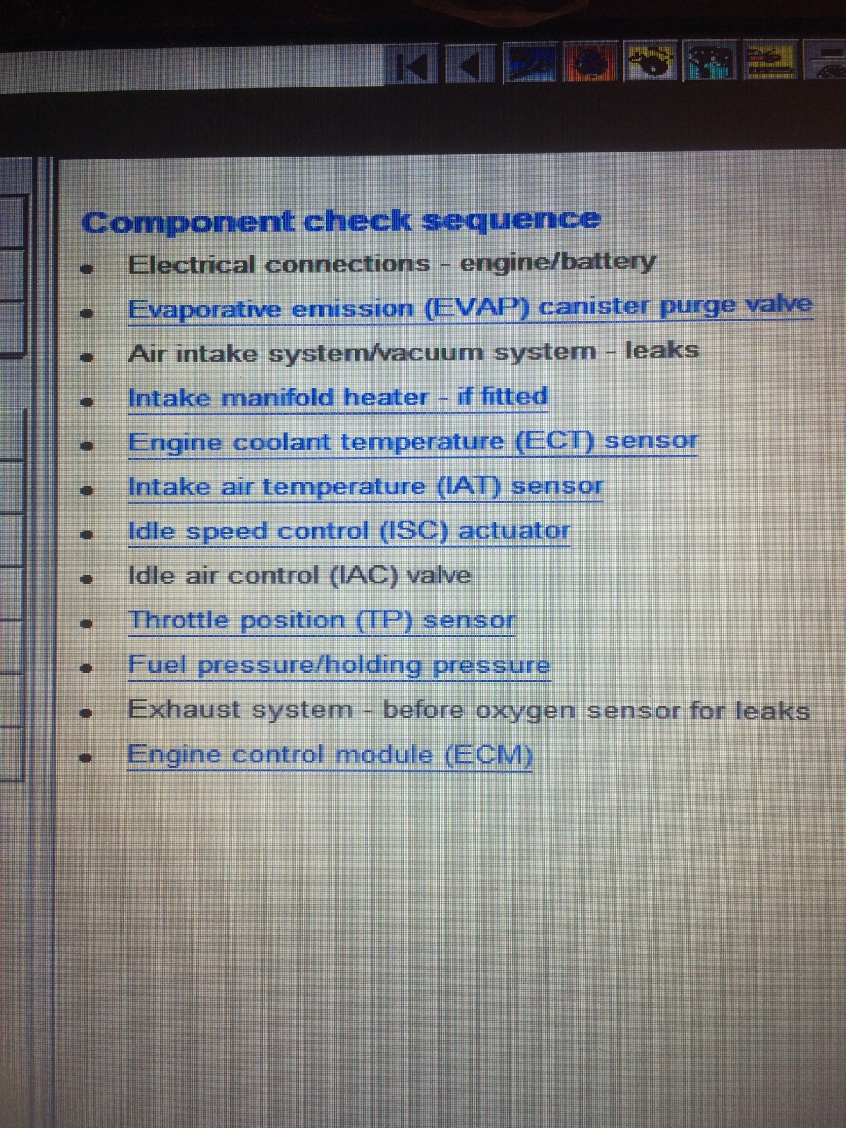

This is the fault finding list on Autodata for poor idling when cold
I can’t find a flow rate for the SPI. Only a pressure of 0.8~1.2 bar when idling and holding a pressure of 0.5bar after 5 mins since switching off
Thanks for that - thats a handy checklist.
