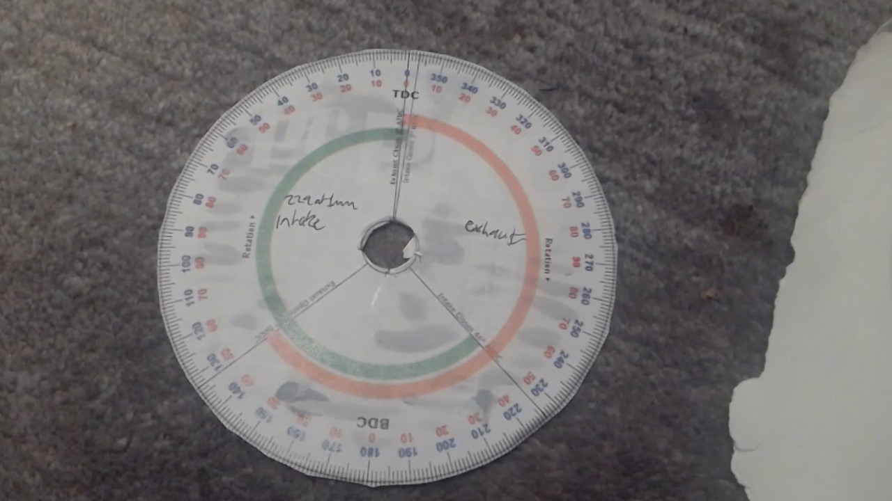

I want to check some camshaft dimensions and angles,
http://www.tildentechnologies.com/Cams/Tip_DegreeCam.html
so I thought I need to buy a degree wheel. Like a 360 degree protractor. to attach to cam pulley
Found one then realised it was for an American muscle car and like 9 inches in diameter.
A polo camshaft pulley is 132mm diameter.
Found one for minis, but not sure of the bolt size.
https://www.retrominisltd.co.uk/index.php?main_page=product_info&products_id=167
Then found a web app
https://www.blocklayer.com/degree-wheel.aspx
that will create a custom degree wheel marked with your cam events (ATDC BBDC ACDC?) as a PDF to print at any diameter you want (almost).
And suggests CD sized. (hint use the Print Diagrams button, turn off Fit to page when print the saved PDF )
So I did that and glued it to an old PCPro magazine CD..
