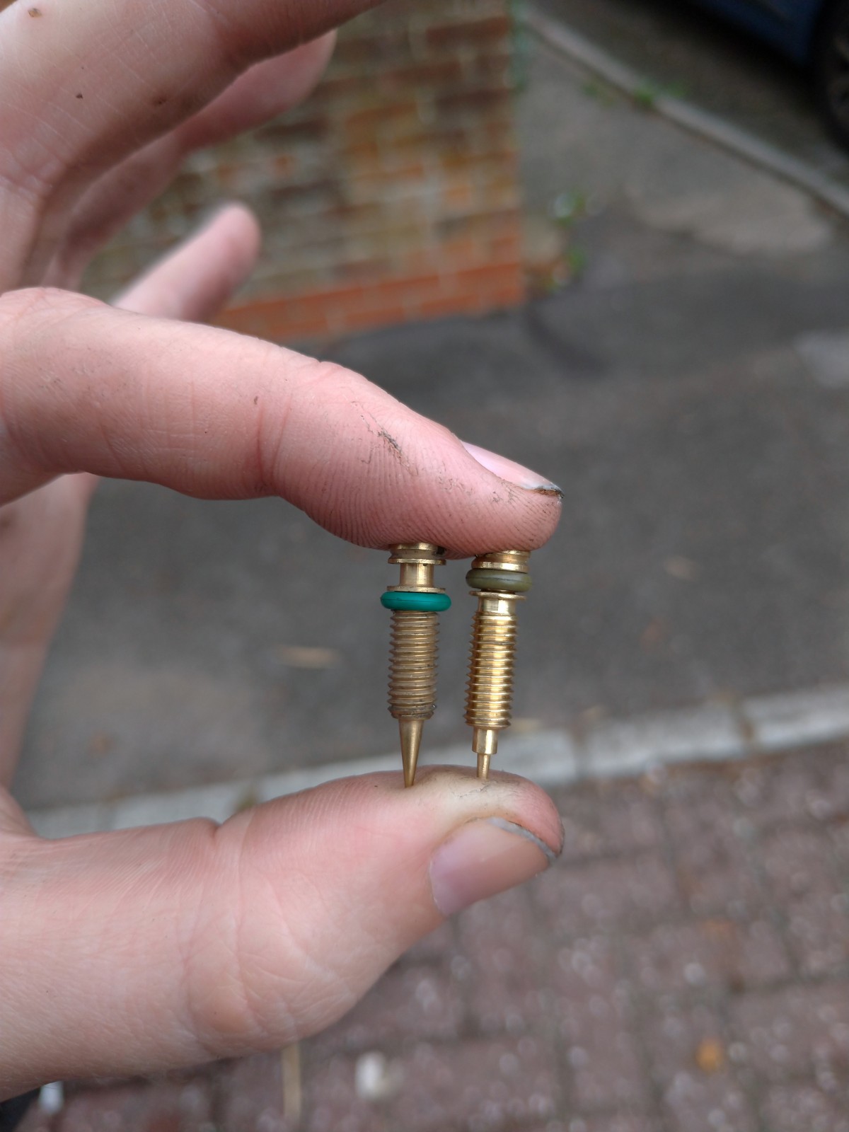

I found a new (old) mixture screw from a rebuild kit. I also fiddled around, put a new vacuum line to the air box temperature switch, and blew carb cleaner through some of the air holes on the top of the carb.
Things are a lot, lot better now! The colortune shows idle at ok-leanish condition. Fiddling with the screw makes the idle stop rising about 2.5 turns out. Going on to throttle is quite sensitive, although I think there might be a little slack in the cable so will rule that out. The new jet I put in on the primary seems to make it run rich (yellow flame at higher RPM?). Will be fiddling about with this some more.
At the moment though, it pulls just fine with the choke in. My test was, can the car accelerate from 1.5k revs in third? Yes, it can. Plenty of torque (for a 1.3) to make the car move, no misfiring. As things are, it looks like a case of tuning rather than actual issues with the carburettor.
I'm guessing the mixture screw made the difference because that's the biggest thing I changed, this one feels a little spongy where the ring is meeting the inside. It actually feels like the one on the old Pierburg. I don't know how the different profile affects things, but, it seems to work. (The new one is on the left in the pic)
I'd have to look at another screw, to confirm, but O-ring closer to pointy tip is probably right.
 I can't remember what the taper is meant to be like. Smooth taper obviously linear.
Looked at 32/34DMTL (from a Landrover I think and very crusty) it has stepped mixture screw.
A  30DMTR - (type 103/252) had the tapering screw.
Both had o-ring at slotted head end and not above the thread.
I suppose the tube is long enough to seal.
Might you have damaged the mixture screw tube with a slipped screwdriver tip?
Carb body is soft alu.
Removing the tapered one with fingernails (and old hardened maybe leaky o-ring) was easier than the other whose o-ring was still soft.
www.webcon.co.uk/shopexd.asp?id=5234
is stepped and correct for DMTL
But if the NOS one works, go with it.
