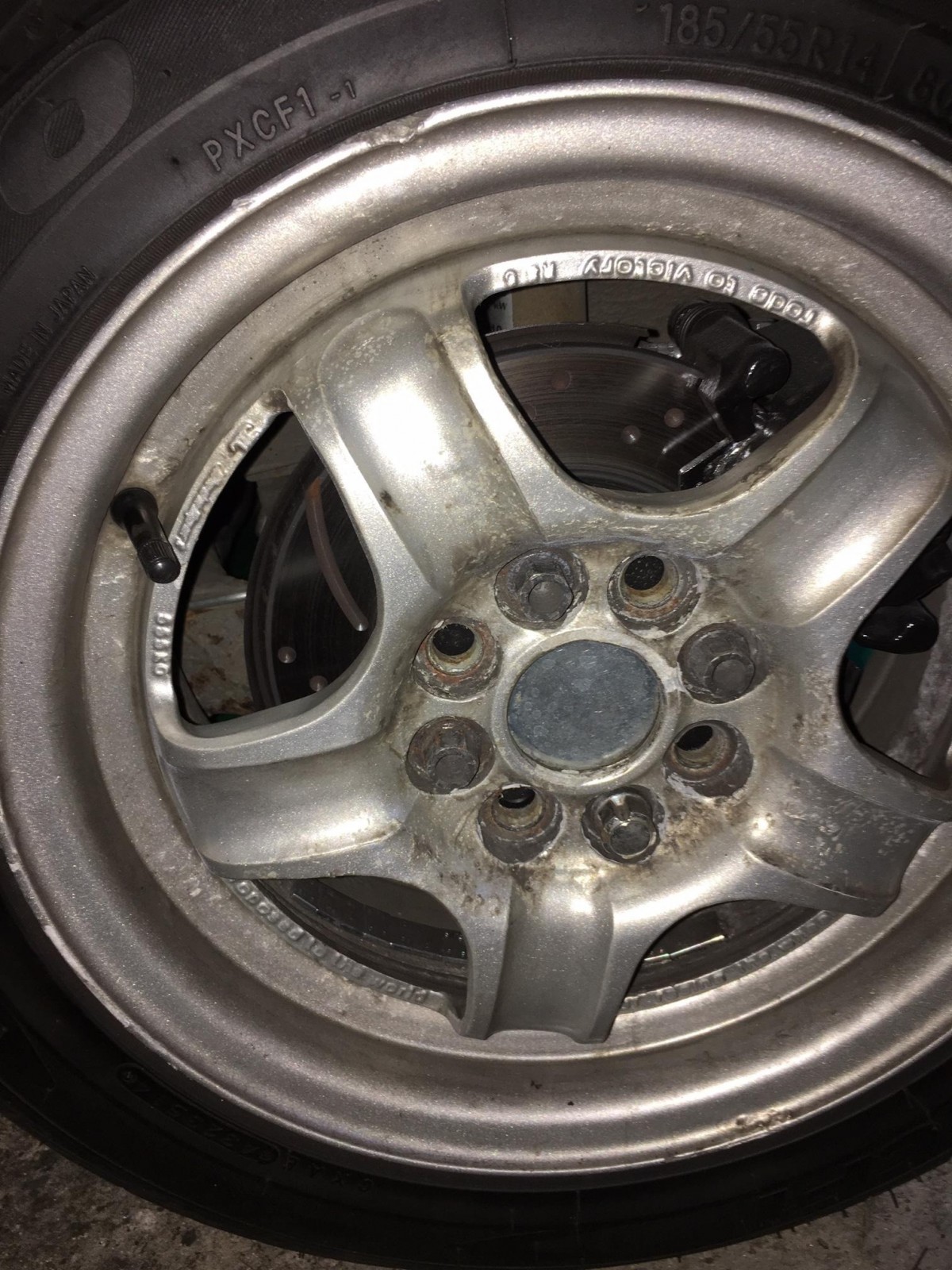

I bled the front brakes again.
I am starting to wonder if it is natural for the non vented & smaller discs to get hotter than the fronts leadings you to beleive the fronts are not working as they should.
no fault codes on ABS using vcds free version. No point spending 99 dollars plus brake fluid bottles if everything is already.
JUst dont want rears ot catch fire. whats max temps discs can get to before you should worry.
did a ten minute drive , brakes a few times rears were 100C and fronts were 50C
https://www.ferodoracing.com/products/car-racing/racing-brake-pads/ds2500/
Pads can reach 500 degrees.
Smaller solid disks run hotter.
Small pads are hotter than big pads.
If it is not locking up the rears first ant not boiling the brake fluid it's probably fine.
Get a roller brake test as done as part of MOT (unless you car is too low for the rollers).
good idea. makes sense.  i can push car without andbrake on.
hand brake cable is flapping around under car  abit but i doubt that could engage a handbrake.
How they supposed to get cooling with dust shield on this side of brake disc; that stops all air flow to it.
