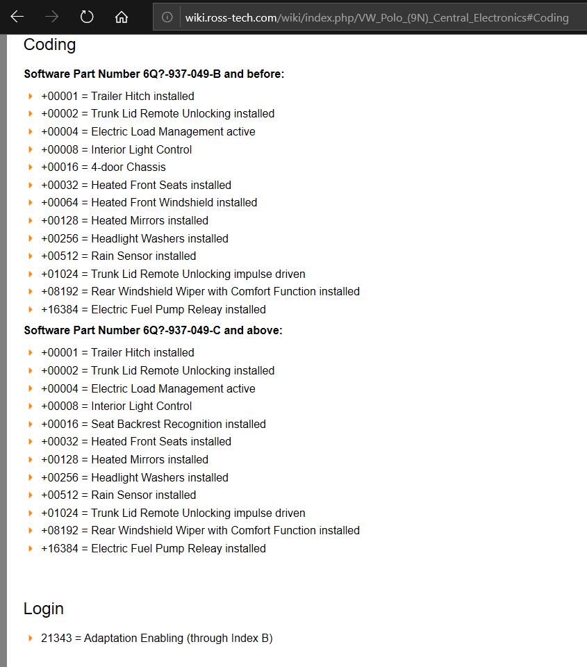

Found the coding table for J519, on Ross-Tech:
http://wiki.ross-tech.com/wiki/index.php/VW_Polo_(9N)_Central_Electronics#Coding
There are a few adaptations available, listed on the same page, which might be fun to try.
I think you'll find the you will need the full version to do any adaptions and maybe even any re-coding the "lite version" has very limited functions

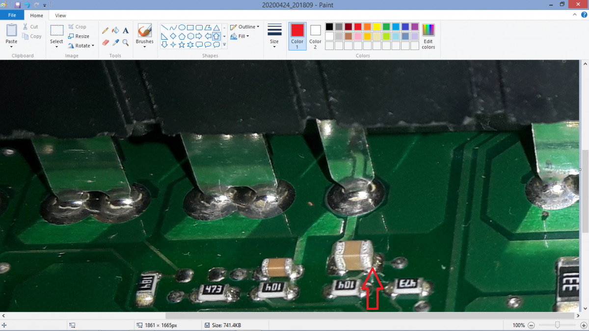

Just got to work out what the fault is now. Will possibly start by removing and examining the unit, to see if there's similar component damage to what's happened in yours.
Edit: nope no such damage, nor anything else obvious.

Of course this may not be why you're measuring what you are, but I think it's quite plausible.  Not sure how this relates to the obvious damage within your module, which may be 100% or 0% related to your measured situation.

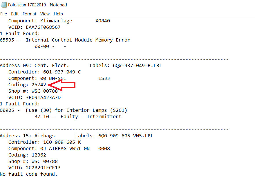

Your offer of the control unit is very kind thank you  I'll plug the VCDS in after I've had my dinner and attempt to read the coding of the unit and let you know what that is later.
Doug.
Pete,
The "soft coding" for my central electrics controller is "25742" , I tried to upload a screen shot picture but it says the file was too big!
Doug.

Just remembered Doug, the so-called CAN Gateway at address 19 is a sub-module within the Onboard PSU unit.  Don't suppose your scan included showing the coding for this also, just so I can check it too? If you did an autoscan it should be amongst the results, otherwise you'd need to specifically address that module (19). I think it's always coded 00014 on any similar cars I've seen, but it would be good to be sure it's right before I send the unit.
I could change any adaptations you want while I'm at it too, e.g. reduce the terminal 30g activation period, reduce wing mirror heating from the default of continuous to - say - ten minutes. Reduce rear screen heater timeout period etc.  Have a look at the last section under the Adaptation heading (for suffix C and later control modules) here http://wiki.ross-tech.com/wiki/index.php/VW_Polo_(9N)_Central_Electronics#Coding

Morning Pete, no sorry I just opened VCDS far enough to see the code on the control unit and I ran a fault code check but that was it.

Just a quick update on the high current draw saga, Pete has been a massive help and between us we decided that the obviously burnt component on the circuit board of the BCM was the source of the issue so Pete kindly supplied me with another unit (incidentally slightly different part number to the original) but re-coded to match the one originally fitted and it has cured the high current draw - now at 0.01amps by the time all of the ECU's have gone to sleep (which takes approx 1/2 hour on my car)!
