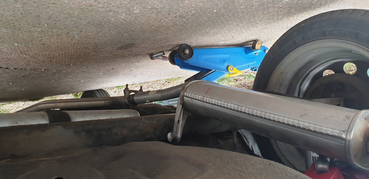

  • So that part arrived from Germany. Fits beautifully! Has only really pulled the lowest part of the exhaust up by about 3mm. At least it isn't any lower! It's also quiet. Really quiet. Which i'm okay w

I have nothing to actually check for leaks but i can't see any signs of leakage around the connection.
Only thing is literally a tiny section that looks like it could be a bit more snug. I measured both pipes and they were pretty close so i'm guessin they are seated quite nicely inside.
