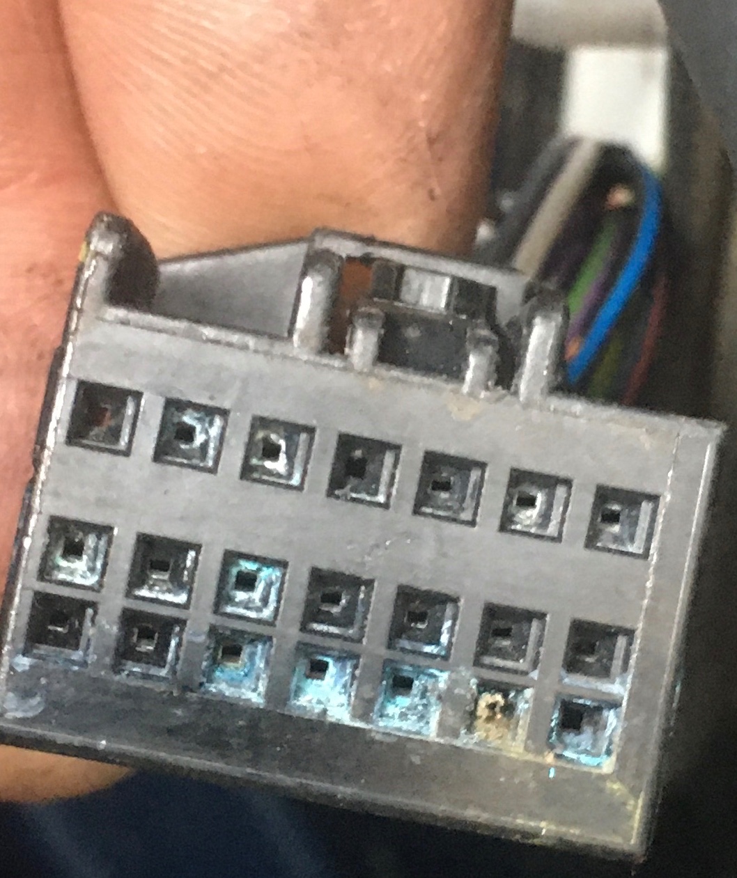

Not good that.
I may have some of both halves those crimp inserts, male and female, can have a look over the weekend if you like.
I'm guessing that row of pins in the mating connector won't look very pretty.
Hi Pete

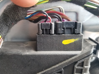

You nailed it in one ! Did some more continuity testing across the Drivers A post , resulting in a fail , so pulled the plugs out which was a bit of a tight space but there it was broken pin in the plug bottom left second one in , connecting the purple / white wire . Corrosion evident , not surprisingly like you said ( exactly) a previous visit has left the bellows not seating well over the plastic bracket it slips over is loose obviously let moisture in . Not sure what to do about the pug connections big deal chopping all those wires in the footwell to put a new plug in , so for now just pieced the connection up with a piece of wire  and siliconed the bellows secure , all working . Thanks again for the heads up not sure I would of got there without it 👍
Not thought of replacing the actual pin inserts may be a way forward assuming I can get to the plug under the A pillar , they have some sort of tang holding them in and a little tool needed to release out of the plug
On the sister car, the Skoda Fabia, that whole connector block can be taken out outwards, and the individual connectors accessed. Haven't studied a Polo to see if it's the same approach. I was pleasantly surprised to find there was enough loom to be able to pull the lot out a bit on the Fabia, unlike Skoda's normal 'juuuust long enough' approach.

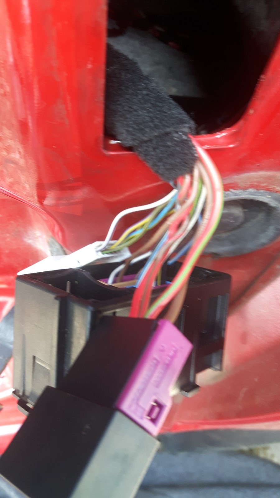

On 01/12/2022 at 20:52, JonG said:
Hi Pete
Yes I initially peeled the bellows away as I’ve had fractured wires before , even within a loom ( o2 sensor heater circuit ) but nothing obvious, today I tried another unit (  supposedly working fine ) same results.
This was before I saw your reply , so after reading that went at it again , this time I pulled both bellows well back still nothing showing at the top towards the A post plugs ..,rather than undo the looms further down the bellows I did a continuity test from one plug to the other with both door cards off ( as you said the purple/ white ran from one module to the other ) Result no continuity, as you suspected . So next just to confirm that I ran a fresh wire from one plug purple connection to the other plug connection .
Result …,working windows 👍 confirming indeed a break somewhere . Next up continuity test from plug to wire just before it enters A post plug on both sides . Result continuity…,Running out of daylight at this stage so called it s day for today, but hey at least I’ve narrowed it down to a break in between both A posts , I’m suspecting the Drivers A post connection may be dodgy there was evidence around there of previous mauling with some old Alarm harness . I’m gonna resume tomorrow see if I can find it , if not I’ll run a fresh wire between the confirmed good bits ,
.Right then bud massive thanks for putting me in the right direction with that purple white wire , it was starting to drive me nuts not making any progress , ill
hopefully find the break keep you posted .Excellent advice and tips again 👍

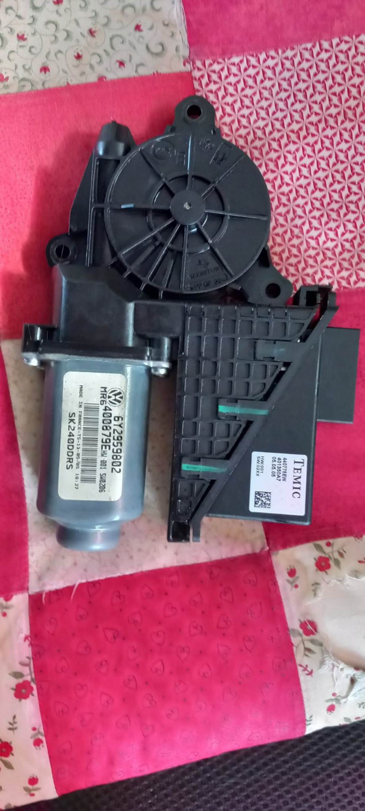

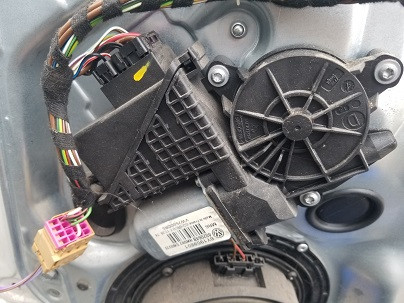

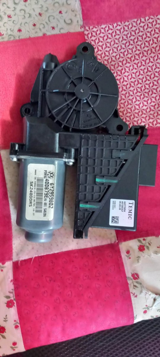

This is the what the part looks like (mirror image of this and PN 6Y1959801 on RHD Polo):
