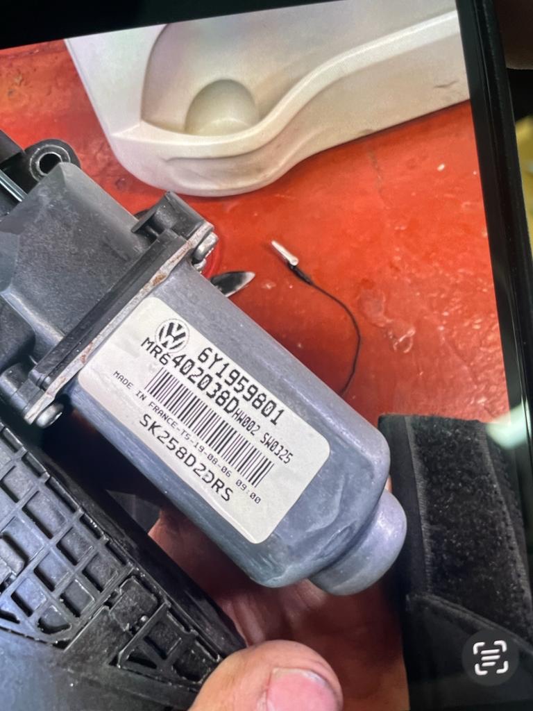

Hi pete,
can I have an address and telephone link so that I can send you photos ( even the unit!) of the window module/ motor on my Skoda Roomster 3 , 1.4 16v petrol 2007 model.
It’s drivers side front.
6Y1959801
402038D
SK258D2DRS
TEMIC 440765EW
many thanks for your help
1618b715-fbd7-4d28-a01f-7c7f066765db.jpeg.22d4e6d8e92b4418a2c5620cfbb68496.jpeg7da8f951-05de-4b32-8243-5c24bebb5ecb.jpeg.71e83dddd78961247203c76681de2e78.jpeg
Will send you a message in a few minutes. 🙂
