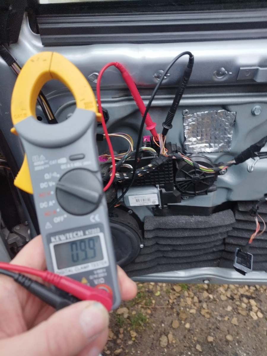

Finally got around to working on the electric windows on my Polo 9n3. Was wondering if you had any other insights into what the issue might be -
Removed both door panels, removed the connectors from the electric window motors on both sides and check the continuity on pin 3 (lilac/white wire). Seems fine reading 0.05ohms so I don't believe that is the issue?
Voltage to ground on lilac/white wire with only the driver side connected is 1.5v
Voltage to ground on lilac/white wire with only the passenger side connected is 10.5v (or 12.5v with engine running)
Is that normal? Still wondering if it's a fault to the circuit board in the drivers side motor?
Symptoms are that the passenger side window does not work from either the drivers side or passenger side switch, however by unplugging the connector and plugging it back in it will work temporarily from the passenger side switch until you lock the car and the system resets. I've tried changing the passenger side motor for another one with the same result?
Many Thanks

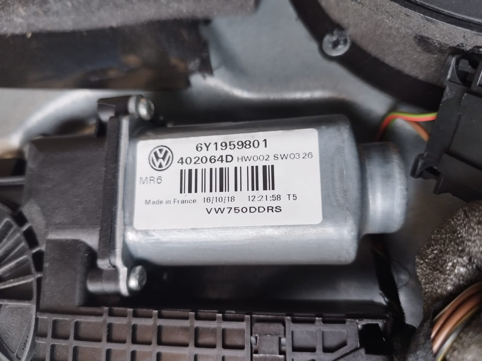

Probably simplest to try another driver's side motor to see if that sorts it.
Can do you a returnable exchange one on a refundable-if-no-fix basis if you like, give or take postage costs.
Photo of existing one?
And passenger side too please, just the main VAG part number labels.

Hi, thanks for the reply. The drivers side, as you can see it must have already been replaced once a few years ago before I got the car, has a date code of 2018. Don't know if this means it's an improved design, or if they all have the same fault regardless? I think I've ruled out the wiring, the connectors inside the door hinges, the driver's side door switches and continuity on the lilac/white wire from one side to the other but can't be 100% sure. Presumably if the motor on the passenger side has power and connectivity on the LIN bus lilac/white wire then it should work right? As I say driver's side works fine but passenger's side only works on the passenger side switch if you unplug it/remove the fuse and then plug it back in. Tried 2 different motors both the same fault.
So if you think it's fixable please PM me the details for posting it to you. Many thanks!

Interesting.
The VW750 bit on that label tells me that it's a motor for a T5 Transporter rather than a Polo (would say VW240 instead).
I doubt that alone would result in the observed misbehaviour on passenger side though.
I've never seen 'mix and match' pairings like that on my test rig show such behaviour.
Will be interesting to see what you have on passenger side.

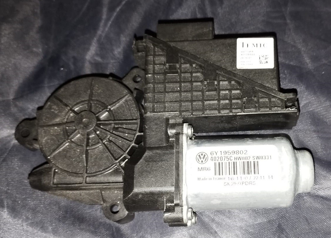

Passenger side one that's currently screwed on is correct for Polo, other one is from a mk2 Fabia (SK250).

Passenger side is the bottom picture which I believe is the original one, although I've also tried the other one in the middle picture which I recently bought on ebay. Even though the drivers side motor is from a T5 It was working absolutely fine like that for about 3 years.

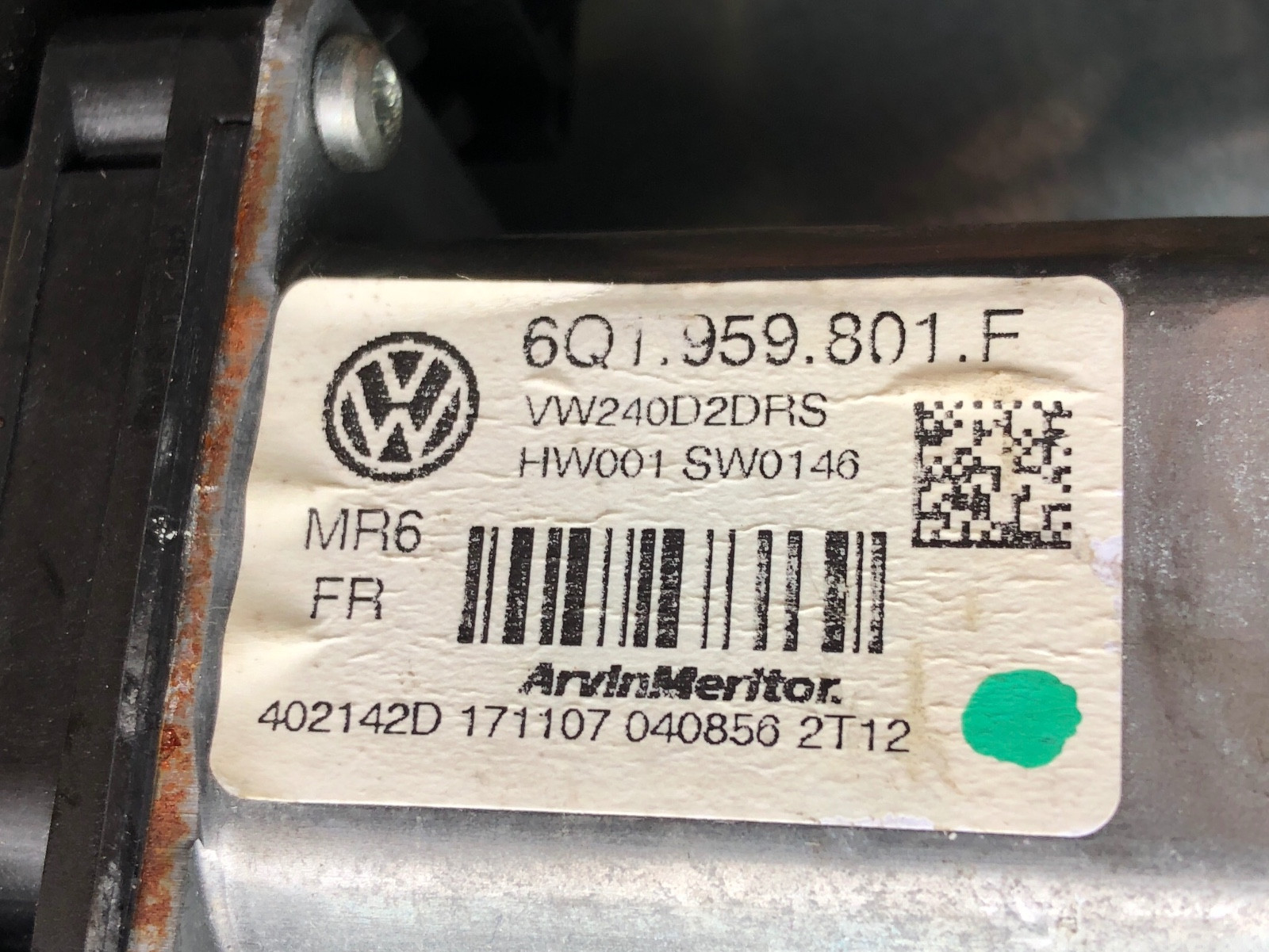

I have the same or some symptoms as many in this thread, but my polo is 2008 with an updated ( presumably ) version of the motor.
Drivers door fails to unlock using drivers door
Drivers electric window works all the time
Passenger window works for about 10 mins when using passenger switch only after being locked/ unlocked from passenger side
All central locks work from interior switch
Electric mirrors work both sides and heat as normal
No fault codes on vcds
6QI959801F
VW240D2DRS
HW001 SW 0146
In case the pic doesn't load here are the numbers, any chance you would be able to do an exchange repair please ?
Many thanks
Tony
