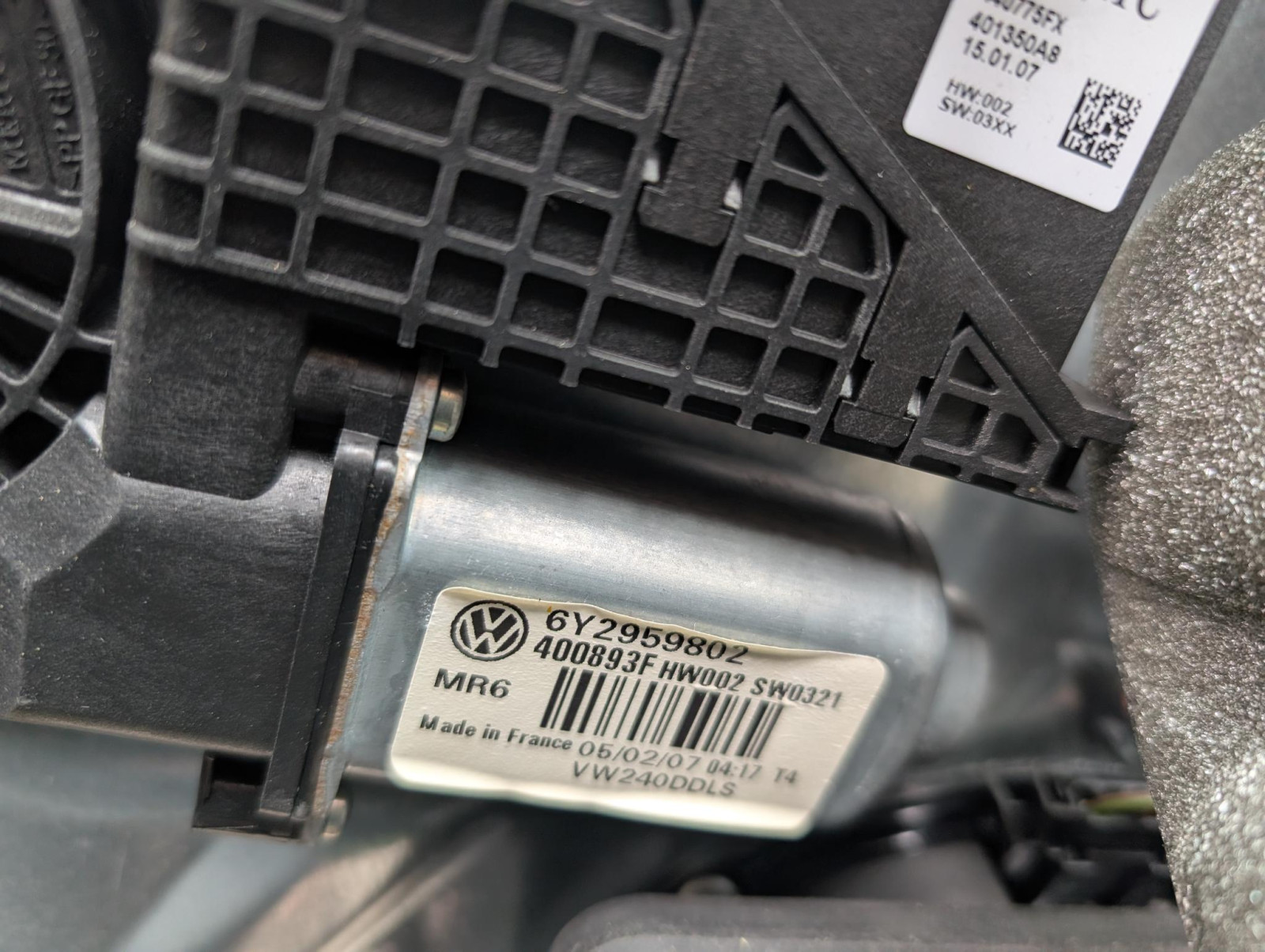

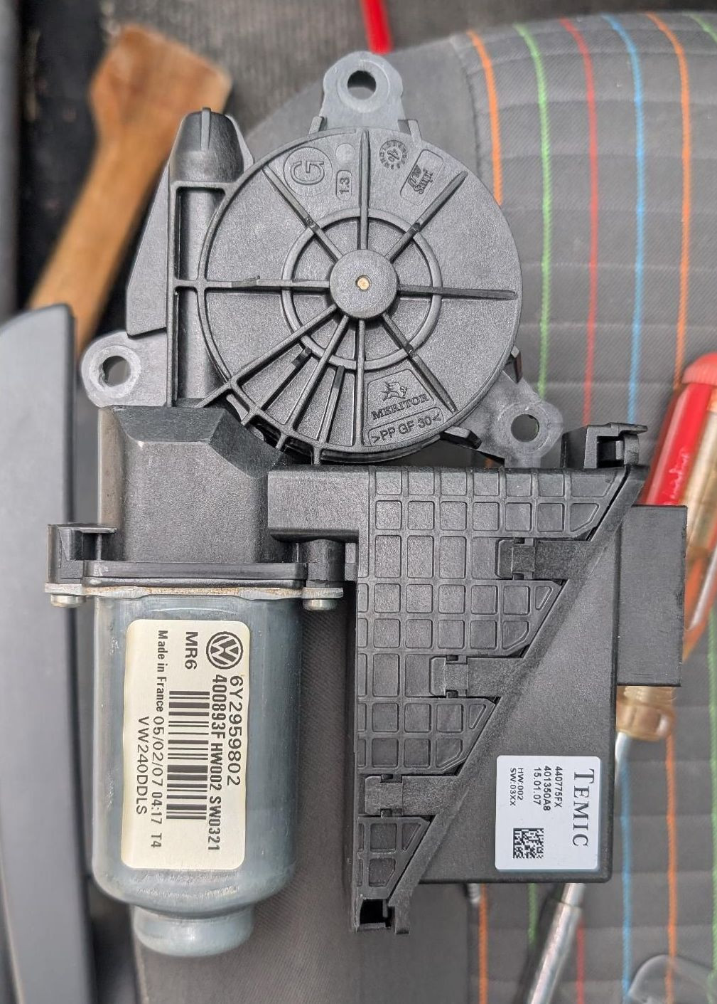

Hi, I have problems with windows and central locking not working from drivers door. I have removed the motor 6Y1959801 also with Temic numbers 440775FX 401350A8. Can you help with testing/fixing the module.
Many thanks
@Vellan, yes I'll be happy to help you with that. I'll message you with more info.

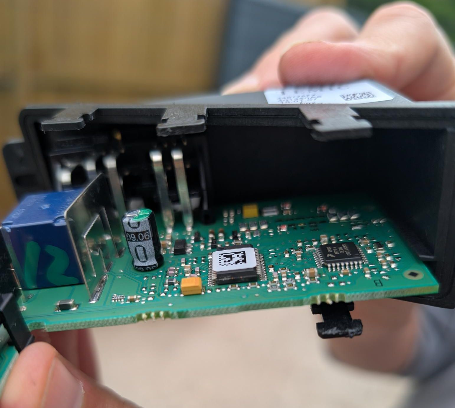

Hi Pete, (my 1st post here) I have a 05 polo 1.9tdi gt with window trouble, if I disconnect the battery and leave it for an hour, reconnect the battery, they will occasionally start working ish, sometimes just the passenger side, but never lasts before stopping again, so far I've checked the wires between the door and A pillar, they look fine with no signs of cracking, even fitted a new relay & changed the 100uf cap on the drivers side 6Y1959801 module, still no joy, is it the mc33689adwb ic that dies in them and causes all the trouble? Be way beyond my capabilities if it is, remote central locking seems unaffected, but the using the key in the drivers door just opens/ locks it, the interior light doesnt go out locking with the key, if I lock via the fob then unlock with key, open the door the alarm goes off, till I press the fob to unlock... does it sound like the drivers window module at fault of a wiring break that I've missed? any help would be greatly appreciated,
Thanks, Ben
Not the relay, not the capacitor and not the LIN chip.
Messaging you now.
